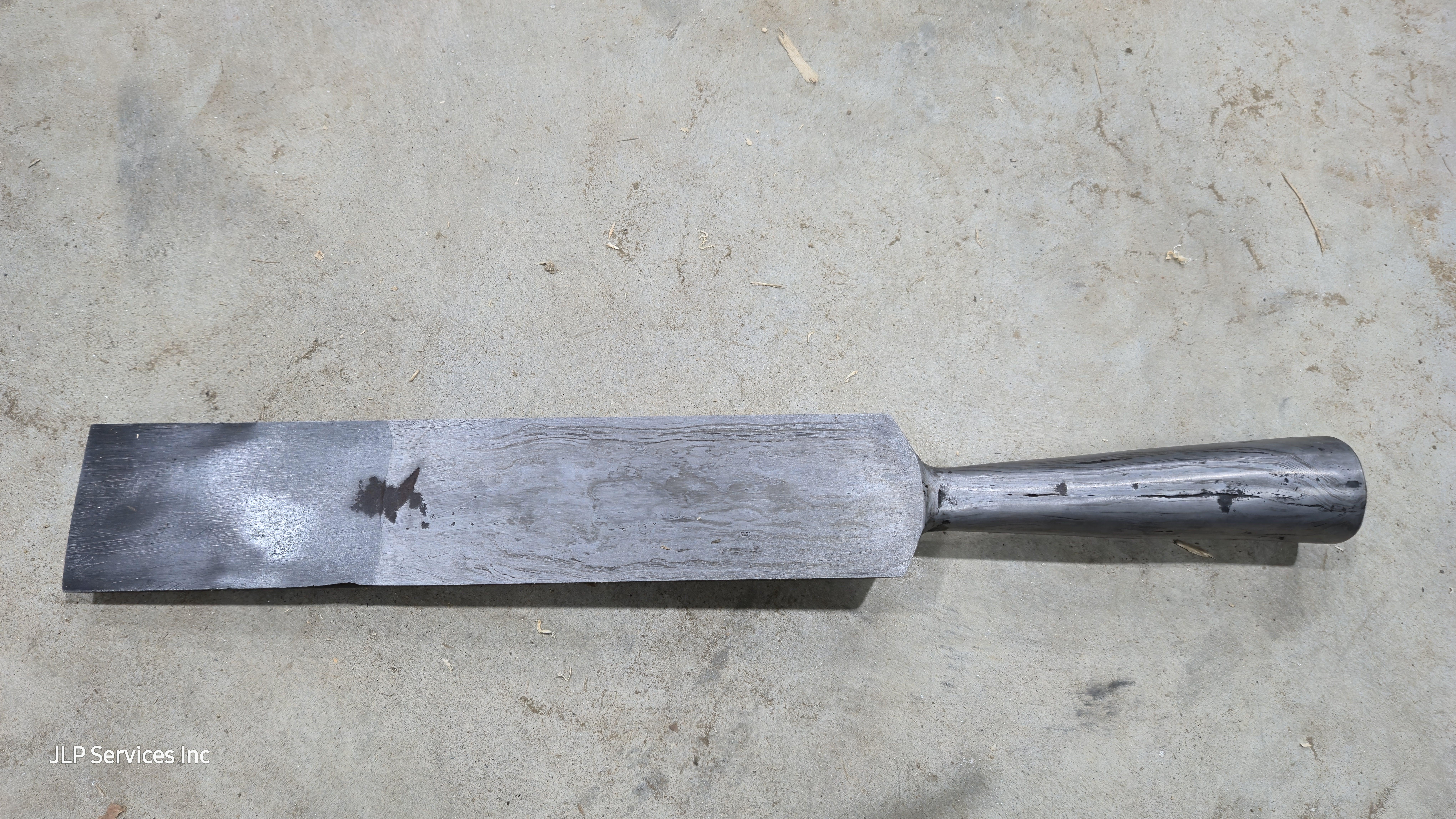

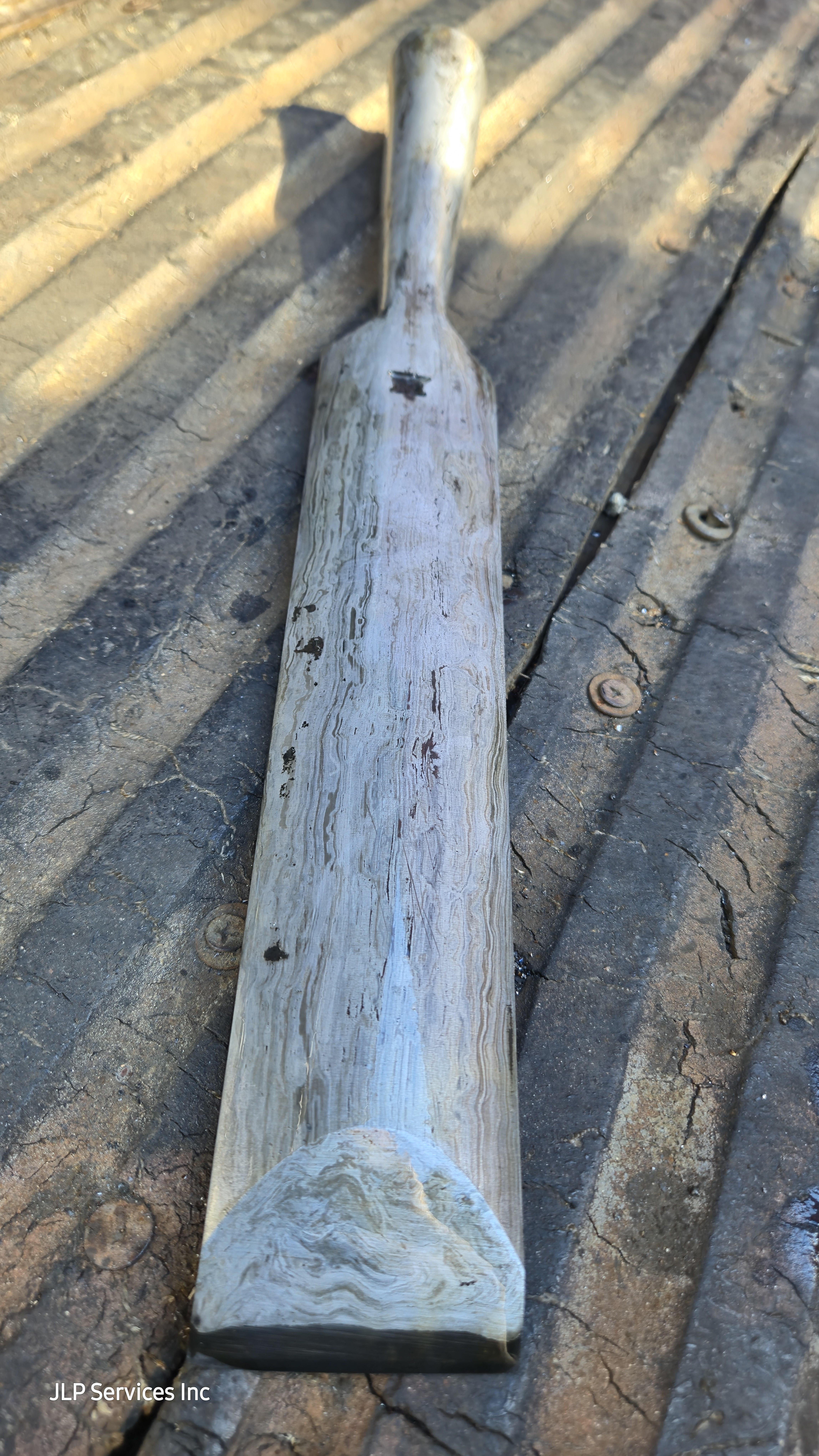

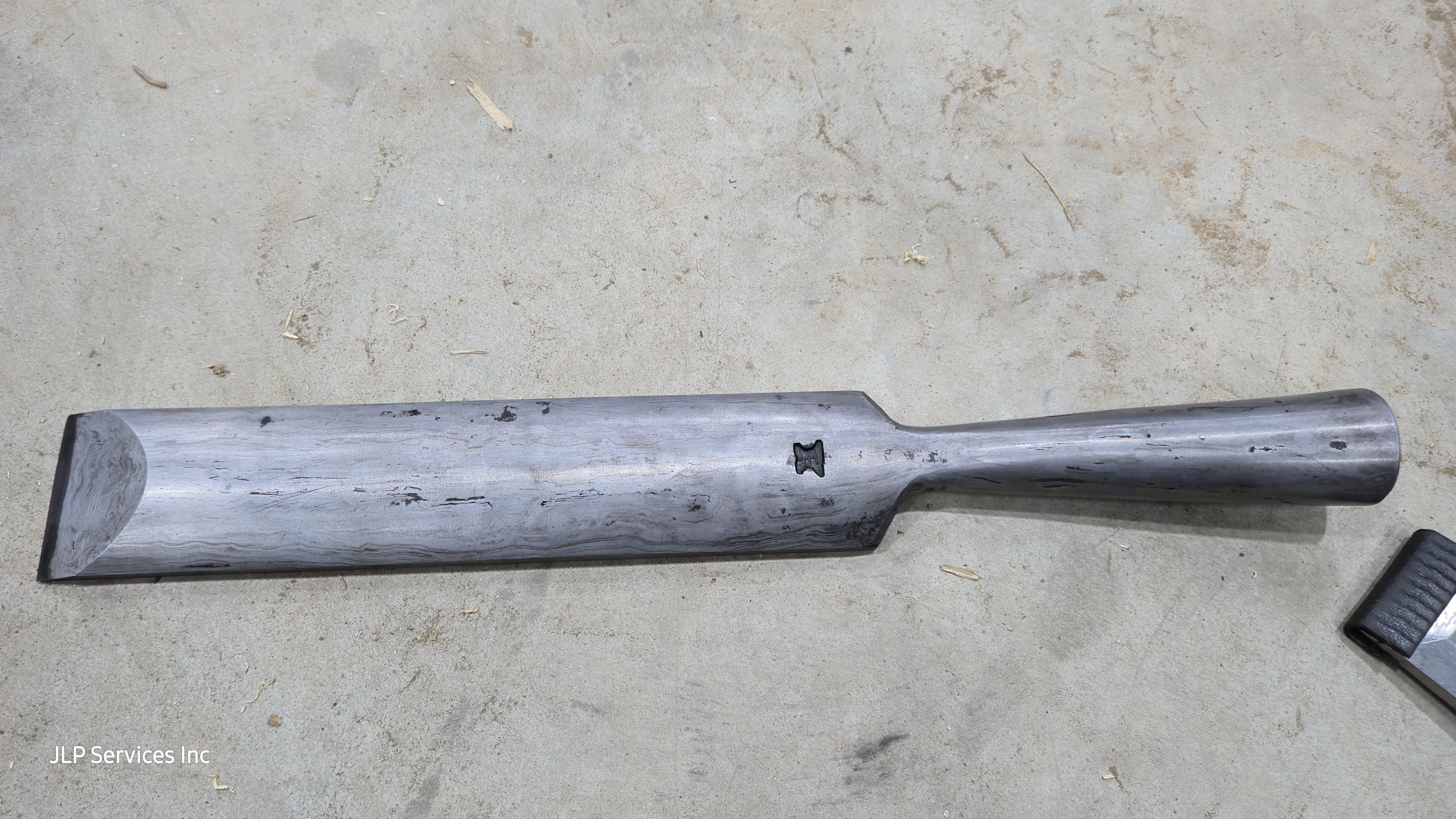

I finished up the chisels and bick iron to send down to CMA Johnstown for class spring 2025
1", 1.5" framing chisels and 2" slick

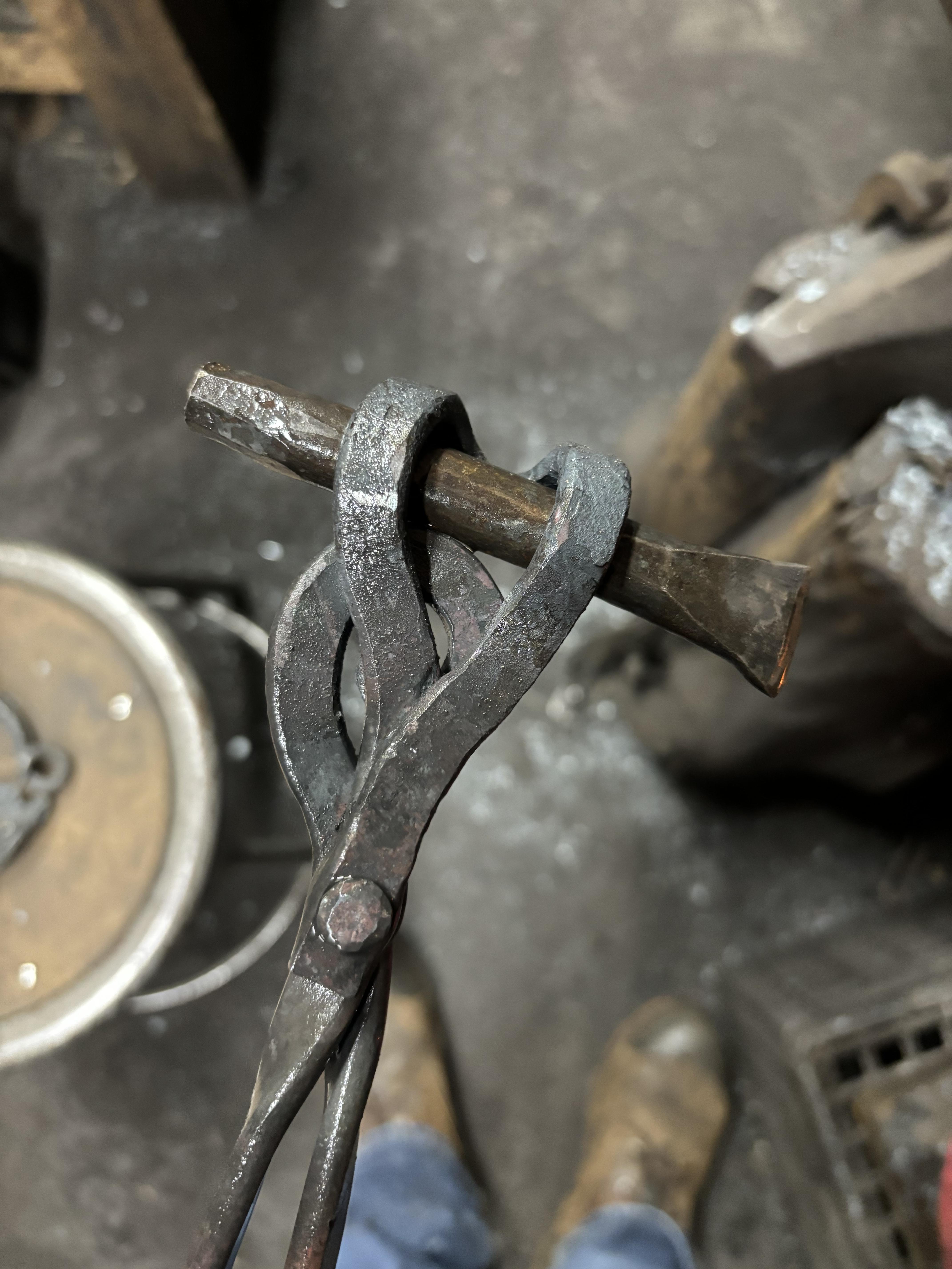

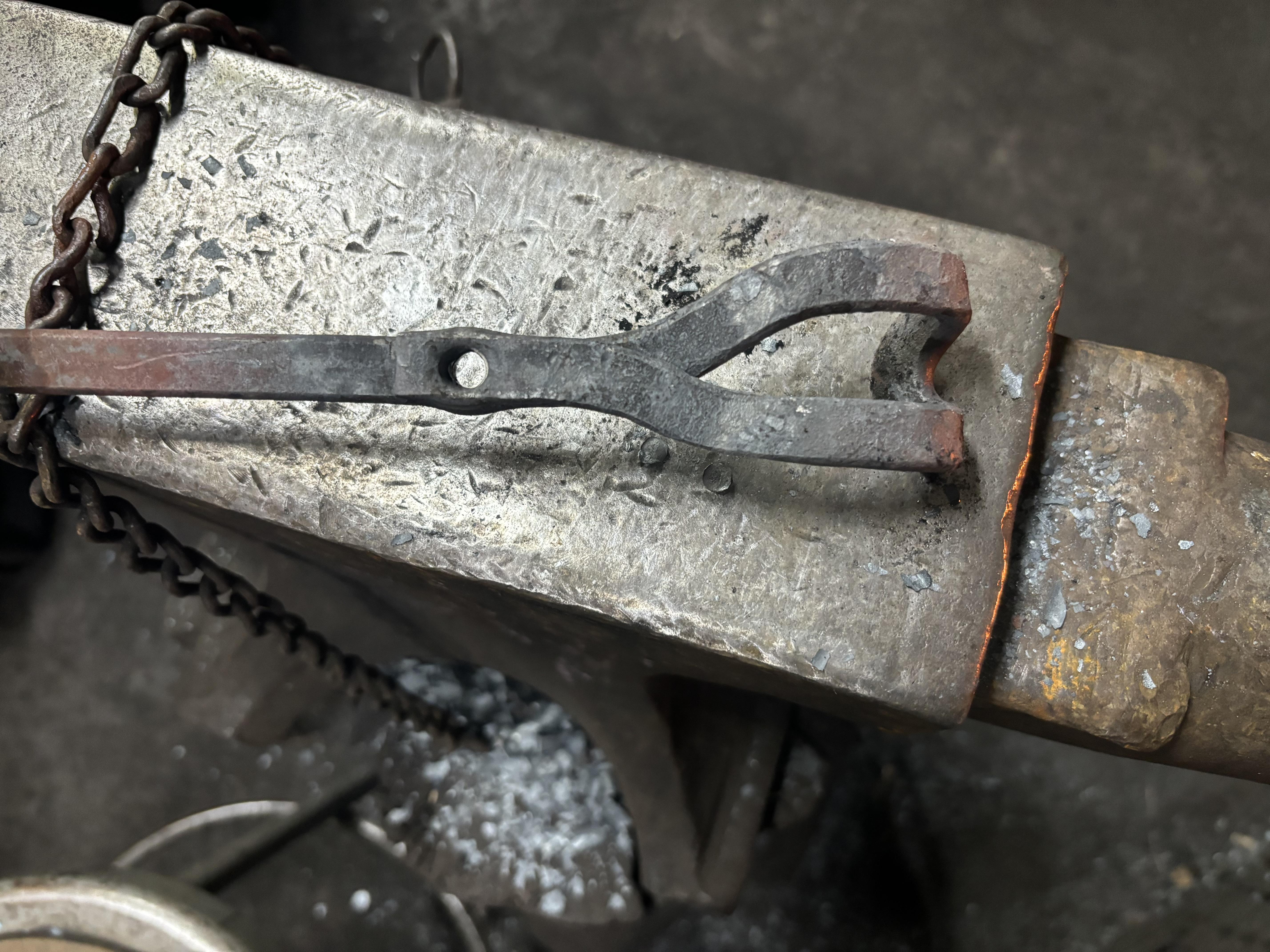

I was supposed to strike for Willow Zeitman’s hammer making class at Prospect Hill Forge in Waltham, MA, but because of a scheduling glitch, only one student showed up. Instead, Willow and I experimented with creating a quick-and-dirty twist-tong version of my cam-lock punch tongs. Here’s the original:
 And here’s the q&d version, made from 1/2” x 1/4” flat bar:
 And here’s the outer jaw, showing how we created the loop by bending the bar the hard way. This was fastened with the same rivet that’s also the pivot for the tongs:
For a proof-of-concept, they worked really, really well. Lots of potential.

Those are interesting tongs. I'm sure you've posted about the original pair before because they look familiar. The original looks like the bottom jaw has more contact with the punch than the q&d version. Does the q&s hold just as well?

Here’s the original post:
Basically, yes. In both versions, the punch contacts the outer V-jaw at four points and the inner cam jaw at one point. That can take a little bit of fiddling to get the alignment off those points just right, but once you have, it’s pretty rock solid.

Have you tried a V for the receiver half? A V should be able to hold a bunch of size punches though the ones made from hex stock might be an issue.
If by “receiver half”, you mean the outer jaw, then Yes, it’s already V-shaped. The problem isn’t fitting a range of sizes into the outer jaw, but that thicker sizes keep the reins from closing enough to hold comfortably.
Outer jaw, okay. I was thinking it wasn't that V shaped but that's what I get looking at a monitor. I wonder how much more eccentric the cam jaw would still be comfortable to use. Hmmm.

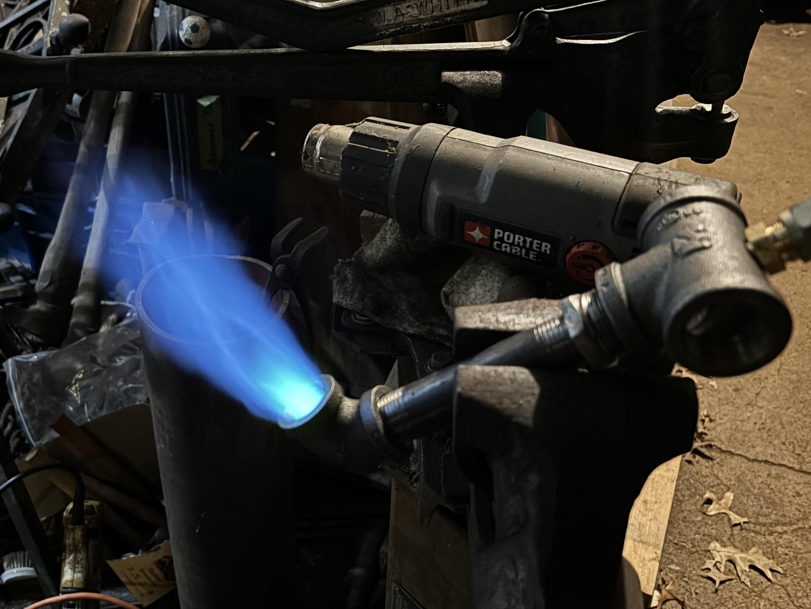

Put together a 1/2” Frosty T-burner, intended for the construction of a small NARB.
With the shop lights off:
