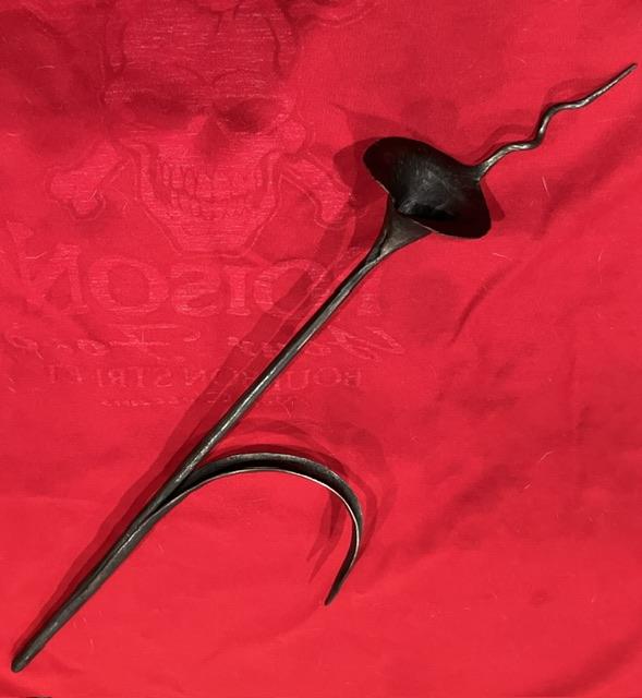

Today I got some time in the forge and forged out a a flower as a gift for a neighbor:IMG_0312.jpeg.4c457134b91961b81c864e0792d06a6e.jpeg

 Goods, that's a good lookin' lilly. ;d

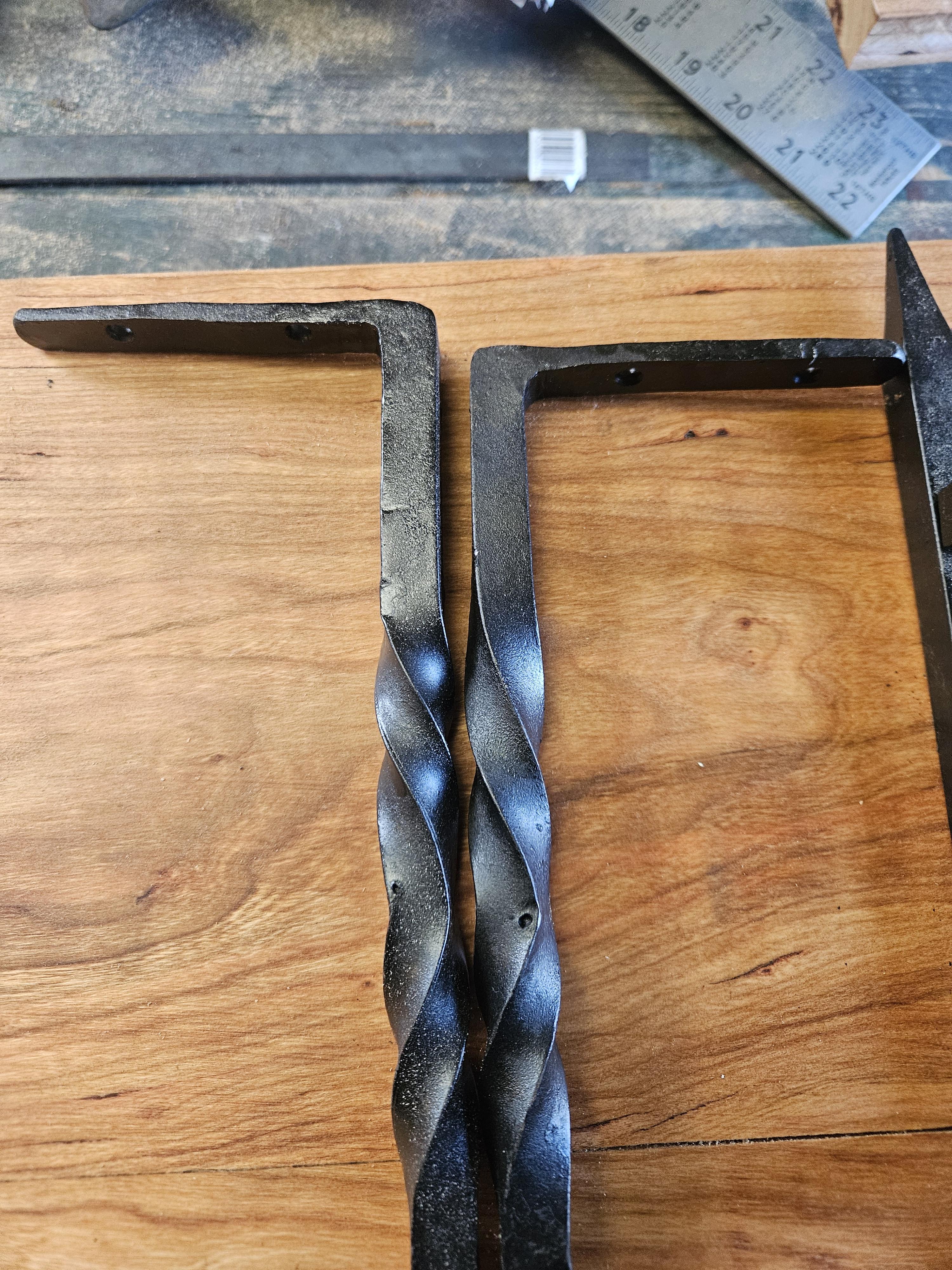

2 of my brackets are 1/2" off. Ended up just redoing all 4. So that sets me one more day behind. I am kind of glad though, i rushed the supports and was not really happy with them from the beginning.
Did get the side supports put on though. The ones i am remaking are going in the enclosed part. 2 will hold up the bottom shelf while the other 2 have a shelf hanging.
Your cabinet project is coming along nicely I'd say Billy. Some time back I decided that "measure twice" wasn't sufficient, so at this point I'm up to "measure thrice, cut once" and some days three ain't enough...in other words, I get how you're feeling about the brackets! I think the extra set of horizontal bars that you have in the middle support are a nice touch.
--Larry
Billy, the technique I use to make multiples like yours is to make them all at the same time sequentially. Cut 4 bars. Draw tapers on one end of each and match them. Draw tapers at the other ends and match them. Twist and match them. Bend one end on all and match them, bend the last end and match them.
Sounds complicated but not nearly as complicated as trying to make them separately and come out matching.
I really like your twists, very fluid and have an organic look to my eye.

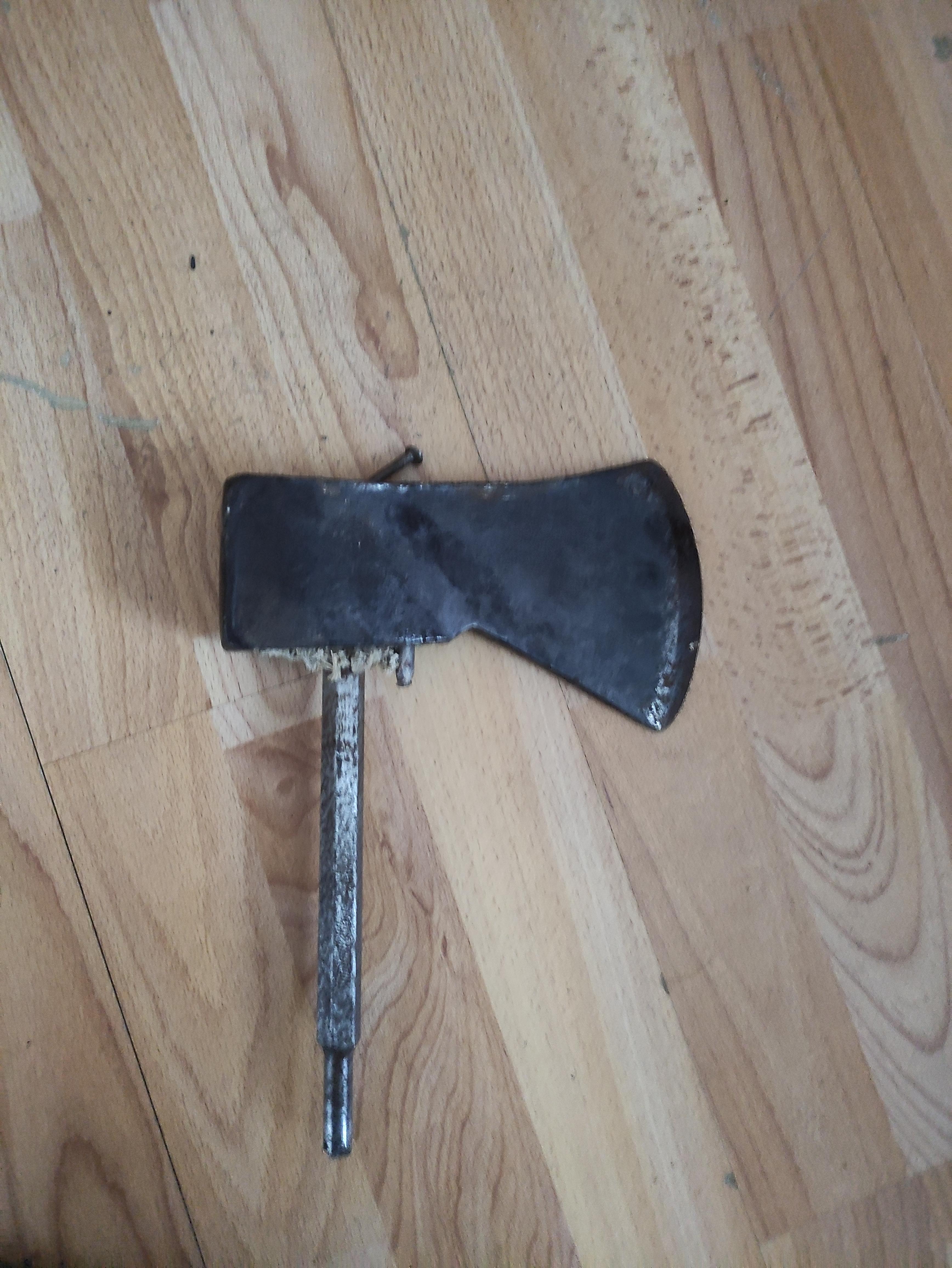

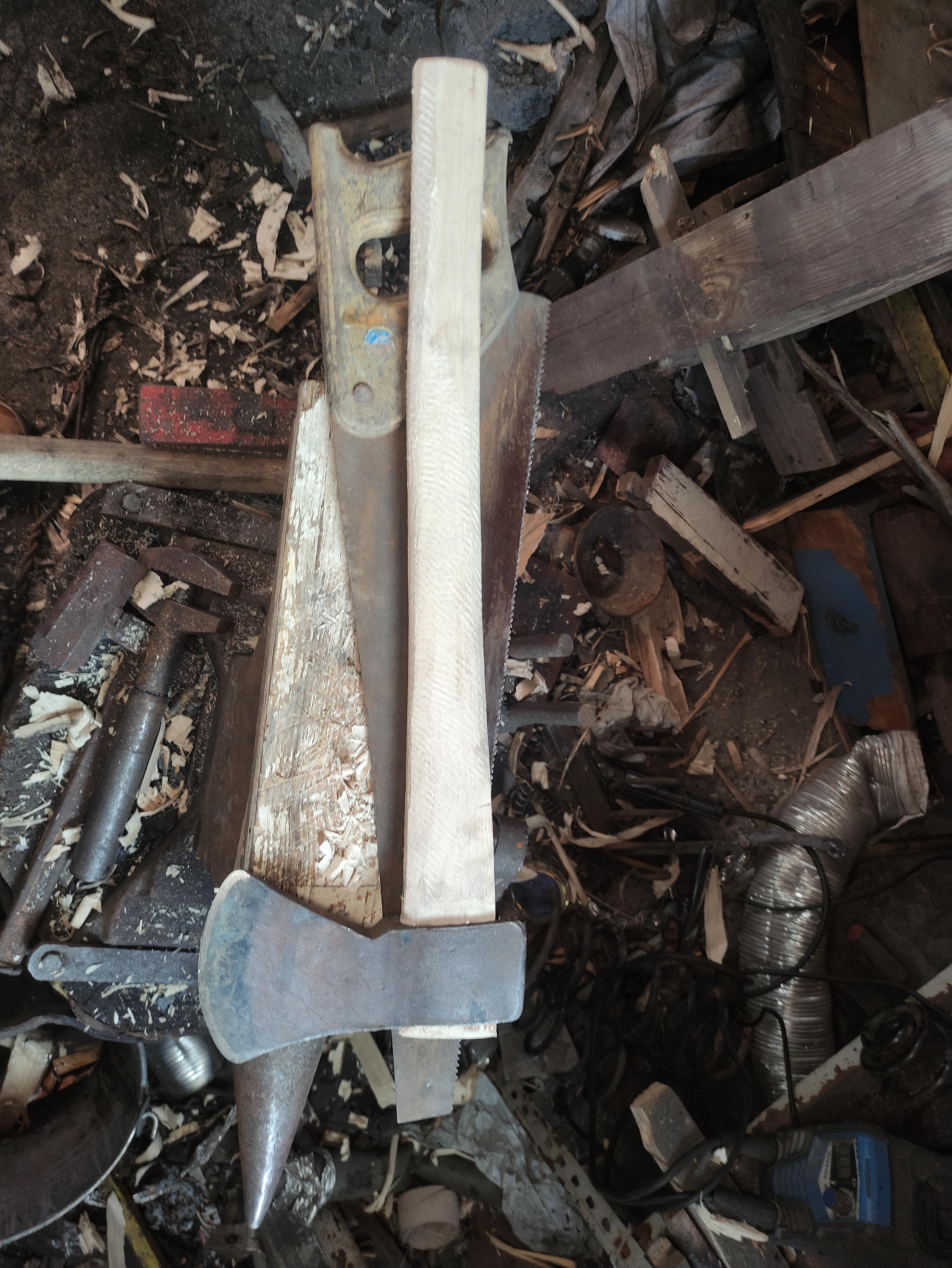

Well made from this  axe with unskilled work that someone tried to use concrete chisel to push out leftover form wooden handle.
First I had to push this out with drill fire (didint used blower maybe a bit, so I don't ruin temper of eye, let it burn ) then I used some chisels to push it out.
I drawn out, heat treated , sharpened and made new axe handle
Frosty, yep that is exactly how i do things as well. Cut my bars, marked them where i wanted set downs and my twists to begin and end. Did all the set downs, then twisted, then upset the corners. I for the life of me can not figure out where i went wrong. With the marking step i mean, obviously i failed to check the length after set downs and bending.
That is provably my favorite way to twist a bar. I find it more aesthetic that just a long twist but is quite subtle that most people do not see it until they pay attention. That one is 1/2 twist, i actually prefer 1/4 twist when i do those. Like i said in an earlier post i think it comes out looking like waves so i call it a water twist.

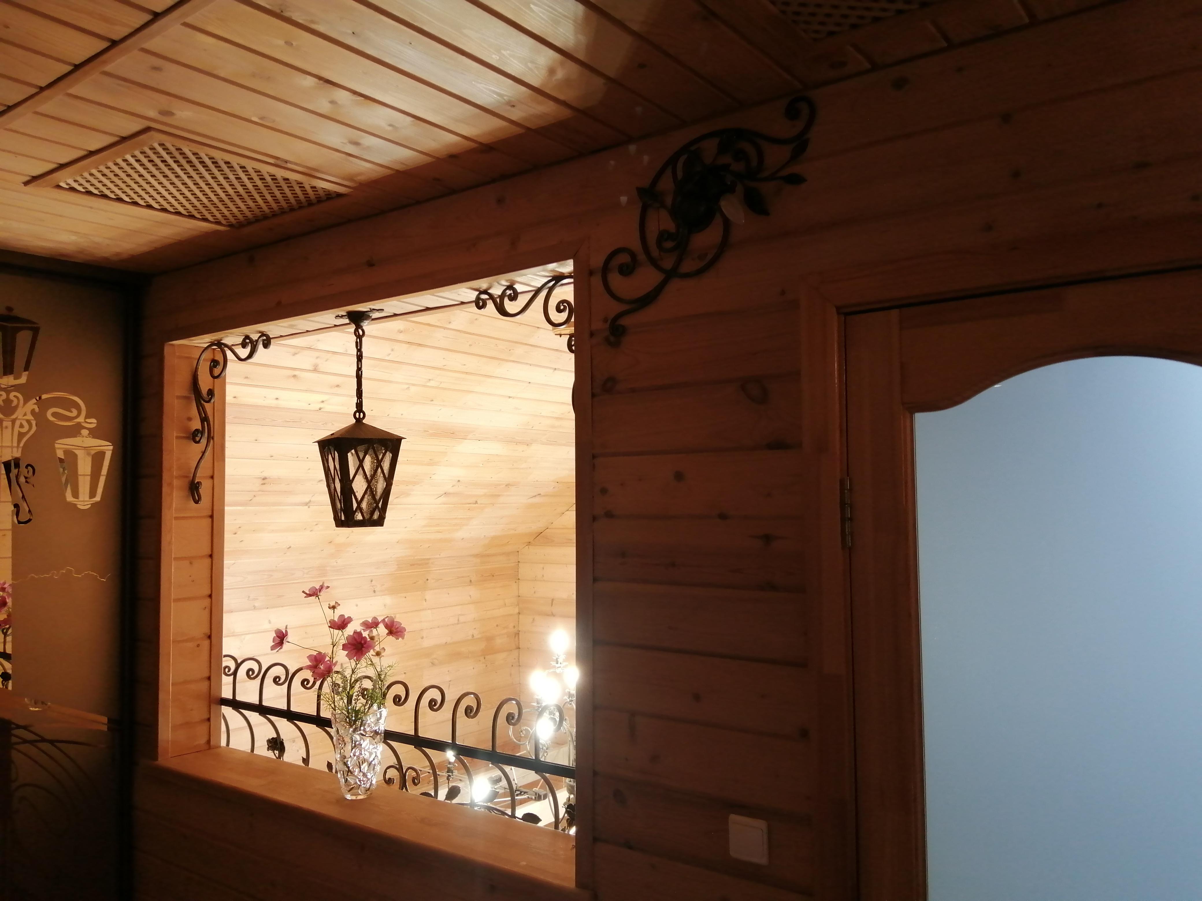

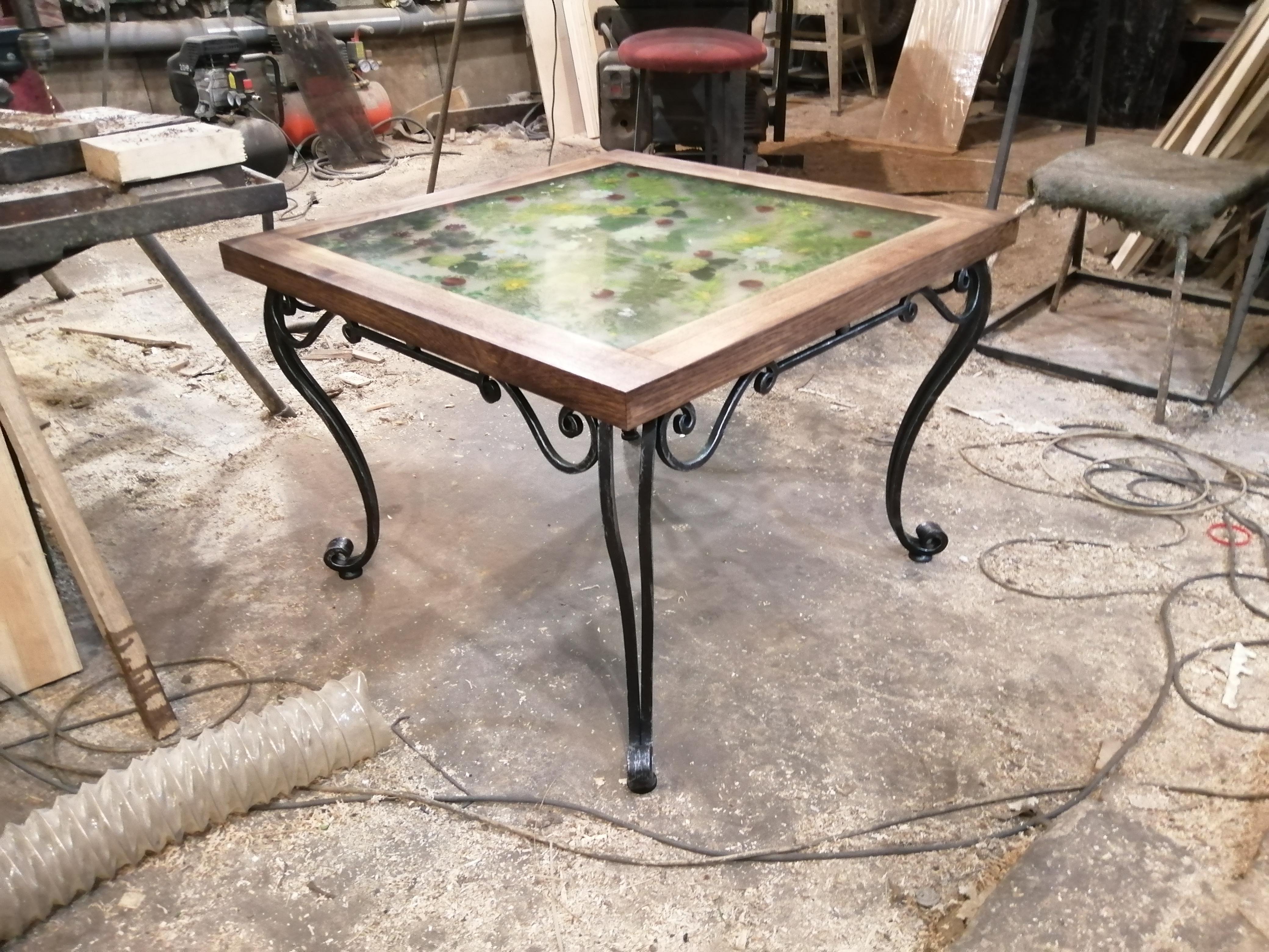

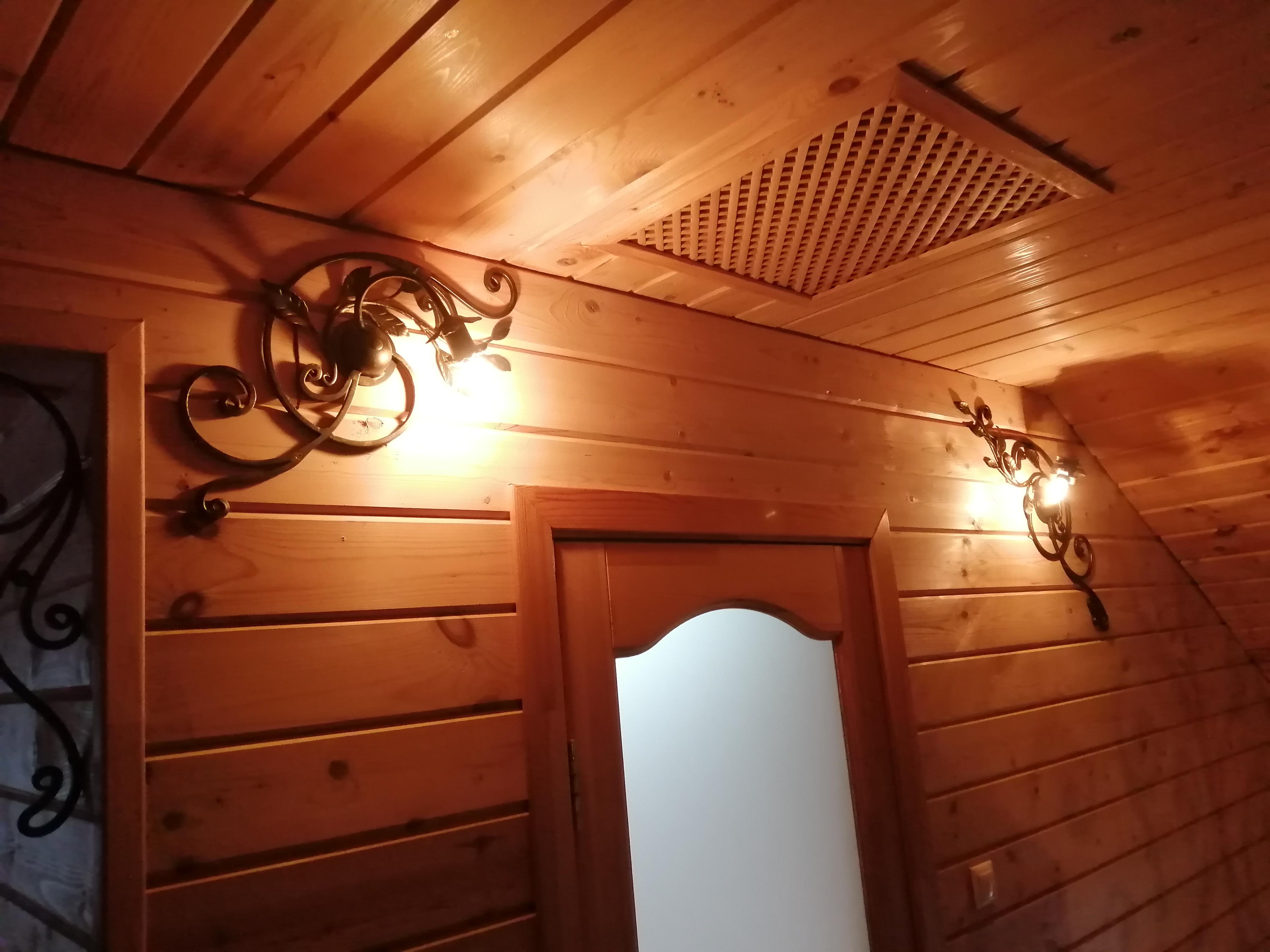

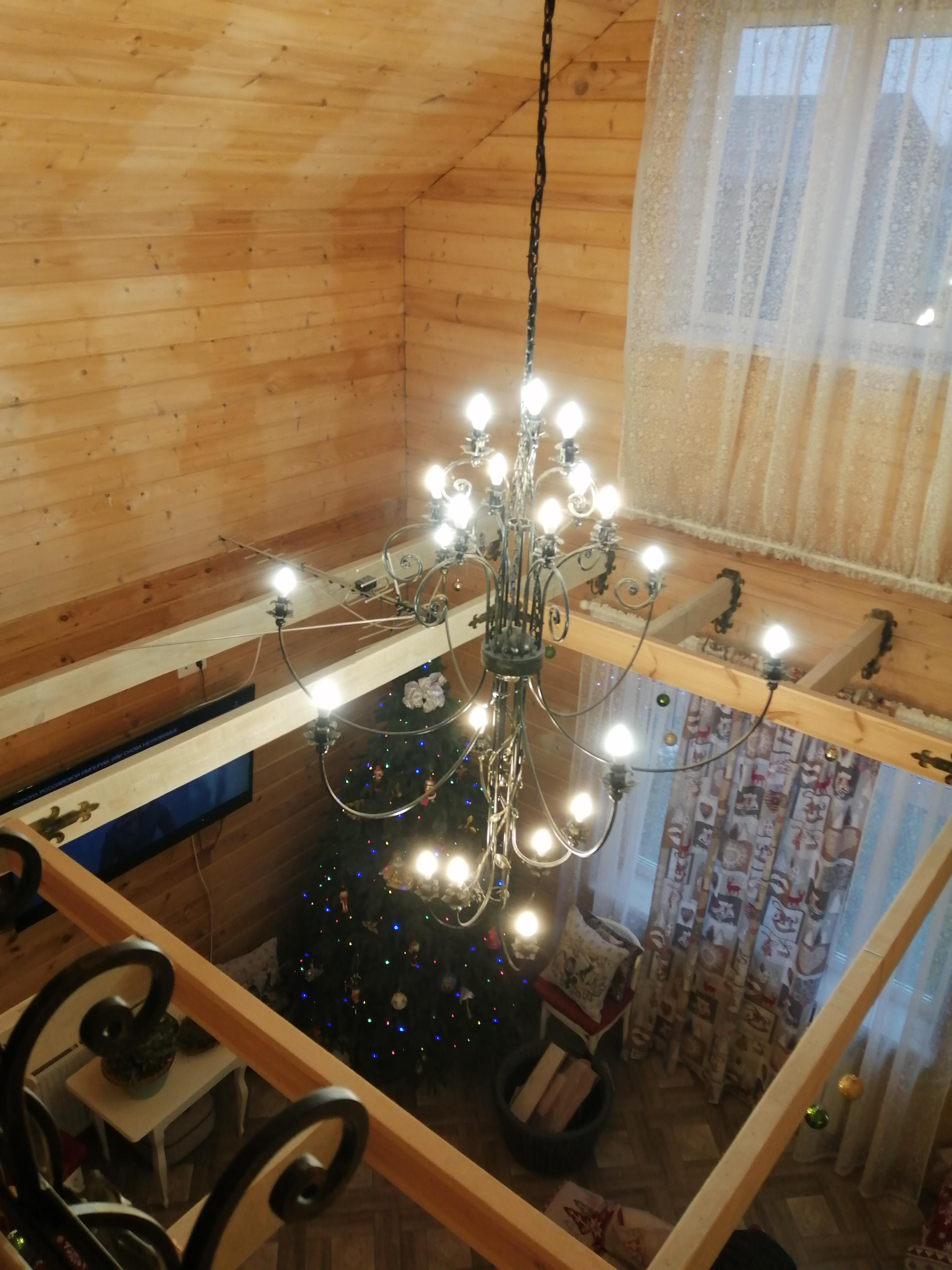

This year is the finish. Completely finished the project. Installed 2 more lamps. The chandelier, lantern, fence were made earlier. Several works from resin are almost ready.
You are amazing with all that you accomplish Alex! Doubtless you have many happy customers. I think you've earned a long winter's nap!
--Larry
That's a fine end to the year Alex. Is This your place? I remember different pieces as you made and installed them, some I don't. As I recall the resin castings were the ends for book cases / shelves and such?
Enjoy your holidays, you more than deserve some time off and fun.

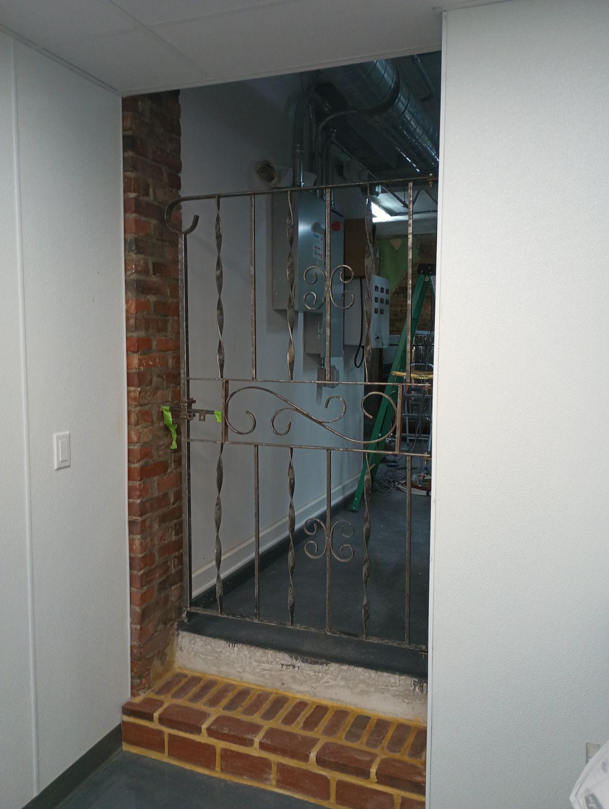

Update: the customer at the brewery sent me a photo of the gate I’d made from pieces of a couple of old railings, shown here installed and awaiting paint. Sometimes a bodged-together piece turns out to be just as good as (and much more affordable than) a purpose-designed custom masterpiece.
Billy, I really like that rope/water twist combo!
John, not bad at all for something "bodged together".

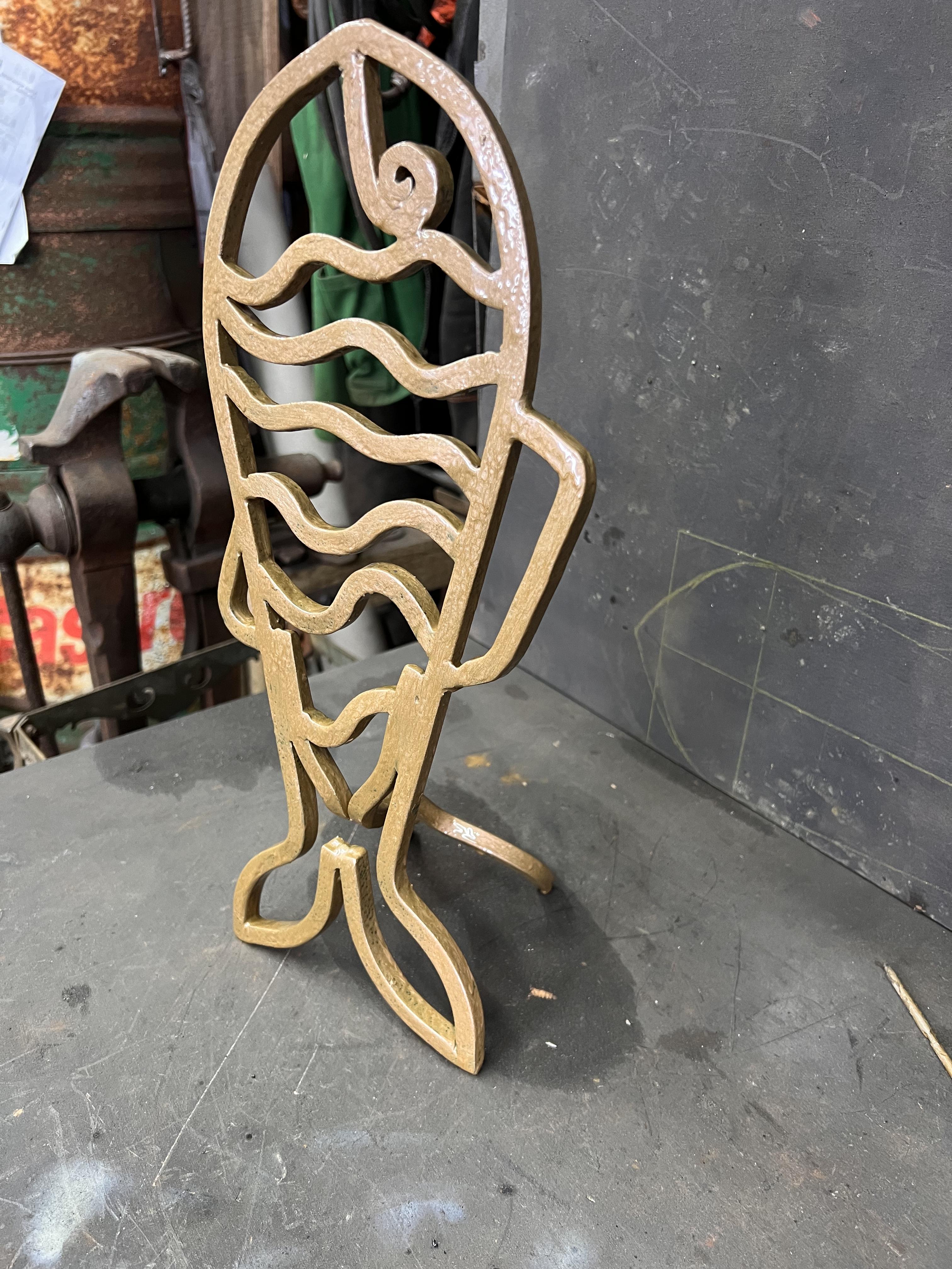

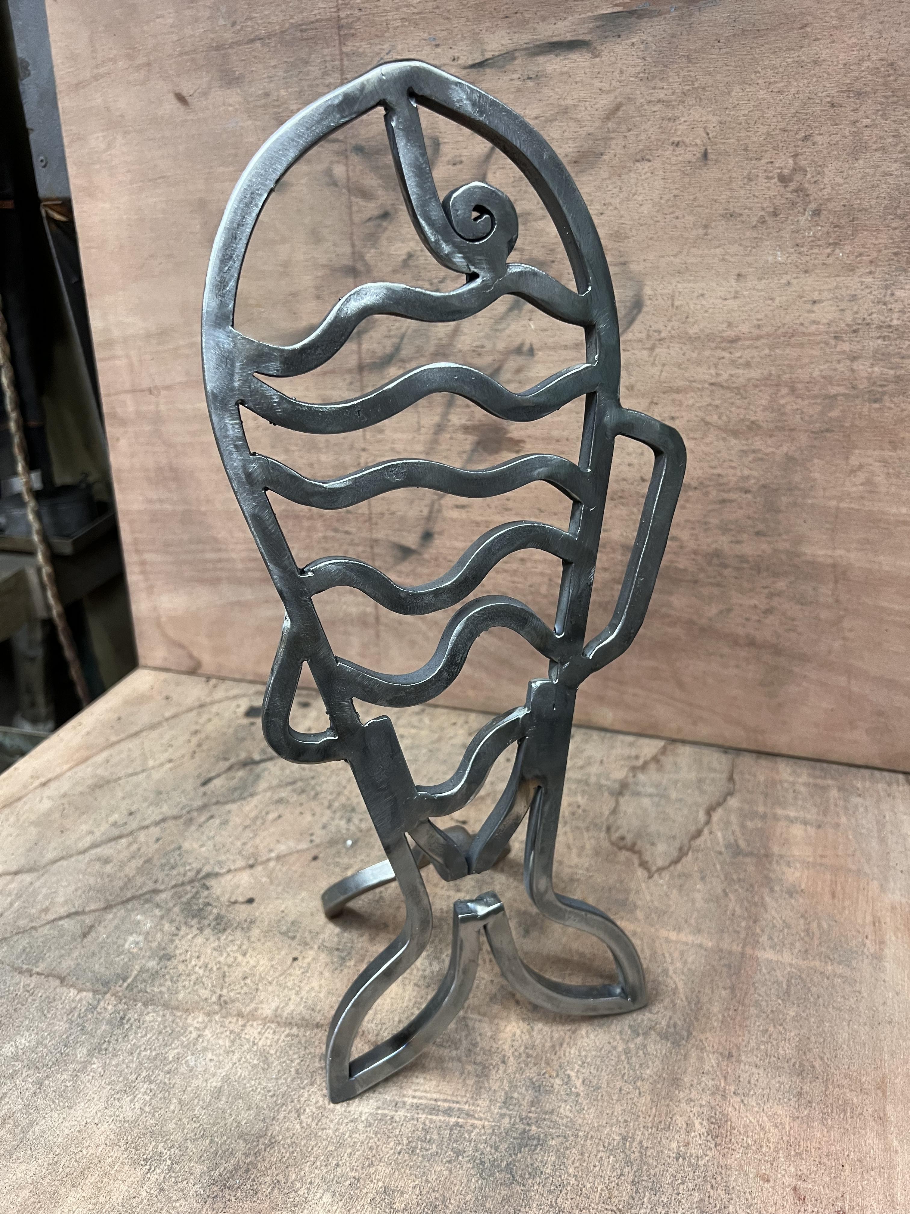

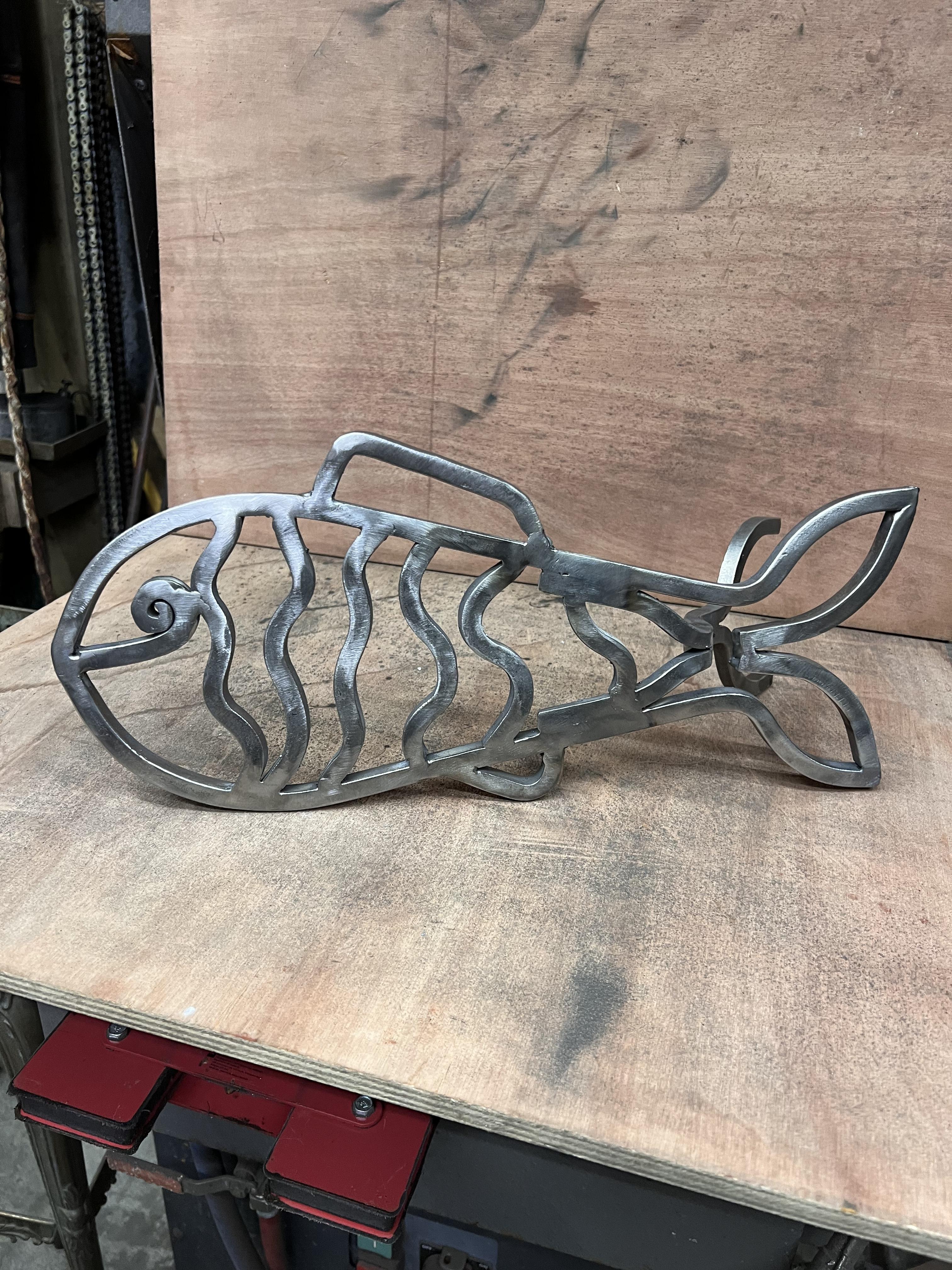

All the best for next year folks!  Looking forward to 2025, this year has not been great.  Back problems and family stuff:wacko:.  I was asked to 'make something' as a gift for an 80 year old farmer who does nothing else but fish in his spare time, so I took the advice from here on boot jacks.  10mm square bar (harvested from wonky animal head pokers). So, it needed to work, needed to look 'OK' by the door in the porch and easy to put out of the way, and comfortable for feet in socks for the second 'pull off'.  It can stand on its side or tail, the dorsal fin is a handy handle and I got to cover my welds with paint.

JHCC, the gate looks nice.
