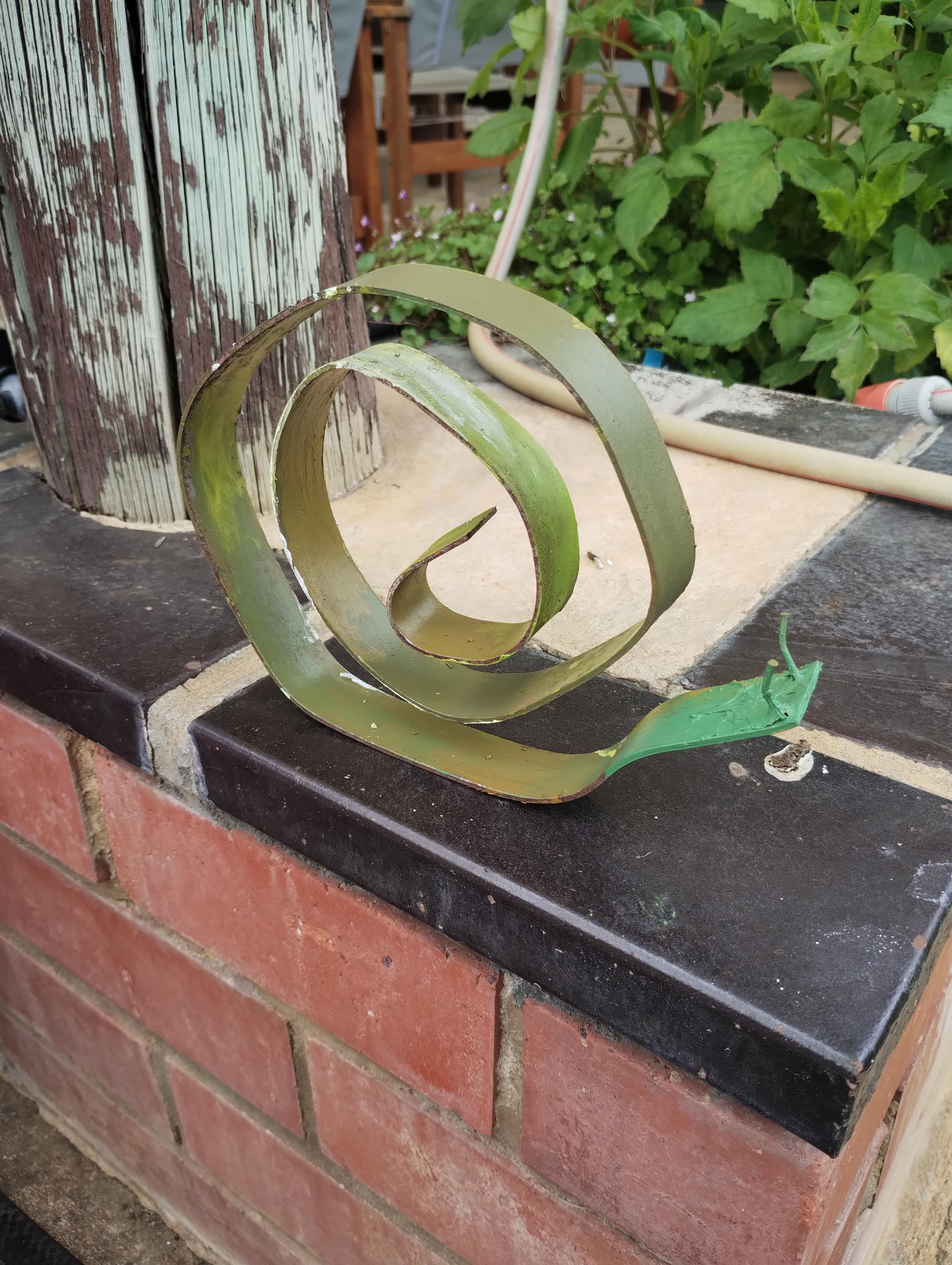

We just moved into a new to us house and my 9yr old daughter went straight to the shed and found some wire and made the outline of a snail. She then asked what else can I make a snail out of?
I found some light flat stock, put 2 bits of round bar in the vice and said you can use that to make the bends. I showed her once and left her to it.
I was so happy to see what she made. We then center punched 2 holes and glued in some nails for eyes and then she painted it.
She is very artistic and I am so glad she is showing an interest in metal work. I am only starting to set my shed up and have a gas forge on order so will be able to make a lot of cool things with her.
My 6yr old had a go as well so may need a bigger shed!

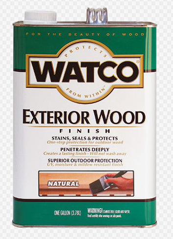

20 hours ago, BillyBones said:
Alexandr, I am not sure what you mean by wood oil, is that linseed oil or something similar?
HI ! For the street I use teak oil. Usually from this manufacturer. For furniture I use oil with wax, it is well sanded and polished.

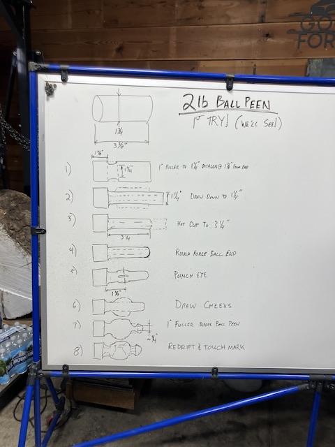

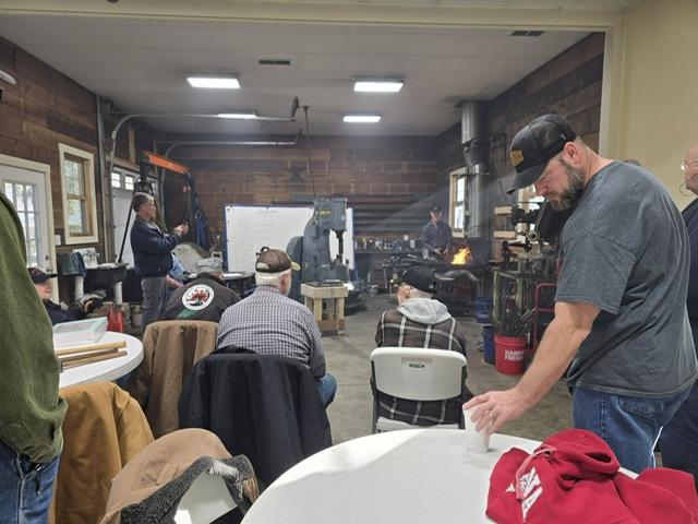

The hammer-in at my shop went pretty well yesterday. Not a big group, with the IBA state hammer-in taking place on the same day, but we all had a good time. My demonstration was a first try at making a 2lbs ball peen. It didn’t turn out quite to my liking, but let’s me know what to change up in the process. Just so happens that things are working out that the January hammer-in will be at my shop again and everyone wants to see attempt number at the ball peen.
IMG_0285.jpeg.e3348c7cd8e3d6b613ce50a473497f8f.jpeg2847078989949530168.jpeg.b0d6400abe7bb1817f771500a735895c.jpegIMG_6148.jpeg.6fc98e7174a0e8ab78487dd49607ca18.jpegIMG_6158.jpeg.086b0ed95dff1c26fcd090ae378e5d57.jpegIMG_6163.jpeg.16ac15fb065bd0e95753fe46bcc7cbe0.jpegIMG_6170.jpeg.0136ed9c4a340b31009c264365a45bcb.jpegIMG_6184.jpeg.d1f42d9f693a3349b5916ef7ad94c0d7.jpeg
This hammer-in had a very different feel. I was the only member to swing a hammer. Usually, a bunch of different smiths are forging. It may have been from me setting up a more formal demonstration. Either way it was a good day!

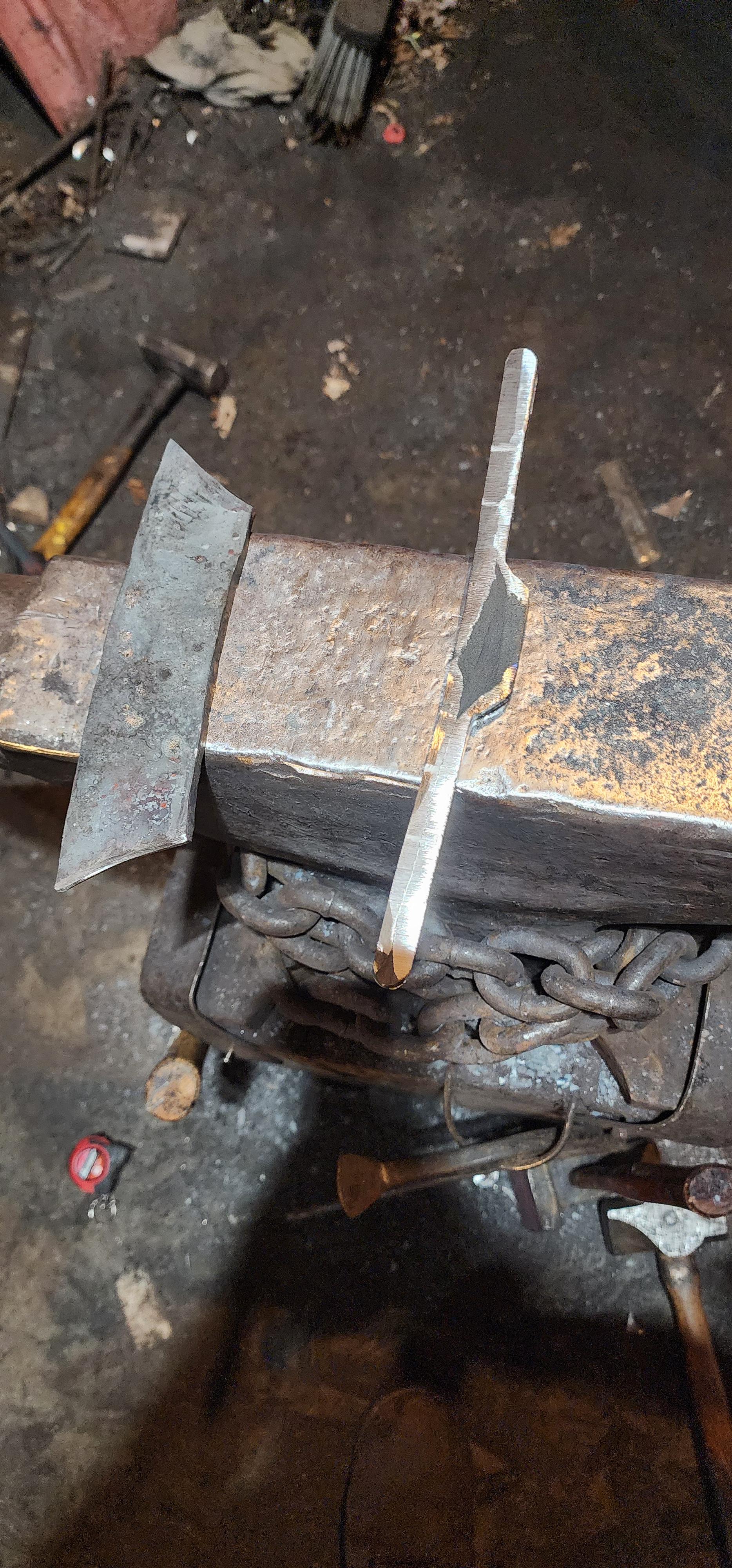

Anyway I have in the past made a skeleton key bottle opener using half inch round but was never happy with how it would finish up.   Yesterday I started with 1 x 1/8 flat stock and had much better success.  I also was working down my 33 later damascus billet, I need a power hammer , and got it to where I want to for the ax bit for my zombie killer pole ax project.  If been playing with designs and realized it needs to really look past apocalyptic.  I've modified my original design to have a skeletonized ax and hammer forge welded onto the central blade that is going to be based off a falchion.  I'll get a drawing up later today.   I got the frame forged out for the ax as well.  The body is going to be wrought.  Just practicing my sockets to get that ready.   Also last week forge welded on a but to my first chisel attempt.
Good job. It's great she is interested in metal art. Might want to put a date and her name on the bottom so years down the road she can remember when she started.

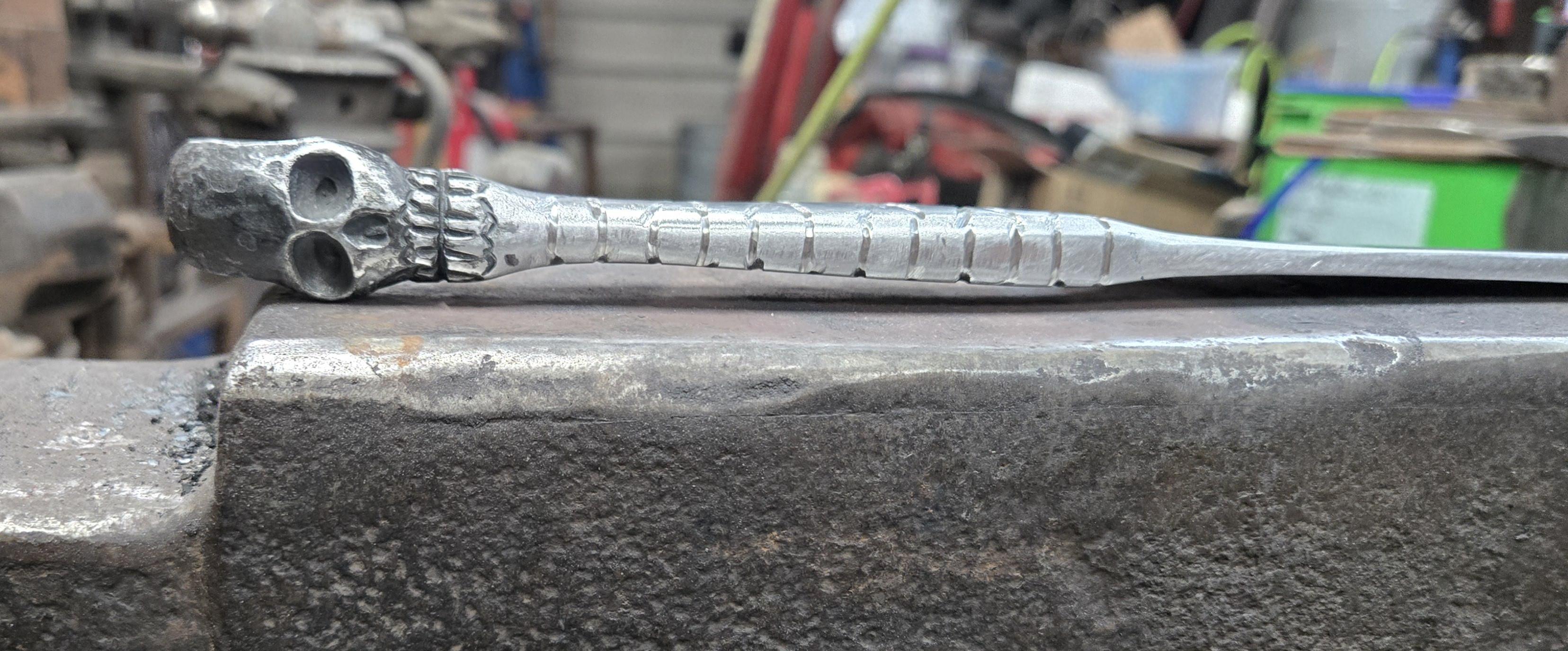

Ive been mostly busy with other stuff but I had a secret santa gift to make for our production manager/friend. He liked something I made last year with a forged skull and I've been wanting to try to make one as the pommel of a knife.
I planned on a small knife but it got a bit big as I was really rushing it and it got away from me. It's nowhere near what I planned but I needed to just get it done so every little mistake turned into a design change.
Least the pommel idea worked great and he really likes it as it is. One more evening and I could have gave it a much more finished look.

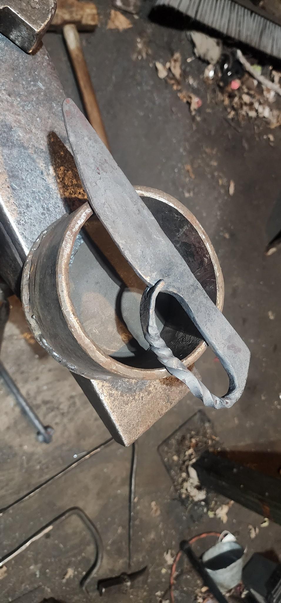

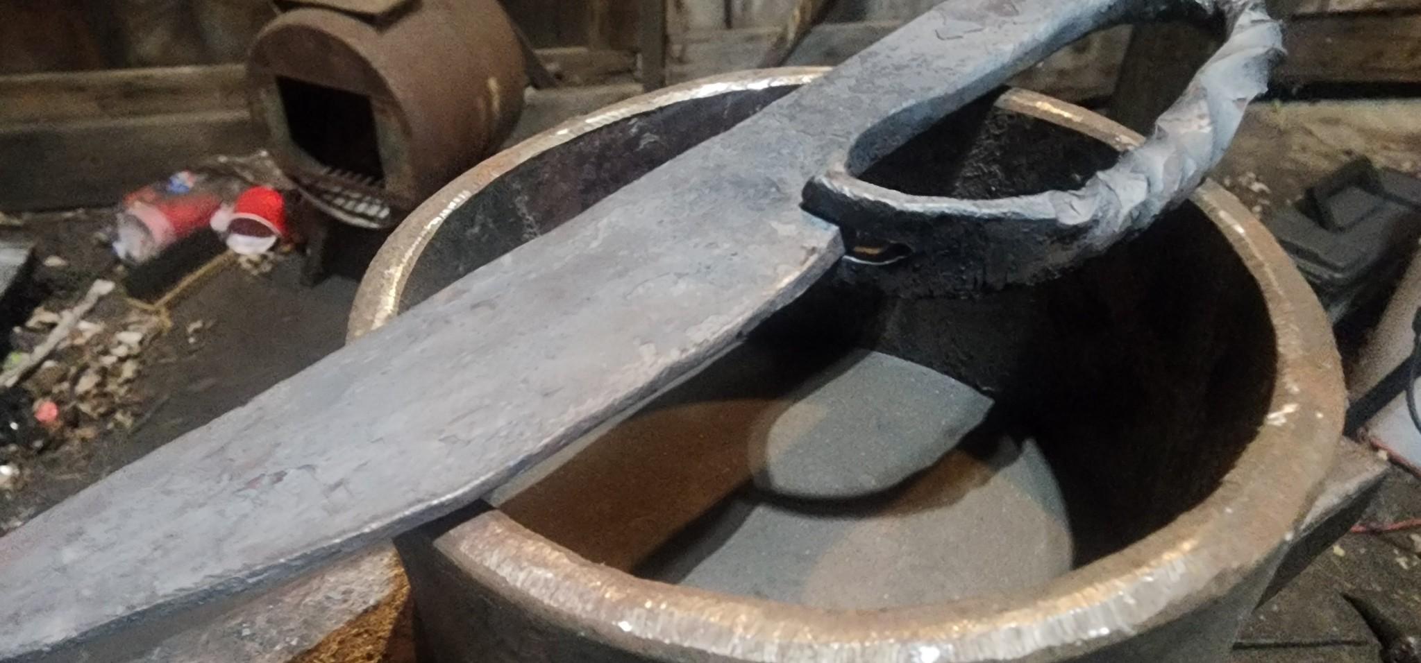

Started out planning on a blacksmith knife but that changed suddenly.  I have a little filling to do to get the guard in place properly.

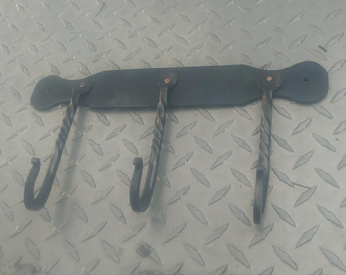

No horses to shoe today so I locked myself in the shop. Productive day, got a 3-hook coat-rack forged (Christmas gift) then moved over to the TIG station and fixed the shoeing box that a crazed Thoroughbred kicked across the barn; then over to the South Bend lathe and started turning a brass range rod for a caplock. Good de-stress day! Matt.1219241115-1.thumb.jpg.021a3fc784ba4e69d3e0adc94fc5fbc2.jpg1219241627a-1.thumb.jpg.4baa47264c9f6c8786702acc95b46374.jpg
Hickory, I have found that on coat racks to give a fish tail finial is much more desirable. It does not poke the fabric. On the hook end not the riveted end just to clarify.
Nice work though, simple and elegant in my opinion.
Are the rivets copper? They look like it in the photo to me.
Billybones - good thought. Yes, the rivets are just copper slating nails. We use then for riveting pads to horseshoes all the time.
Matt.
I didn't mention the hook ends because those are about minimum width unless you hang heavy clothes. Copper looks good on iron and is also a good choice for the screws you use to hang it on the wall. Yeah, I think all of us who have been doing this stuff for a while know copper plated hardware is hard to find and expensive.
However there is an old technique and I mean OLD. Bring the part to a dull red and brush it vigorously with preferably a stainless steel brush and then brush it with a copper or brass brush which will deposit copper or brass on the hardware.
Be gentle screwing it into the wall, they have a coat of copper, brass, bronze, etc. about like electroplating. OR of course you can just electroplate your hardware, it's easy but takes time and worse you don't get to play with fire doing it. :ph34r:

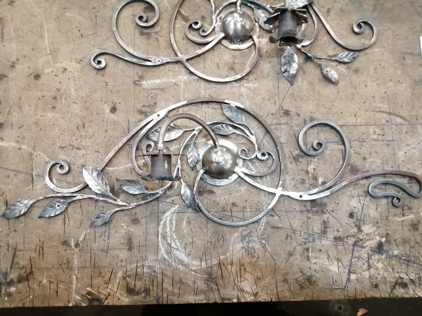

Pre-New Year rally. Lots of work to be completed before the end of the year.

Good to see you posting Alex. When do you not have lots of work to complete?
BIG clock and ornate wall sconces. Beautiful as always.
