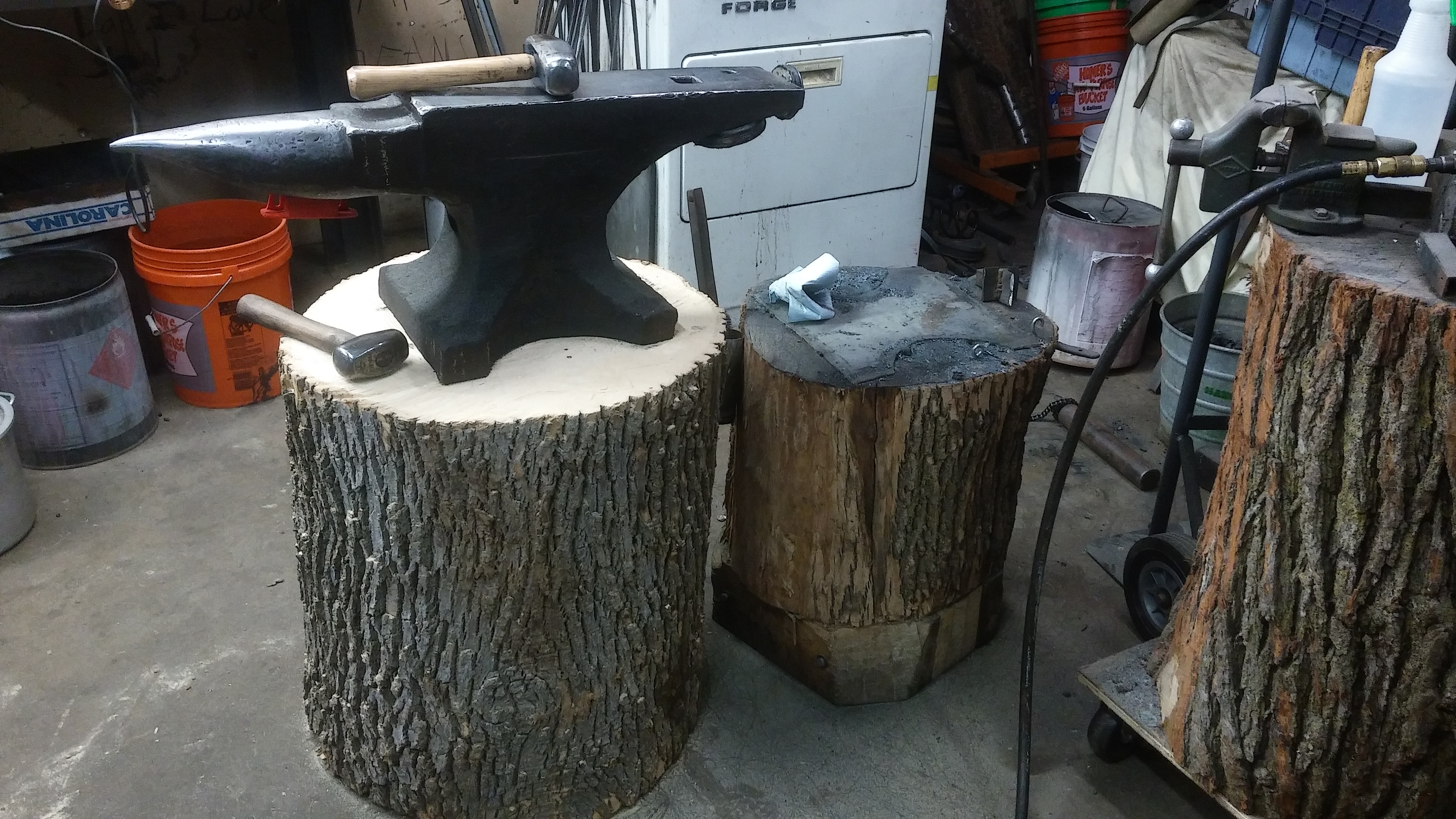

Here's mine, a black oak stump under my 104 lb Peter Wright. Bark drawknifed off, recess for the anvil routed in the top.  I routed 3 "feet" on the bottom so its a sort of tripod. Anvilstand3.thumb.jpg.0f80041db63b28f6d6Anvilstand2.thumb.JPG.1e3f8e7aa79d3d712d
rings for hammers, a rack in front for the tongs in use.  Bike chain stapled to the front with a weight on the other end as a hold down.

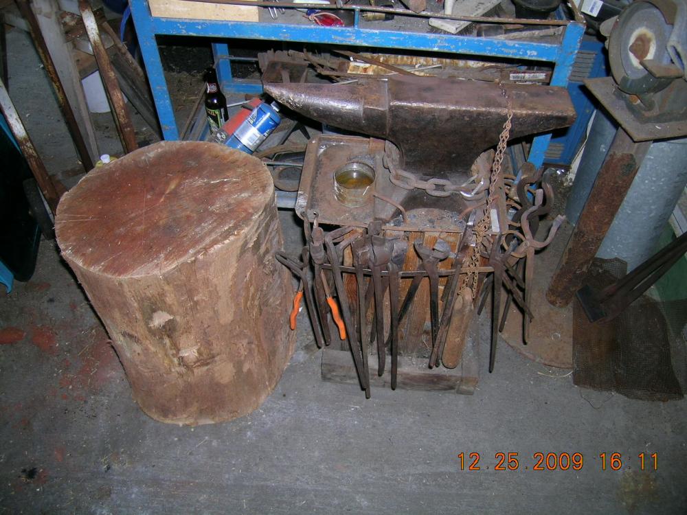

 the stand before that, 2x10's held together with all thread, the boards staggered to make pockets for hardy tools and tong. Anvilstand1.thumb.JPG.67bedd208e6e563957Ended up putting a cookie sheet from the Goodwill under the anvil as a tray, just drove the anvil staples thru the sheet metal, that was useful. Swage block is on that stand now.

Michael another classic stand. I really like the cookie sheet on the "old" stand. My wife brought one out to the shop just the other day, sounded like she wasn't planning on making any more cookies on it!  A tray with a raised edge on it always works well for tools. I have made sure for several years that any punch, chisel, ect. has a flat on it to keep them from rolling onto the floor, that way I don't have to bend over and pick them up!!  I have also used a window weight as a hold down for a long time.

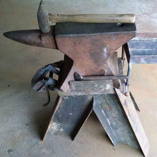

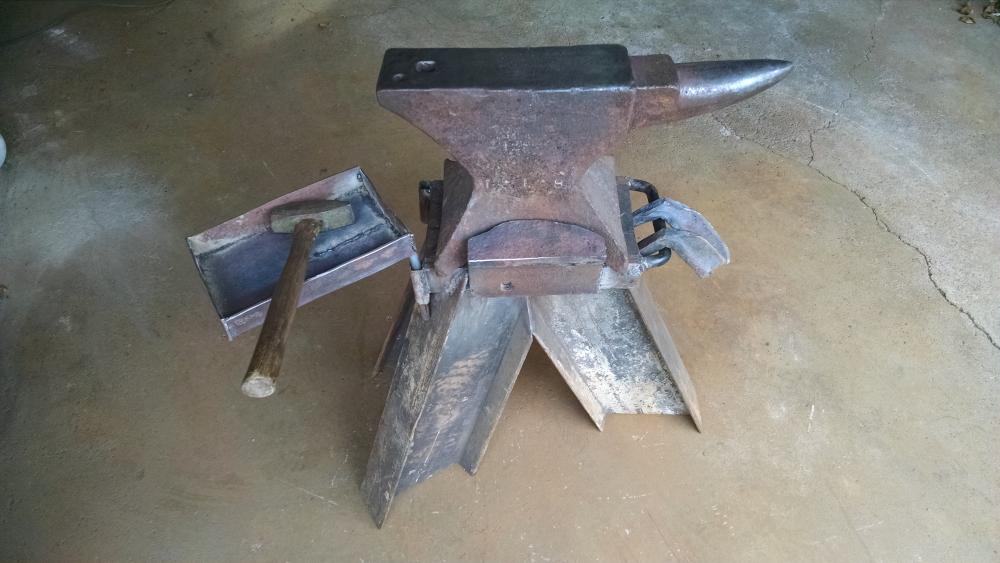

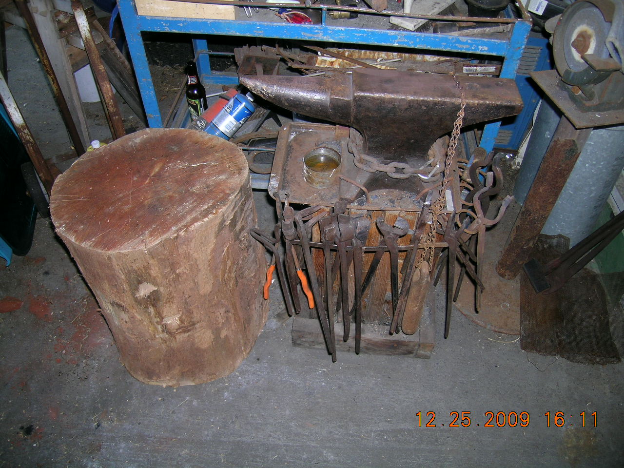

Well I realized I never posted mine  the wood stand is due for a new stand  I'm thinking a 3 leg stand,  but this is what I got and what I work on.

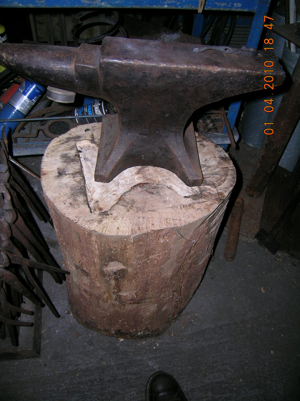

I am using the traditional tree stump. I had to fell a butternut anyway so I cut a piece of it with oversize length. I started by turning the future downside upwards and wedged it until the stump was true upright. I then used a spirit level to mark for horizontal cutting (still oversize). Cut it with a chainsaw and made it very slightly convex. Turned it right on a flat surface (checked that it was a true upright - it was) measured correct height all around plus about 2 cm. Cut after the mark with the chainsaw. Smoothed the surface with a rotary plane. After planing it was about 1 cm too high. Put the anvil on it in a proper position and marked the footprint. Removed the anvil and cut down after the mark with a router to right height - again very slightly dished so the anvil cannot rock. I am very happy with the result. My 250 pound anvil stands perfectly and needs no hold down. A two horn North Swedish anvil is fairly silent in spite of being cast steel.
The reason for the somewhat elaborte way of doing it is that the stump was far from a perfect cylinder. A carpenter's square was useless. There is a pic somewhere in the show your anvil thread.

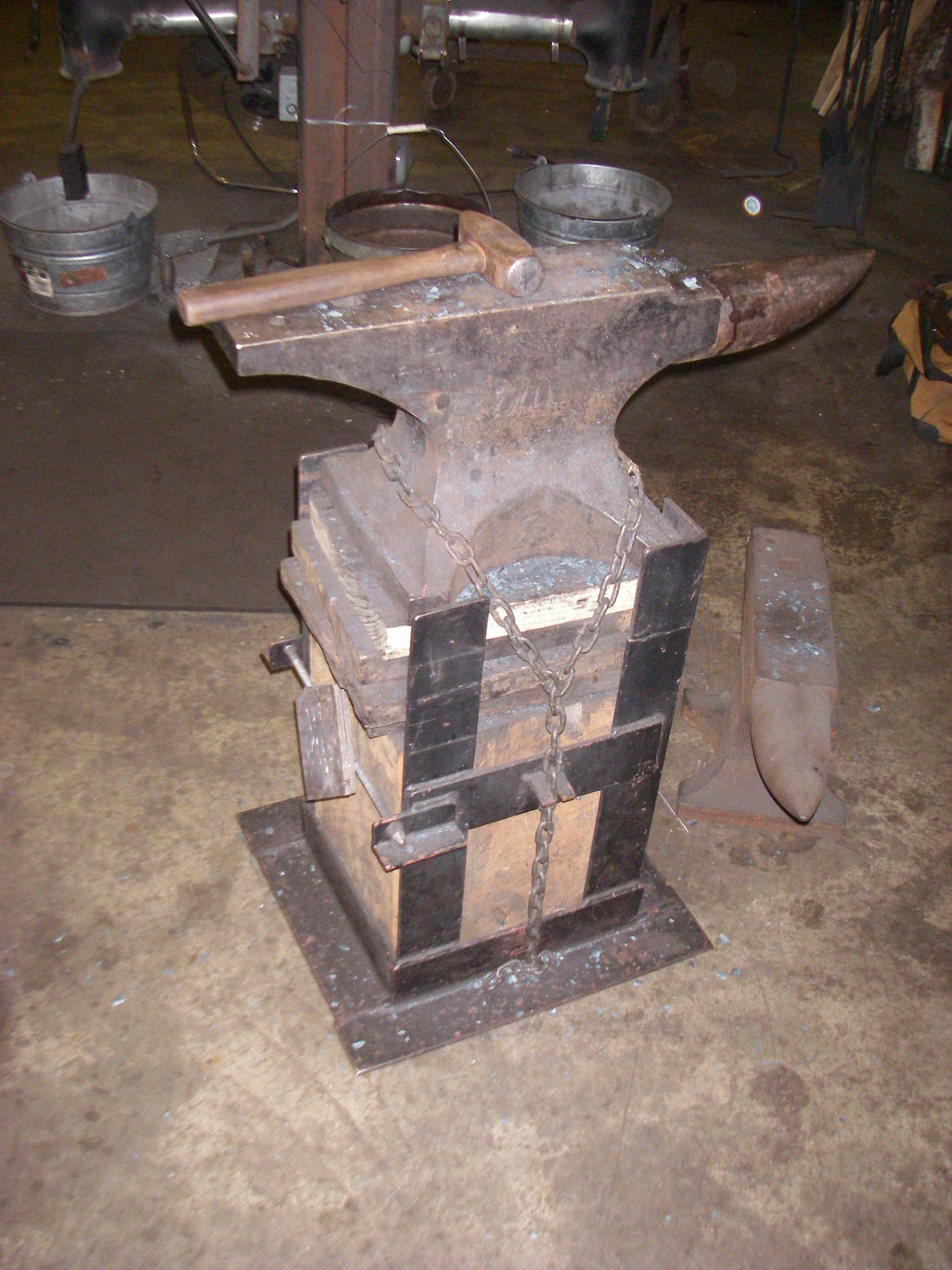

This is one of the adjustable stands at the John C. Campbell Folk School. My legs did not really care for the sharp corners left on the structural angle elements, but quite serviceable design. There is a turnbuckle on the other side to tension the chain.

What's the purpose of the threaded rod on the left and how do you adjust the height?

This stacking design has been around for a long time. It will help a person adjust to the height that serves them best.
Then they usually make it more permanent.
Some will use sand. The blacksmith will adjust to what ever configuration his tools and equipment will allow.

Mm ... so ... what is adjustable? The tension on the chain?
You will have to lift the anvil, slide a board or take one off and put the anvil back on. Nee ... try that with a 200k anvil.
I am thinking in an adjustable stand as in ... well ... adjustable. :)
Something were you pump a lever of turn a handle and the anvil comes up or down as by magic ... ha ha.
3 large bolts one at each leg would probably be a good compromise, say 2" bolt or similar that you can turn with a spanner.
I like the idea of 3 car jack only because they take a ton or two, so some severe whacking on the anvil will surely be ok on the jacks' thread.
PS
Ted, I did not read your post before posting mine ... so ... sand, boards stacking ... not adjustable in my books, that is more like repositioning the anvil with a lot of effort and some risk to one's toes. I like adjustable like the dentist chair. :)
Marc1, I think the idea is that a school with a rotating body of students (each with their own height and proportions) will want to reset their anvils periodically, at the arrival of each new group. Not an easy thing, but not to be done with any frequency.
Yep, that makes sense for a school.
Mine was just one of those ideas ... rather than occupying permanently prime real estate with multiple anvils, I would prefer to make a variable height stand that does not require to lift the anvil.
Actually not that hard at all come to think of it ... :)

Were I to make such a stand, I think I'd make a tripod of heavy jackscrews with locking nuts. That way, you just tilt the anvil on two legs while you adjust the third, repeating until all three legs are at the height you want. You'd never have to lift the entire weight all at once.

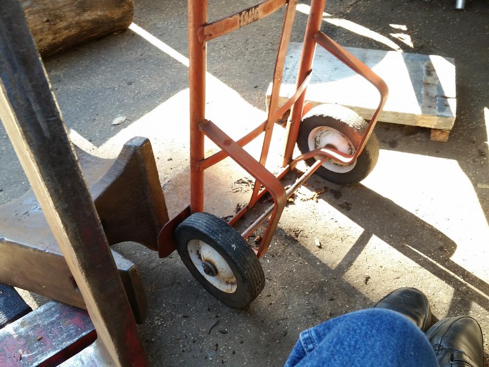

Lifting an anvil is what they make cherry pickers for!  I have my large anvils set up for *me*!  Students get the 93-165# ones that can be easily lifted and moved to a better fitting stand for them---if there isn't an anvil already on such a stand; then they have to move the stand in place and then the anvil in place.  Shop rule:  Never pick up an anvil until you have a place to set it down ready!  Also: *NEVER* set an anvil on the ground!    (bad for the back to pick one up off the ground...)
Scaffold jack, of course! ... a bit of an overkill and a piti to butcher it but those will certainly work. :)
Cherry picker ... wow Thomas, a cherry picker wouldn't fit in my little shop, not even a forklift and I stopped selling bobcats so can't even borrow one of them. Nee ... still thinking about it and considering I'll probably adjust it only occasionally, don't need it motorised. Screw action seems good enough. No lifting? I agree!
