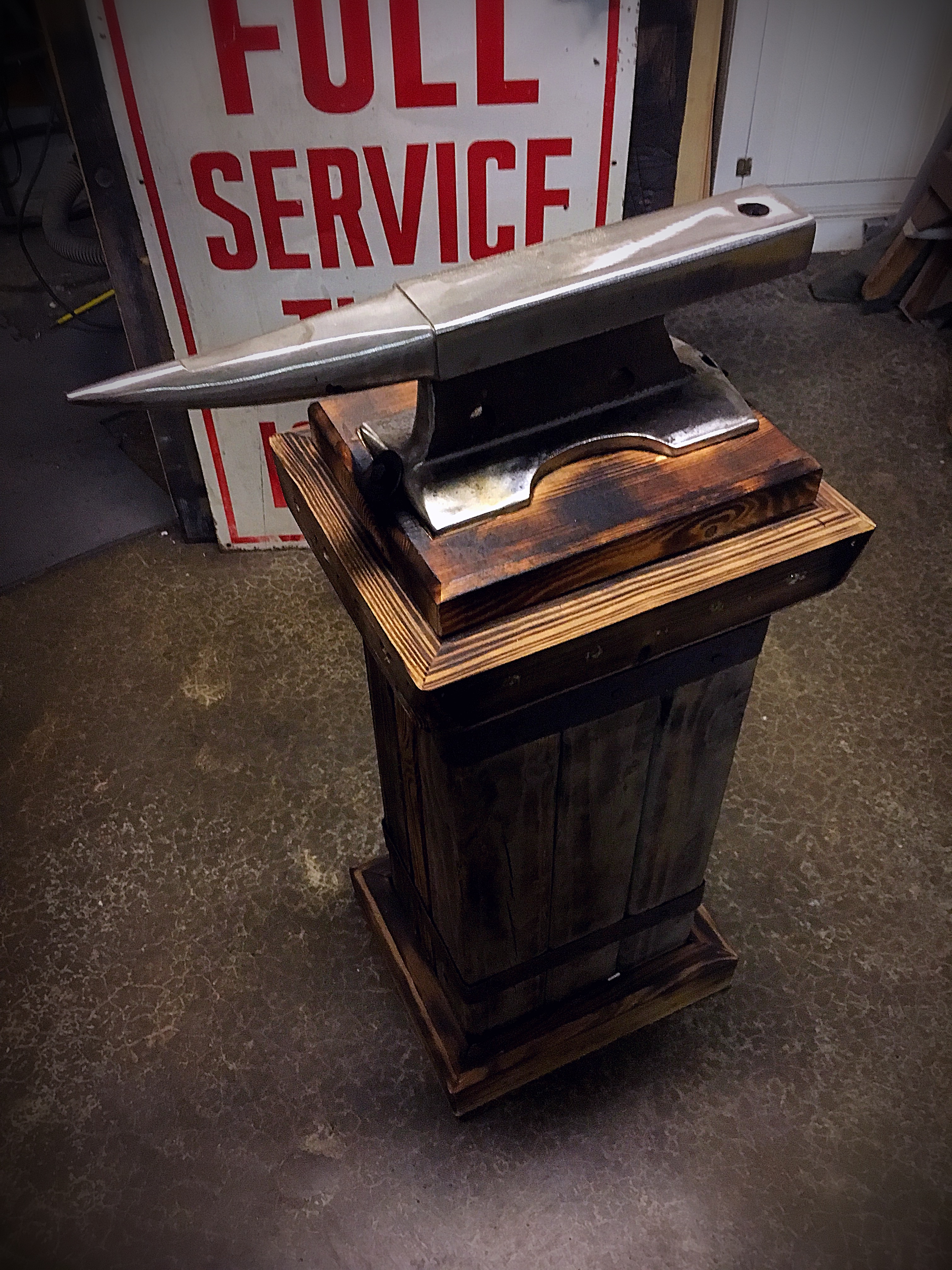

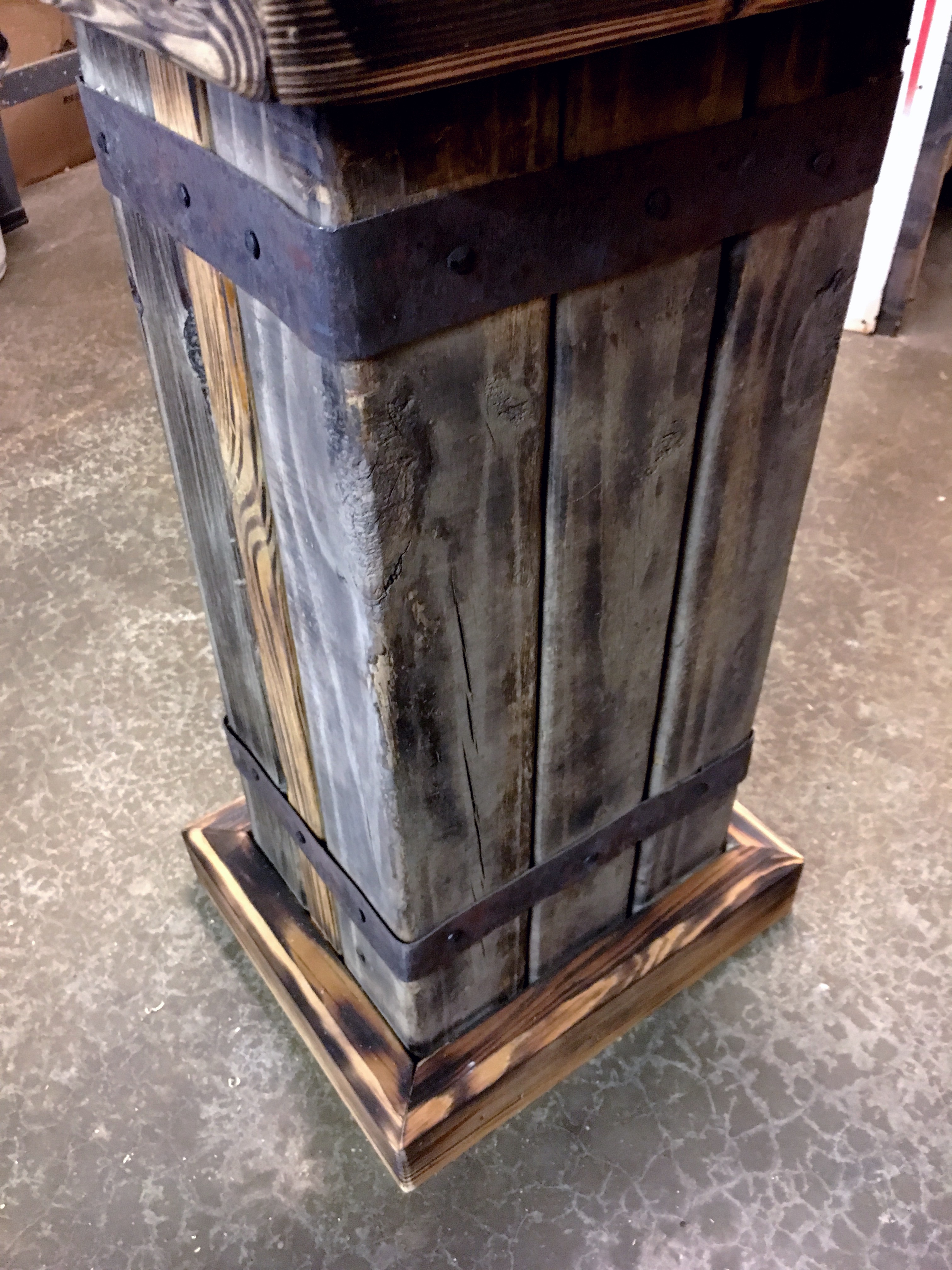

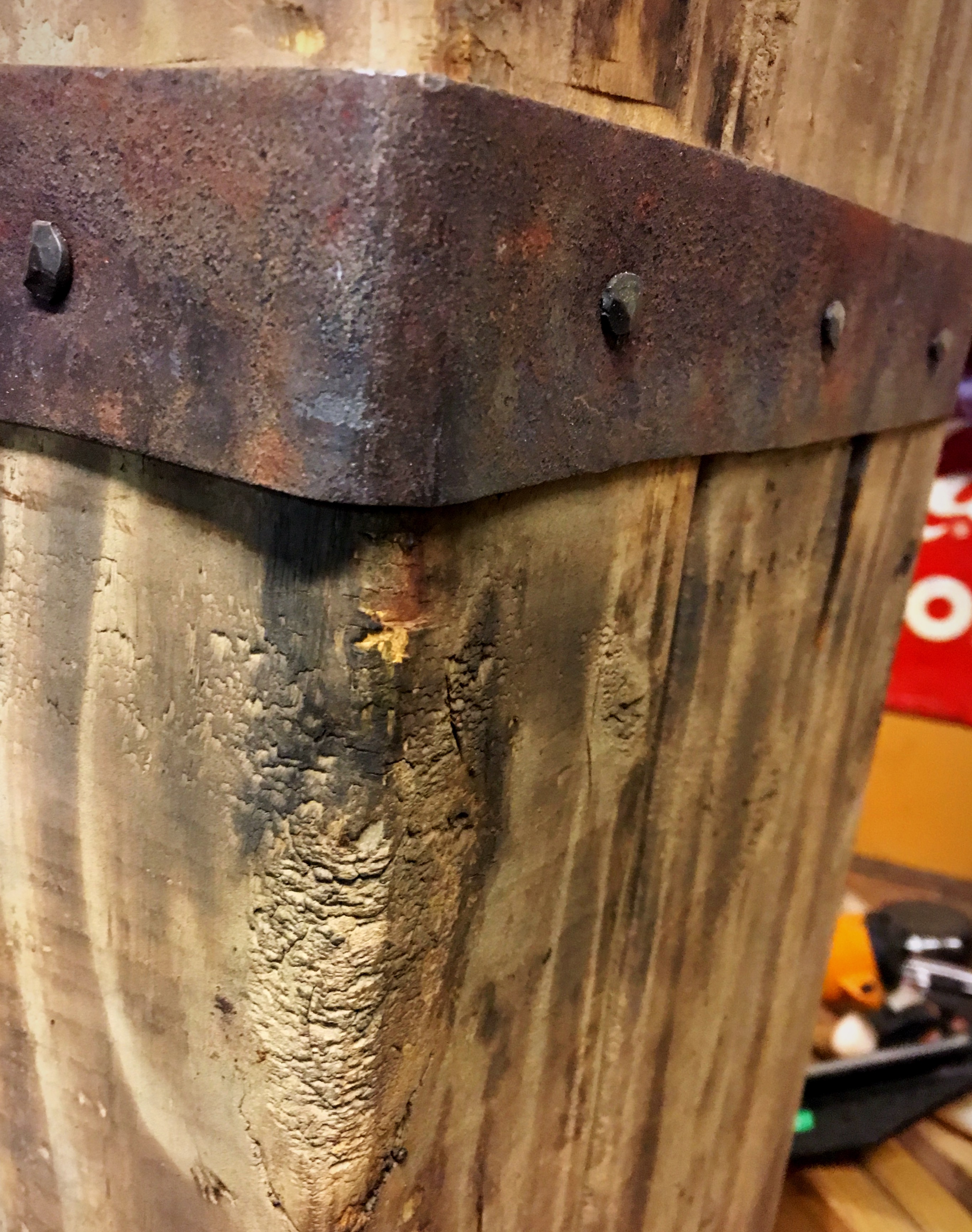

GrumpyBiker Posted July 27, 2017 Share Posted July 27, 2017 New guy here. (New to anything & everything concerning metal working.) Just made this stand for my RR rail anvil. Some old banding from a whisky barrel & hand cut nails from another project. Link to comment Share on other sites More sharing options...
Frosty Posted July 27, 2017 Share Posted July 27, 2017 Welcome aboard Grumpy, glad to have you. Nice stand. Have you checked out the vertical rail anvils? Charles Stevens posted a few in a thread showing some of the tooling you can make in the ends. Vertical also gives a much better depth of rebound and so is more effective at moving metal. I'm not dissing the anvil you've made, it has a splendid horn and will be an outstanding bench anvil once you have a more heavy duty one. Frosty The Lucky. Link to comment Share on other sites More sharing options...
jlpservicesinc Posted July 27, 2017 Share Posted July 27, 2017 2 hours ago, GrumpyBiker said: New guy here. (New to anything & everything concerning metal working.) Just made this stand for my RR rail anvil. Some old banding from a whisky barrel & hand cut nails from another project. Nice stand,, I like the anvil also. Good job on the horn.. Are the timbers through drilled and bolted also? Is the anvil glued down? Link to comment Share on other sites More sharing options...
GrumpyBiker Posted July 27, 2017 Share Posted July 27, 2017 9 minutes ago, jlpservicesinc said: Nice stand,, I like the anvil also. Good job on the horn.. Are the timbers through drilled and bolted also? Yeah, the banding is hiding the counter sunk bolt heads. Theyre gorilla glued & lag bolted with steel scrap in the voids. I know function is more important than form, but I do have to look at it! and sometimes I like to just be out in my shop. Not doing anything but being around my stuff. If that makes any sense. Link to comment Share on other sites More sharing options...
