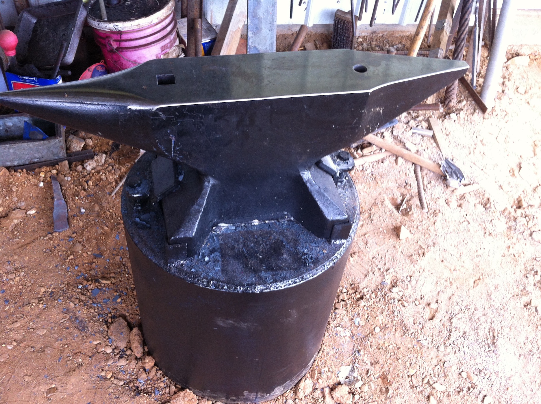

will52100 Posted March 17, 2016 Share Posted March 17, 2016 #57 330 pound Refflinghaus anvil mounted on 3/8" thick 20" diameter pipe, 1/2" thick top, filled with concrete and buried 6" in the ground. Solid as a rock. Quote Link to comment Share on other sites More sharing options...

Al Stephens Posted March 17, 2016 Share Posted March 17, 2016 Will52100, I sure hope that thing is where you want it! Concerning all the medical discussion , lets be thankful we are "fearfully and wonderfully made"….. and can be repaired! Quote Link to comment Share on other sites More sharing options...
