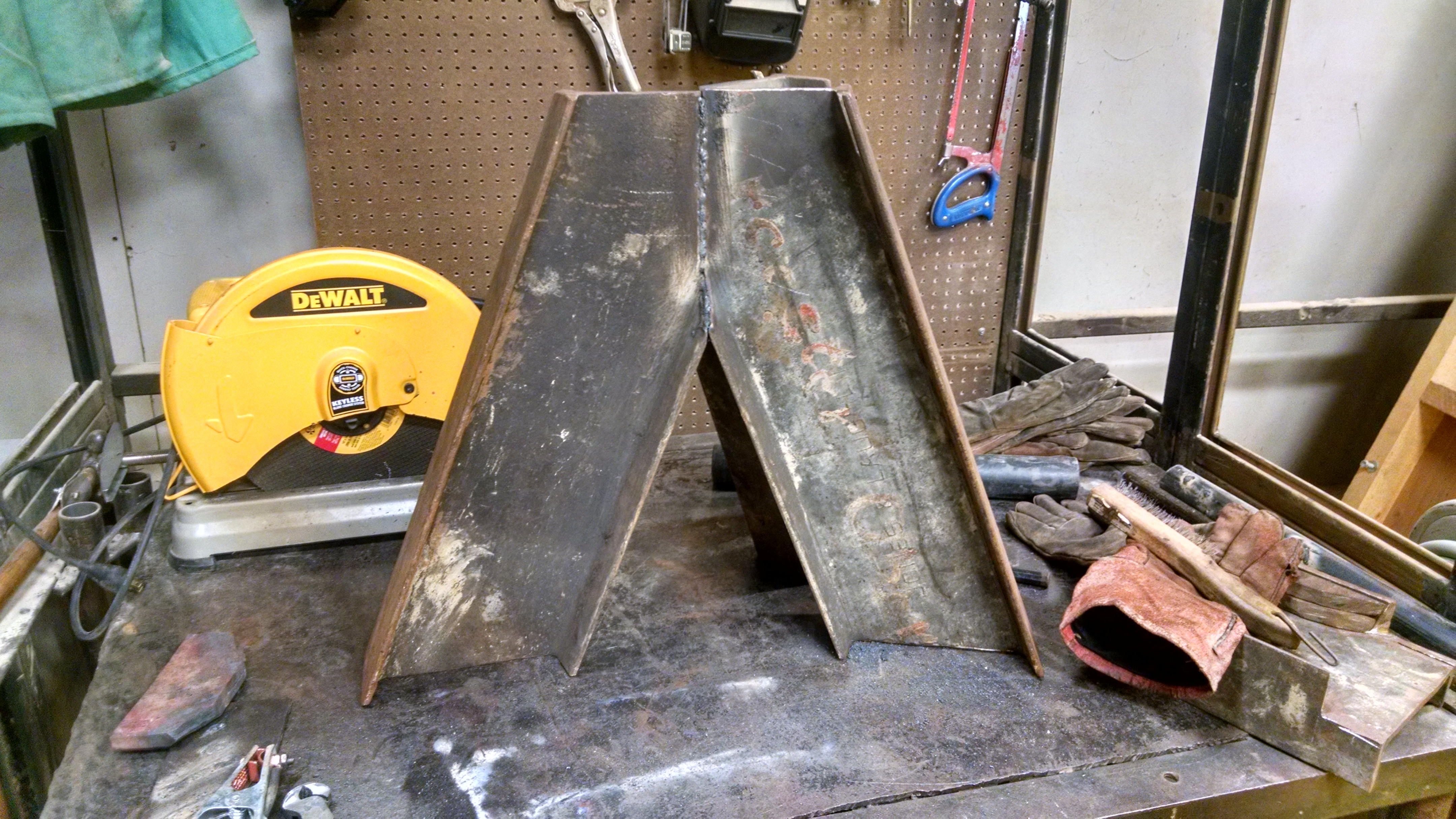

Lou L Posted July 25, 2017 Share Posted July 25, 2017 Okay, I suffer from "embarrassing stand-itis" and need a stamdecromy. I have hesitated while perusing my favorite steel monger for options because of design doubts. I have read many differing opinions on the layout of the legs and I would like to ask. If anyone posts their steel stand here could they include their opinions on the ideal angle for the slope of the legs? Im aware of the benefits of sturdiness with wider legs but they also get in the way. I wanted to know if legs on a steeper angle (closer to upright) confer an appreciable increase in rigidity or if welding struts between wider legs is just as solid. Finally, has anyone combined a steel stand with a box of stand on top? Apologies if I should have posted this in a separate thread...I just thought the discussion might add to the pictures of the stands. Lou Quote Link to comment Share on other sites More sharing options...
jlpservicesinc Posted July 25, 2017 Share Posted July 25, 2017 Lou L. Anytime you move a straight piece of steel at a slope and put weight on it you will lose rigidity.. It's the reason I did a complete rebuild on the stand in the trailer.. Using all straight pieces (with major gussets) vs sloped.. some would argue that because of the mechanics involved with kinetic energy and such that it becomes a moot point and from a strictly scientific study that may be the case.. Same reasoning with Ball bearng bounce on anvil faces.. I want as much rigidity in the stand as I can get and ideally the stand should be embedded in cement or bolted down solidly.. While a tripod stand will give you a non rocking setup on just about any surface a properly designed metal stand can be as rigid as solid but I don't see this in a tripod design no matter where or how I see the design.. You would have to reinforce the mounting plate with pre stressed girders with a huge amount of gusseting to stabilize the steel from flexing or bowing, springing with each blow as well as just supporting the anvil itself. Cement does very well in compression.. Say you have a 1/4" wall 3" sq tubing. 3ft long. If you add weight on the end of it standing up straight there will be deflection until the steel is compressed and the sides are tensioned enough to stabilize.. Fill the tube with cement and it will achieve rigidity nearly immediately when the load is applied.. Lolly column.. Steel being springy or flexible needs gussets or diagonals to stabilize any fabricated/welded item.. Both the black widow stand and the one in the trailer offer the stability and solidness I was looking for but both took a lot of desire and removal or design features I disliked vs ones I needed to have.. In other words I engineered out all the things I didn't like in a fabricated stand.. Again the problems with steel is how do you get rid of the spring.. The easiest way to minimize the spring is to get the legs straight up and down and gusset heavily to stop flexing of the side of the pipe, tube or solid.. On 7/16/2017 at 10:41 PM, ThomasPowers said: and every one of those interfaces sapping energy! +1 Unless they are all welded together with no air gaps between them.. Quote Link to comment Share on other sites More sharing options...
JHCC Posted July 25, 2017 Share Posted July 25, 2017 26 minutes ago, jlpservicesinc said: a properly designed metal stand can be as rigid as solid but I don't see this in a tripod design no matter where or how I see the design. You including mine in that? It's a tripod of 4" x 8" I-beam with the webs joined in a vertical seam under the center of the anvil. I suppose that theoretically there's some infinitesimal degree of flexing, but that thing is a rock. Here it is during fabrication, before the top plate went on: (Please excuse the messy welding.) (Although it is worth noting that the legs are wide enough that their inside faces are within the footprint of the anvil, so there is at least some force going straight down.) Quote Link to comment Share on other sites More sharing options...

JHCC Posted July 25, 2017 Share Posted July 25, 2017 The top of my stand is a piece of the same I-beam, notched in the corners to fit around the anvil's feet. I don't think it's superior to angle iron, certainly, but it certainly made a difference in fabrication, as I could run welds along the entire width of the legs' flanges and webs where they intersected with its underside. (And given my significant inexperience with welding, that was a very good thing.) That gave the whole thing a lot of resistance to torquing under load. Quote Link to comment Share on other sites More sharing options...

jlpservicesinc Posted July 25, 2017 Share Posted July 25, 2017 5 hours ago, JHCC said: You including mine in that? It's a tripod of 4" x 8" I-beam with the webs joined in a vertical seam under the center of the anvil. I suppose that theoretically there's some infinitesimal degree of flexing, but that thing is a rock. Here it is during fabrication, before the top plate went on: (Although it is worth noting that the legs are wide enough that their inside faces are within the footprint of the anvil, so there is at least some force going straight down.) Hi Sorry about that.. I was thinking commercially made stand but a lot of the tripod stands are also weak in the knees.. The stand you fabricated is the best design for that sized and shaped anvil I have seen.. It uses the sides and webs of the I beam to reinforce and stablilize.. I would still add tie in's to all the feet to help with load spreading and then add a way to bolt it down solidly.. The heel of your anvil is within the foot print of the stand thus any shifting of the stand under load is decent enough to help with torsional rigidity.. It's the best in a tripod stand I have seen.. Quote Link to comment Share on other sites More sharing options...

JHCC Posted July 25, 2017 Share Posted July 25, 2017 29 minutes ago, jlpservicesinc said: It's the best in a tripod stand I have seen. Thank you! (And to think folks accused me of overbuilding....) Quote Link to comment Share on other sites More sharing options...
jlpservicesinc Posted July 25, 2017 Share Posted July 25, 2017 25 minutes ago, JHCC said: Thank you! (And to think folks accused me of overbuilding....) Not quite sure what I want to do for anvil stands design wise when I get the school up and running but your design is the leader of the pack.. Simple in design, offering decent rigidity.. I have 40 i beams which might fit the build when the time comes.. Ideally I want to offer both wood and steel stands as well as gas, coal and wood fired forges with both electric or hand crank so people can experience the differences.. Quote Link to comment Share on other sites More sharing options...
JHCC Posted July 25, 2017 Share Posted July 25, 2017 11 minutes ago, jlpservicesinc said: Not quite sure what I want to do for anvil stands design wise when I get the school up and running but your design is the leader of the pack.. Simple in design, offering decent rigidity.. I have 40 i beams which might fit the build when the time comes.. Ideally I want to offer both wood and steel stands as well as gas, coal and wood fired forges with both electric or hand crank so people can experience the differences.. And the three legs are essentially identical (apart from needing different beveling on the flanges), so easier to mass produce. If you have a flat top plate instead of I-beam, you can simply cut that to shape, weld it on, and drill bolt holes to mount the anvils in place. Quote Link to comment Share on other sites More sharing options...
