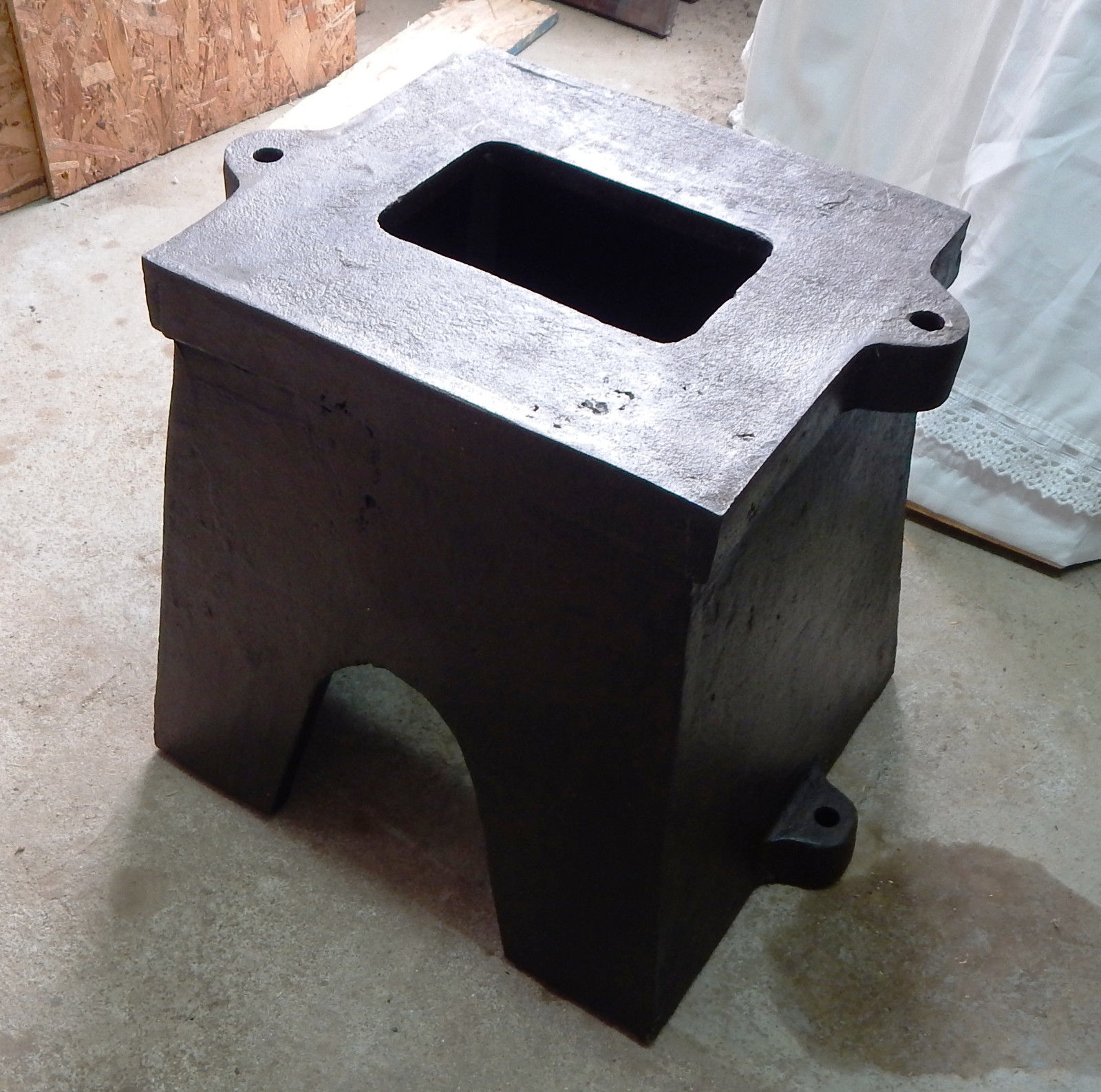

JT Posted July 6, 2017 Share Posted July 6, 2017 heres just a block of wood my Soderfors Paragon came on, and a original cast iron stand under my Kohlswa , and I believe a cast iron factory Fisher stand .. although there is no name on it.. Quote Link to comment Share on other sites More sharing options...

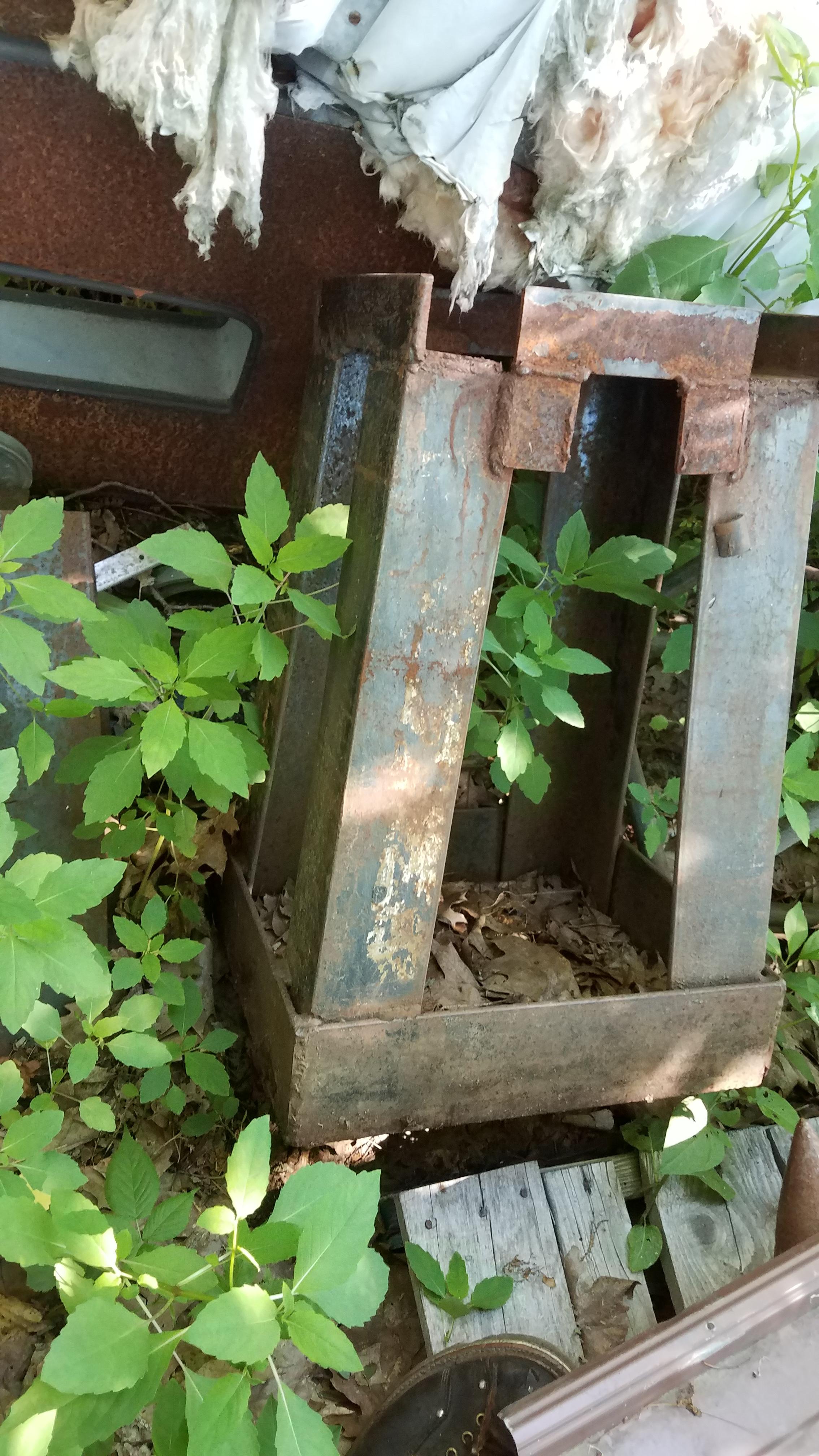

jlpservicesinc Posted July 8, 2017 Share Posted July 8, 2017 heres a few.. all steel except 1.. this one was used in the blacksmith shop for many years.. It finally rotted out last year.. It was 20+ years old and lived in a damp shop, then outside for the rest of it's life.. Quote Link to comment Share on other sites More sharing options...

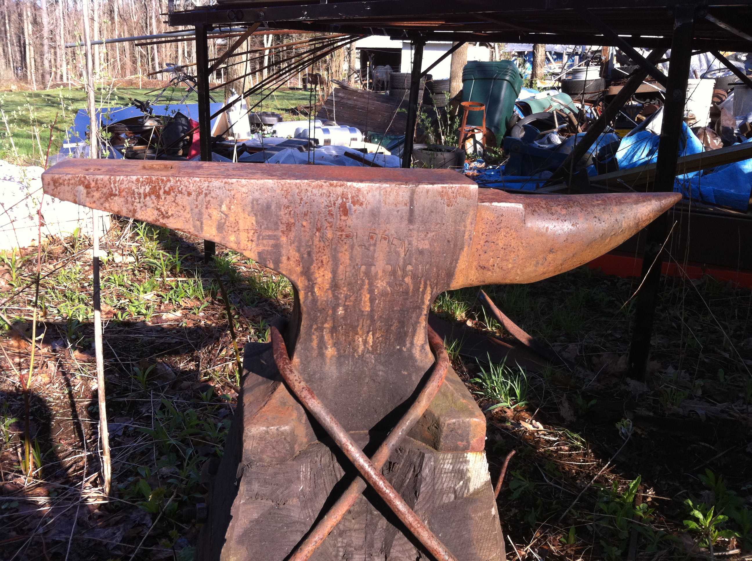

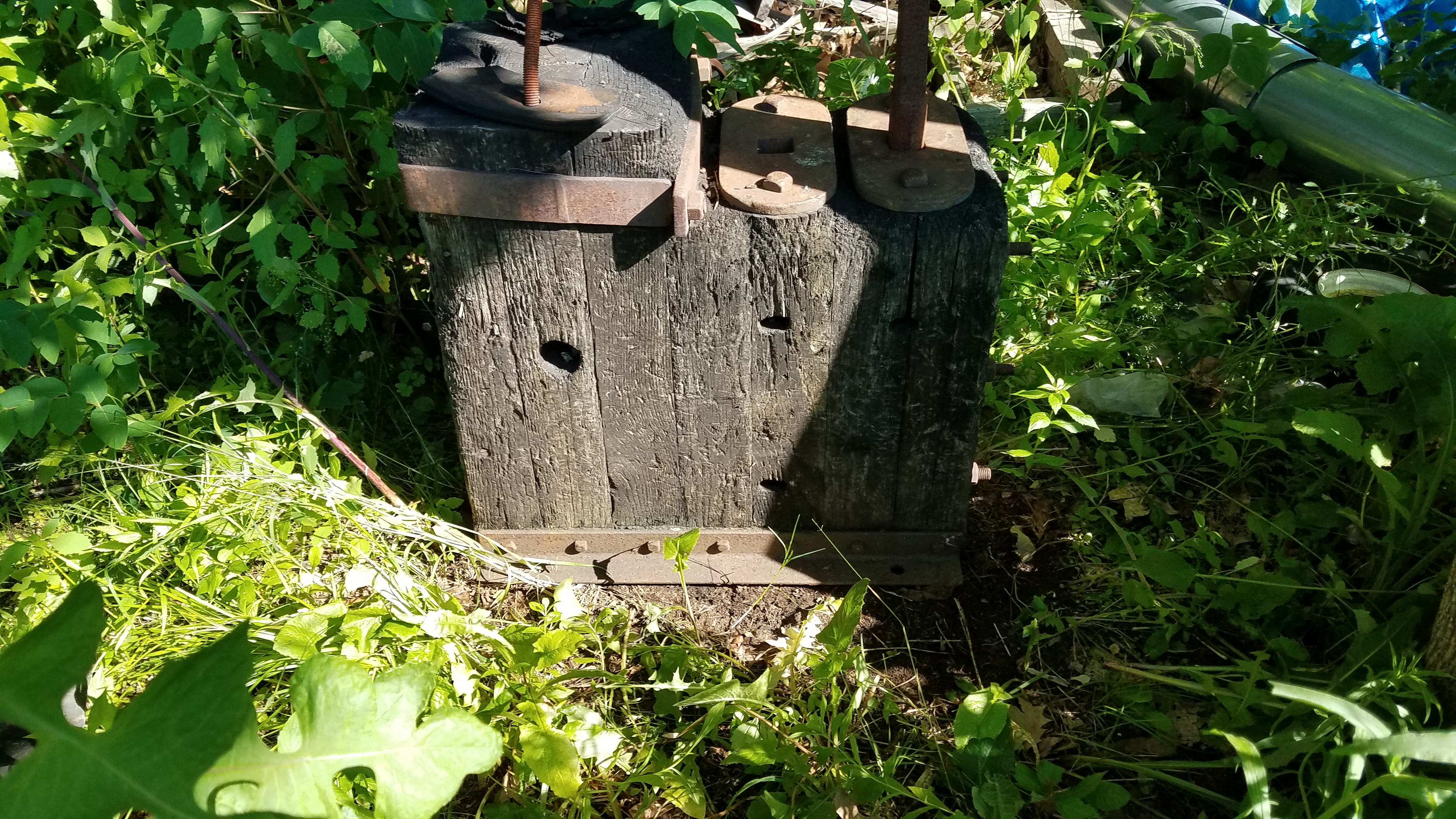

jlpservicesinc Posted July 10, 2017 Share Posted July 10, 2017 That stand with the wood is gorgeiois.. It wouldn't take to much to make a setup like this The side bars are 1"X2" but I would make them bigger next time around.. The bars were inset into the wood and then the long treaded straight bars were drilled and placed through the holes.. Then the anchor bars were wrapped around the fed in.. Everything was then threaded.. Reason why I even mention it is you have a really nice stump with a very nice anvil.. Kind of falls apart at the staples.. Sorry.. I don't mean to sound like an elitist.. The other thing is when bolted down with the brackets shown.. The anvil will be very quite and it will perform like a much bigger anvil.. Quote Link to comment Share on other sites More sharing options...

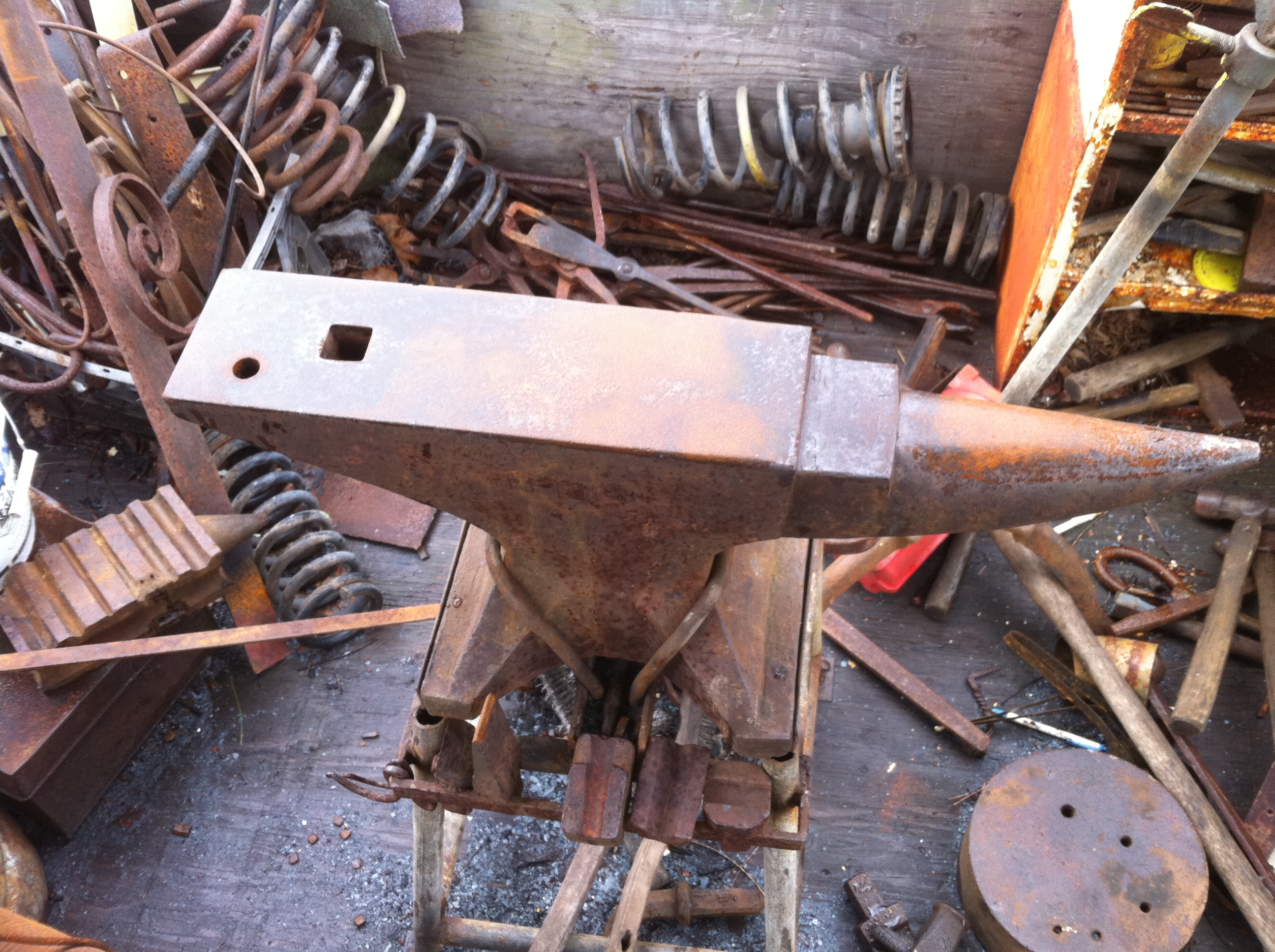

jlpservicesinc Posted July 10, 2017 Share Posted July 10, 2017 Few more stands.. angle iron 1/4" X 3" angle.. was a stand put together to keep the anvil off the ground. Next is the old one out of the trailer, Then one made back between 1843-1925.. The anvil mounted on it was a Hay Budden bought directly from the factory.. It was a 2 piece anvil 198lbs. Quote Link to comment Share on other sites More sharing options...

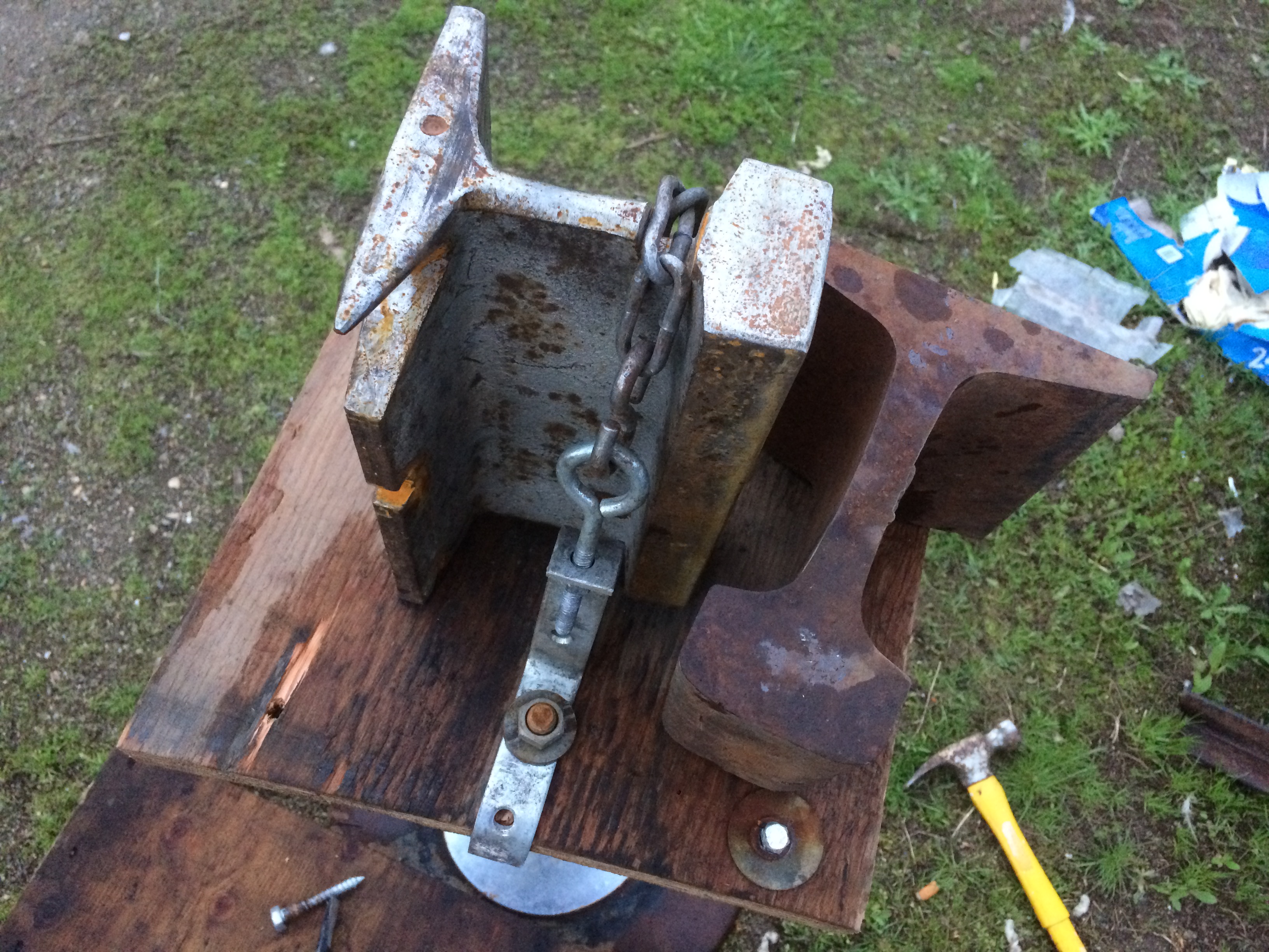

tanglediver Posted July 12, 2017 Share Posted July 12, 2017 My first stand attempt for the London-esque pattern rail. Quote Link to comment Share on other sites More sharing options...
