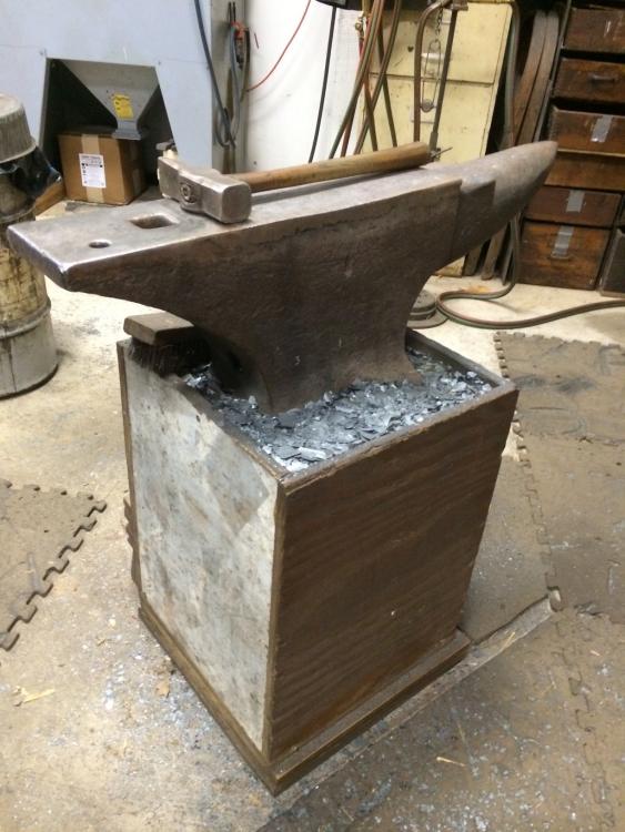

Al Stephens Posted January 29, 2016 Share Posted January 29, 2016 I hope the long time IFI members will forgive me if this has been covered, but I thought pictures of different anvil stands might be helpful for beginners. The anvil I use the most is a plywood box, filled with sand. Anvil sits on a piece of plywood and space between the feet of the anvil and top of the box fills up with scale. Very solid, doesn't move or bounce, very quite while forging. I have 4 others,if there is any interest, and I'm sure there are a lot of good ideas out there. Link to comment Share on other sites More sharing options...

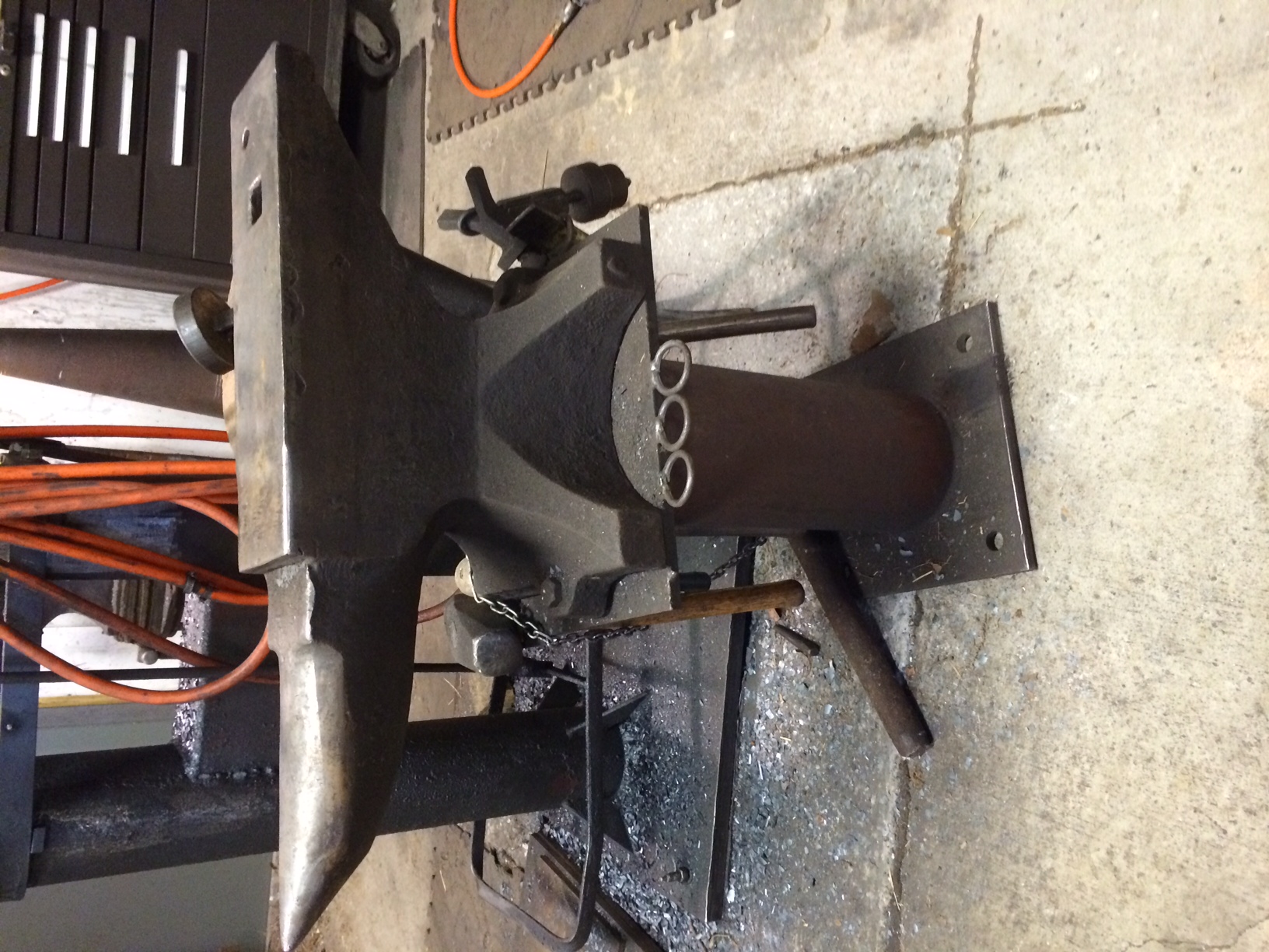

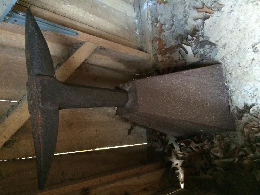

Al Stephens Posted February 2, 2016 Share Posted February 2, 2016 Two, nice workable stands. Don't think I've ever seen a anvil welded at the waste before. The stake stand looks good. When it gets light I'll take and post a pic of a fabricated stake stand I made several years ago. But for now, here's my #2 stand. It was made in a weld shop where a meeting was held years ago. I bought it when he closed his shop down. Not sure why it's sideways. Link to comment Share on other sites More sharing options...

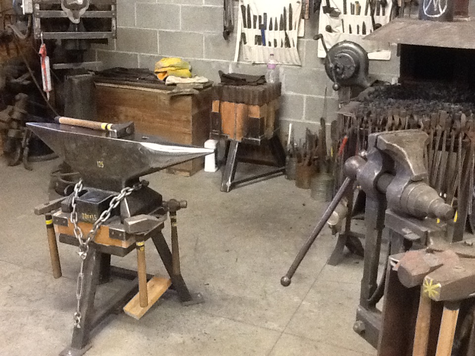

matto Posted February 2, 2016 Share Posted February 2, 2016 her is my main stand Link to comment Share on other sites More sharing options...
Al Stephens Posted February 2, 2016 Share Posted February 2, 2016 Very nice, hope every notices the swage block stand also. Here's the stake stand pic. Sorry about the sideway pic. Face 32" high, stand 12" sq. base, 20" high Link to comment Share on other sites More sharing options...
matto Posted February 2, 2016 Share Posted February 2, 2016 The swage block stand also allows me to put it up on its side and keep it low. Link to comment Share on other sites More sharing options...
