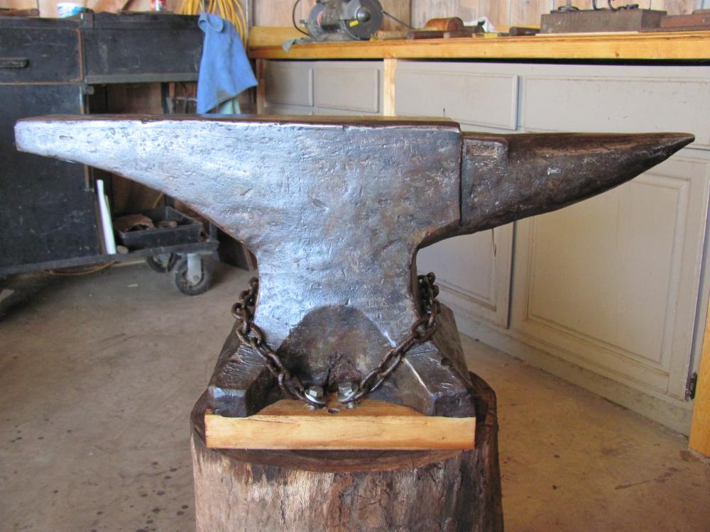

Quench. Posted February 19, 2016 Share Posted February 19, 2016 (edited) Nothing special, but better than the stack of bricks... 1 1/4" x 1/8" bar, with pieces of 1" angle welded on for reinforcing the bolt. 4x4, 5/16" chain, 3/8" turnbuckles. The anvil is 120lbs. Moves well with a hand cart. Edited February 19, 2016 by Quench. The picture is back... Link to comment Share on other sites More sharing options...
JHCC Posted February 19, 2016 Share Posted February 19, 2016 6 minutes ago, Quench. said: Nothing special, but better than the stack of bricks... 1 1/4" x 1/8" bar, with pieces of 1" angle welded on for reinforcing the bolt. 4x4, 5/16" chain, 3/8" turnbuckles. The anvil is 120lbs. Moves well with a hand cart. Nice! Do you have any problems with it twisting? Link to comment Share on other sites More sharing options...
Quench. Posted February 19, 2016 Share Posted February 19, 2016 JHCC, I expect there will be issues with twisting, but I figure I can screw some lag bolts in the holes of the base. I put a few screws in there just to line up the chain. Link to comment Share on other sites More sharing options...
Quench. Posted February 19, 2016 Share Posted February 19, 2016 Well, I cannot reply...disappearing post, repeatedly. Can't reply with more than about a 1 liner. Very, very frustrating. No adhesive. Wood needs to dry and shrink and still be able to be tightened. Had a lot more detail, but the forum won't save the post. Link to comment Share on other sites More sharing options...
