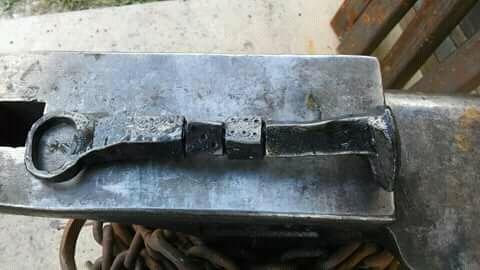

  22. I call this one my Pair 'O Dice opener.
