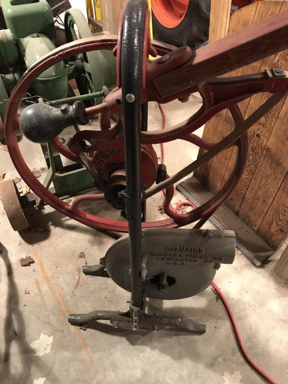

  2. Greetings Swiss, I just posted a picture of one I restored .. “Champion 1898 blower”. The picture shows the belt arrangement which would be the same as yours. Restorations are a challenge and many parts have to be manufactured.. Good luck and have fun Forge on and make beautiful things Jim

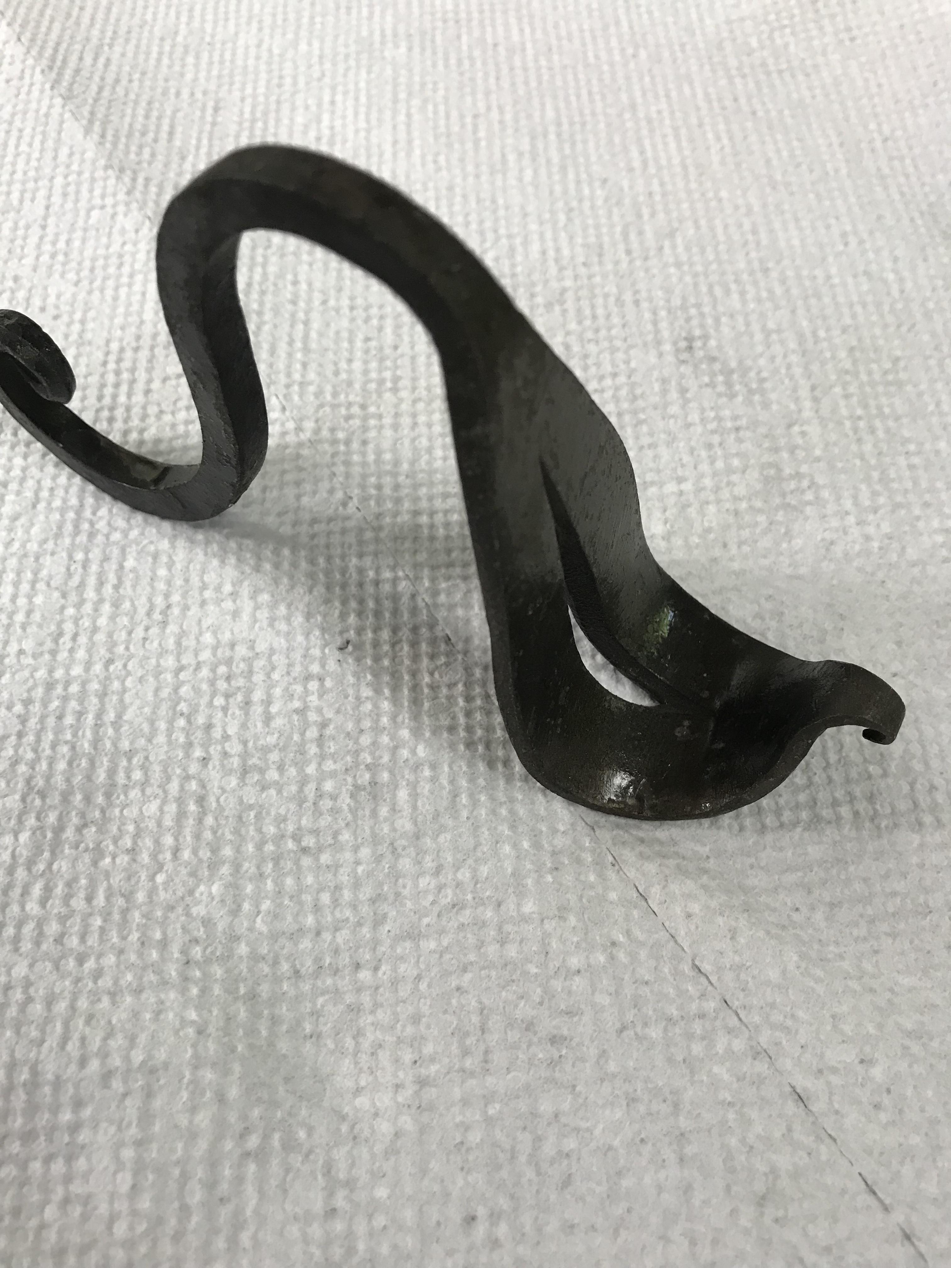

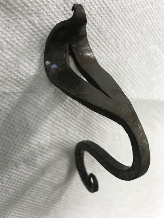

  7. Greetings Finn. Just start with a simple hook.. If you use a chunk of round stock 1/4 .. 5/16 .. 3/8 ,, you won’t need tongs.. If you have a cut off hardy tool it’s good practice.. Keep trying keep trying. No such thing as failure... After 40 plus years at smithing I still have my first forge weld.. Forge on and make beautiful things Jim

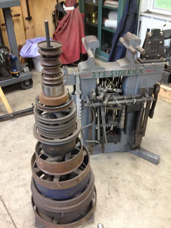

  12. Greetings JLP, Yep it’s armstrong... You only see just a few things that I do with it . Notice the rails and staggered pins . Great for straightening. Many other fixtures fit in the hardy with a wedge.. I’m surprised nobody ask what STS means. Bigger stuff I do on the acorn table with pins and forms. And yes I also have a Hossfield. Forge on and make beautiful things Jim
