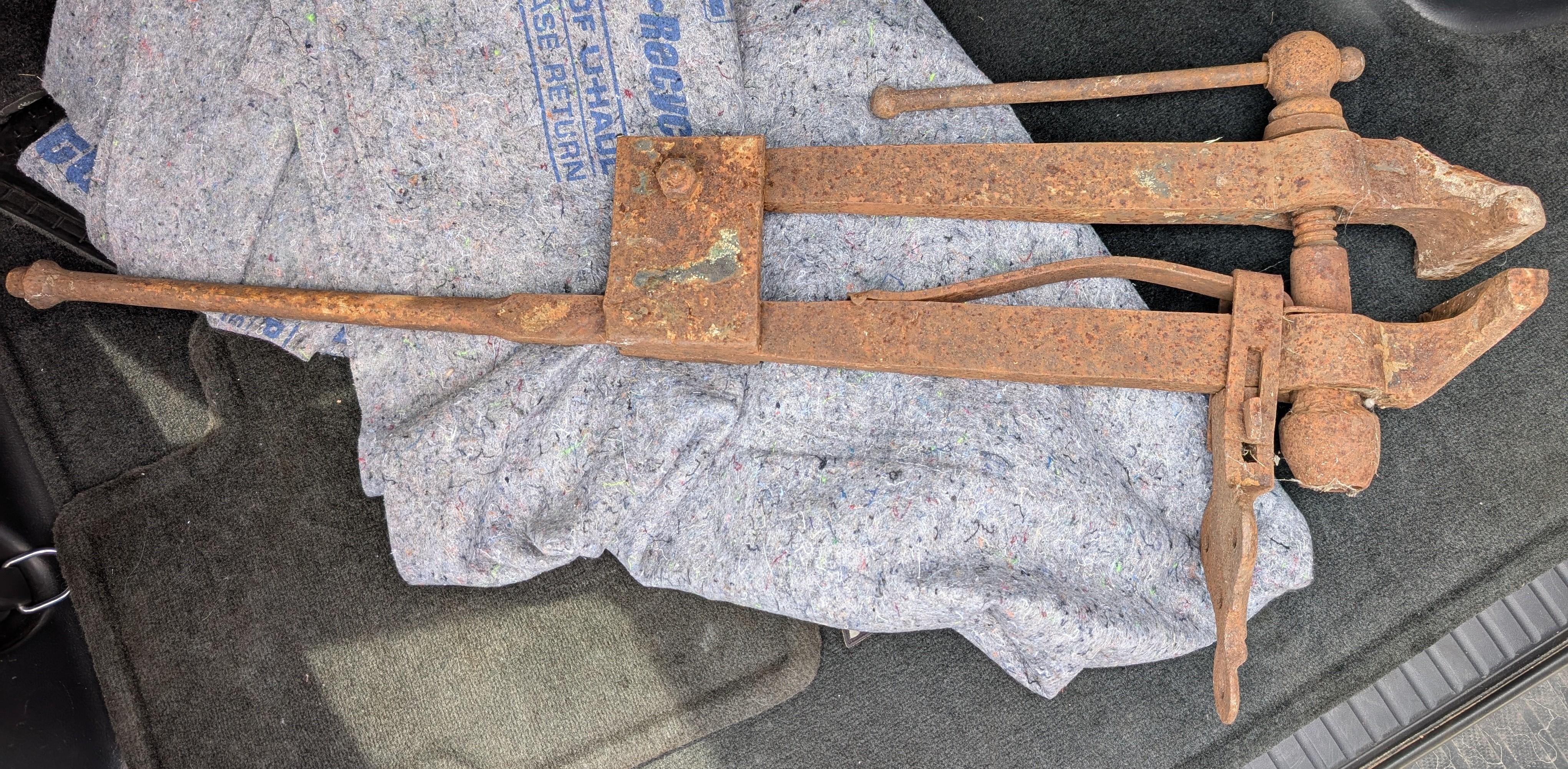

    Picked this up yesterday for $100 and about an hour and a half round trip commute. Guy had it listed last week for $165, and when I saw it drop to $100 I jumped at it. She needs a little TLC as the spring is on backwards and it looks like a key is missing (which will make turning the spring around easier), but other than that it'll just be some rust removing and some lubricating and then it's time to mount it. 5" jaws that line up with minimal wear on the jaw faces, but I'll still likely make some sleeves in the future.

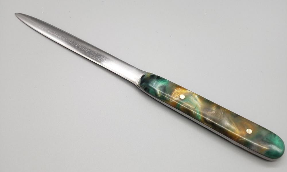

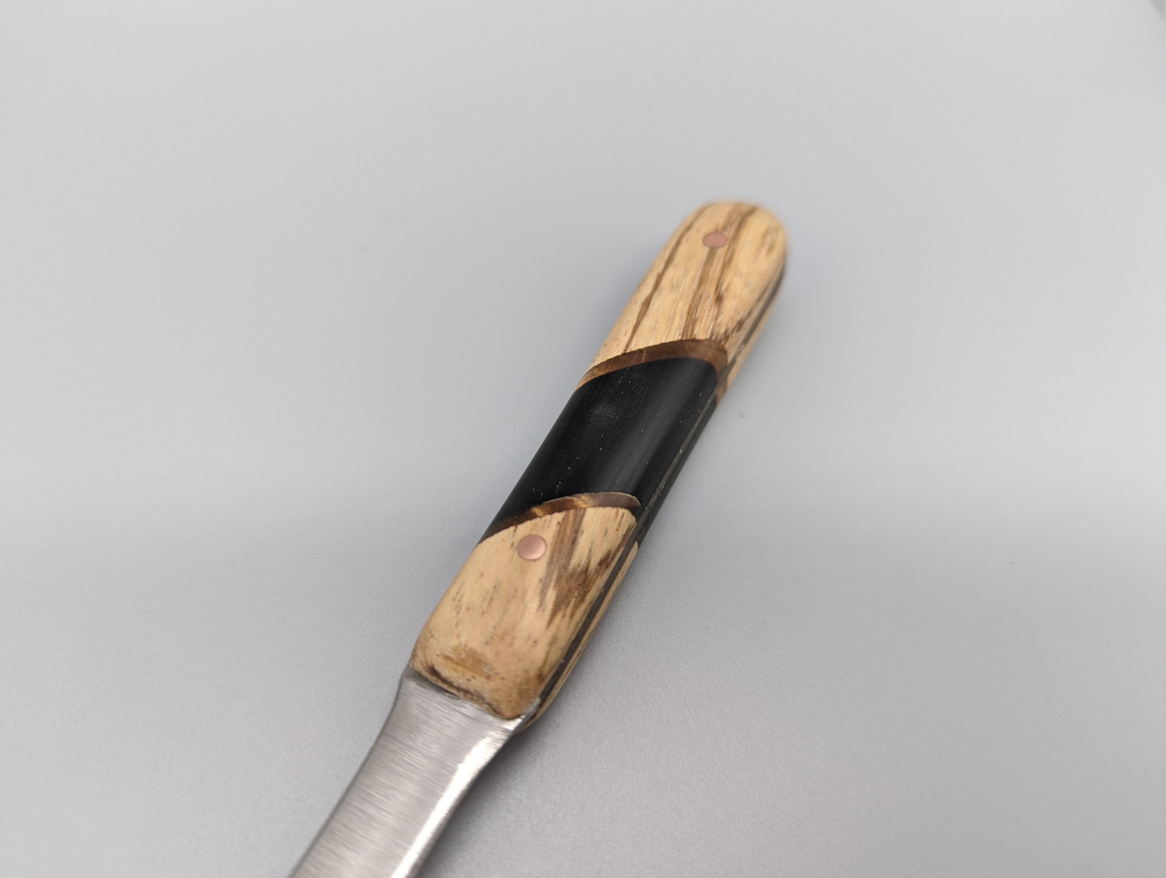

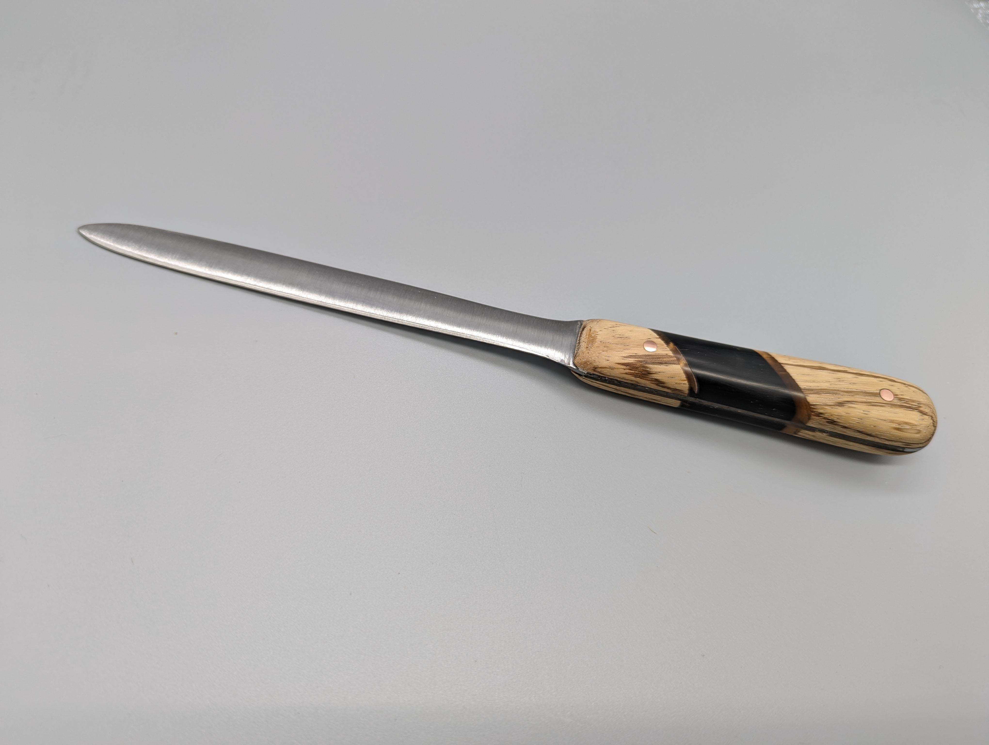

  12. I'm a little late in posting this, but over the holiday break I managed to finish up another letter opener, which was given to a friend who gifted me a butcher block cutting board. Recycled coil spring blade, Zebrawood & resin handle.

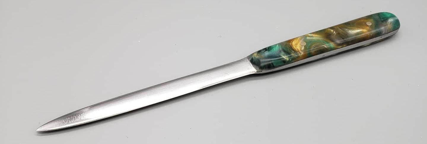

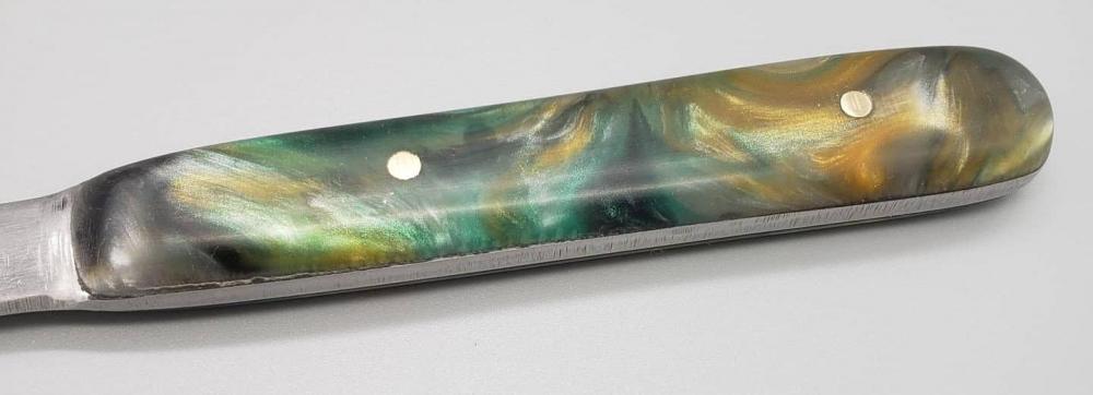

  14. I made this over Memorial Day weekend, realized I hadn't posted it here yet. My first forged item that I'm proud to show others, something that I learned a fair amount during the making of. I've had plenty of compliments on it, and interest from some of the people I've shown it to for one of their own. Blade is from coil spring, handle is epoxy resin and mica powder. There are some pretty obvious flaws to it, but as a first I don't think it's horrible. I'd love feedback too so the ones I make for others will be closer to perfect.

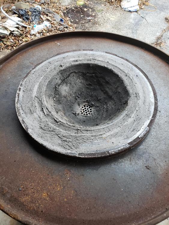

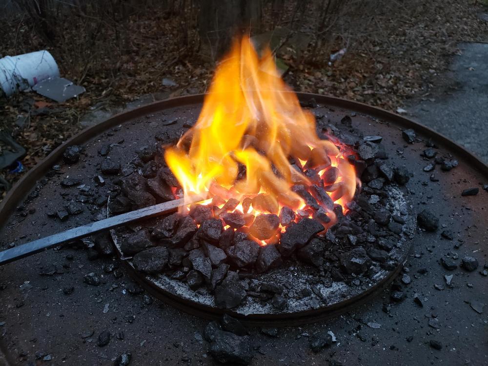

  23. So a bit of an update on this... I built a bigger fire in the pot today, enough to see if I could successfully heat a piece of steel laying across the rim of the rotor. I cut a chunk off a coil spring I have and heated it a little lower than the rim to straighten it out, then laid it across the rim to test. And I have to say, it was a success. So I think I just need to make the attachments of the hair dryer to the pipe more permanent than they are, add the "cap" that'll be cut from another drum, and I'll be in business. Probably should cut an access in the side as well to get to the ash dump now that I'm thinking about it... Hrm. My rotor firepot, "clayed" with leftover Greenpatch: A shot of the "bigger" fire, heating up the mild steel that'd become my quickie coal rake:
