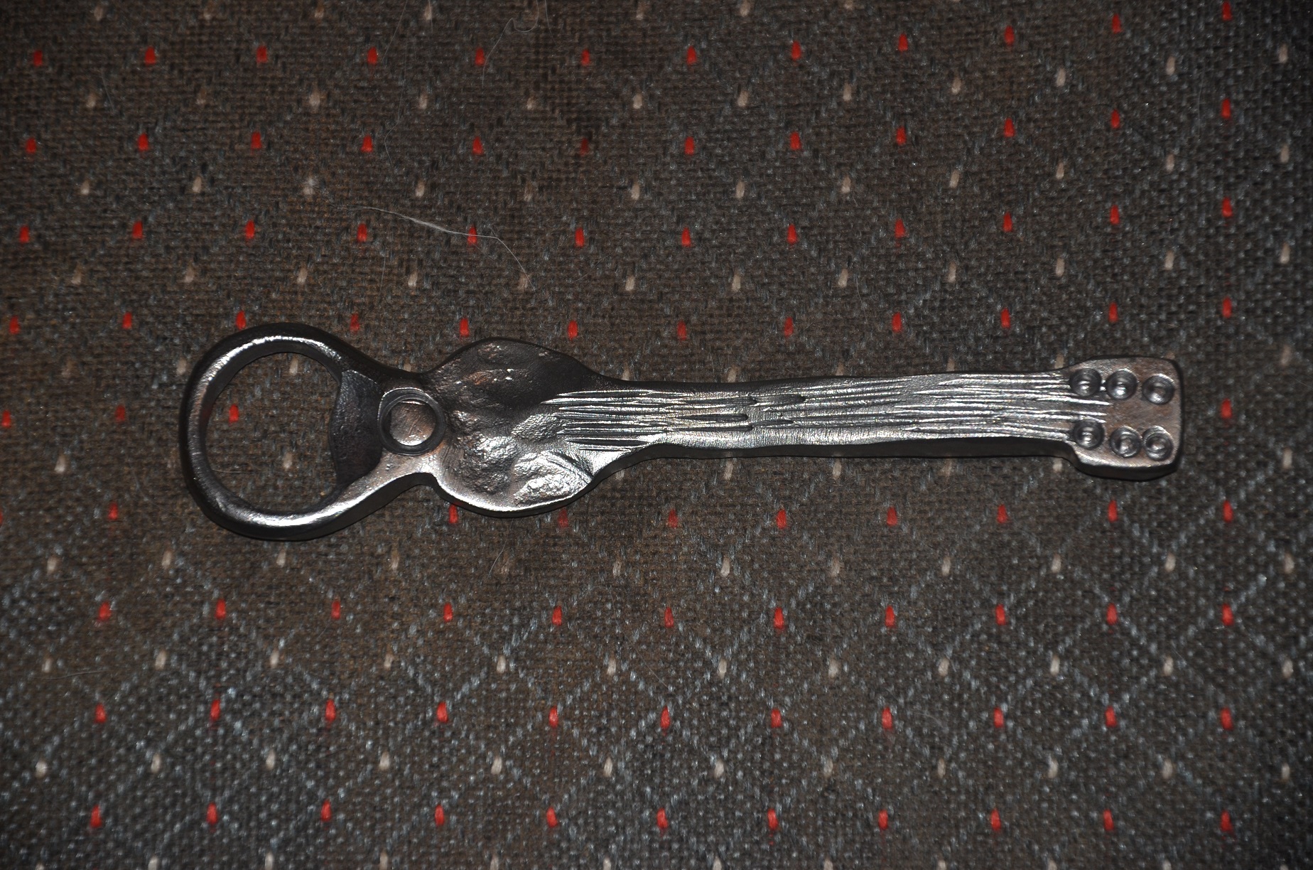

ausfire Posted December 6, 2017 Share Posted December 6, 2017 Like Little Blacksmith, I too was inspired by Just Another Biker's guitar bottle opener. Had to give it a try after today's demo, but I'm not too thrilled with the result. I think I started with the wrong stock (12mm square bar). Next time I might try something rectangular, maybe 20mm x 6mm. But that's OK; every time you try something new you learn things. It does open bottles though: Quote Link to comment Share on other sites More sharing options...
JustAnotherViking Posted December 6, 2017 Share Posted December 6, 2017 I'd say your stock size was fine, just a little bit thick in the guitar neck compared to the body. Much neater than mine at any rate! Now there's an idea..... vaguely guitar like shapes in different dimensions - bass - double bass - cello - violin Not everyone would want a guitar! The bit I struggled with the most was the 'waist' part in the middle of the guitar.. a simple guillotine fuller would speed the process up. I attempted a prototype horse shoe / horse head /hoof pick last night, but my chisel slipped when I was trying to cut in the ear... So next one I'll need to make an eye punch, and be more careful with the chisel. I'm happy enough with it as a concept bashed out in 20 minutes. Quote Link to comment Share on other sites More sharing options...

C-1ToolSteel Posted December 6, 2017 Share Posted December 6, 2017 On 12/6/2017 at 4:07 AM, ausfire said: Like Little Blacksmith, I too was inspired by Just Another Biker's guitar bottle opener. A shorter neck and it would look very similar to a weissenborn guitar: To make a standard dreadnought or folk guitar look right, you need to have very sharp, almost 90 degree transitions from body to neck. It is also easy to make the waist to thin and a bunch of other things that make guitars very difficult (and sometimes frustrating) to replicate. Looking forward to what else you guys come up with. Weissenborn guitar: Quote Link to comment Share on other sites More sharing options...
