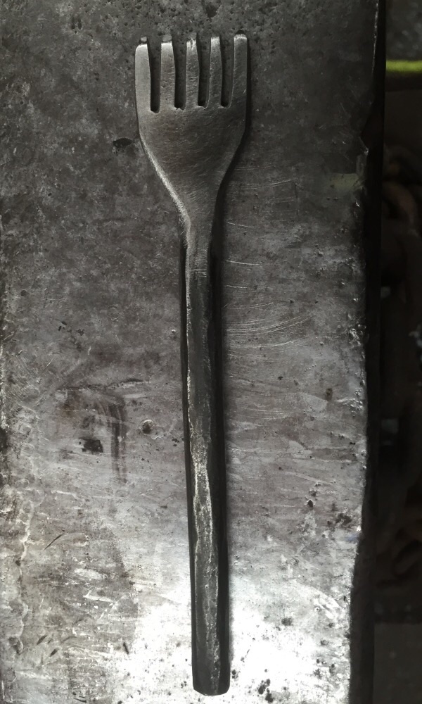

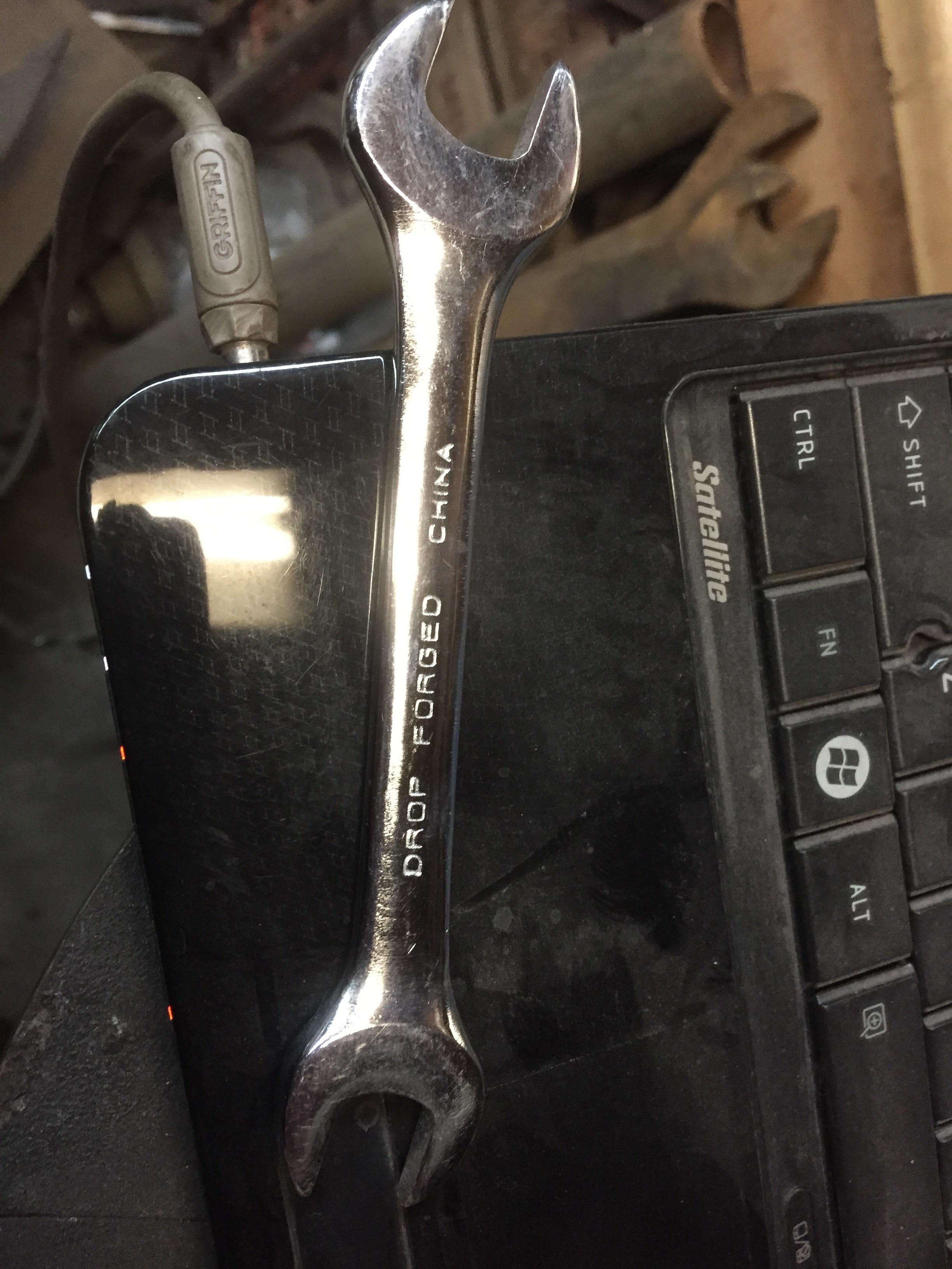

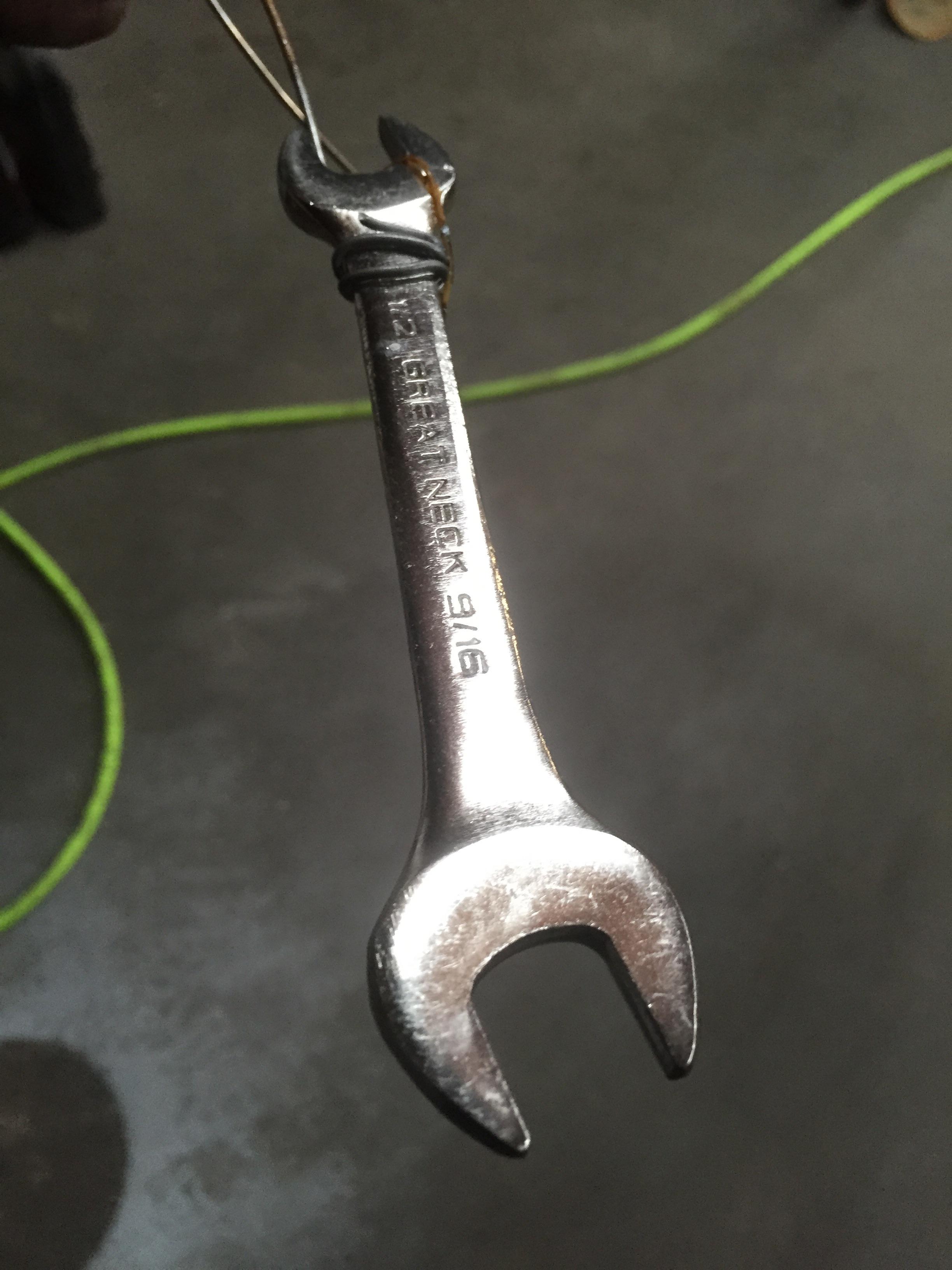

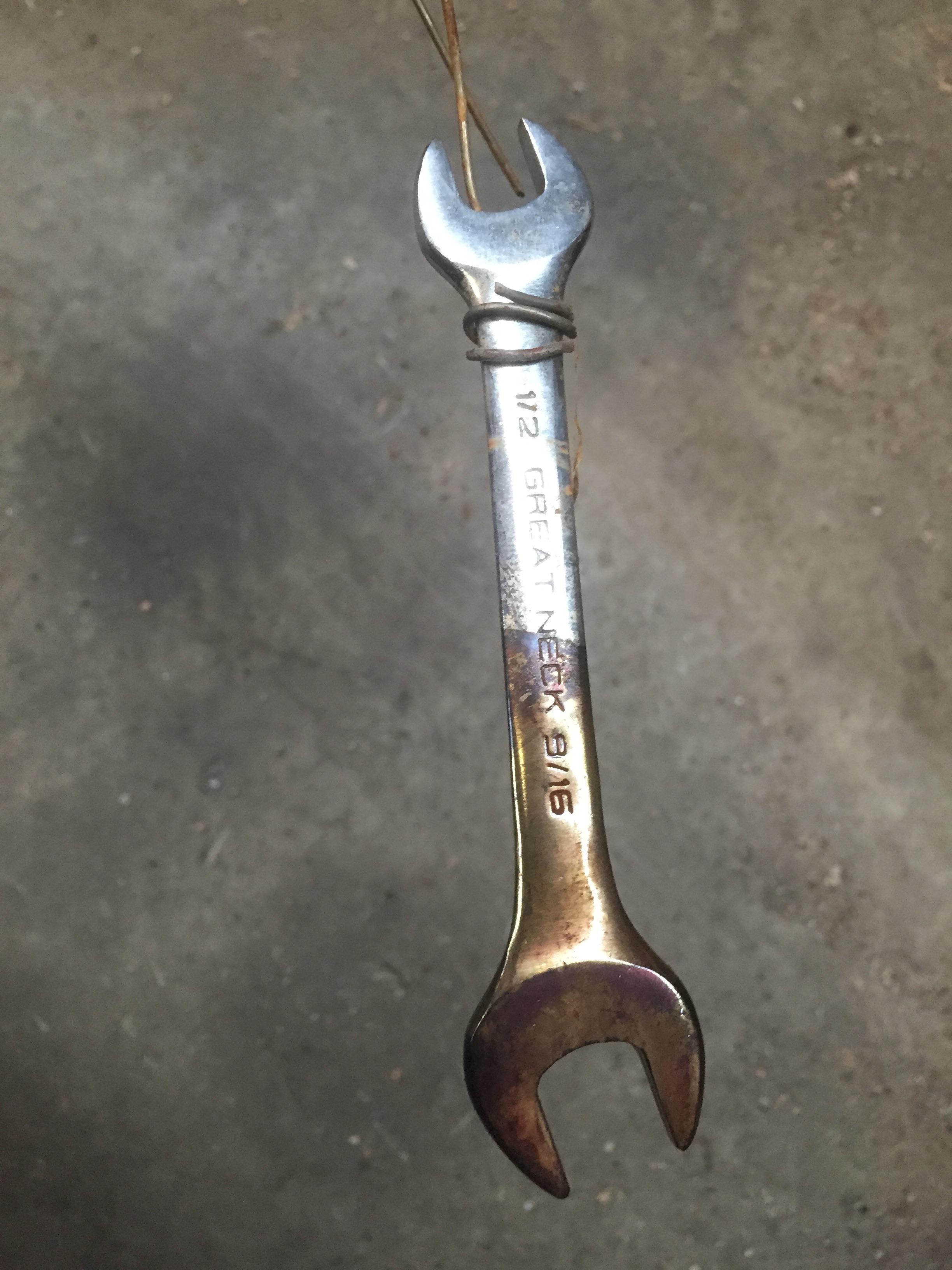

Daswulf Posted December 1, 2017 Share Posted December 1, 2017 All I got done was a leather stitching tool. Second one actually. I burned the first one trying to get fancy with it. Ugh will I ever learn? Other then that I have been testing the potassium permanganate to attack the chrome so muriatic acid will remove it. So far with the test piece no luck. A couple days in the pp solution and then in the ma, no luck. Any other clues on this? Quote Link to comment Share on other sites More sharing options...

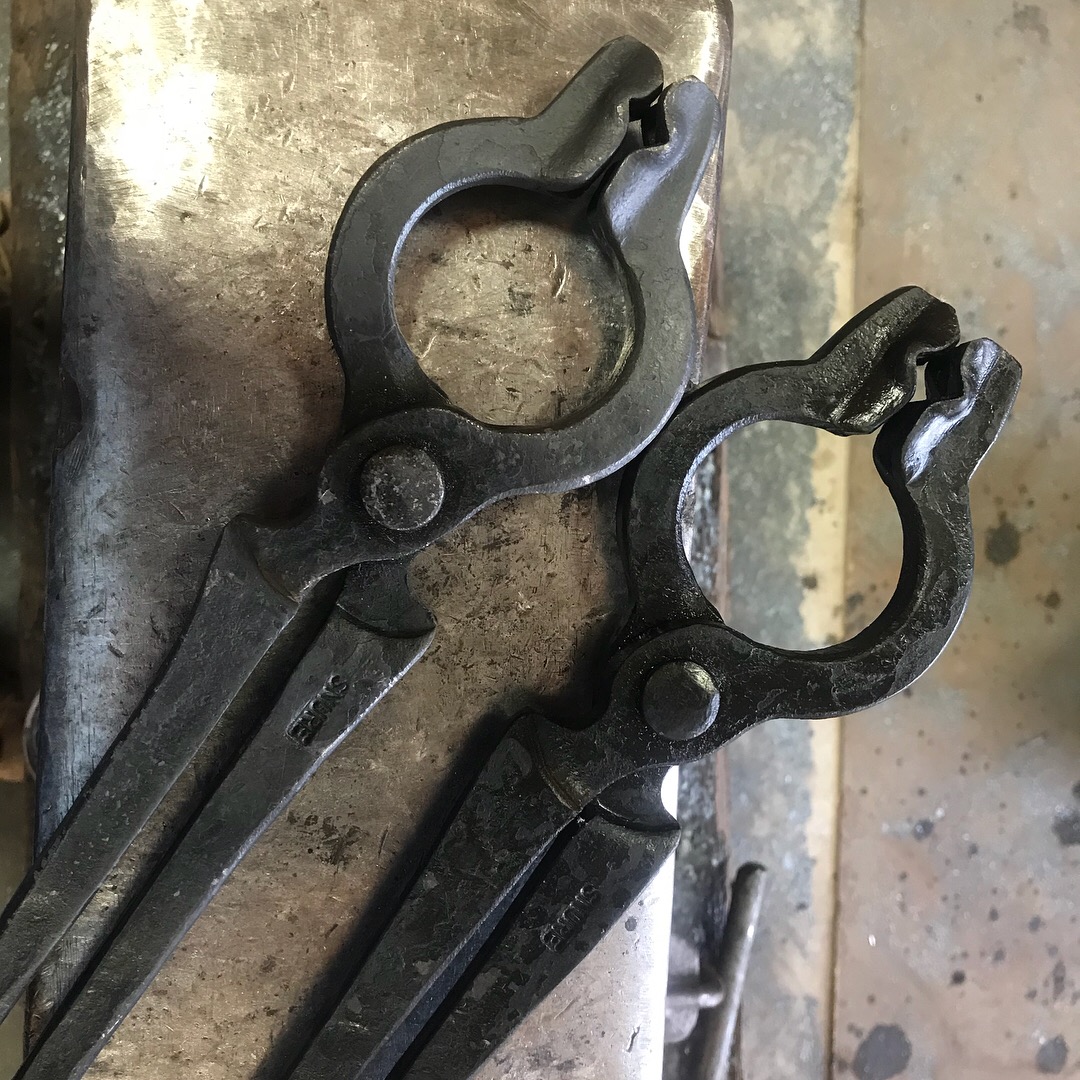

Ranchmanben Posted December 1, 2017 Share Posted December 1, 2017 6 hours ago, littleblacksmith said: Very nice hammers! remind me of a farrier pattern I like it with the narrower fuller than most, gives it a nice look. How'd the tongs work? Thanks Mark. The farrier style rounding hammer was my goal, glad you picked up on that. The tongs worked like a dream but I wish someone had told me that there’s a learning curve to using them. After a while I got the hang of it and things started going more smoothly. Das, I’m guessing you’re getting ready to buck stitch something? I built one set of half inch bolt tongs today and I’m hoping I’ll get a chance tomorrow to build the other set in need to make. Felt pretty good to use a hammer I made myself. Quote Link to comment Share on other sites More sharing options...
Gergely Posted December 1, 2017 Share Posted December 1, 2017 Beautiful pair of tongs you made there! Very stylish and functional - I like it very much. Bests: Gergely Quote Link to comment Share on other sites More sharing options...
Ranchmanben Posted December 1, 2017 Share Posted December 1, 2017 Thanks Gergely, now if I can only make another pair exactly like those I’ll be getting somewhere. Quote Link to comment Share on other sites More sharing options...
JustAnotherViking Posted December 1, 2017 Share Posted December 1, 2017 4 hours ago, Daswulf said: Other then that I have been testing the potassium permanganate to attack the chrome so muriatic acid will remove it. So far with the test piece no luck. A couple days in the pp solution and then in the ma, no luck. Any other clues on this? Would 'roughing up' the chrome using an 80 grit sanding wheel or something work, then try the acid? I have no experience in this, but would have thought that roughing up the surface in the same manner as you would key something before applying paint may break the surface enough for the acid to get under the top layer? Quote Link to comment Share on other sites More sharing options...
Mark Ling Posted December 1, 2017 Author Share Posted December 1, 2017 8 hours ago, Ranchmanben said: Thanks Mark. The farrier style rounding hammer was my goal, glad you picked up on that. The tongs worked like a dream but I wish someone had told me that there’s a learning curve to using them. After a while I got the hang of it and things started going more smoothly. Yes, they take some time to get used to. I found also that it helps if you hold them about an inch or so behind the boss, don't try holding them at the end of the reins, you wont have enough control. Very nice tongs!! you have progressed very quickly. Littleblacksmith Quote Link to comment Share on other sites More sharing options...
Daswulf Posted December 1, 2017 Share Posted December 1, 2017 Ranchmanben, I have s sheath to make. Think I'm going to make a 2 or 3 point as well. Very nice tongs. JABiker, it might help. I'll be looking further into this. Quote Link to comment Share on other sites More sharing options...

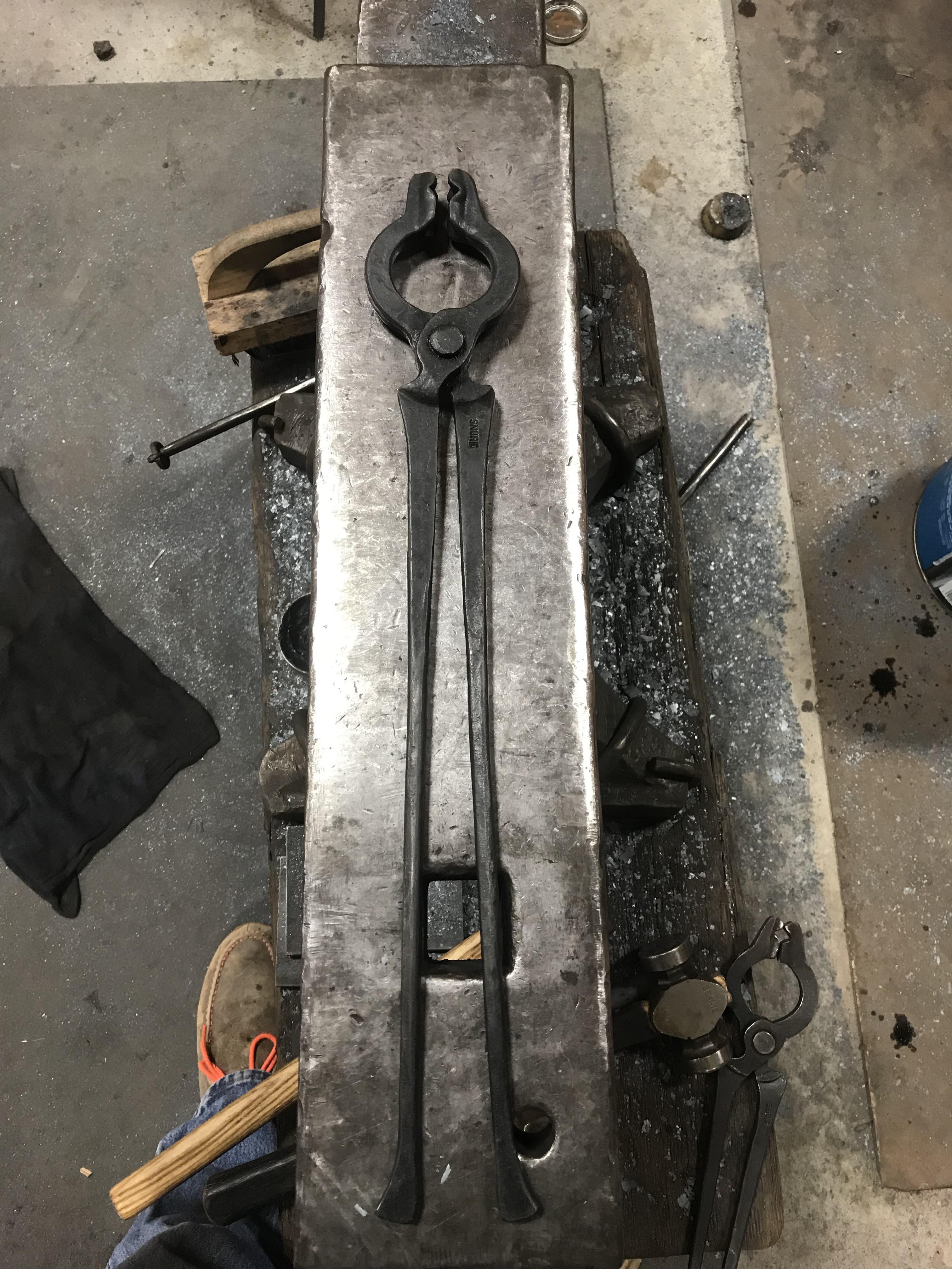

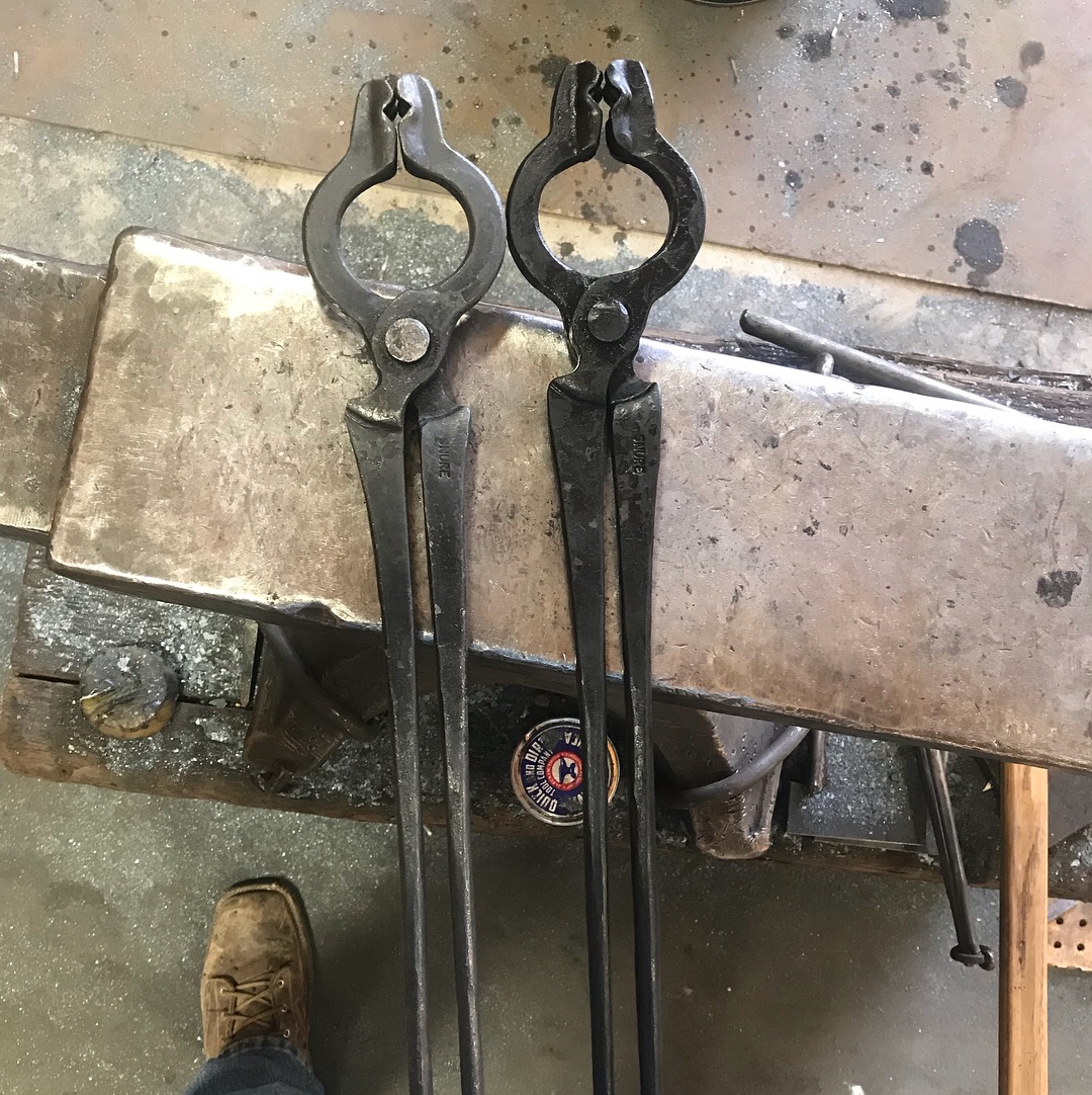

Ranchmanben Posted December 3, 2017 Share Posted December 3, 2017 Got the other pair of tongs done today. Managed to get them to match fairly closely. Quote Link to comment Share on other sites More sharing options...
JustAnotherViking Posted December 3, 2017 Share Posted December 3, 2017 Very nice! I seriously need to get a decent pair of tongs made. I just about got my first pair put together but the reigns were far too thin. It only took about 8 attempts to get two pieces I could rivet together after disasters such as stress cracks, burning in half, setting down on the wrong side... Pretty much anything that could go wrong did. Grip too tightly and they just bend. Oh well, practice and all that. Anyway.... After a weekend of thoroughly testing out bottle openers for quality control purposes, I decided to do something different this morning. Quote Link to comment Share on other sites More sharing options...
