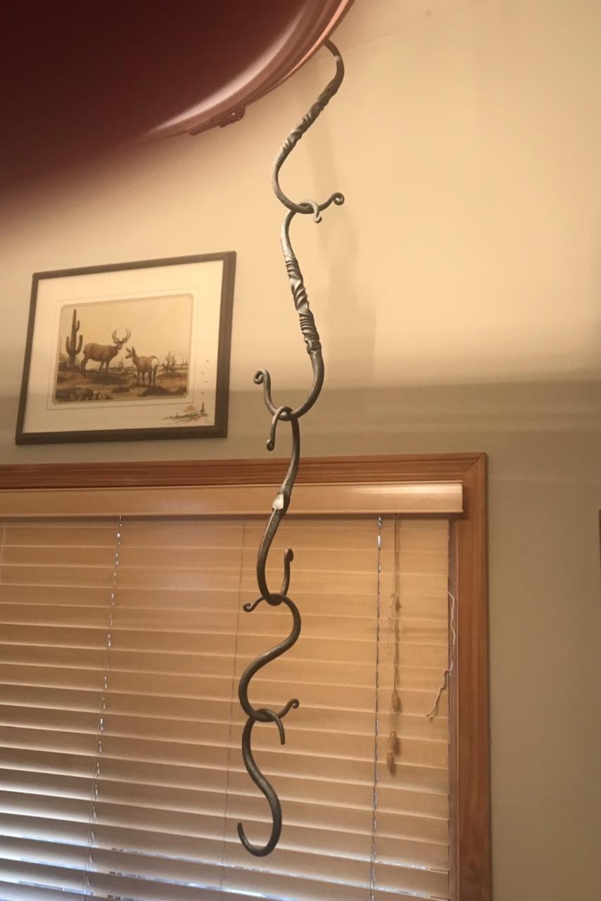

Forged a nice plant hanger (commissioned by a friend for her mother’s birthday).
Realized during painting that it could also look quite nice upside down.

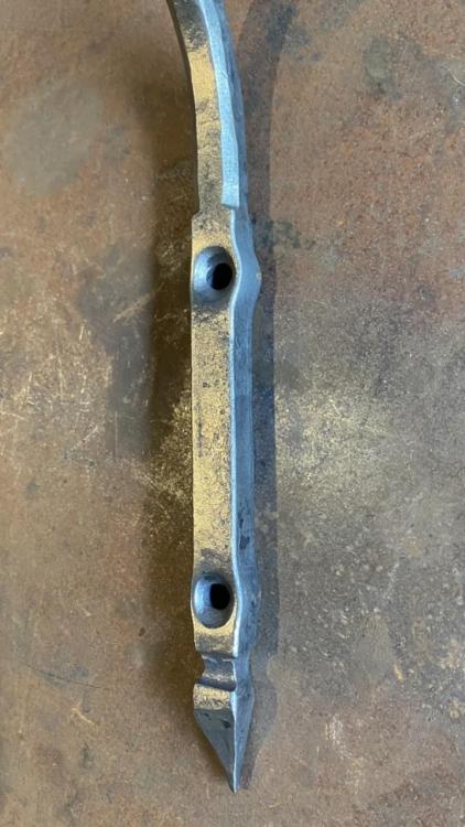

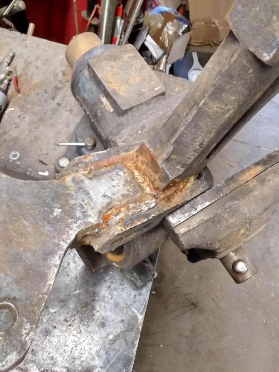

Also welded a bracket (made out of bed rail) to the stand for my small swage block, to hold it when I’m using its stand to support one of my hollowing forms.

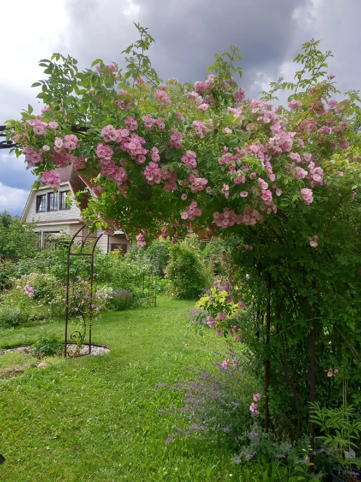

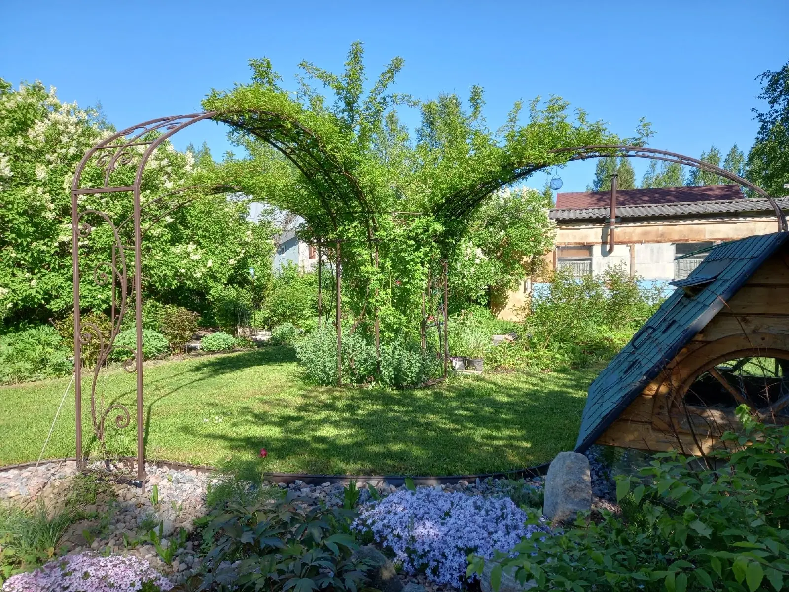

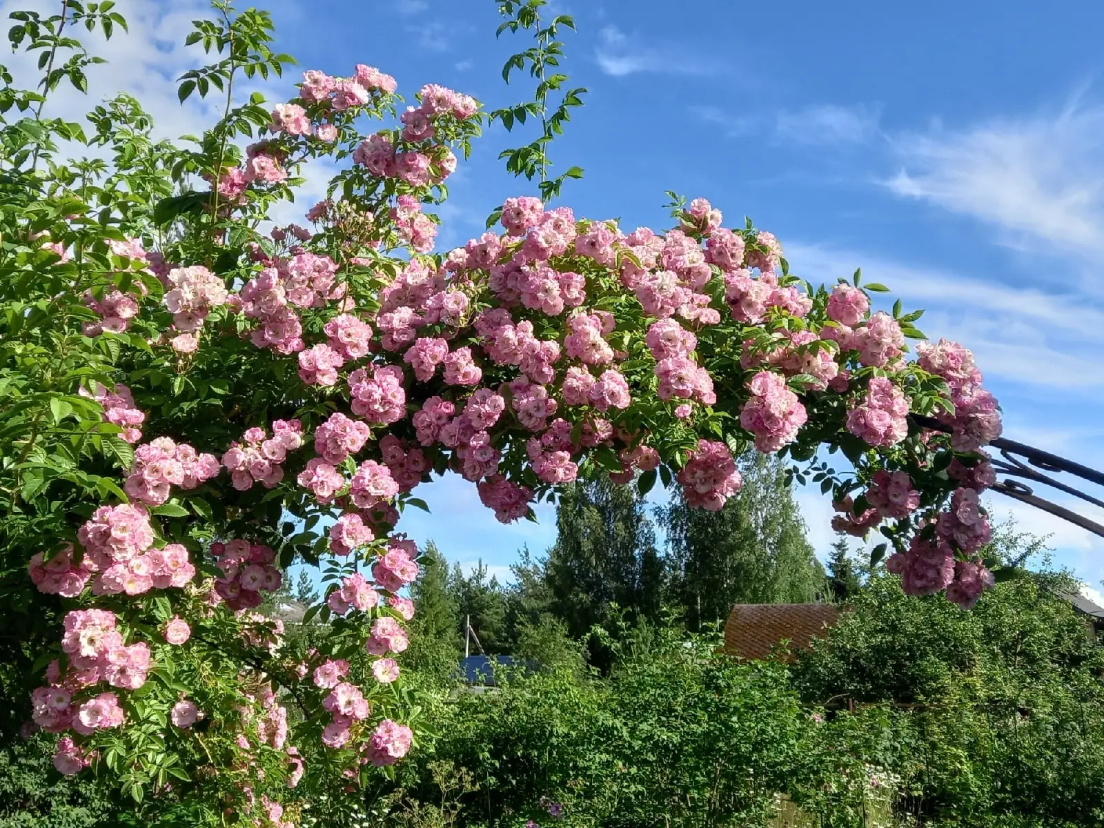

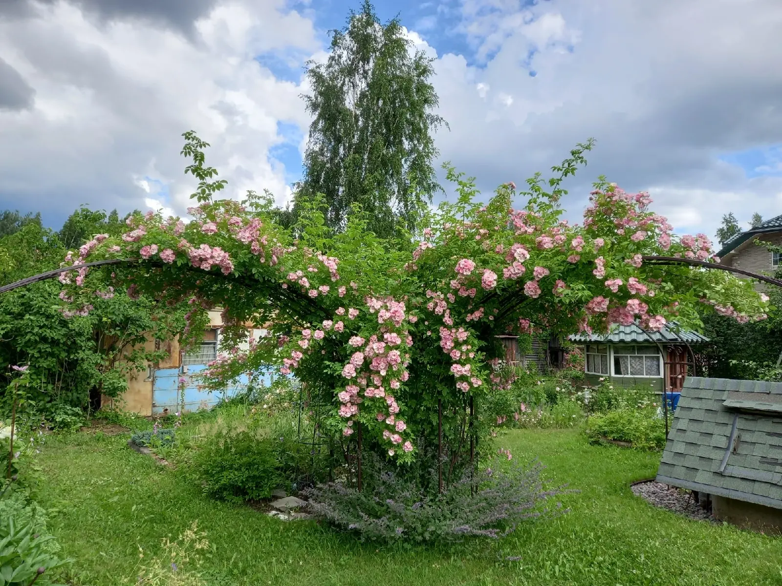

John, that plant hanger looks really clean. I think I like the "upside down" perspective better. Alexandr, those roses are stunning, I should plant some around my yard. I have a lot of issues with deer though, a few years ago I planted a few hundred dollars worth of azaleas, and the deer tore them up like they were candy. I thought they avoided plants in the Rhododendron family, but I guess not.

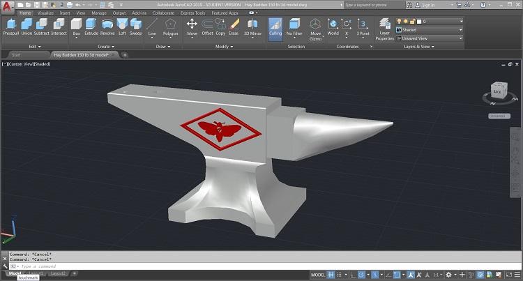

Yesterday and today I worked on 3D modeling my 150 lb. Hay-Budden anvil in AutoCAD. I added my touchmark and my shop initials. I'm going to continue working on the model; I plan to design a casting mold complete with risers, runners, etc., get it 3D printed, and start casting paperweight-sized anvils from aluminum and bronze.
The model is pretty close to the actual dimensions/shape. The heel slope and the horn are a little off, but I had to make some concessions based on the behavior of the CAD program. The "Loft" tool in AutoCAD can be fun, but also infuriating at times. I think it turned out pretty well though. One of these days I'd like to draw up a bunch of different styles and brands of anvils.

Beautiful pallet scraper Mothman I'm looking forward to seeing pics of the anvils the renderings look good.
That's a good looking hanger Pedro you might not need to close the scroll to hang upside down but closing it a little won't hurt a thing.

My roses bloomed almost 2 months ago, but i am a bit further south than St. Petersburgh though. Different zone. my daughter has been this week collecting the hips. For what i am not sure. I know they are pretty high in i believe vitamin C and are used in a lot of herbal teas.
I like the plant hangers.

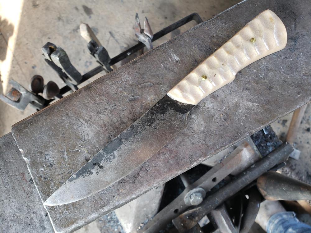

I'm in the middle of a knife build off between some friends. We all will forge a 5" blade and then torture test them. We also are forging a gift to give to the winner. We have throigh the month of July to forge our blades and gifts. We will have the torture test in August and the winner will choose the next forging challenge to make. I finished my knife and started on my gift. It will be a little camp ax out of some trailer axel. After 2 laid back nights of forging, I have it to the annealing stage.
The knife is made from 8670 btw. My first time forging and heat treating that alloy, but I must say I'm really impressed with it so far. The test to failure in August will tell....
