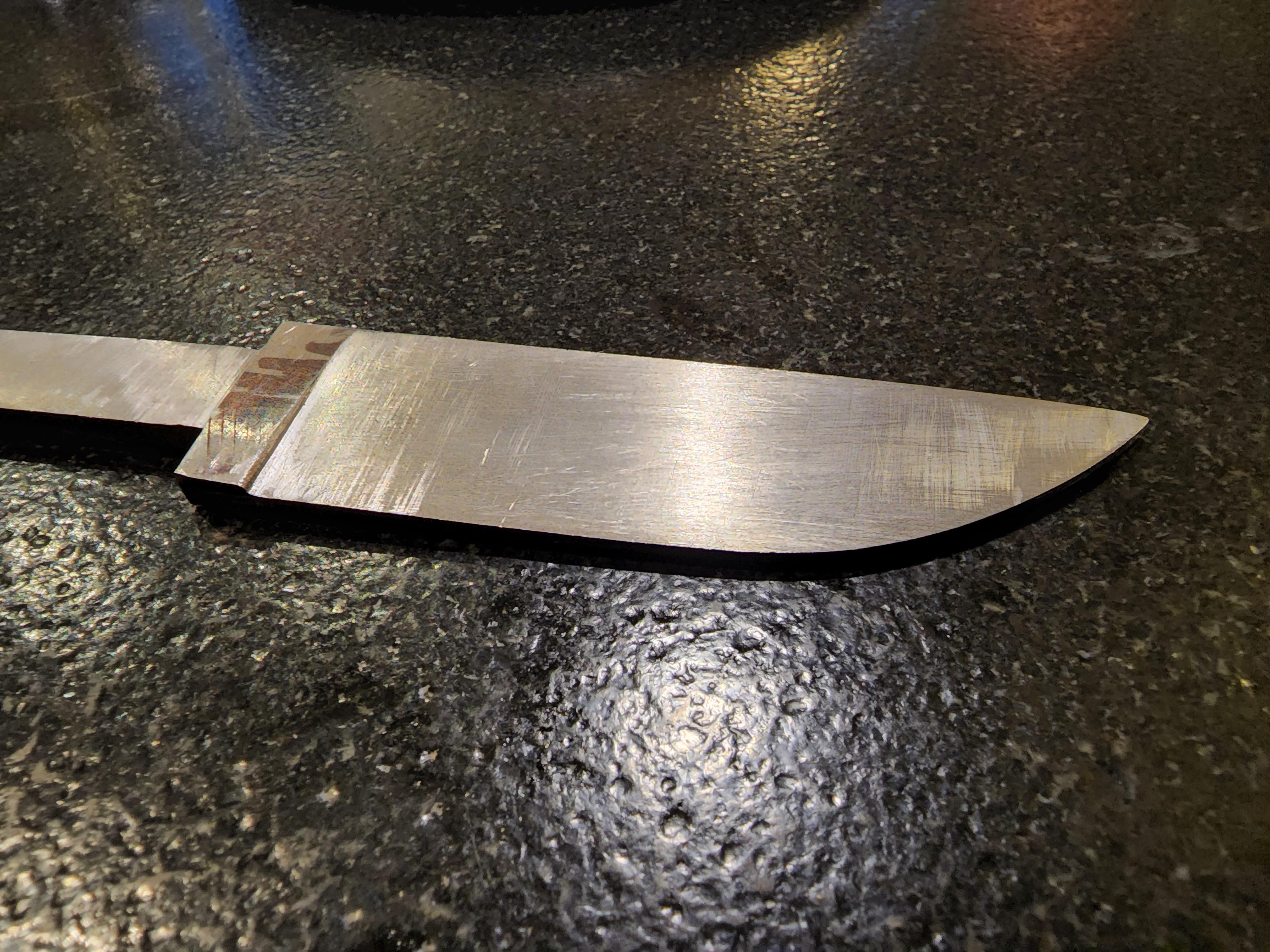

Finished filing the bevels on my first knife. It's going to hopefully end up a puukko style knife, wasn't intending a full grind, but I screwed up the plunge lines so I had to file further up to hide it. Need to heat treat it now, it's made out of a Nichols file, any ideas how to heat treat it? I have left it very thick because I am terrified of melting the edge in my coal forge

Heat if to a point where a magnet will not stick to it (about medium red, usually) and then quench it in vegtable oil.  Plain old cooking oil from the supermarket will do (whatever is the cheapest).  Then, with a file or grinder get it down to to bare metal and use a propane torch or above the fire in your forge to temper it.  I like a differential temper where you heat from the spine and let the colors run across the blade.  Stop (quench) when the edge is about straw color and the spine is blue.  It takes kind of a delicate touch and you might want to practice on a similar size and shape of mild steel until you get a feel for the technique.  You can practice multiple times with the same practice piece, just polish, grind, or file the tempering colors off and do it again.
If you heat slowly and keep your eye on the colors in the forge fire you should not have a problem with burning the edge.  You can use the same practice piece to practice heating the final piece.  BTW, if you overheat a piece of steel you will burn it, creating lots of sparks, not melt it.  Try to do so with a thin rod or piece of steel wire (like a coat hanger) so that you know what over heating looks like.
Good luck.  IMO the forging and heat treating of a knife are the easy parts but the fussy work of polishing and making and fitting a hilt and guard are the tedious parts.
As it's winter down there, preheat the oil to around 140 deg *F* / 60 C and draw temper IMMEDIATELY after hardening!
To avoid  burning the edge you can take a piece of black pipe, (non-galvanized), close off one end and bury it in the hot coals and make a muffle furnace. Add some powdered charcoal as an O2 scavenger  and place the blade edge up in it and watch while it heats.

I had to scrap trying to heat treat it today, as I noticed that the tip wasn't centered and one side was more filed that the other. It just made it looked warped when you looked down it. I decided to fix it now, rather that post HT when the steel would be harder

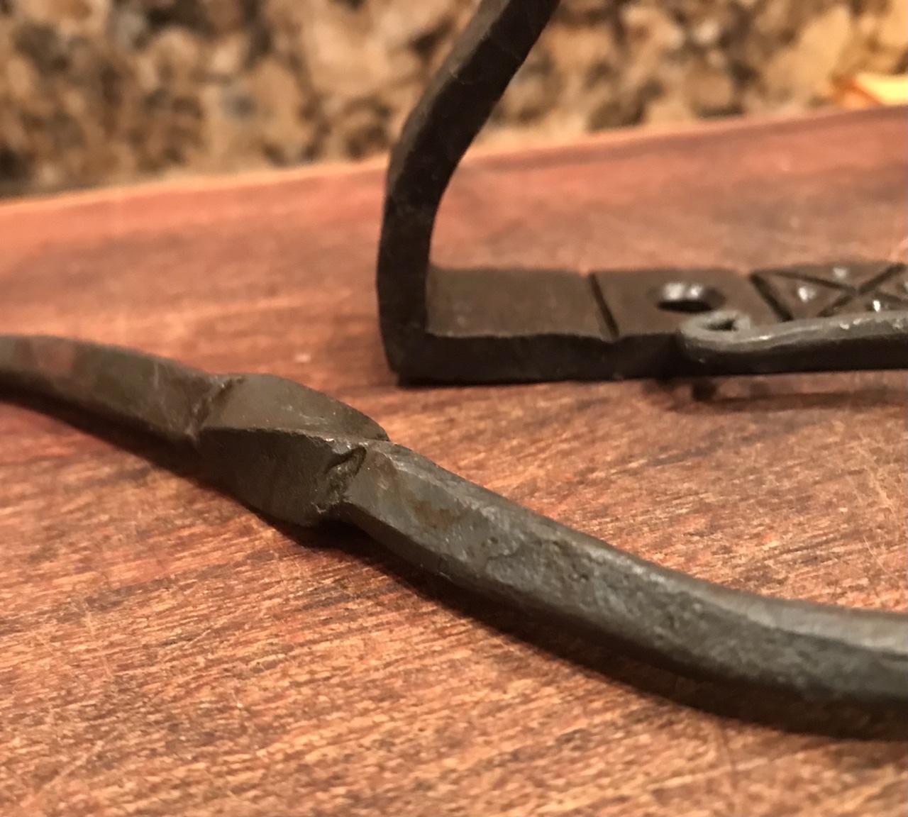

Its been a few weeks but got home early enough to make a couple hooks. I am really happy with the square corner. Was fun and hope to get at lease one more session this weekend (wifes out of town)
thanks for looking

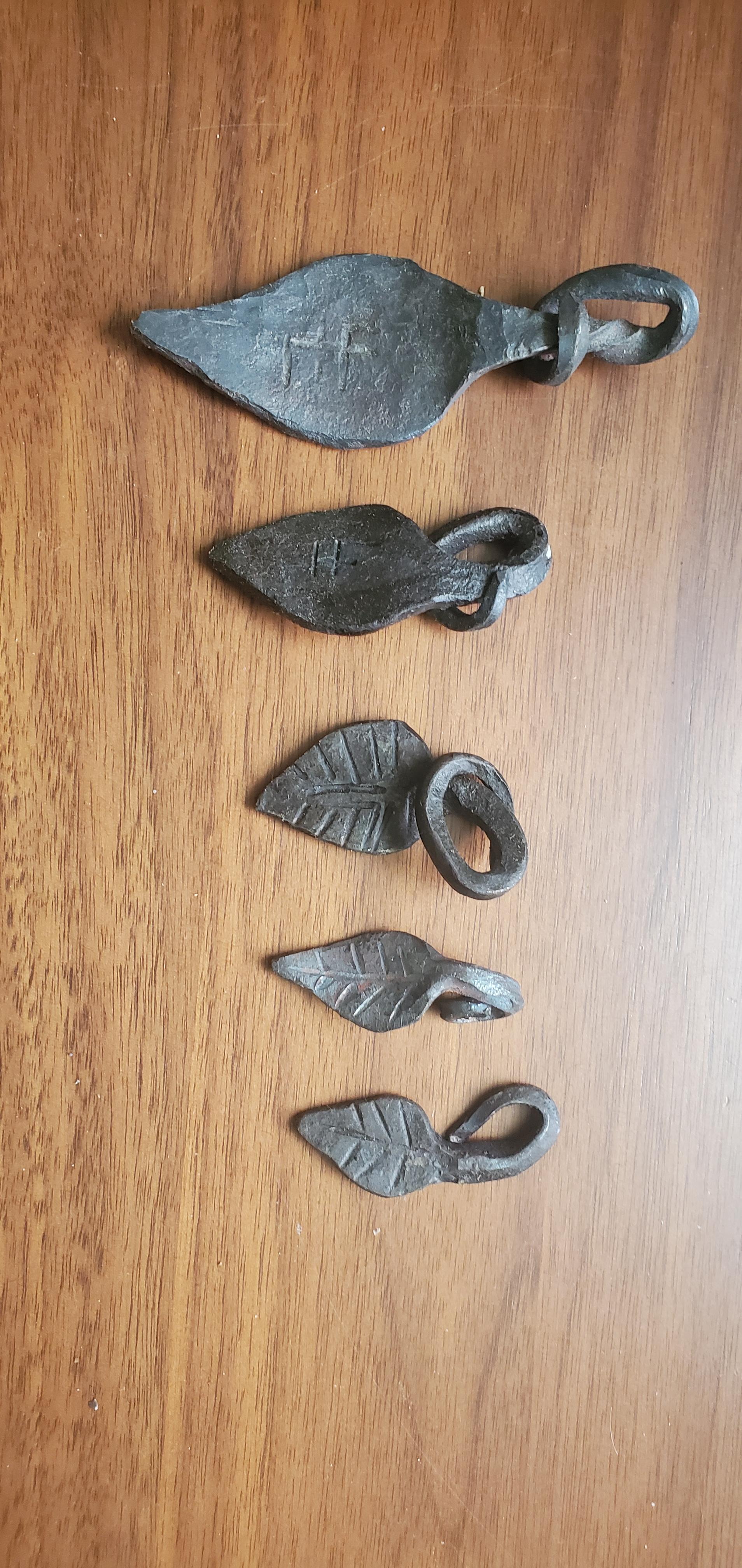

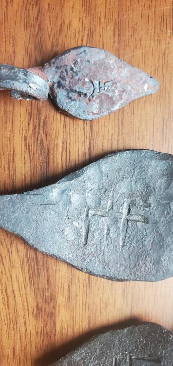

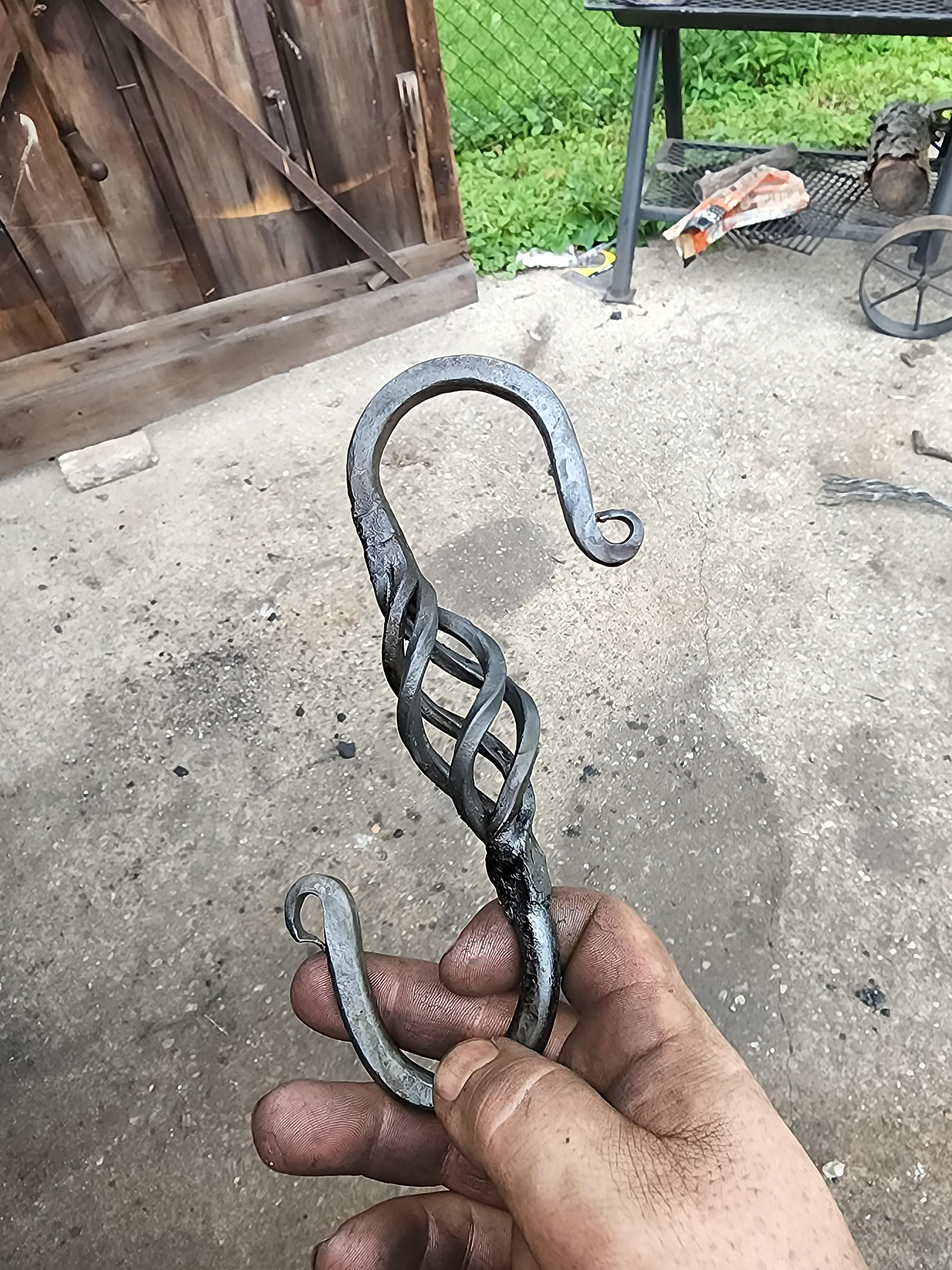

Made several basket hooks today, I've got the number I want for my both at the craft show now so I'll move on to the next set of items.  This was fun to see though.   I tend to give my gf stuff that I make, my first rose, and apparently I gave her a couple leaf rings when I first started making them.  Check out this progression,  I was actually shocked at how clearly I progressed on them.
Nice, how much do the baskets hold? :rolleyes:
You're working them a little too hot or not brushing hard enough. You're getting pretty good at leaves. Keep it up, you're getting better fast.

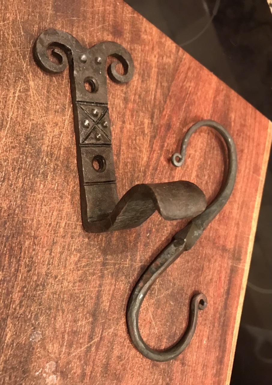

Well,  I've hung off of one of the big hooks... these are just basket twist s hooks,  I went with 1/4 inch for the twist and 3/8 for the ends.  I drew out the center after I welded them and squared them off.  I'm happy with the look.   I sold several last week when I did a demonstration so I decided to make more.
