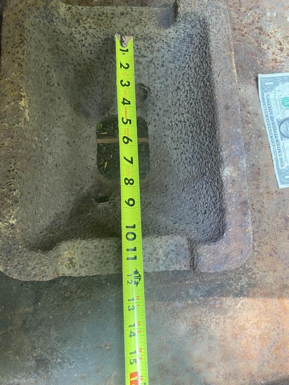

  3. Twistedwillow, I will pm you soon with some dimensions and we can discuss further. frosty, thank you! I just got up from a night shift and this is all very good information. I don’t intend on doing it in the next week or two, I plan on really laying this all out before tackling it, so much of this is new and unfamiliar water for me. That being said, I do have very minor experience with coal. I have a lot of reading to do and than it’s all hands on. I do intend on doing “larger” stock but that is a relative term. I would like to get into some hammer making and ultimately, would like to start doing grills, grates, doorways, railings. I want it all! I wanna learn it all!!! Fire and Metal and hitting things with hammers! Lol what is the work life of a clayed forge pan, usually? 3-5 years before relining? I’m just taking a guess, I really don’t have any clue.

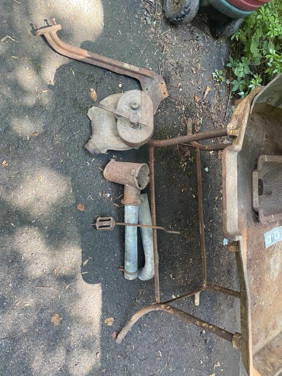

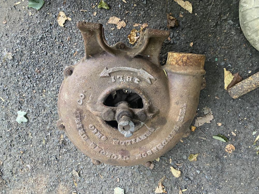

  5. Daswulf, Never heard of the stuff but I am positive, just by the name, I’ll be solid with that, I have Zero intention of painting the inside of the pot but I’m thinking a good coat of that stuff on the underside now and again wouldn’t hurt any…Any time you are in Bucks County, PA you have a cold beer and some hot iron waiting. The First 2 pictures are the broken blower, the second 2 are what I intend to replace it with. I’ll need to find an adjustable speed 1hp motor to run the blower but, everything in its time and place, no use getting too far ahead of myself. I can’t imagine running this monster on a hand crank, no thank you. As a note, the pipe diameter on the broken Lancaster is 3inch. The Sanderson is 3.5inch. I am wondering if at least lining the firepot with satanite is wise for overall longevity

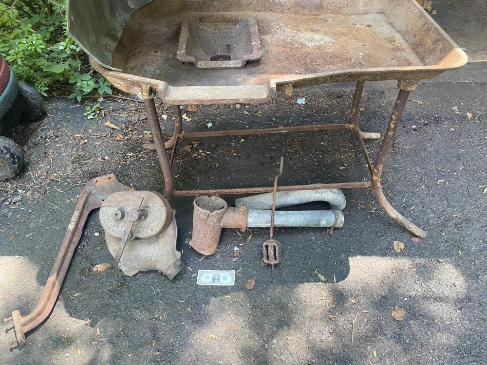

  6. George! Thank you for the siege advice. I don’t know if it’s quite ready to just start running but it is darn close. I agree, perhaps, once the rust is off the bed, refractory mixed and poured would add a good layer of both heat resistance and durability. The hood definitely had a few minor holes/cracks that I’m sure smoke and all those good gases will seep out through. It’s funny that you mention tinners rivets, kinda looks like that is what is holding the hood together currently, lol. Is there a recommended gauge of sheet for the hood? Obviously I don’t want something too flimsy. I know it will need to be big enough to handle the draft and I would think the one on there is a good reference but, without running it, I can’t really know for certain. It is a Lancaster blower! I know I can get it moving, ATF is what I used to gently lubricate the gears in the last one I brought back to life. I think the killer is the multiple cracks in the gear housing, the air connect, and the mount for the arm to the forge. I can get more pictures up soon.
  7. I was encouraged to start a new thread so…here we go! I recently purchased a coal forge as I want to being the process of transitioning off of propane over the next few years. She is huge 43” x 32” x 32” (overall dimensions) 8” x 10” (fire pot) In regards to clean up I intend to : -soak what I can in evapo-rust -wire brush with angle grinder -hit the rough outer edges of the bed with a flap disk -redrill the holes for mounting/reattaching the clinker breaker and ash vent - paint the outside underside and legs (at this time) prime and paint with rustoleum -I am considering, once the coal bed is rust free, painting a few layers of Satanite over it, is this wise? Should I do something else entirely? Or change my plan of attack? -hood will need replacing, it’s pretty rusted through in some areas If there is something I absolutely should not do, please let me know! The bed is marked 41-42, I am guessing it’s manufacture date? I want to preserve history and bring it back to life, not ruin it irrevocably The blower looks like toast, maybe good for parts down the line? It’s missing a big chunk and is seized pretty well. I have restored a blower in the past, we will see what comes to fruition. in the last 2 pictures, to the left of and slightly behind the blower, is an arm that bolts to the belly of the forge and holds the blower. Has anyone ever seen a beast like this? What are ya’lls thoughts on this beast and what I can/should NOT do to bring it back to life? Love, Peace, and chicken grease!
