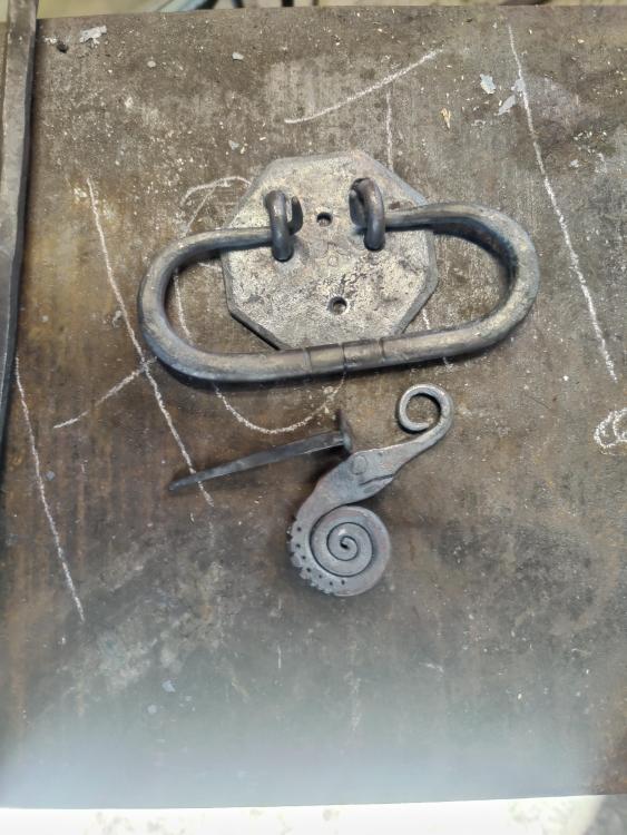

Thomas, i usually would say the "HC" means higher carbon, not high carbon. Yeah they aint ideal but it came down to what i had on hand. I only need to make about 20 small nails that are just for decoration, so far i got 2 made. I drilled a small hole to start then broached with a small square punch, i will definitely keep in mind that masonry nail trick if i need to make a more permanent one though.
I got a few more spike that i am going to cut the heads off, drill and tap a hole, clean up any rough spots and finish to make drawer pulls out of. I thought they would be pretty cool especially for a garage or work shop and so did a few other people.

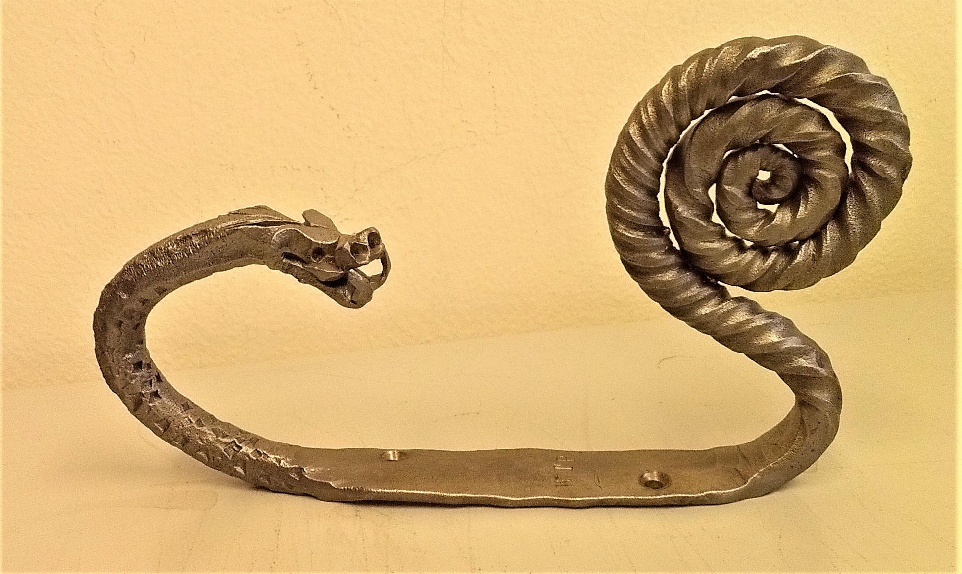

Anywho, not much did. Made a nail, finished my chest handle, then made a dangly for a necklace for my daughter. Celtic style dragon.

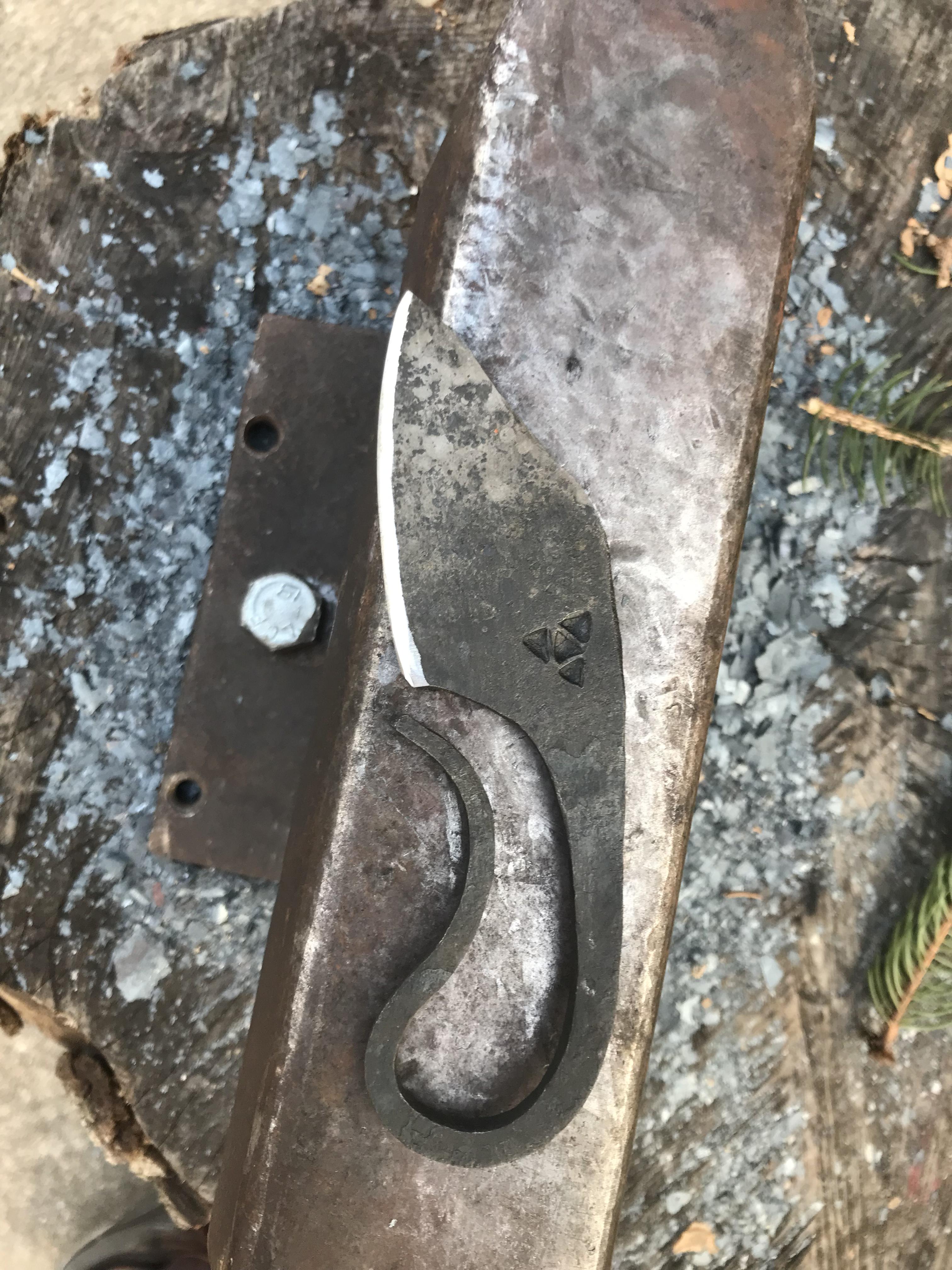

Got a few hours in today, and it went pretty well! While I burned one project, I’d just started it, so it wasn’t a biggie. Other than that, I felt I had really good fire control all day. I got a few knives done. I really enjoyed doing this blacksmith’s neck knife, since the only grinding is in the edge. All profiling and beveling was done by hammer. Cutting edge is about 2.25”BC1DCDE1-BA78-4229-B28B-6A5C4DEAF0E2.thumb.jpeg.124a63f0cb01648f22bdb4535cba9e11.jpeg
That is a nice little blade.

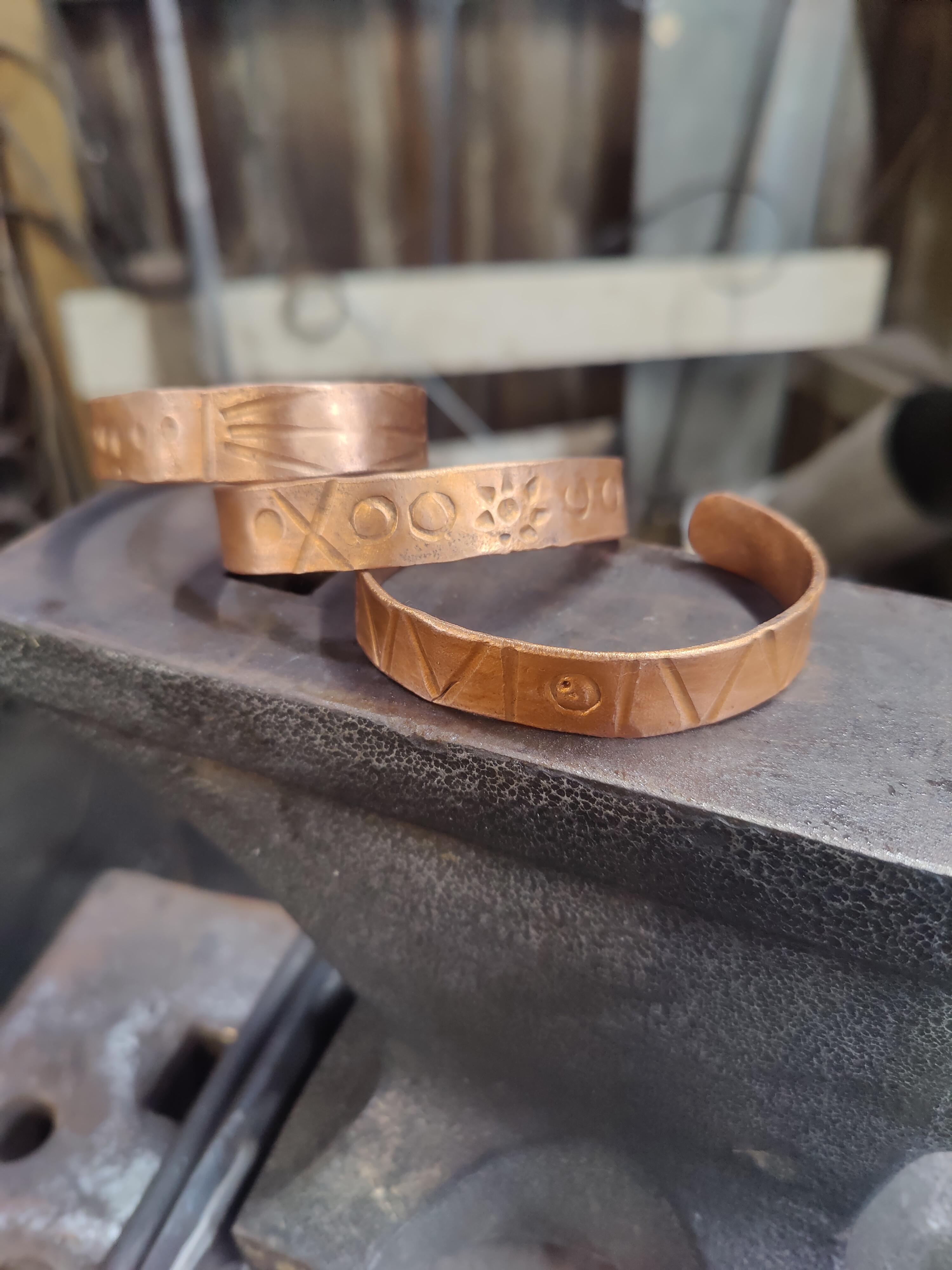

Billy, great job on the bracelets, are you going to flame color them?Alexandr, beautiful as always!
Billy, I really like those! It's a nice minimalist style! Alexandr, you always amaze me!

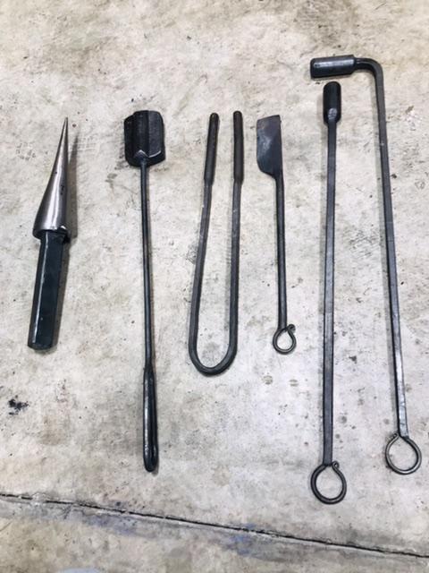

Still growing my power hammer tooling inventory. I also made the first not tooling item using my new hammer. That cone would have taken my days without the hammer. Still getting used to the power though, it’s not quite an even taper and has a couple “bites “ in it…C680BF74-1D75-4119-9CCD-E0AA16CD3D61.jpeg.544aff5f3aa16322ae2b0746c747444a.jpeg

Les, not sure how to flame color, i assume the name kind of says it all. These i just heated up some, put a little wax on then hand buffed with a rag when cooled.

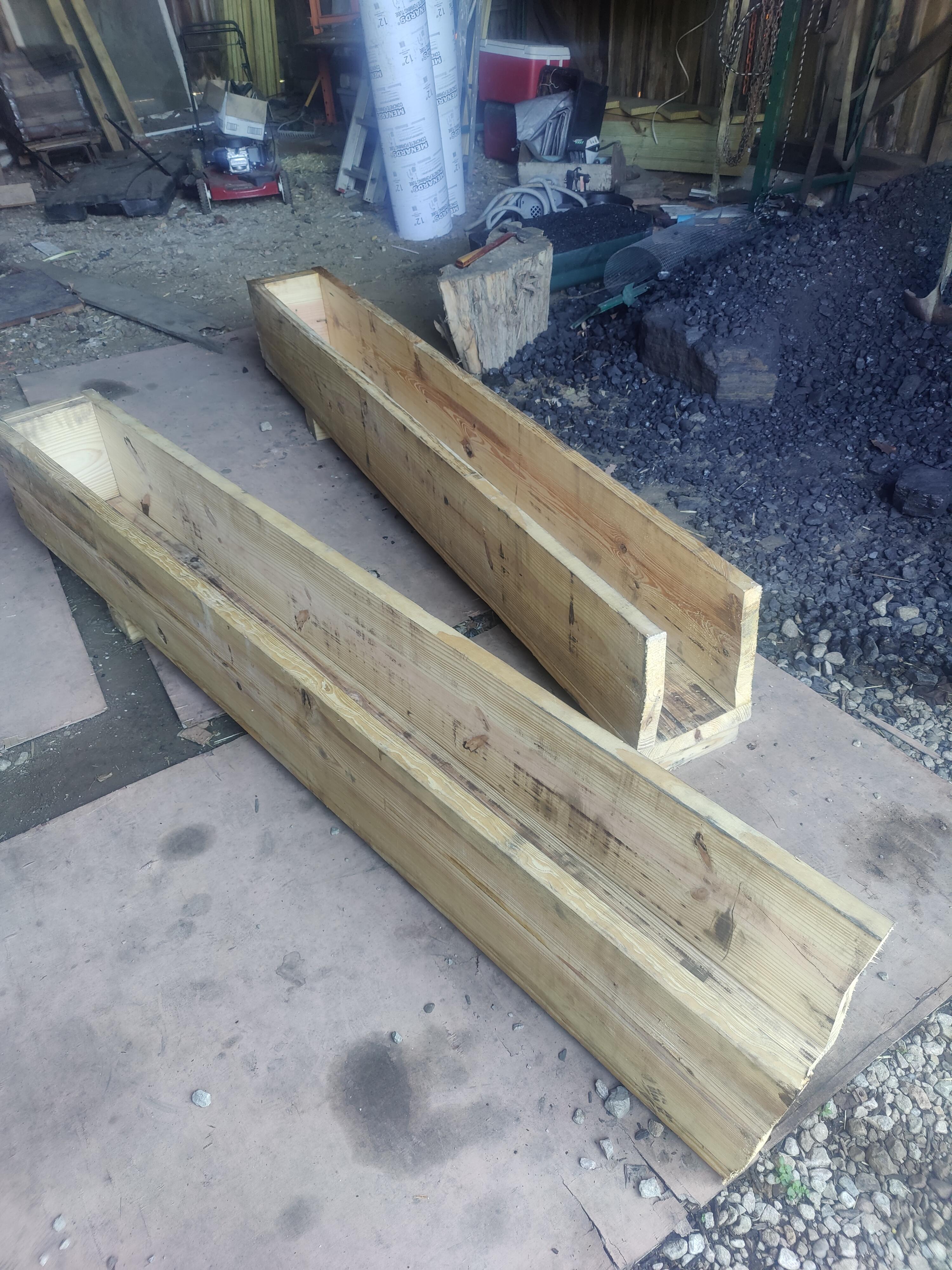

Got a new work bench, some assembly required. We got some bar stock at work and it came in a 16' box made from 2" x 10"'s. They were just going to throw it away. Unfortunately i had to cut it in half as it would have stuck out just a bit to far in my truck. So i got 6 8' boards for free.

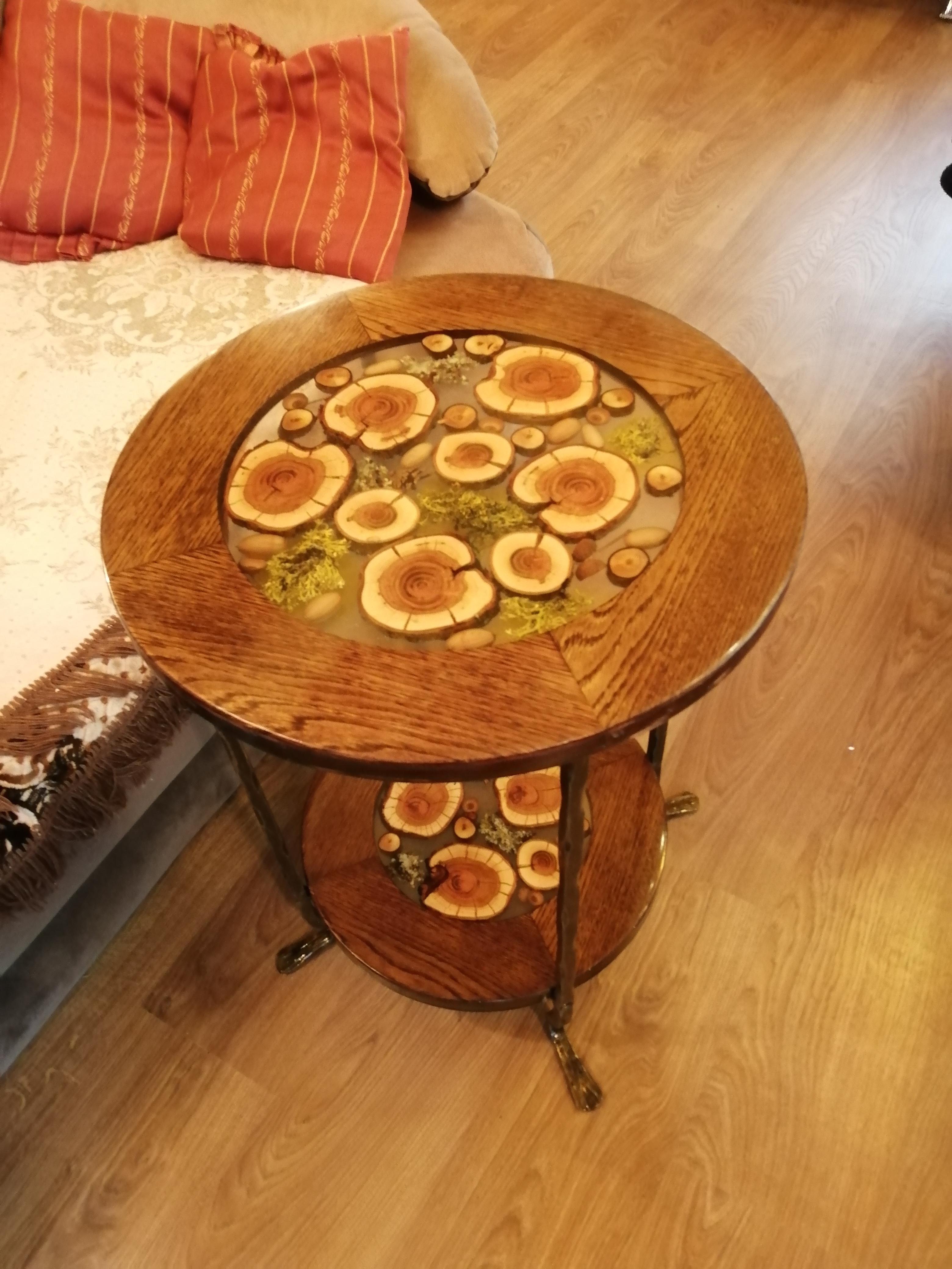

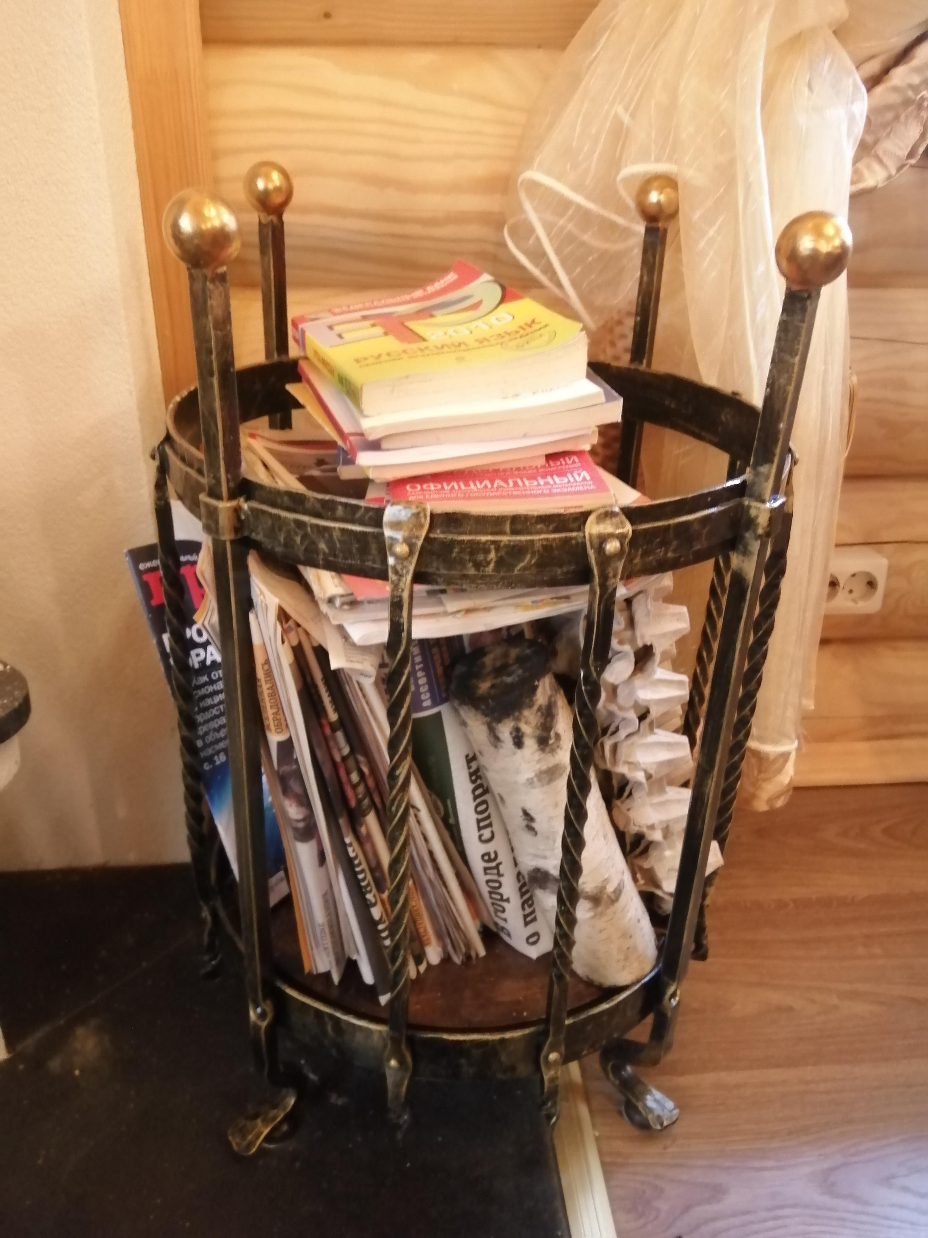

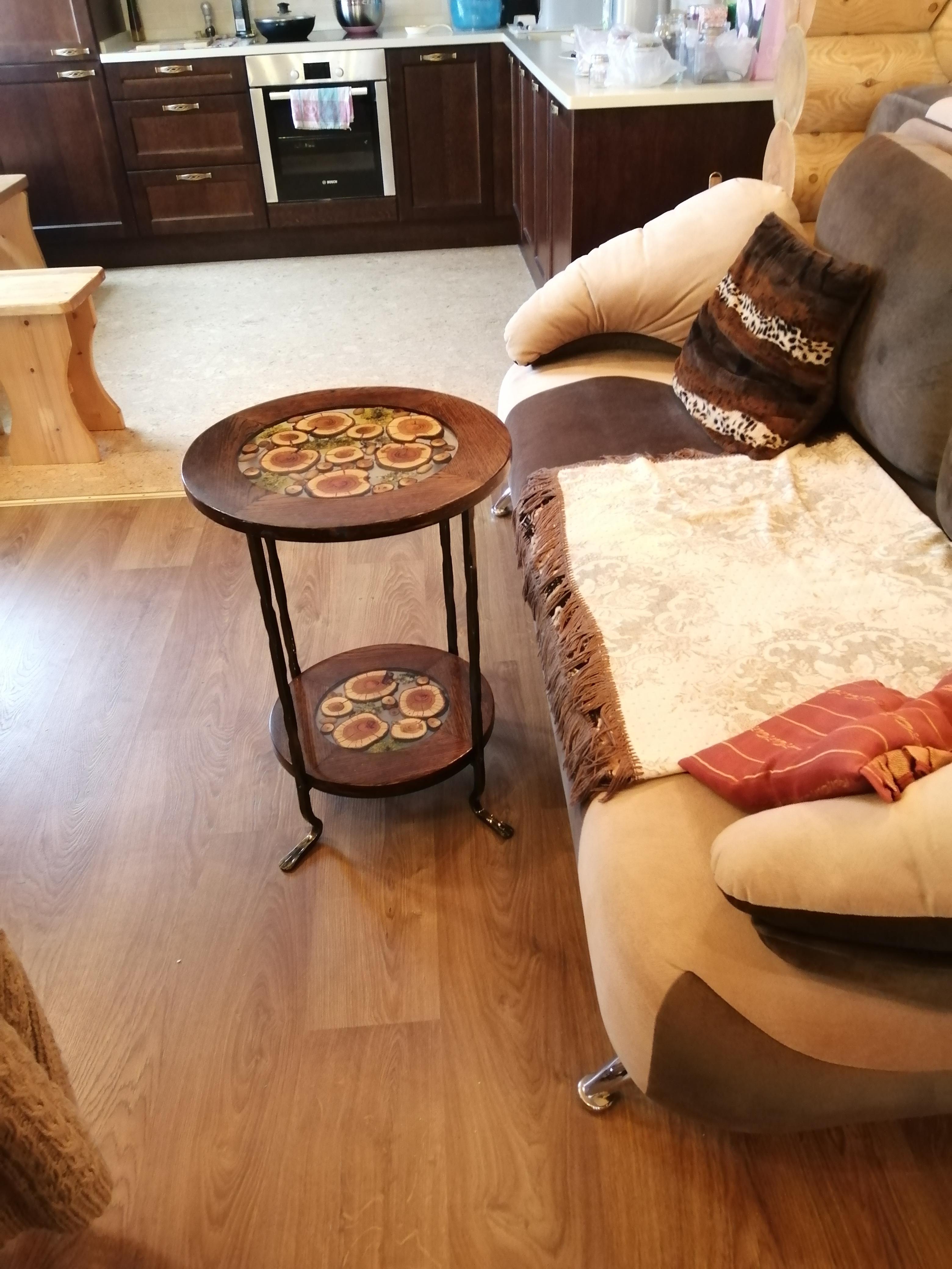

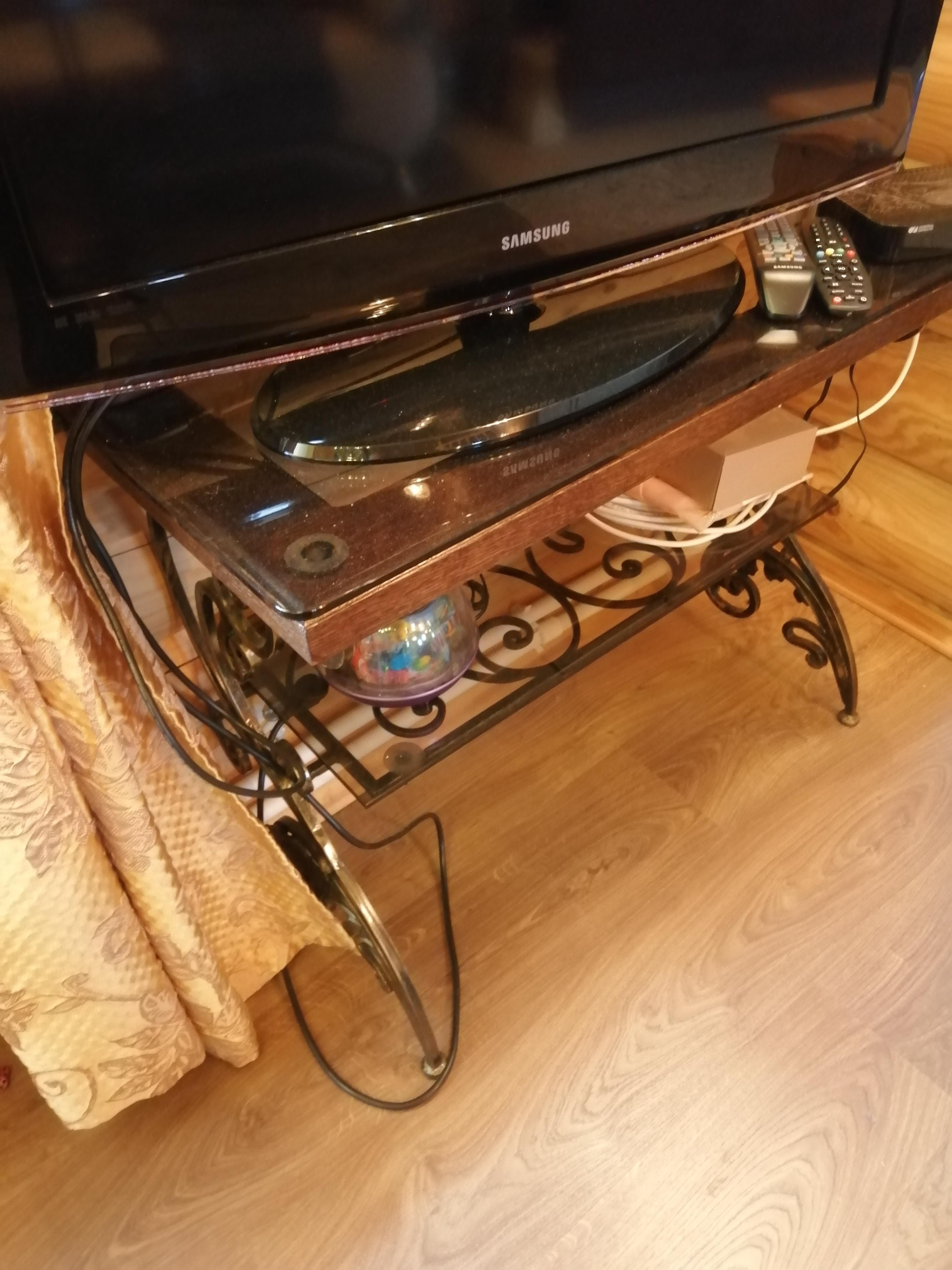

Moved the table to its place. Earlier in the same room I installed a chandelier, a firewood basket, a TV shelf.
