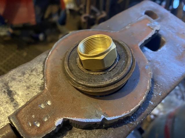

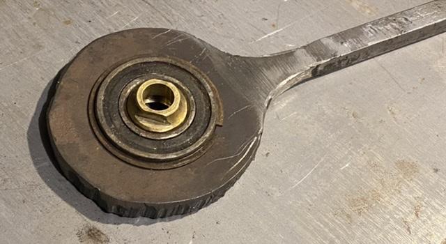

One of the reasons I got my oxypropane torch is to cut circles of sheet steel for making bowls. I've been looking at circle cutting jigs, but decided to make one for myself. Here it is:

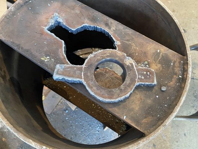

The scrap assembly that eventually became the base of the stand for a new anvil probably started life as some kind of wheel, so it had a piece of 1/2" plate on either side with a ball bearing press-fit into a hole  in the middle. I started by torching out a circular piece around that hole with a bit of a tab on either side (the second tab was intended for a design element that I ended up scrapping, so that got cut off):

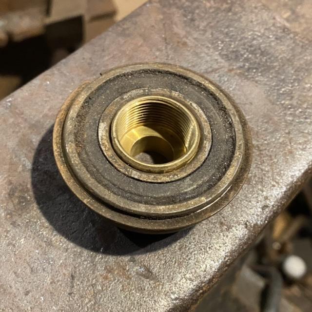

The next step was to get an extra of the nut that holds the cutting tips onto the torch:
The nut is filed to go inside the bearing, with a very tight press fit:
Flats are filed into the tip of the nut for a wrench, and a 11" piece of 1/2" square bar is welded onto the remaining tab for a beam:

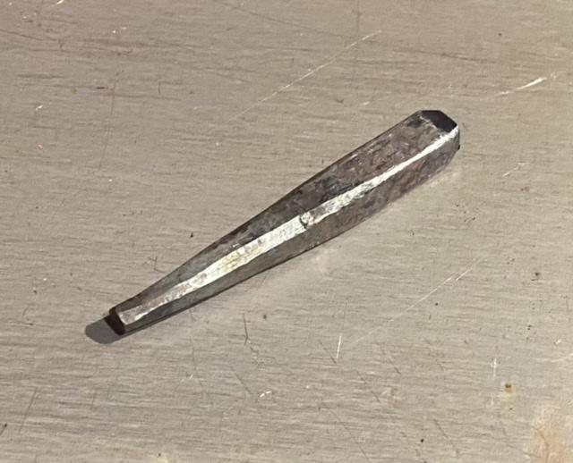

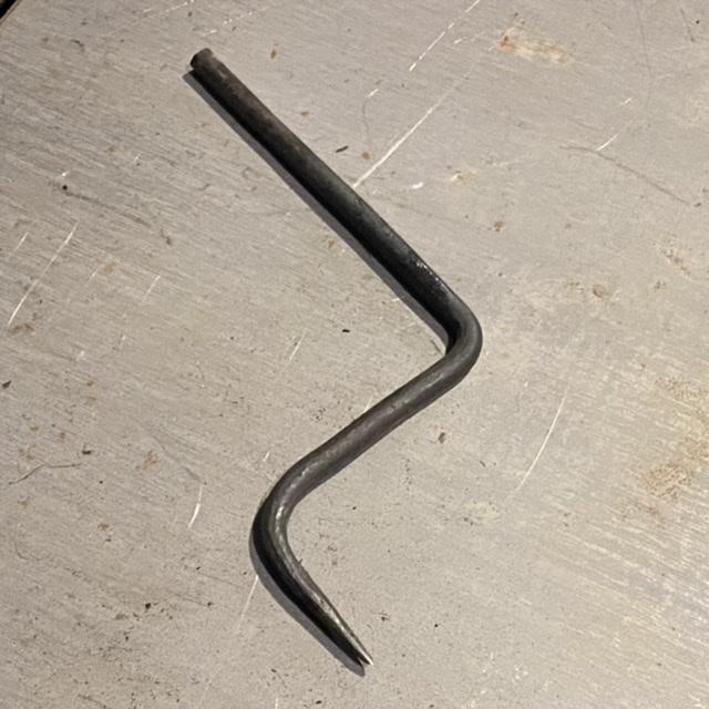

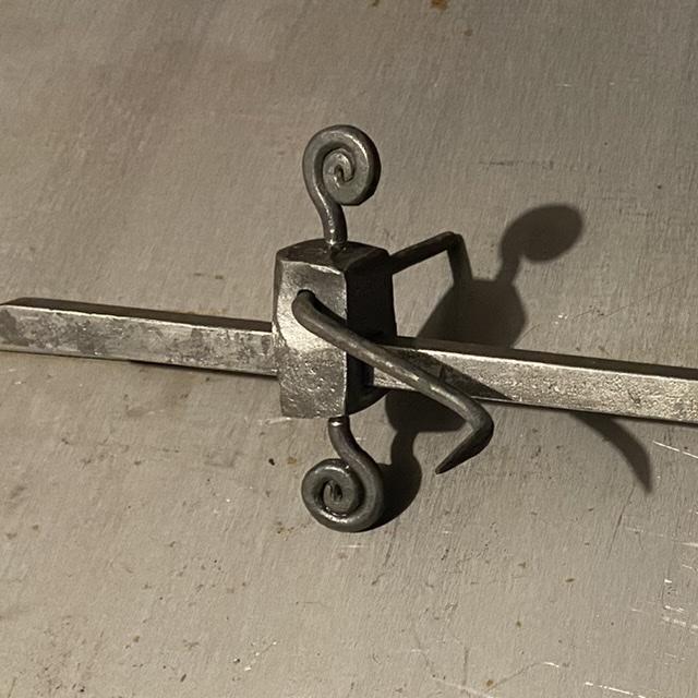

The pivot point is made from a piece of garage door spring, bent to shape, sharpened, and with the tip hardened and tempered:

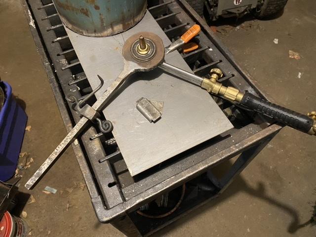

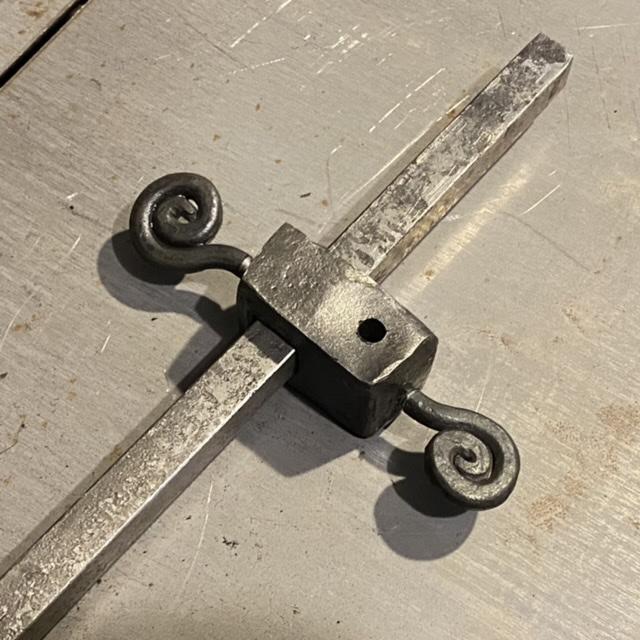

The pivot is held by a block that slides along the 1/2" square beam; both pivot and beam are locked in place with thumbscrews:
Another view, without the pivot:

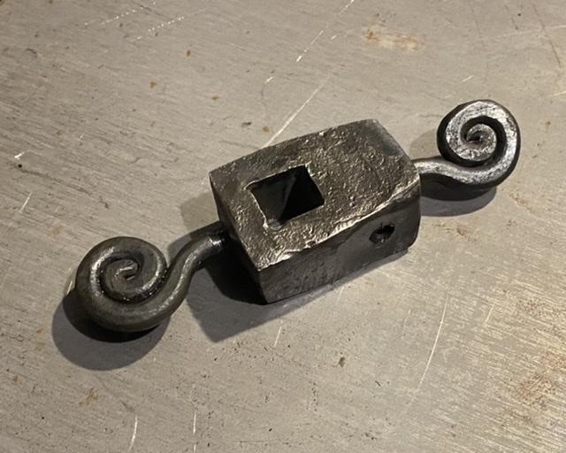

The block and its thumbscrews:
The hole for the pivot is drilled through, and the holes for the thumbscrews are drilled and tapped. Those holes and the thumbscrews are threaded to 12-24 UTS. The square hole was made by punching a 3/8" round hole, which was then squared with a drift made from the same 1/2" square stock:

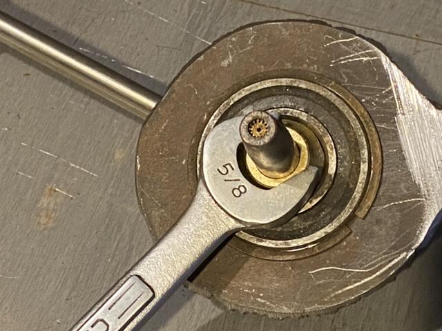

The jig is set up with the torch by putting the appropriate tip in the nut and tightening it onto the torch with a 5/8" wrench:
The pivot is set at the appropriate radius, and we should be good to go. Unfortunately, I discovered that I'd run out of oxygen, so I haven't had a chance to test it yet. I'll keep you all posted.

Nice circle cutter John. I  made one using lab bar clamps and steel tubing. There's no bearing to let the torch maintain orientation as you cut a circle but I was so used to turning the torch too it's not an issue for me. The problem I've always had was maintaining the correct distance from the work and the little steel wheels on commercial circle cutters never seem to work very well. I just bent a piece of 1/4" round in half so there was a rounded nub to ride the plate.

I like the idea of the rounded guide. I will give that some thought.
You could drill and tap yours for a piece of uplated all thread with a round end.
With a locking nut, perhaps. Interesting idea.

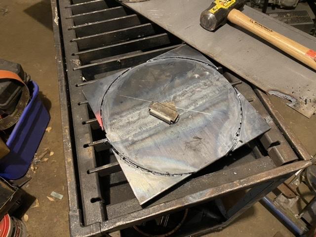

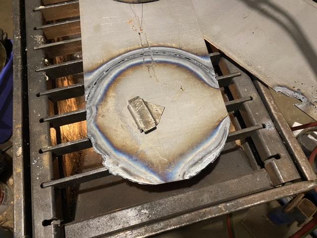

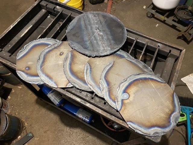

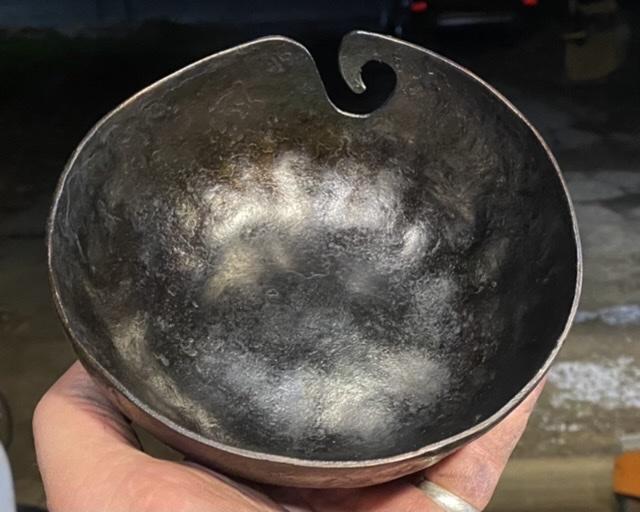

Well, finally put it to work. I’m still learning hire to cut in the first place, so things were a bit ragged at times. Nonetheless, it worked quite well cutting out a half-dozen bowl blanks and one for a frying pan.
John, what  thickness/gauge do you use for your knitting bowls and what diameter are the blanks?  From the photos I would guess about 6-8".  I know several knitters who would appreciate them.
Thx.
GNM
More like 8-9” in 16 gauge. Now that my wife is getting her yarn shop (named “For Ewe”) up and running, it looks like we’ll be selling these through her website.
Getting there John. Going fast is the secret but it takes practice.
Getting the torch properly adjusted helps too.
Oh yeah. I never did get fast enough to really make my torch work like it can.

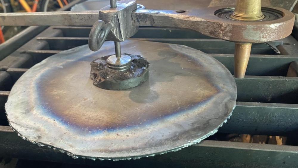

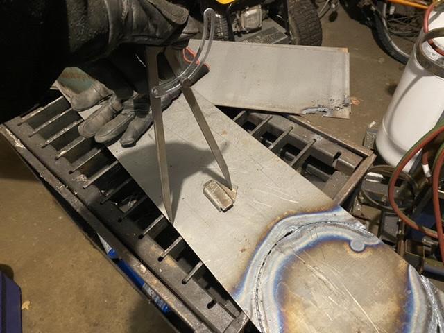

Update: The center-point holder turned out to be not particularly accurate and prone to shifting. I tried doing a small divot center-punched directly into the metal, but that wasn’t great either. Yesterday, I had a bit of a brainwave and built this:

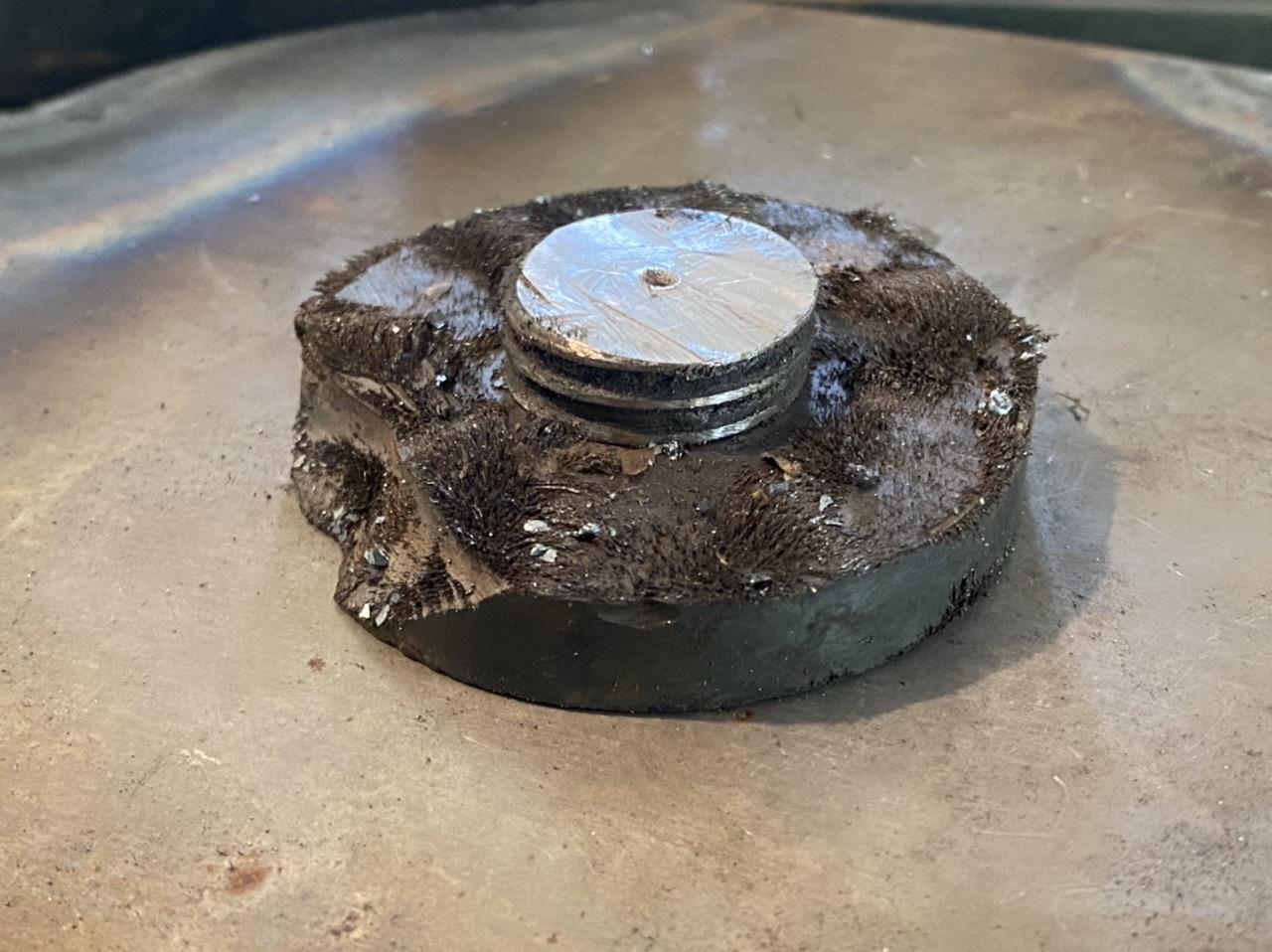

This is the magnet off a Harbor Freight magnetic part dish (although a small speaker magnet would work equally well), with a piece of 1” bolt ground to a tight friction fit. The bolt has a divot in the center to take the pivot pin from the circle guide:
Since this raises up the point of contact rather significantly, I’m not using the dogleg side of the pivot pin, but instead sharpened the straight end to fit the divot. It works very well, and I can just stick it on the side of the cutting table when not in use.
A good way to prevent a magnet from shifting on flat material is to squirt a bit of silicon calking on it and spread it very thin. It forms a very non-slippery surface, it's a trick I learned from a mate on a State Ferry ride to Kodiak. The run is known for heavy seas but the dishes never slid off the tables, everything but the flatware was wiped with silicone calking on the bottom. It's dishwasher safe too.
I've suggested using a magnet with a center piece instead of making a divot in the workpiece several times over the years here,  Some speaker magnets have a central  hole in the keeper plate already.
