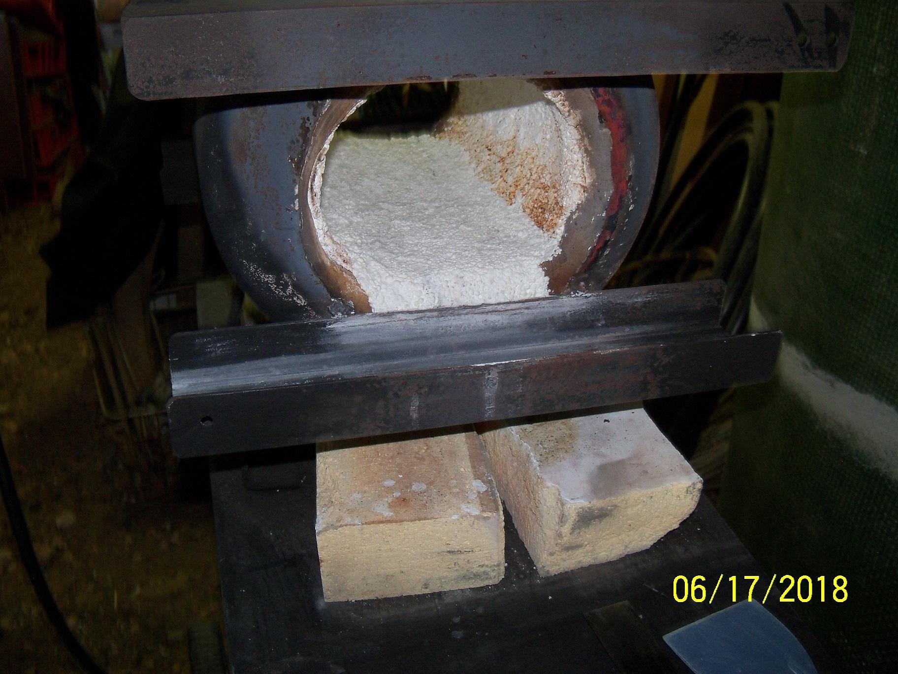

Gandalfgreen Posted October 8, 2021 Share Posted October 8, 2021 well we will call that a learning expierence and loss of money. 5lbs kastolite wasted had about half the forged covered reposition to do the rest and everything just fell off couldnt get finished before exceeded time recommended by manufacturer after being mixed. so I have learned this wont work without a form of some sort on a cylinder forge. 2 kastolite is not at all sticky like I thought and 3 need to save money and buy more kastolite once I figure out a form. guess back to the drawing board and more videos that didnt act like I thought it would at all didnt stick to anything lol Quote Link to comment Share on other sites More sharing options...
JHCC Posted October 9, 2021 Share Posted October 9, 2021 Sorry to hear it. You really do need to either do it in sections or have a form that will hold things in place. Quote Link to comment Share on other sites More sharing options...
Gandalfgreen Posted October 9, 2021 Share Posted October 9, 2021 Been sitting here and believe that I will have to do in section top and bottom. think I will buy some cotton backing cut a piece out that would lay across half the pipe. then lay down cotton place wooden half inch blocks around edge press in kastolite pick up cotton backing lay press kastolite into forge press into walls and leave sit. Guess being nervous this entire time was an omen haha Now heres a question will kastolite adhere to cured kastolite so when I go to do second half being the bottom half after top has cured. Quote Link to comment Share on other sites More sharing options...
Frosty Posted October 9, 2021 Share Posted October 9, 2021 You mixed up all 5lbs. then tried to line it in sections? I think you missed the point of lining it in sections in the first place. It won't stay in place in an overhang situation so you apply it so gravity holds it in place UNTIL it sets and hardens for a while. Kastolite only has about 30 minutes working time and starts to set up, another hour or so and it's hard enough to stay in position against gravity. If the Kastolite IN the forge is supposed to set in the expected time what did you expect the remainder in the mixing can to do? Next time mix just enough to cover the section you wish and leave the rest of the dry KOL dry. I keep it in a plastic bucket with the lid on. If you aren't sure how much to use cut a piece of paper that covers the area you want to cover with KOL. Lay that piece of paper on a larger piece and carefully cover it with the desired thickness of dry KOL. I'm just grabbing some numbers for an example don't use them. Say the floor is 4" wide x 10" long. You lay that piece of paper on a piece of newspaper and then cover the cut piece with 1/2" of dry KOL. Transfer the KOL to the mixing can/pot/whatever. When you add water KOL increases in volume a little so you have more than enough. Trowel it in pat it smooth and when it starts to get hard to work, stop and go have a snack, watch TV or something for at least an hour, 2-3 is better. Next session figure out how much you can roll the forge and present as much unlined blanket in a position where gravity will keep the KOL in place. Chock the forge so it won't roll and make another paper cutout pattern. Repeat the above process of covering the paper with the desired thickness of KOL. Mix, apply and leave it right where it is for a couple hours. If the section of hardened KOL appears to want to pull off prop it in place with some cardboard or sticks until the other sections will support it. Don't mix up 5lbs. when all you need is 1 1/2 per section. You wouldn't buy a 3lb can of coffee and brew it all up the next morning would you? Cook the whole dozen eggs when you want two? Hmmm? Frosty The Lucky. Quote Link to comment Share on other sites More sharing options...

Gandalfgreen Posted October 9, 2021 Share Posted October 9, 2021 what I thought in my head didnt work out. I thought it would work out where I could slowly roll my forge and the begining part would stick I soon realized immediately I should half mixed half as kastolite did not act as I thought. but nothing I could do then was too late so I tried my hardest to fight that battle but in the end kastolite won that battle but he shall not win the war round 2 will go to me. should have waited till day off in hindsight probally rushed a little as worked a long RUFF shift and should have rested first gone into with clear head. all lessons learned and gave my main man Frosty enough ammo to make me realize what a coyote of a move and should have been the road runner use my brain. Quote Link to comment Share on other sites More sharing options...
Irondragon Forge ClayWorks Posted October 9, 2021 Share Posted October 9, 2021 When we did our forge, I figured I could do the bottom half first. I divided the bubble alumina in half and mixed that up, applied it and let it sit overnight. Then turned the forge over and mixed the rest up and applied it, let it sit over night then fired it to finish curing it. It worked for us (YMMV). Of course we put it over cured Satanite but it should work over cured wool too. After using it for about a year I picked up more bubble alumina and added a flat floor. Still holding up well. Quote Link to comment Share on other sites More sharing options...
