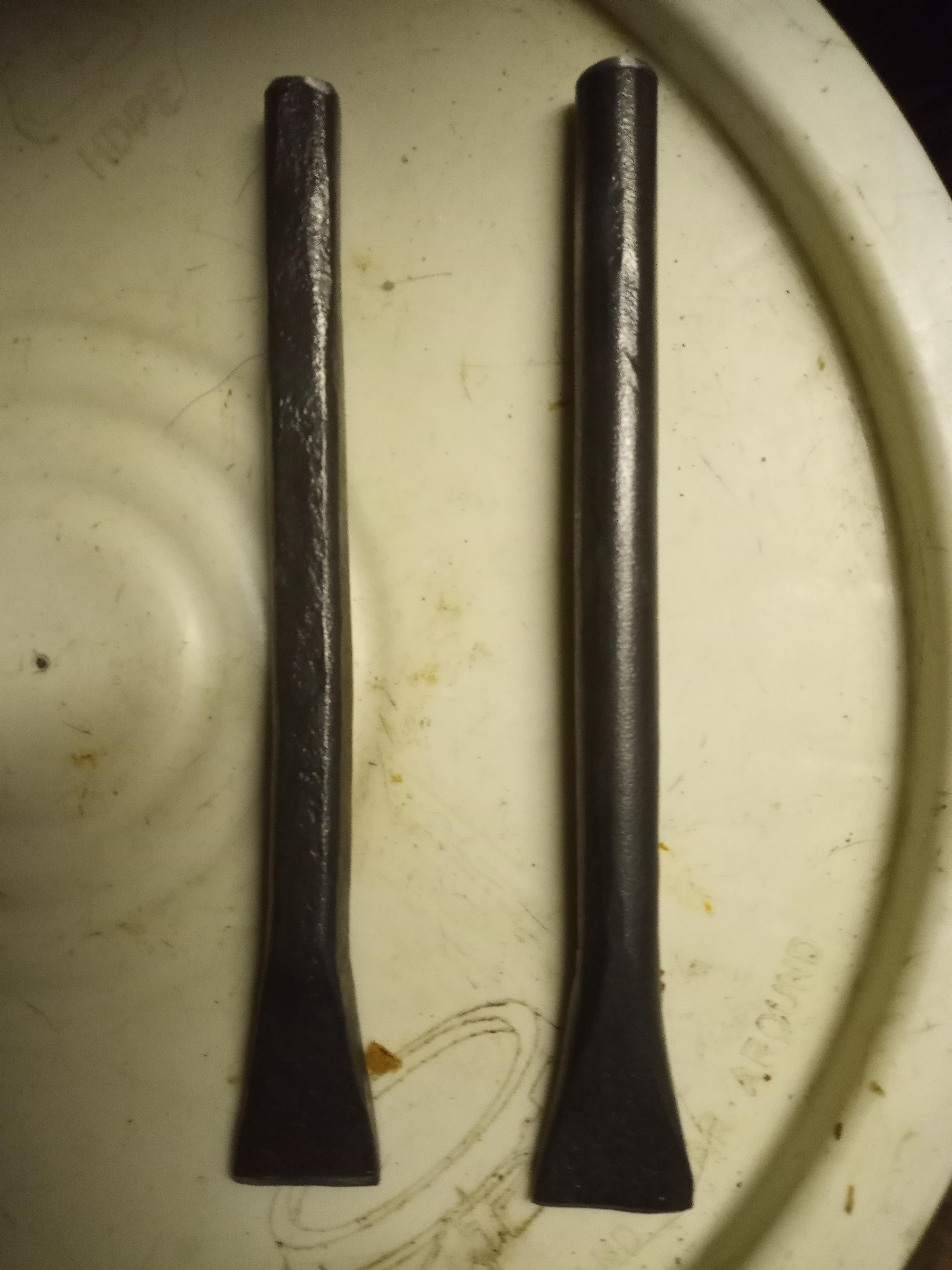

USANewbie Posted October 18, 2021 Share Posted October 18, 2021 Here are a couple chisels I forged today, they are not great but not bad for my first ones I guess. They are half inch, i would prefer 5/8 or 3/4 but 1/2 is all I have. I forged them out of automotive suspension coil springs. One I left round the other i forged square. I think maybe i should have forged a longer taper on the cutting end to give myself more room for forging or grinding a shape, and more room for sharpening in the future. I would also like to forge a diamond type end like you see on store bought chisels. And I would like to work on forging the square shape, its not bad but improvement is needed. I hardened it in water (no oil available) and tempered it in a toaster oven. Quote Link to comment Share on other sites More sharing options...

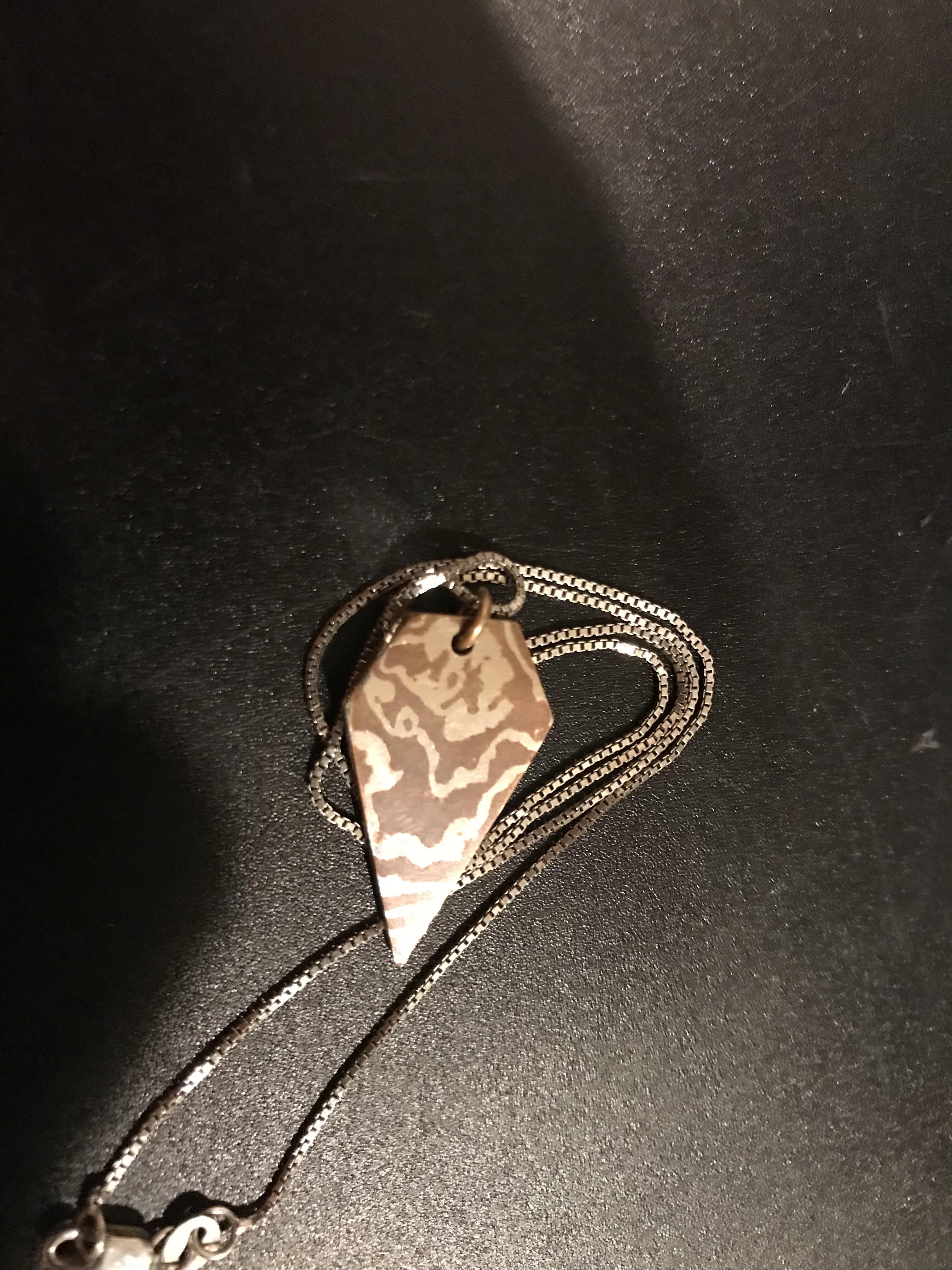

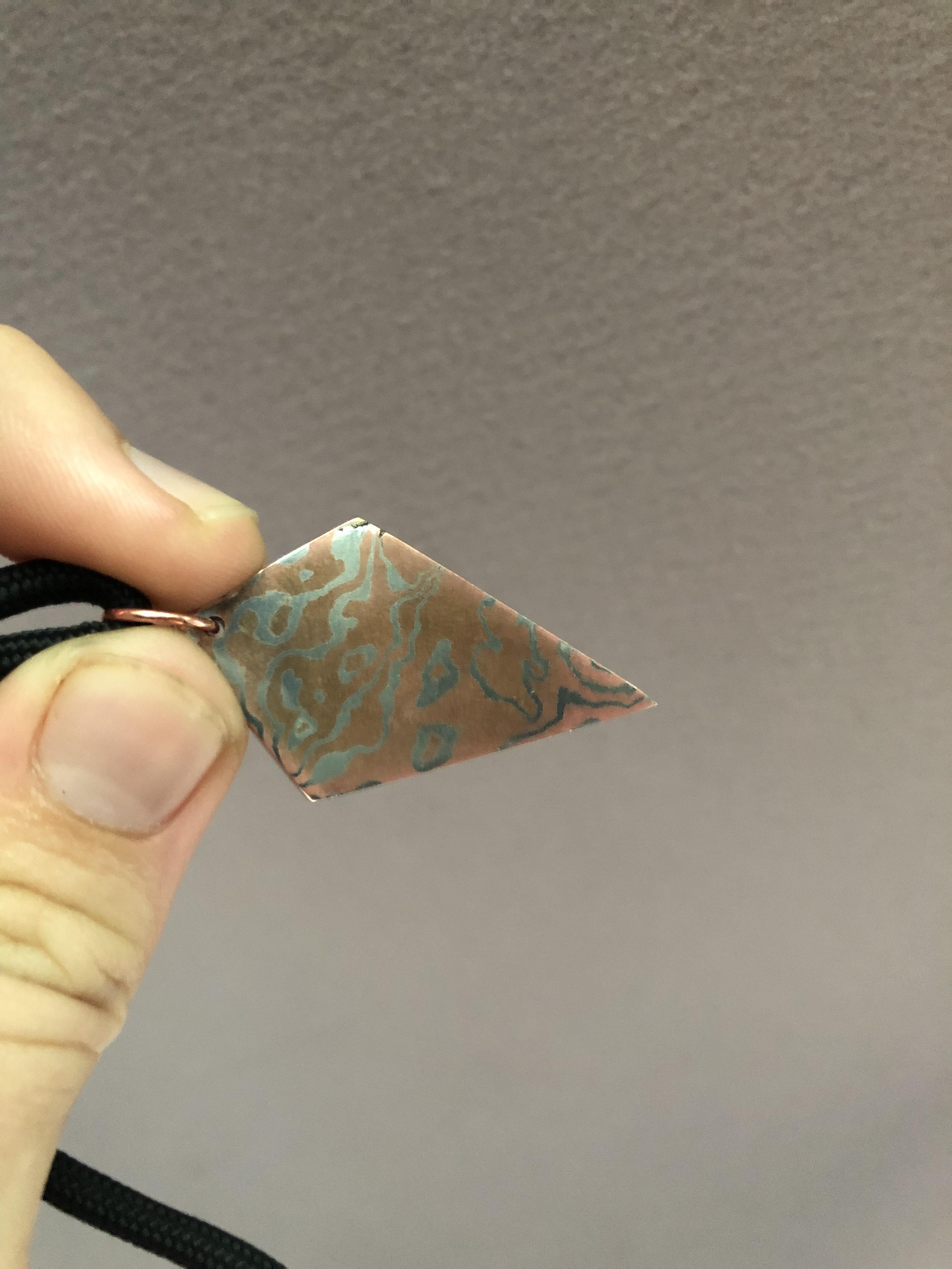

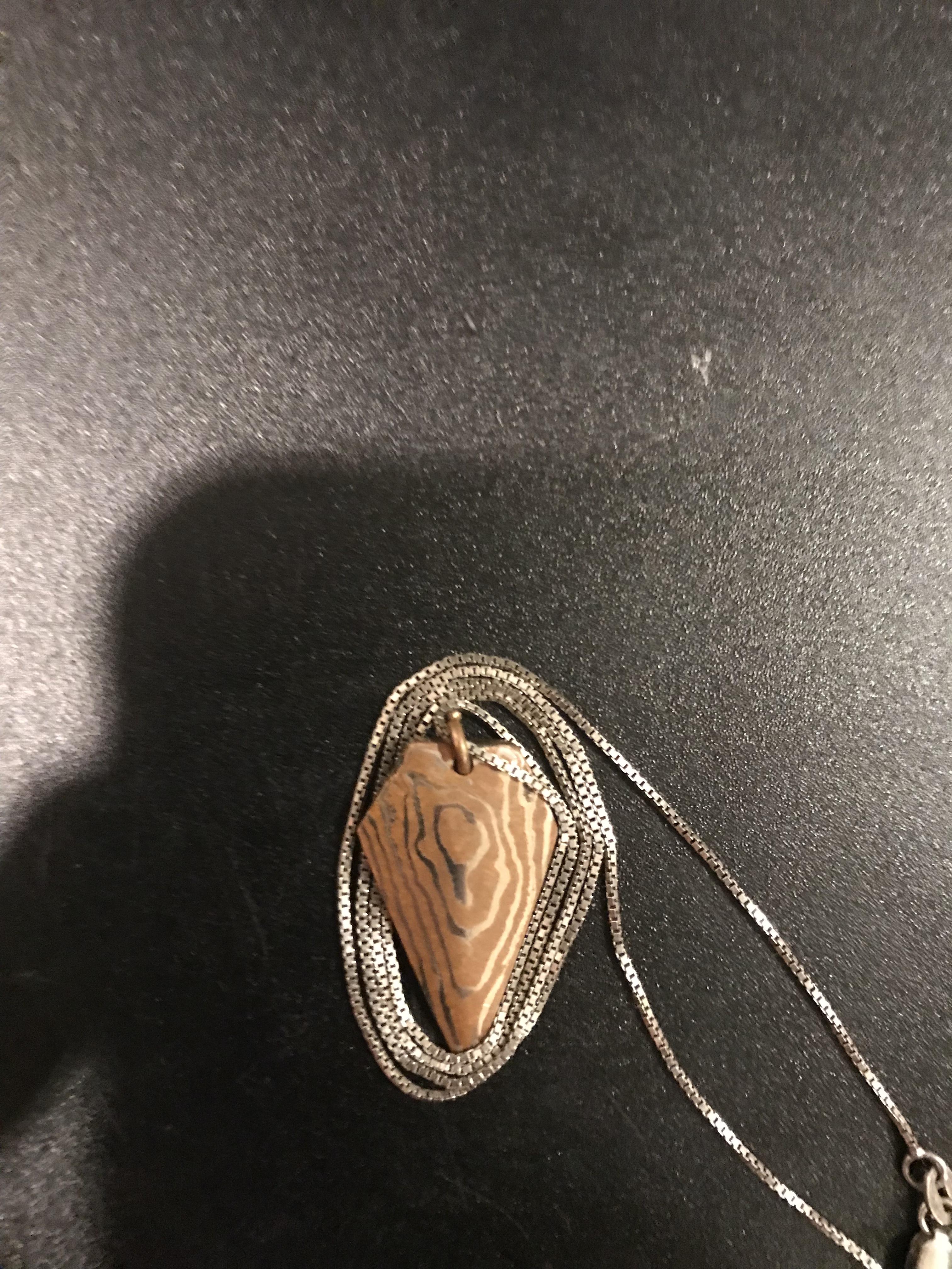

Chimaera Posted October 19, 2021 Share Posted October 19, 2021 Well folks… long time no see! I have been away from the forge (and all of you) for far too long! I recently got these two pieces of mokume finished up. I made the bottom one with a friend, and the top one is a very small, dainty one I made for my mother. I ground down the edges (a bit like a knife bevel) on it to reveal the pattern a bit better. It was greatly assisted by my new belt grinder which I hope to use to make some squirrel tails and possibly a seax in the near future. I would also like to try a wrapped eye tomahawk out of some leaf spring. Quote Link to comment Share on other sites More sharing options...
JHCC Posted October 19, 2021 Share Posted October 19, 2021 Nice! Welcome back! Quote Link to comment Share on other sites More sharing options...
Frosty Posted October 19, 2021 Share Posted October 19, 2021 Good to see you again. The mokume is looking good. Frosty The Lucky. Quote Link to comment Share on other sites More sharing options...
Frazer Posted October 19, 2021 Share Posted October 19, 2021 8 hours ago, Chimaera said: a wrapped eye tomahawk out of some leaf spring. My recommendation would be to make the body out of mild steel and use the leaf spring for the bit. It will make the weld easier. Nice mokume! 12 hours ago, USANewbie said: I hardened it in water (no oil available) You don't have any oil? Most people have some sort of oil or other in the pantry. If not it's pretty inexpensive to pick up at the store. I'd hate to see something crack on you when it could have easily been avoided. Quote Link to comment Share on other sites More sharing options...
Jobtiel1 Posted October 19, 2021 Share Posted October 19, 2021 Over here you can buy 6 liters of sunflower oil at the Lidl for about 6 euros, and it quenches 5160 and 4140 just fine. ~Jobtiel Quote Link to comment Share on other sites More sharing options...

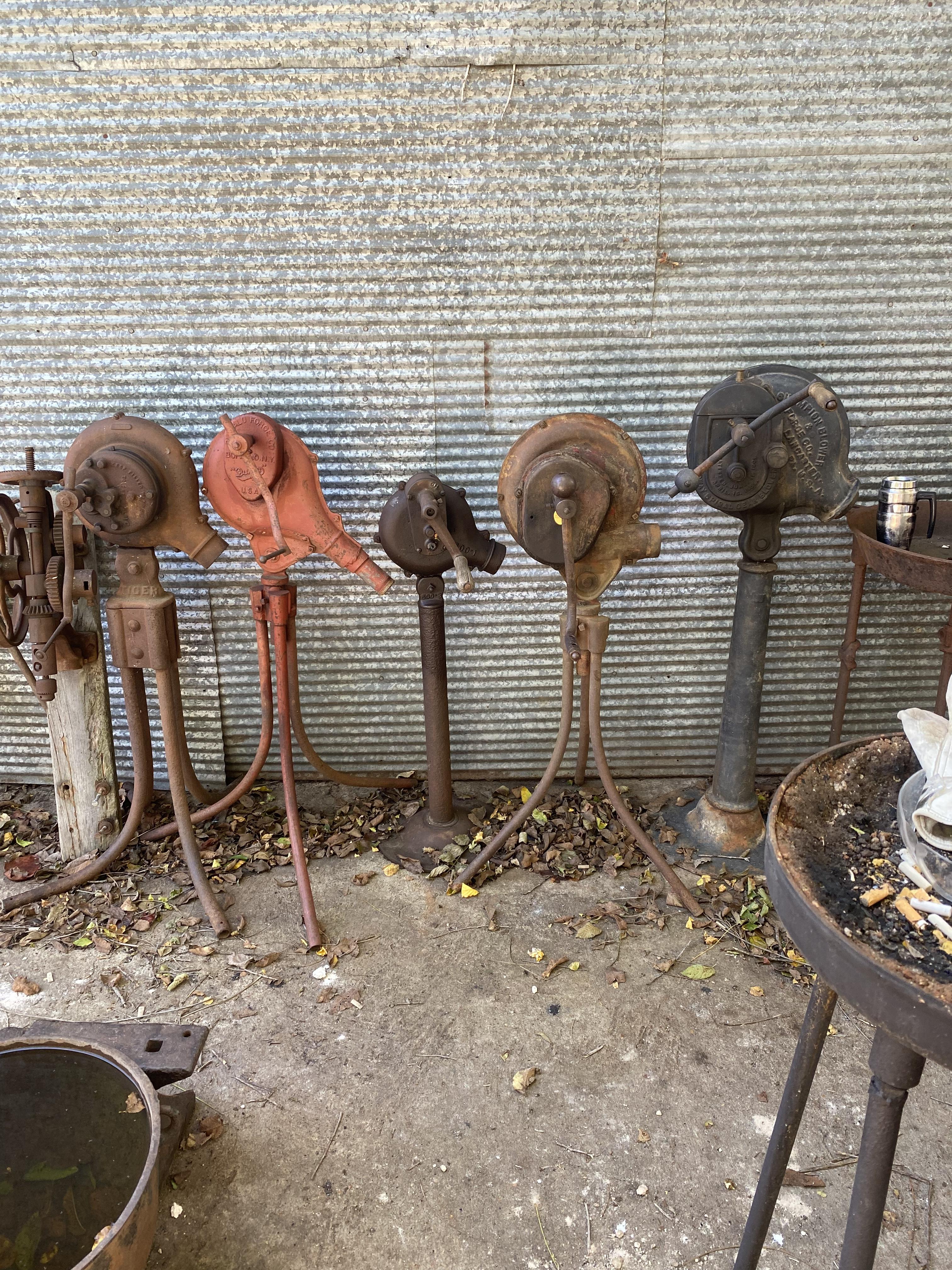

Pat Masterson Posted October 19, 2021 Share Posted October 19, 2021 Are those old forge blowers in the background? They look pretty cool… Quote Link to comment Share on other sites More sharing options...
TWISTEDWILLOW Posted October 19, 2021 Share Posted October 19, 2021 Yes I’ve got 7 blowers setting around my smithy right now along with a bunch of other junk lol, Quote Link to comment Share on other sites More sharing options...

JHCC Posted October 19, 2021 Share Posted October 19, 2021 Depends entirely on the mower blade. A lot of them nowadays are made from high-boron alloys for impact resistance, but I have no idea how that affects their welding characteristics. John Deere makes theirs out of 5160, so that would be rather counterproductive. You really are much better off getting some mild steel for the body. 15 hours ago, USANewbie said: I think maybe i should have forged a longer taper on the cutting end to give myself more room for forging or grinding a shape, and more room for sharpening in the future. A longer taper is certainly good, but not critical. You should also consider grinding a slight curve to the edge, which makes it easier to walk the chisel down the line of a longer cut. Mark Aspery's video about making chisels and punches is quite good: Quote Link to comment Share on other sites More sharing options...

USANewbie Posted October 19, 2021 Share Posted October 19, 2021 Thanks Frazer. I plan on getting some oil. Quote Link to comment Share on other sites More sharing options...
USANewbie Posted October 19, 2021 Share Posted October 19, 2021 Thanks Jobtiel1. Are car springs made from 5160 and 4140? Quote Link to comment Share on other sites More sharing options...
USANewbie Posted October 19, 2021 Share Posted October 19, 2021 Thanks JHCC, I'll check that video out. Quote Link to comment Share on other sites More sharing options...

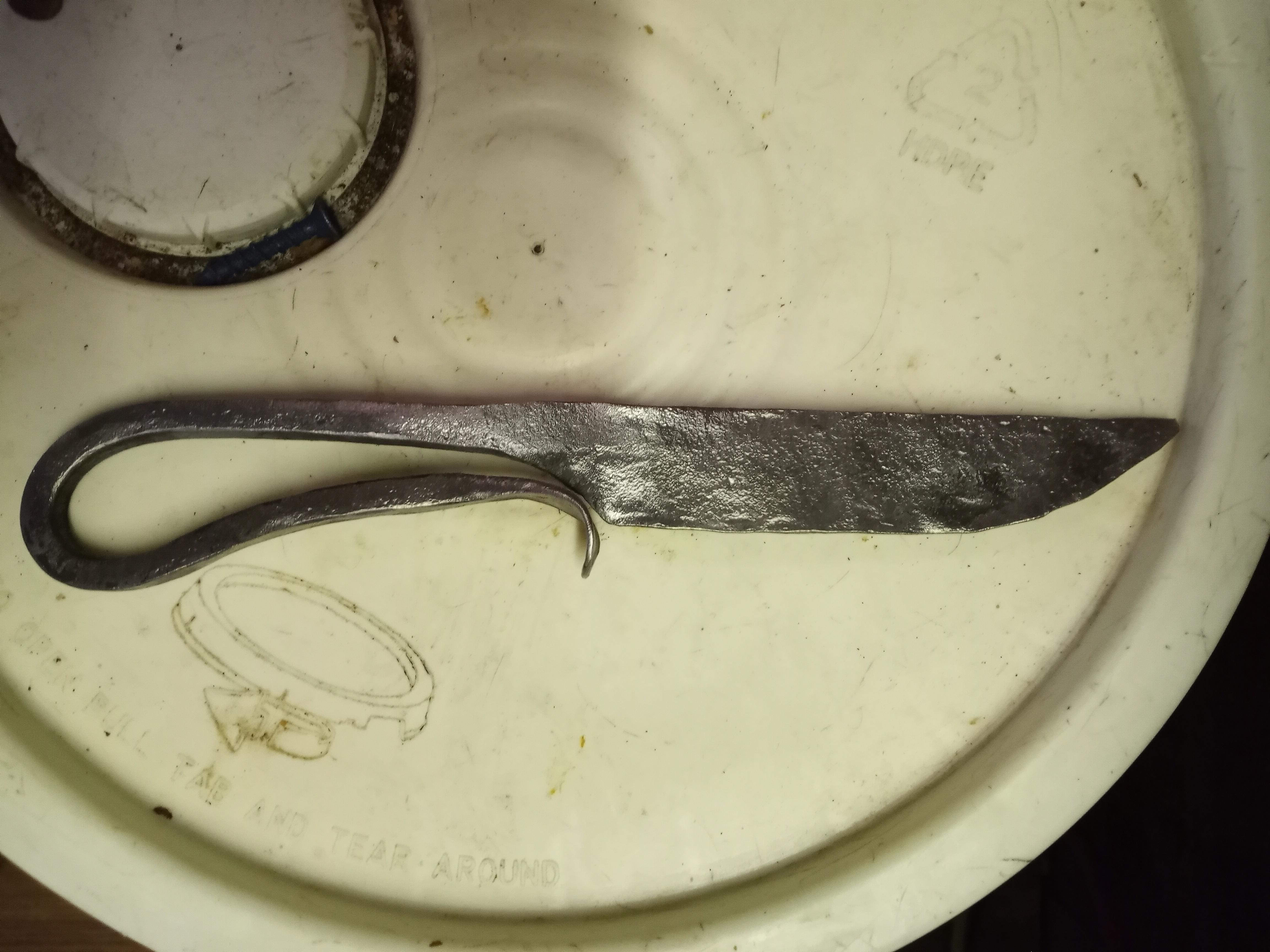

USANewbie Posted October 19, 2021 Share Posted October 19, 2021 I forged this knife today. I used mild steel because i just wanted the practice. I need to do some file work on it still. I forged it from 1/2 square stock. The blade is kinda rough, i will file it smooth but why is it rough? Is it my technique? Any constructive criticism is welcome. Quote Link to comment Share on other sites More sharing options...
