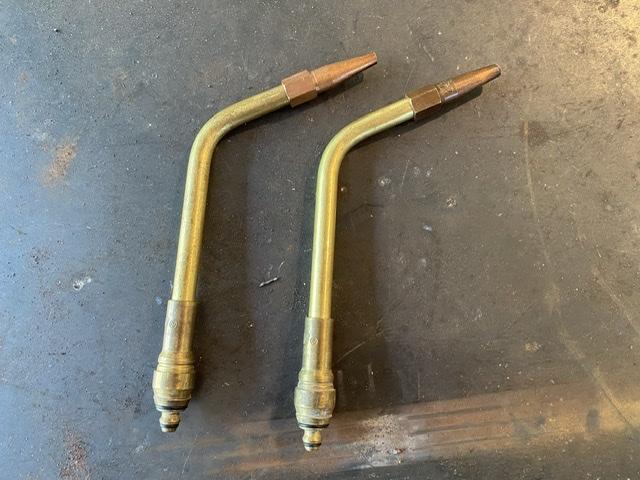

I got a Victor Medalist 250 Propane kit last Xmas. Mainly for extending my cutting range beyond what my little plasma can do. I keep thinking up projects that need 1" plate or bigger.  I had to purchase more cutting tips than comes in the kit to expand the range, but they are not crazy expensive.  I am completely sold on it for rivets, worth the money just for that alone.  I have been using the cutting head for brazing and while it works fine, it is heavy and clunky. The smallest tip turned way down is too much heat for brazing sheet in a nice controlled manner.  Victor makes a propane "welding" style tip for the cutting body, but it is expensive plus there are more tips needed.  If you just want to cut, rivet and braze 1/4" or larger stock then  I would recommend the Medalist 250.

Thanks, LB. The Medalist 250 comes with a #1 tip, which they say is good for up to 1/2”. I’ve heard that propane takes a larger tip than acetylene to cut the same thickness of material; are your numbers for use with propane or acetylene?
The tip sizes I talked about are propane.  000=1/8,00=1/4,0=3/8&1/2,1=3/4,2=1& 11/2.  As for what people say about propane requiring larger tip than acetylene to cut same thickness metal,that's mostly in perpetuating the notion acetylene flame is hotter than propane and/or consume's moetre oxygen.  Don't waste time comparing and trying to figure it out,the tips are not interchangiable anyhow and each have their own set of size #s.  Half the people that give up on propane after one try used acetylene tips,the other half didn't know correct way to use right equipment and had noone to show them.  What you need to know is (A) the Medalist kit is probably available for either gas.  Propane is more expensive because of T hose and come's with propane tip.  I expect the acetylene version can be found on sale and difference will more than buy T hose and propane tip. (B) Get opinions from those you trust about tip size for what you are doing. As you can see,a #1 wouldn't suit me at all since most my material is less than 1/2".  I would much prefer pushing tip to larger than rated thickness than cutting with oversized tip.  If non of what I say helps or makes sense,here's a tip that make's you smarter than the average and might save money while buying used.  The holes are recessed on propane tips which makes them easy to identify.  Most are two piece but have often been over tightened and swedged parts togeather.    Maximum neutral flame temperature of acetylene in oxygen is about 5720 F.  Maximum neutral flame temperature of propane in oxygen is about 5112 F.  600F differential when soldering and brazing can mean the difference between failure and success but it's difficult if not impossible to discern 600F at cutting temps.

It was honestly a major PITA to figure out which series of tips go with that torch. I called Victor and even they got it wrong. Surprisingly my local welding shop did have a couple sizes of them in stock. 1-3-GPN came with it which I think is for 3/4". I bought 0-3-GPN for 1/2" and 2-3-GPN, which I think was good for 1" I am planning on getting a few more so I can cut up to 4".  locally they are under $18 each, I see china models for $11 on line. I think am going to stick with the higher dollar ones.
I am sure I will be yelled at by someone here for not getting the flashbacks yet.  But I do plan on getting the ones that mount on the regulator once I figure out what part # I need.
