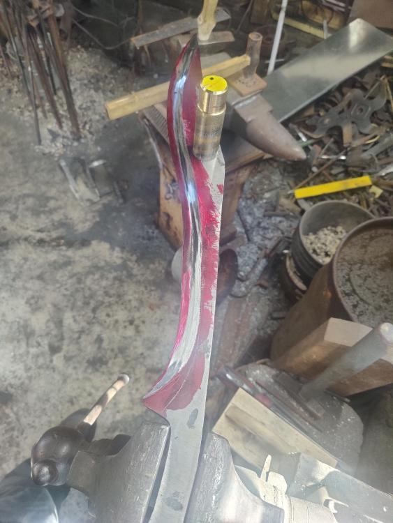

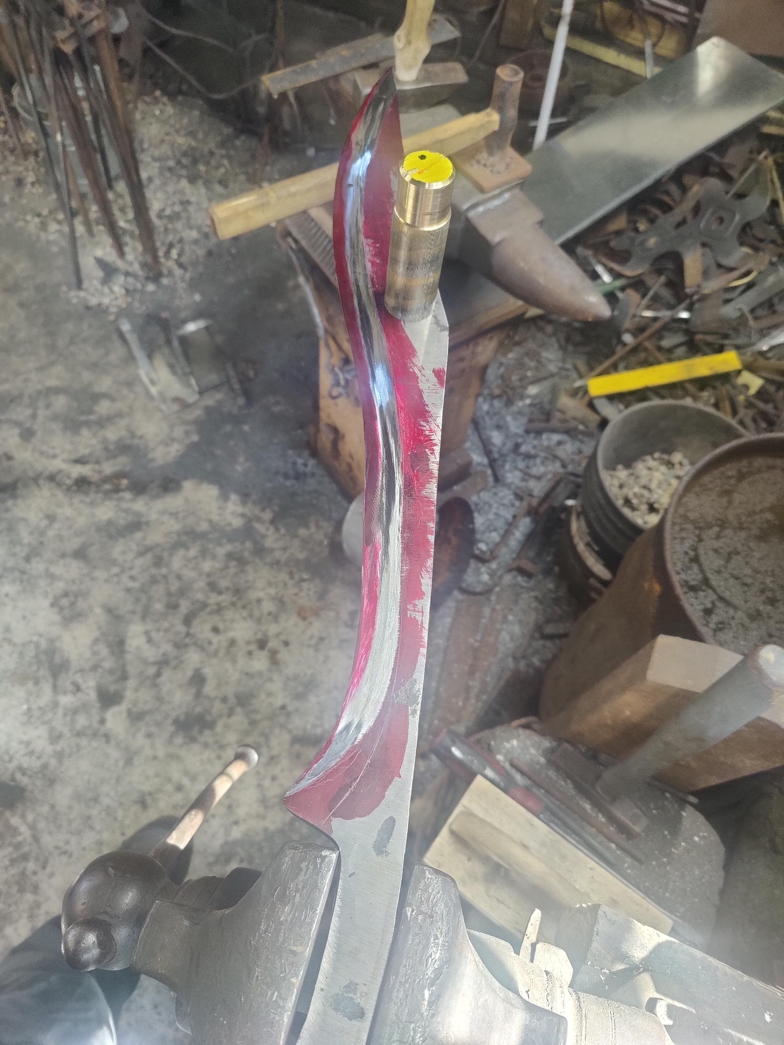

BillyBones Posted October 19, 2021 Share Posted October 19, 2021 Even leaf springs are not always 5160 that is just the most common from my understanding. Been working on grinding this big honkin knife i am making. Got all but some small hammer marks out, they will stay for aesthetics. Flat and straight. Started grinding my bevel. Love that layout dye. Smear it on, set my calipers to .850"... easy peasy line to guide my hand. Going to shoot for heat treat this weekend. (dye makes it look Halloween appropriate too) Also went ahead and grabbed a piece of bronze from work 1 1/4" x 3 3/4" long. Not going to try add a balance but i am going to try and work some bronze into the handle. I was thinking pommel and finger guard. I may try my hand at casting the bronze. Never done more than aluminum and lead but there is always a first time. Quote Link to comment Share on other sites More sharing options...

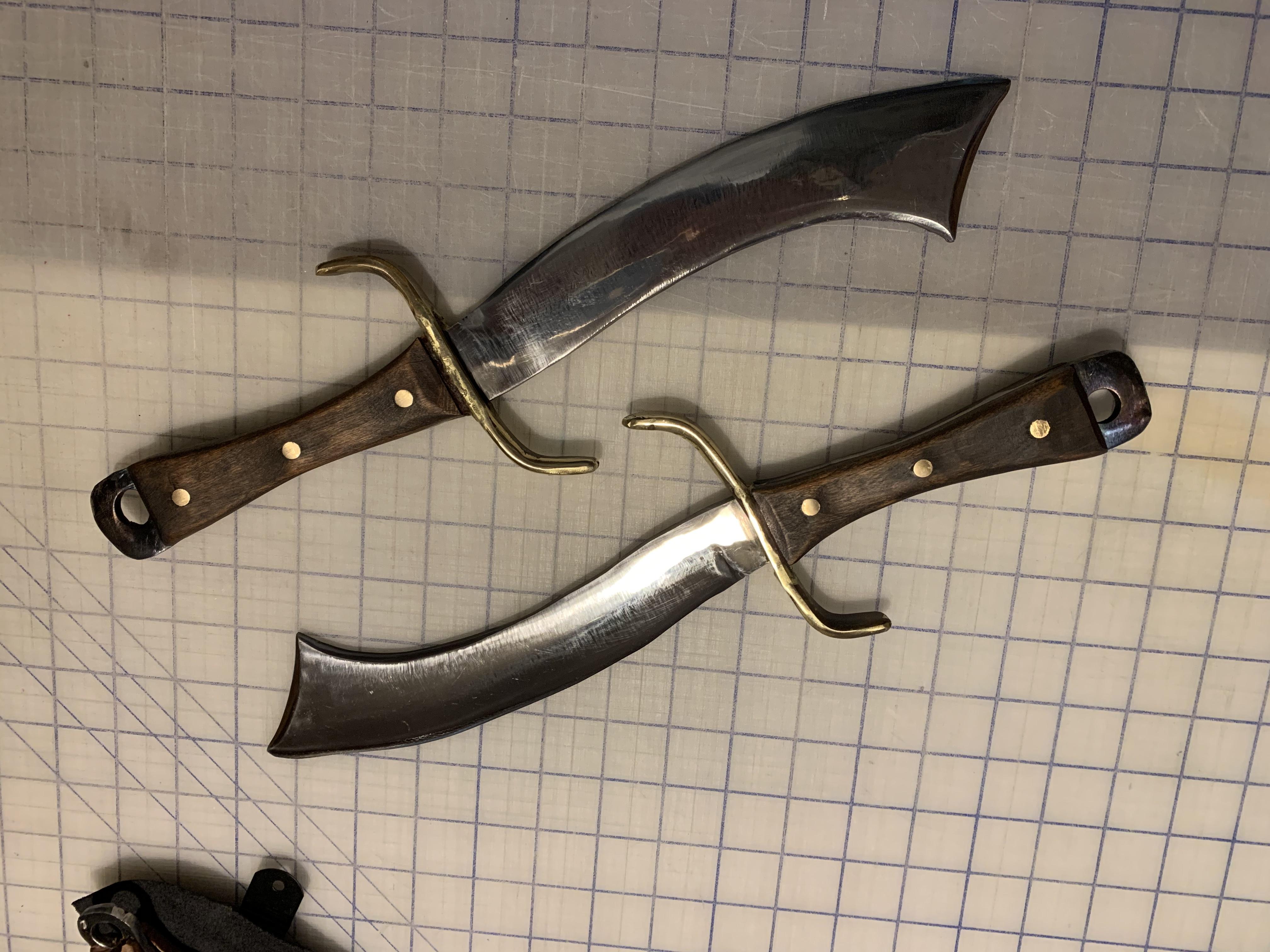

Purple Bullet Posted October 19, 2021 Share Posted October 19, 2021 52 minutes ago, BillyBones said: i am going to try and work some bronze into the handle. I was thinking pommel and finger guard. I may try my hand at casting the bronze. Have you ever tried brazing? I find it is easier to cut and bend large brazing rods (or copper wire) into the rough shape I want and braze them together, then grind it down. That's how I made these. I don't know if I showed you the knife I was wearing at Quad State with the copper guard made the same way. I lost that one recently due to a minor motorcycle spill. Quote Link to comment Share on other sites More sharing options...
George N. M. Posted October 19, 2021 Share Posted October 19, 2021 Purp, that's kind of an odd blade shape. Is there a functional purpose or is it just the coolness factor? Is the front "end" sharpened? "By hammer and hand all arts do stand." Quote Link to comment Share on other sites More sharing options...

George N. M. Posted October 19, 2021 Share Posted October 19, 2021 Actually, I'd say that's a pretty good finish for pre-grinding. The only thing that I'd do differently is to bring the tip of the handle back on itself to form a blunt end. That would be the 1st thing I did to the handle after drawing it out. "By hammer and hand all arts do stand." Quote Link to comment Share on other sites More sharing options...

Purple Bullet Posted October 19, 2021 Share Posted October 19, 2021 1 hour ago, George N. M. said: Purp, that's kind of an odd blade shape. Is there a functional purpose or is it just the coolness factor? Is the front "end" sharpened? I call that my fantasy naval blade. My daughter in law has a father and step-mother that are very well off - multiple mansion AND yachts, but they like to live on the yacht. She asked for a set of "pirate" blades. I really don't like the glamorization of pirates, but there was a sword on the wall on "Forged in Fire" that had a shape that intrigued me. That was the result. She gave them last year before Thanksgiving and they used them to carve the turkey. I didn't make a sheath for them, just a board with hooks to hang on the wall. And yes, the front end is sharpened, but not to the razor edge the blades are. Quote Link to comment Share on other sites More sharing options...
