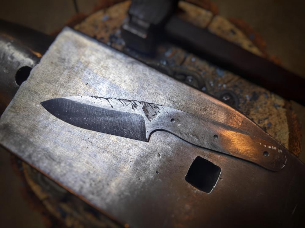

  3. Here's a few of my knives that need a bit more than 1.5"

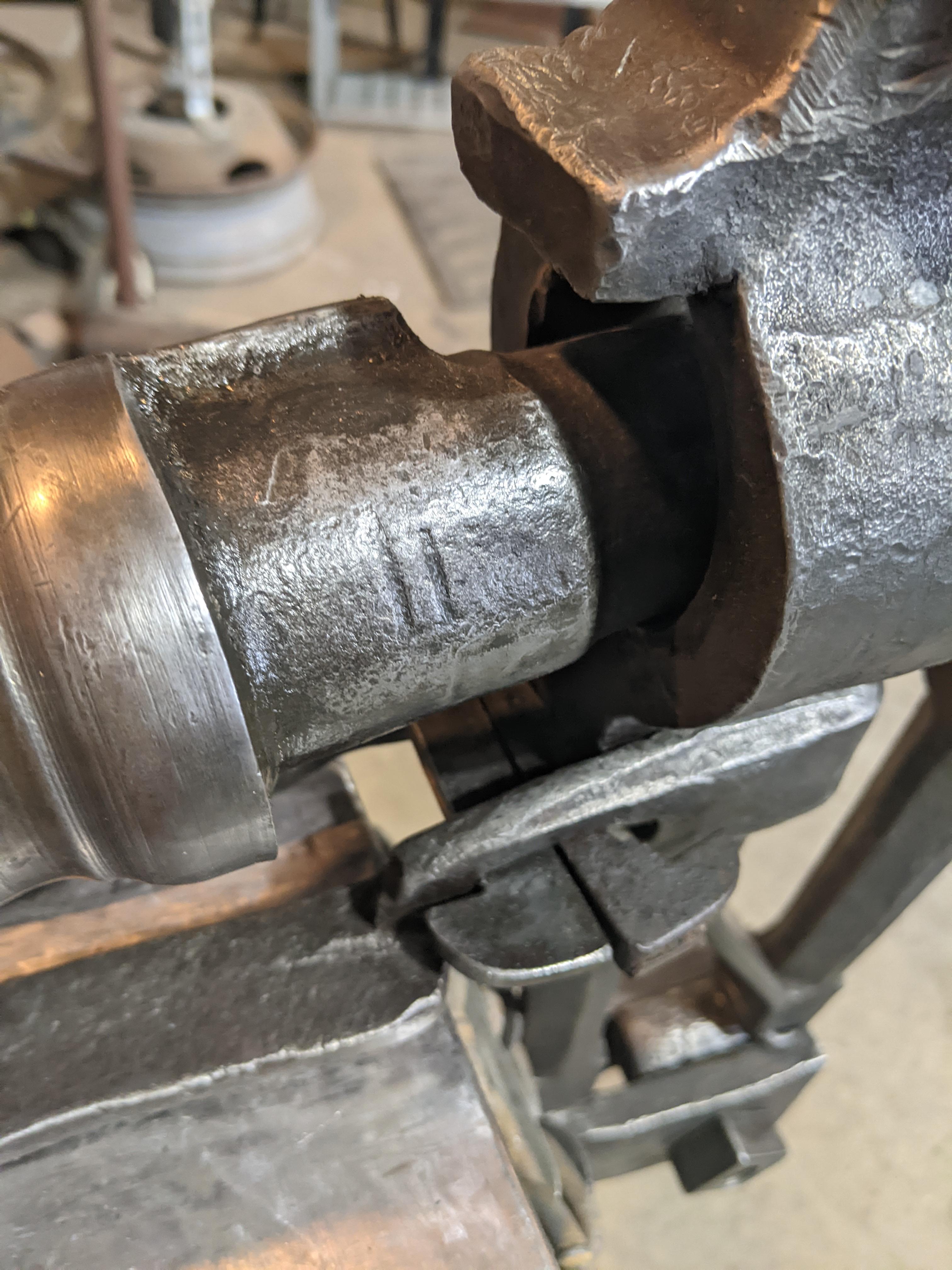

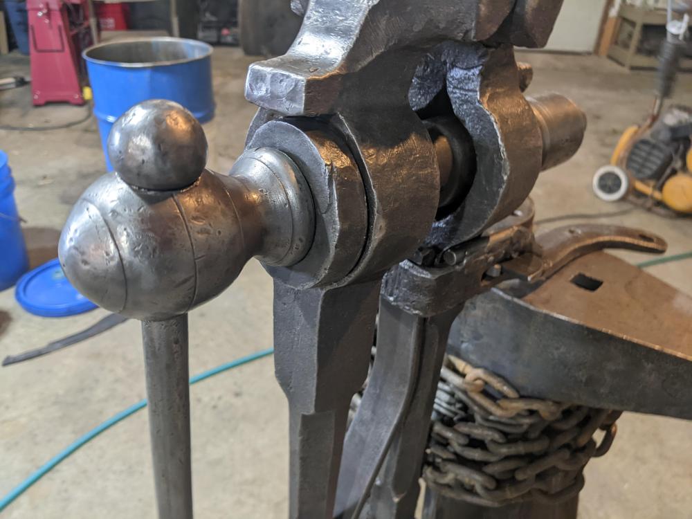

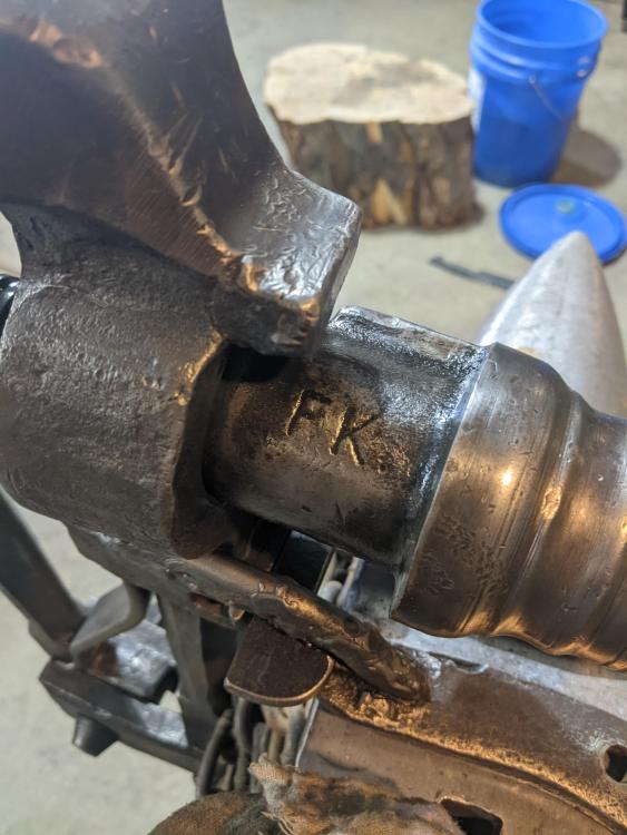

  6. Definitely looks like it's been well used. Some support has been welded to the mounting bracket where it looks to have possibly begun cracking. The leg looks like it has a couple degree bend (hence the supports there). I know Peter Wright had forged bevels, but other than that and the shape of the screw box, I don't really see much else to indicate Peter Wright. Although they were known for making these & then shipping them out unbranded to other companies to sell as their own.
  7. So picked up a couple post vises in northern Idaho. I'm in Helena Montana. The one is clearly a Columbia vise, but the other has very little stamping. All I can find is FK and a II both on the solid box. Shown in the pictures. I haven't weighed it, Buti guess it to be 65#+. 4.5" jaws. Any ideas of what brand or age?
