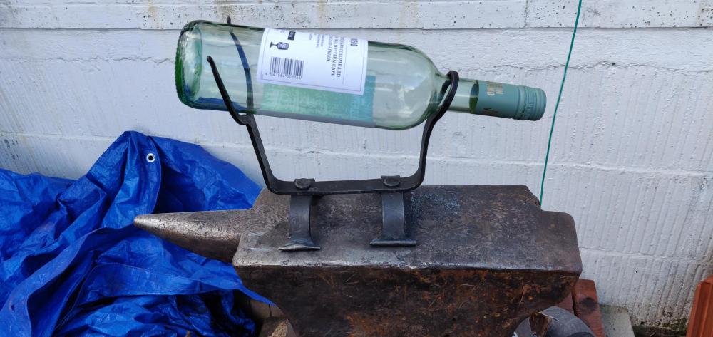

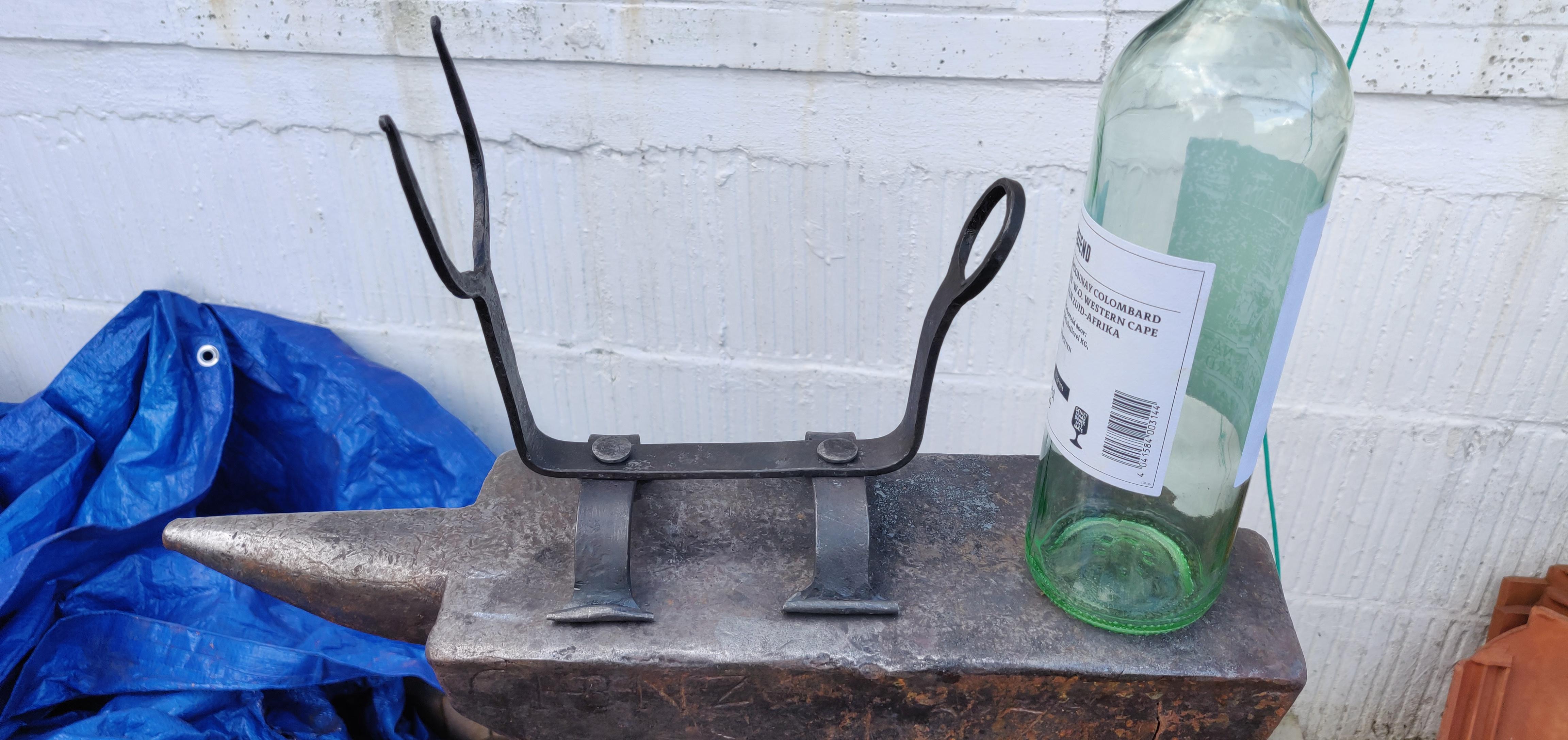

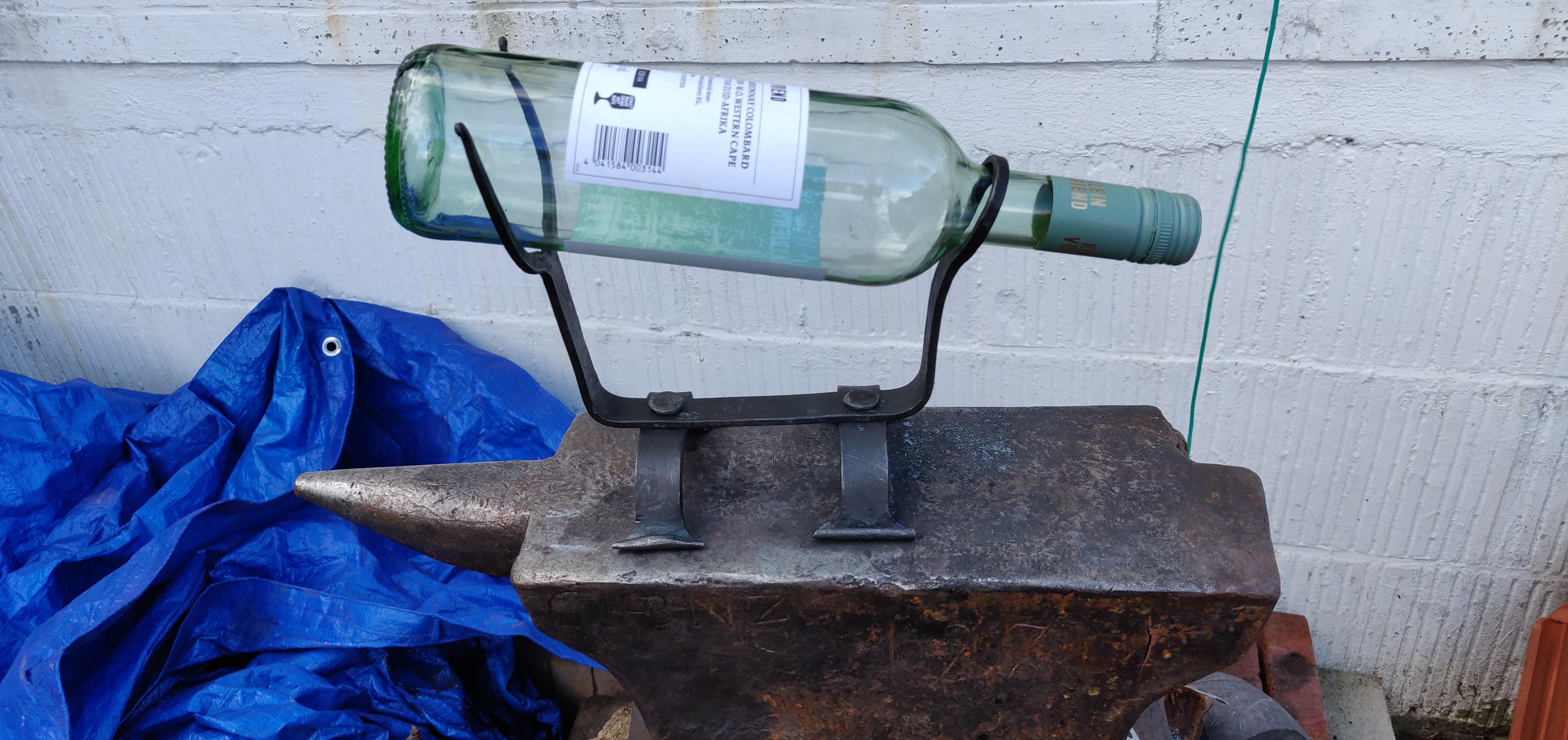

Jobtiel1 Posted October 4, 2021 Share Posted October 4, 2021 Had some forging time again for the first time since universities opened again. I forged a wine bottle holder as a gift for my brother's birthday. Originally I planned to use a block of wood as the base, but while working I had the idea to forge the legs as well, and so I did. ~Jobtiel Quote Link to comment Share on other sites More sharing options...
JHCC Posted October 4, 2021 Share Posted October 4, 2021 Very nice! (You remind me that I have an idea for a wine bottle holder that's been rattling around in my head and that I really do need to try.) Quote Link to comment Share on other sites More sharing options...
TWISTEDWILLOW Posted October 4, 2021 Share Posted October 4, 2021 That’s pretty cool Jobtel1 Quote Link to comment Share on other sites More sharing options...
Jobtiel1 Posted October 4, 2021 Share Posted October 4, 2021 Thanks! While forging I had some other ideas as well, but I'm saving those for other birthdays! What were you thinking about? I thought about winding stock of say 6-8 mm around the bottle. You can play around a lot with this design too, especially the legs. ~Jobtiel Quote Link to comment Share on other sites More sharing options...

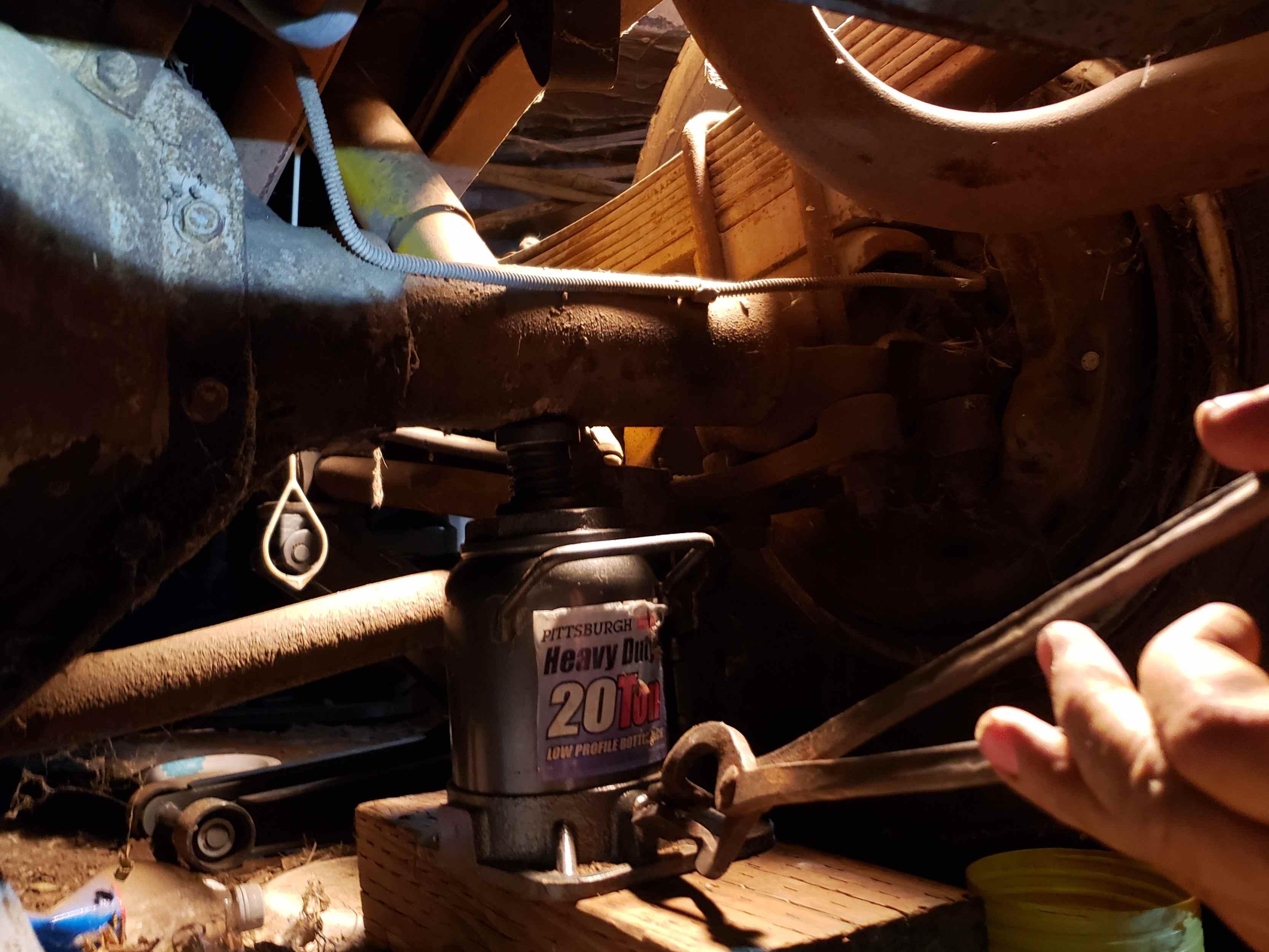

Anachronist58 Posted October 4, 2021 Share Posted October 4, 2021 Got to love a nice pair of tongs! Darned jack handles do not always have well-formed valve actuators. Will reform it in future, but tongs work nice in the interim. 24 foot motor home. Stripping goodies before scrapper hauls it off... Robert Taylor Quote Link to comment Share on other sites More sharing options...
Dax Hewitt Posted October 4, 2021 Share Posted October 4, 2021 (edited) 8 hours ago, Jobtiel1 said: Had some forging time again for the first time since universities opened again. I forged a wine bottle holder as a gift for my brother's birthday. Originally I planned to use a block of wood as the base, but while working I had the idea to forge the legs as well, and so I did.~Jobtiel That's a nice bit of work. Edited October 4, 2021 by Mod44 images trimmed from quote Quote Link to comment Share on other sites More sharing options...

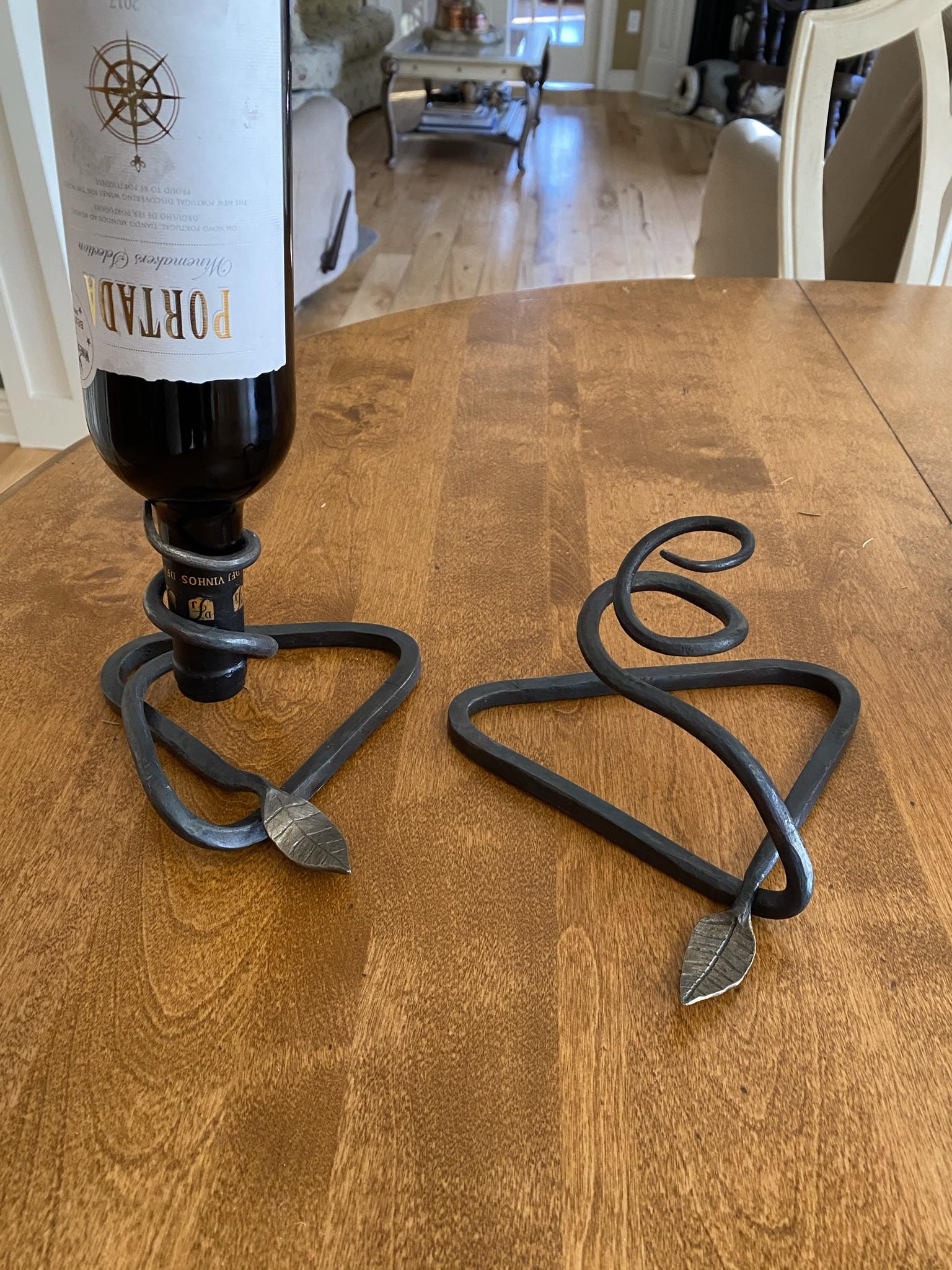

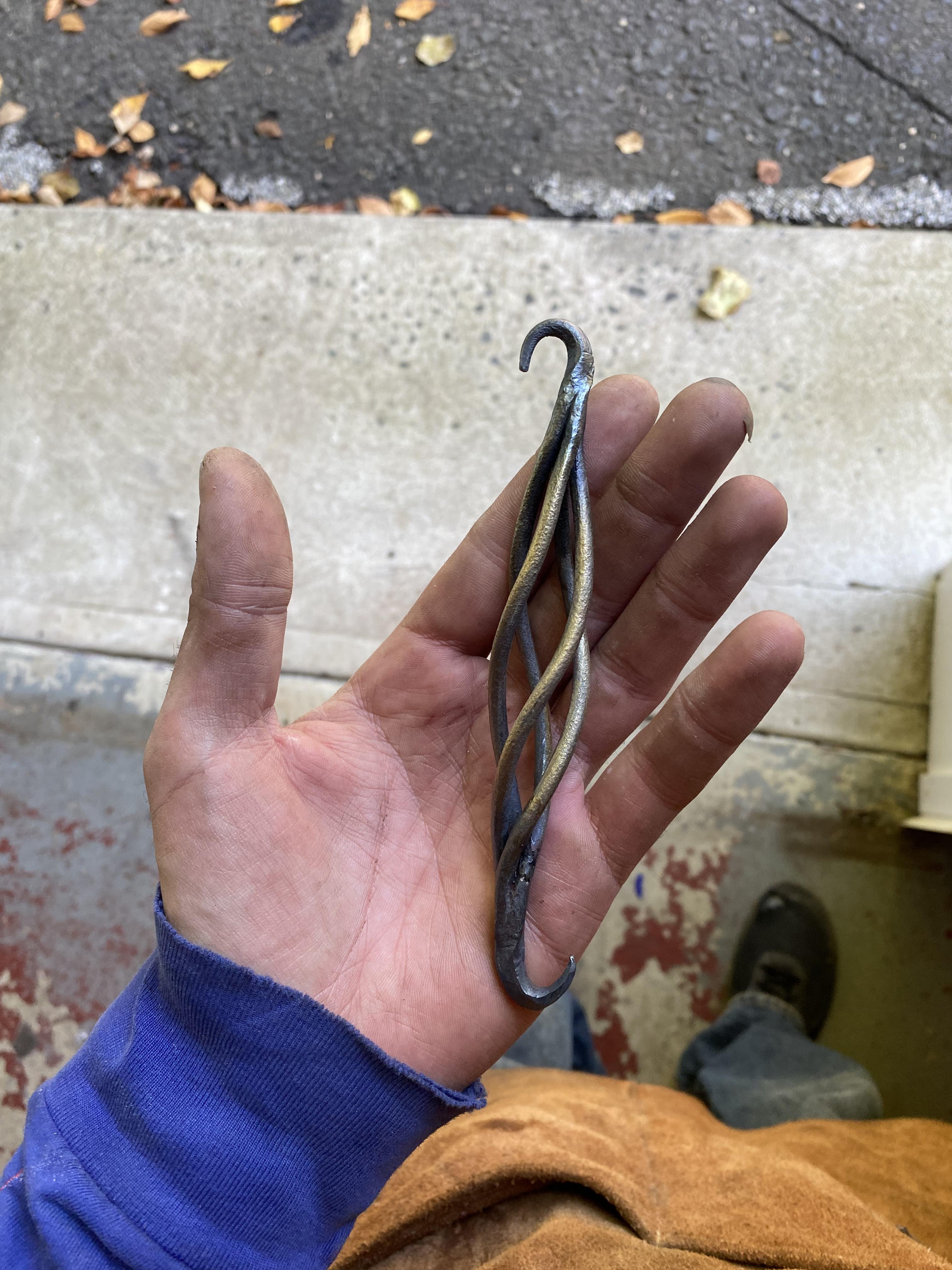

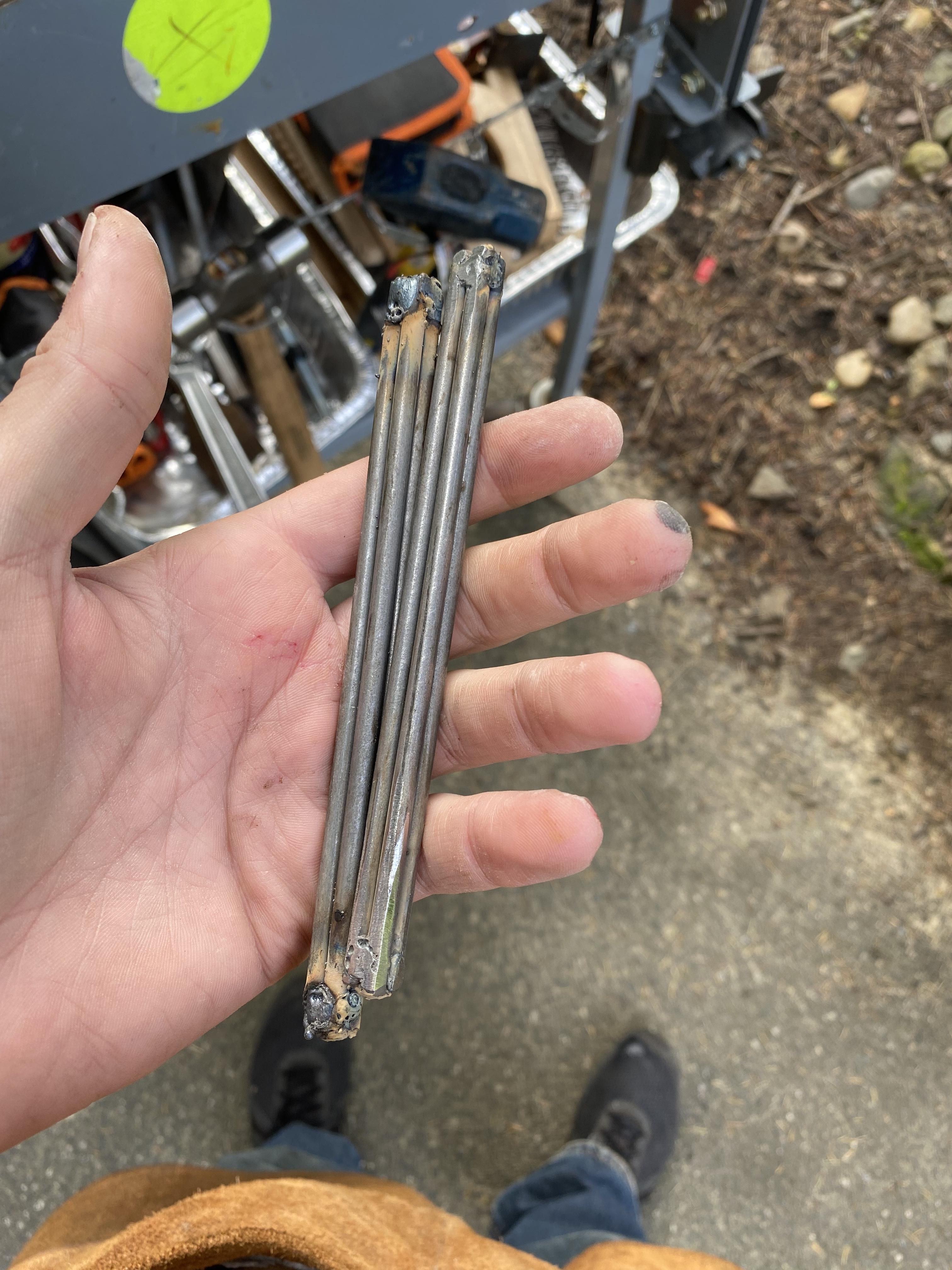

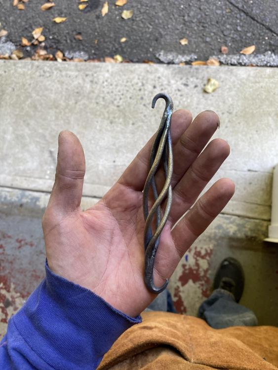

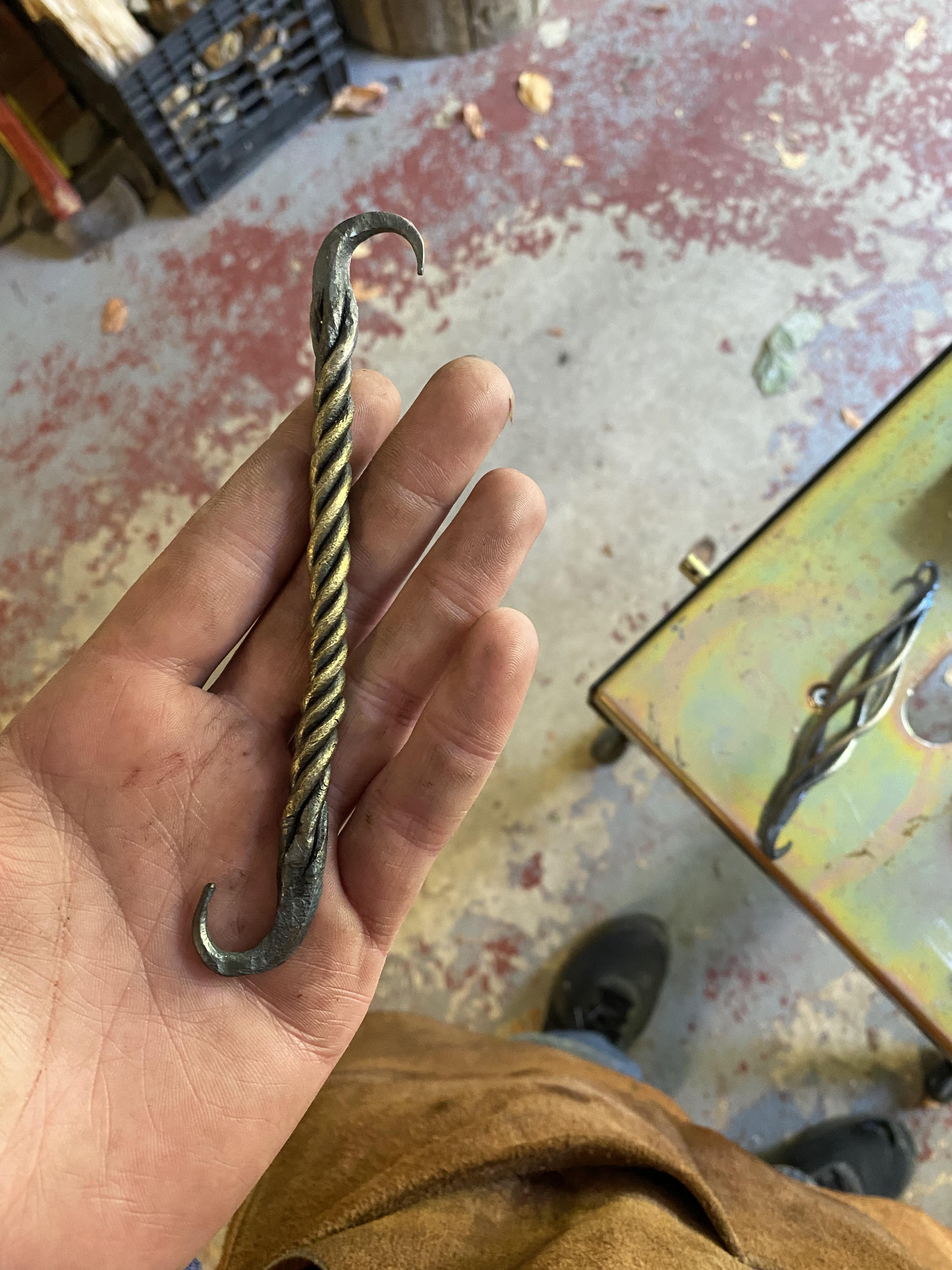

Pat Masterson Posted October 4, 2021 Share Posted October 4, 2021 (edited) 8 hours ago, Jobtiel1 said: ~Jobtiel Very cool. I did a couple wine holders a while back too. Really like this concept for it though. I’ll throw the pic in with the other. I did my first forge welds this weekend. Ok I cheated a bit with some small tack welds to hold the four bars together but whatever - I’m still really psyched I was able to do it and that my little forge got up to temp which I was unsure of. I probably should have tried something a little easier for my first try but I’m the kind the kind of idiot that’ll try pattern welding for his first knife. The first attempt I guess I twisted and untwisted too many times (I realized I needed to pull back as I untwisted to get the look I wanted on the second one) so one of the four broke so I just left it twisted. Also made this little hardy swage to help keep everything from spreading apart while setting the welds. Plan making a bunch of these as tree ornaments for Christmas gifts. Edited October 4, 2021 by Mod44 Images trimmed from quote Quote Link to comment Share on other sites More sharing options...
ThomasPowers Posted October 4, 2021 Share Posted October 4, 2021 Pat; did you see the ones I did with rusty old barbwire and then spray pointed them silver? The rusty barbwire was a pain to forge weld; but living out here, it made it "special". Using a coal forge and borax/boric acid flux and IIRC I baling wired the ends to hold them together. Thanks for reminding me it's about time to make another set for the kids I've seen other people stick a marble in the basket to fancy it up a bit. Quote Link to comment Share on other sites More sharing options...
Jobtiel1 Posted October 4, 2021 Share Posted October 4, 2021 Very nice work Pat, I like those bottle holders too, very elegant. ~Jobtiel1 Quote Link to comment Share on other sites More sharing options...
Frosty Posted October 4, 2021 Share Posted October 4, 2021 Nice bottle holder Jobtiel, it'll be a handsome gift. Frosty The Lucky. Quote Link to comment Share on other sites More sharing options...

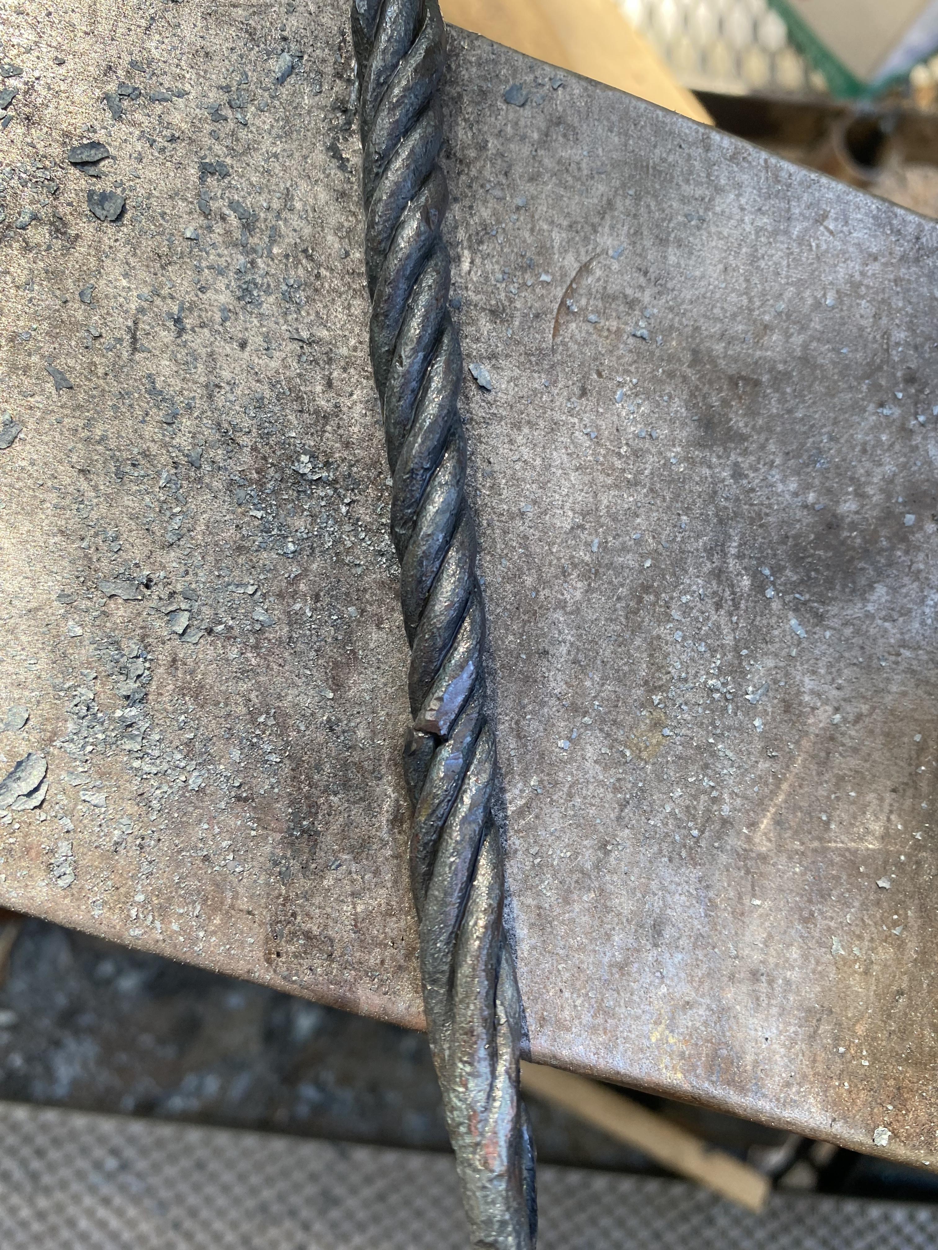

bluerooster Posted October 4, 2021 Share Posted October 4, 2021 Ya'll are doing some nice work out there. I like the bottle racks. And the ornaments are looking good as well. I fired up the forge for the first time in a while today. And decided to make a cable billet. Learned that welding cable is (for me) a tedious process, and it still may not come out right. Getting it to welding temp all the way through, without burning up the outside wires is a task not to be taken lightly. Needless to say I ruined another chunk of cable. Quote Link to comment Share on other sites More sharing options...

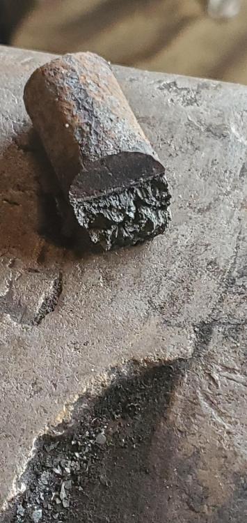

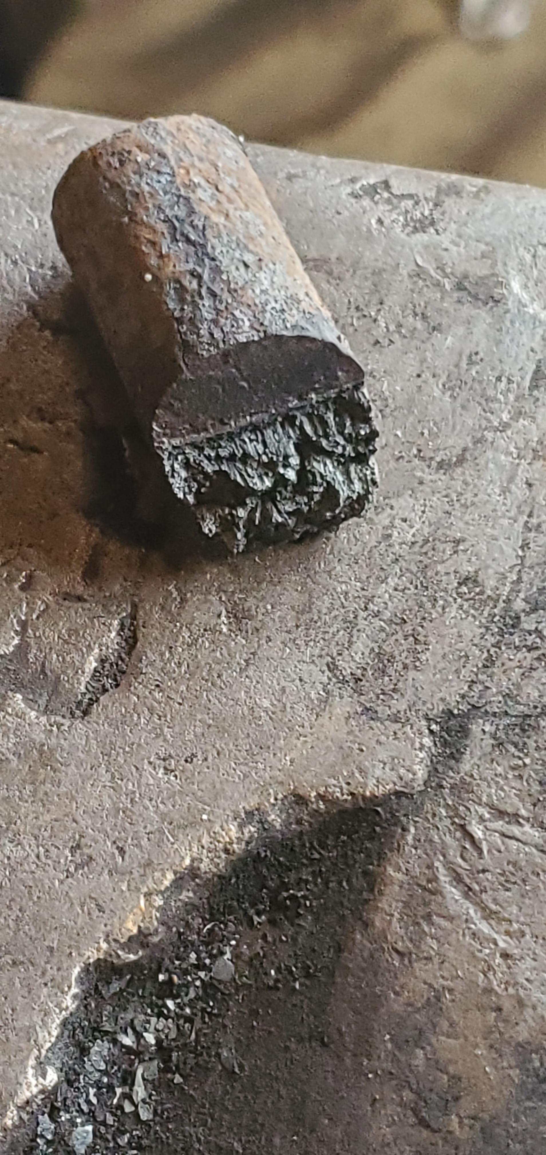

Chad J. Posted October 4, 2021 Share Posted October 4, 2021 Did a break test on a piece today, heated it, cut out and bent it. Am I reading this correctly that is wrought? Quote Link to comment Share on other sites More sharing options...
ThomasPowers Posted October 4, 2021 Share Posted October 4, 2021 Yes; "green stick fracture" == wrought iron. Now do the spark test on it so you know what that is supposed to look like! Quote Link to comment Share on other sites More sharing options...

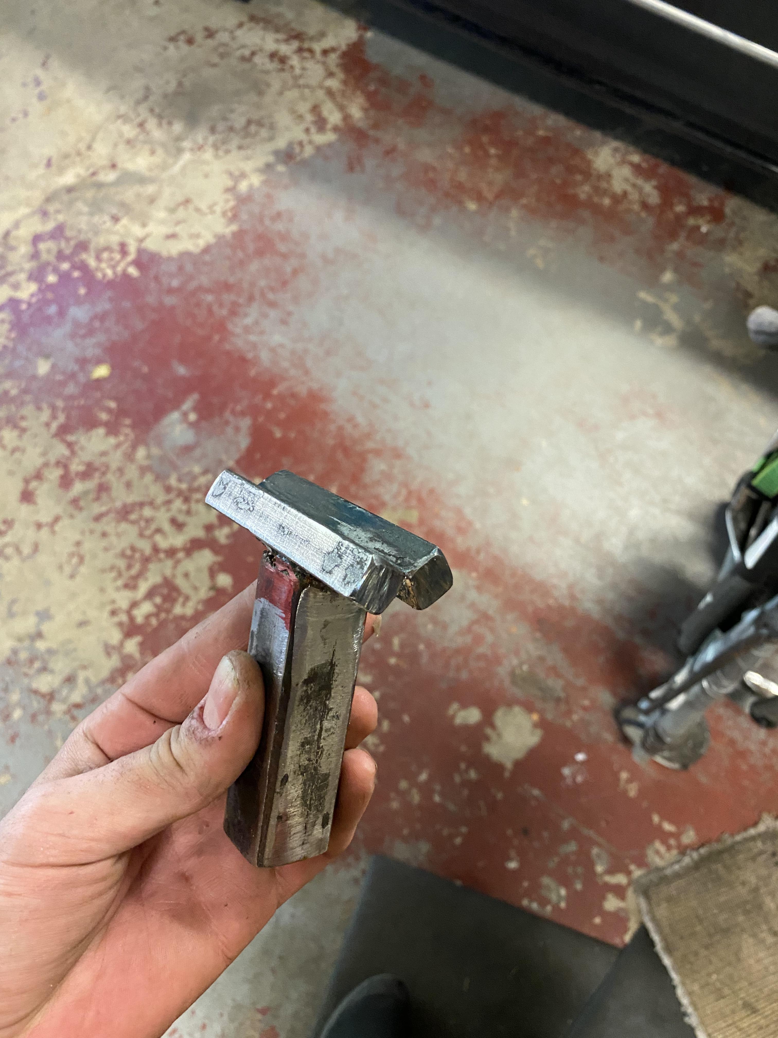

TWISTEDWILLOW Posted October 4, 2021 Share Posted October 4, 2021 3 hours ago, Pat Masterson said: I did my first forge welds this weekend I did my first forge welding this weekend to! I did two lap welds an a scarf weld, I gotta do some more practice but I plan on doing a basket weave soon as well as a flat bar Christmas tree project I seen, Quote Link to comment Share on other sites More sharing options...

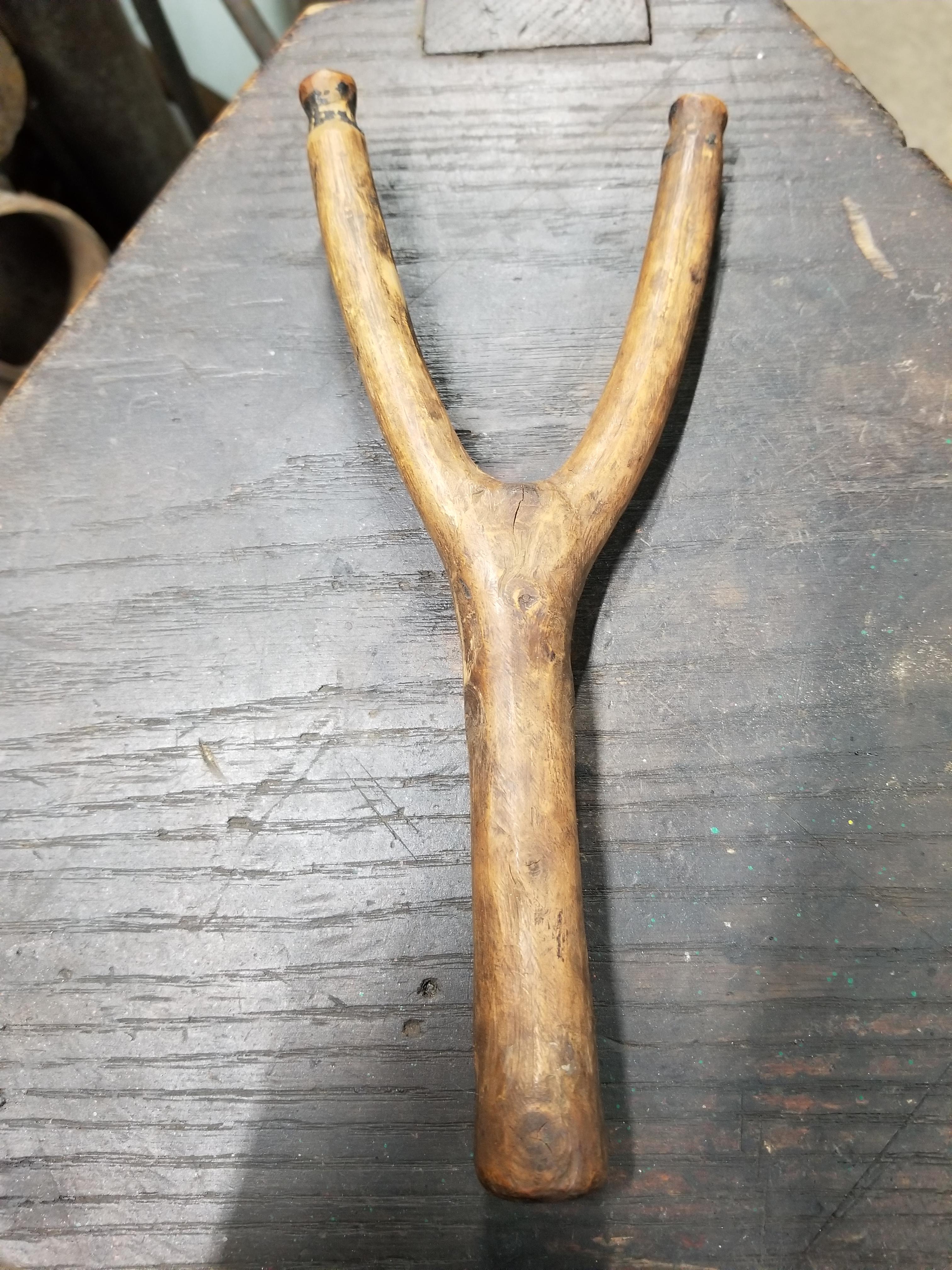

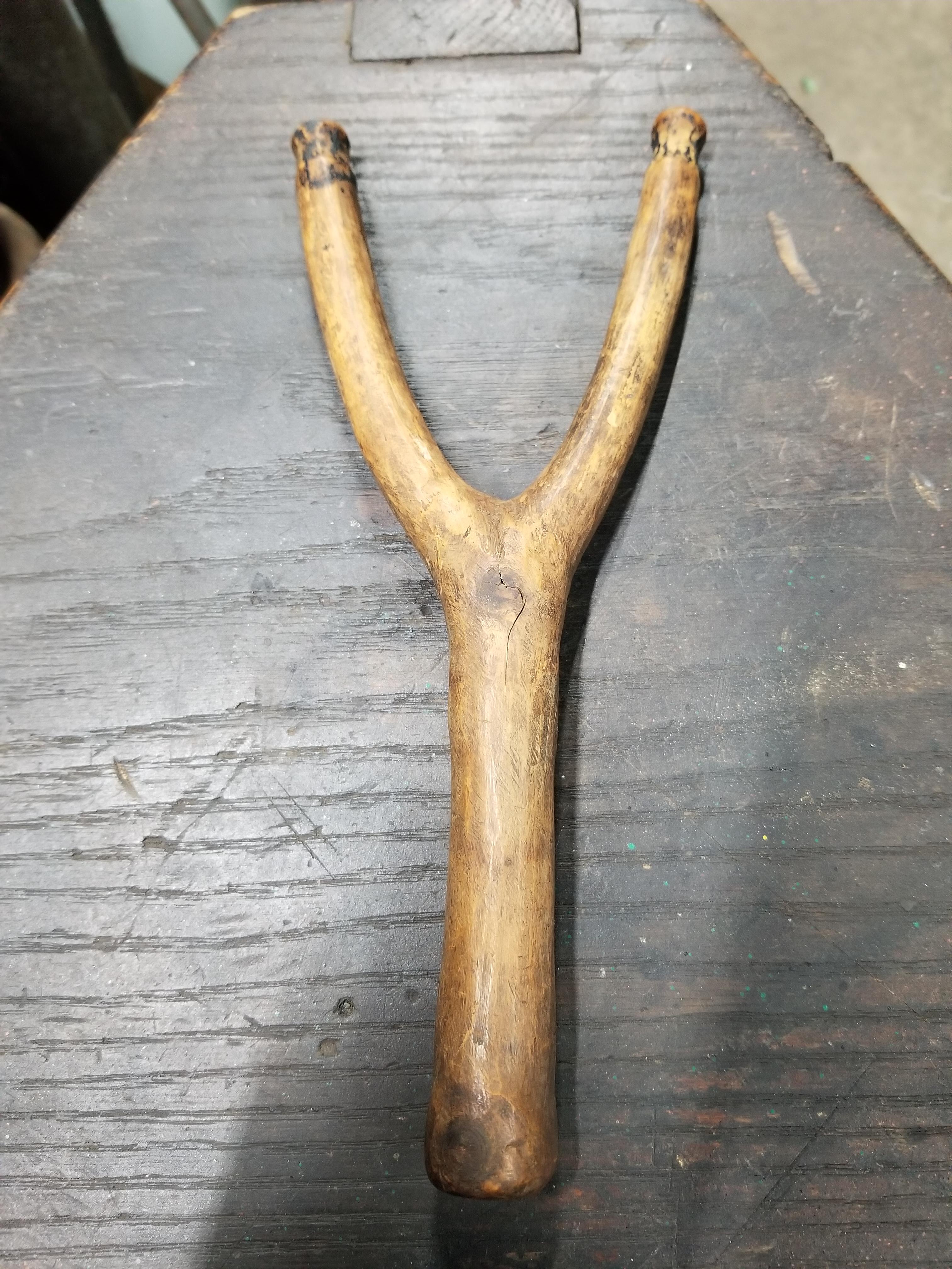

Daswulf Posted October 5, 2021 Share Posted October 5, 2021 On 2/18/2021 at 3:05 PM, Daswulf said: Randy I'll try to get pictures and dimensions Wow, since February, but I Finally found it tonight. Long time coming. I looked up, down and all around thinking I knew where it was. I thought it was lost and gone but it shouldn't have been. As usual, I found it in a weird place nowhere near where I thought. It was in a machinist box with my dremel stuff. I was organizing the box tonight and spotted it. But it exists! My grandfathers or great grandfathers hand carved slingshot. One side is half inch on the carved concave sling area, the other is a 1/16" over half inch. It fits my hand great holding it either direction. 9 hours ago, Anachronist58 said: Stripping goodies before scrapper hauls it off What goodies did you get? Quote Link to comment Share on other sites More sharing options...

Pat Masterson Posted October 5, 2021 Share Posted October 5, 2021 17 hours ago, ThomasPowers said: Pat; did you see the ones I did with rusty old barbwire and then spray pointed them silver? I didn’t but I do now. That is a really awesome idea. The barbed wire makes them look pretty wild. I like the silver paint too. Quote Link to comment Share on other sites More sharing options...
ThomasPowers Posted October 5, 2021 Share Posted October 5, 2021 Rusty Barb Wire---to be sure all the galvanization is off it. Makes it harder to weld; so definitely use flux. IIRC I tried some after I had soaked them in vinegar and wire brushed them under the hose bib to try to get most of the rust off. The wire I have been using is an older flat barb wire as that was what was at the scrap yard. It's pretty thin wire which I thought would make a better "icicle" for the tree. Nice to see all the variations on a theme to give folks ideas to try ranging from easier to not so easy. Quote Link to comment Share on other sites More sharing options...

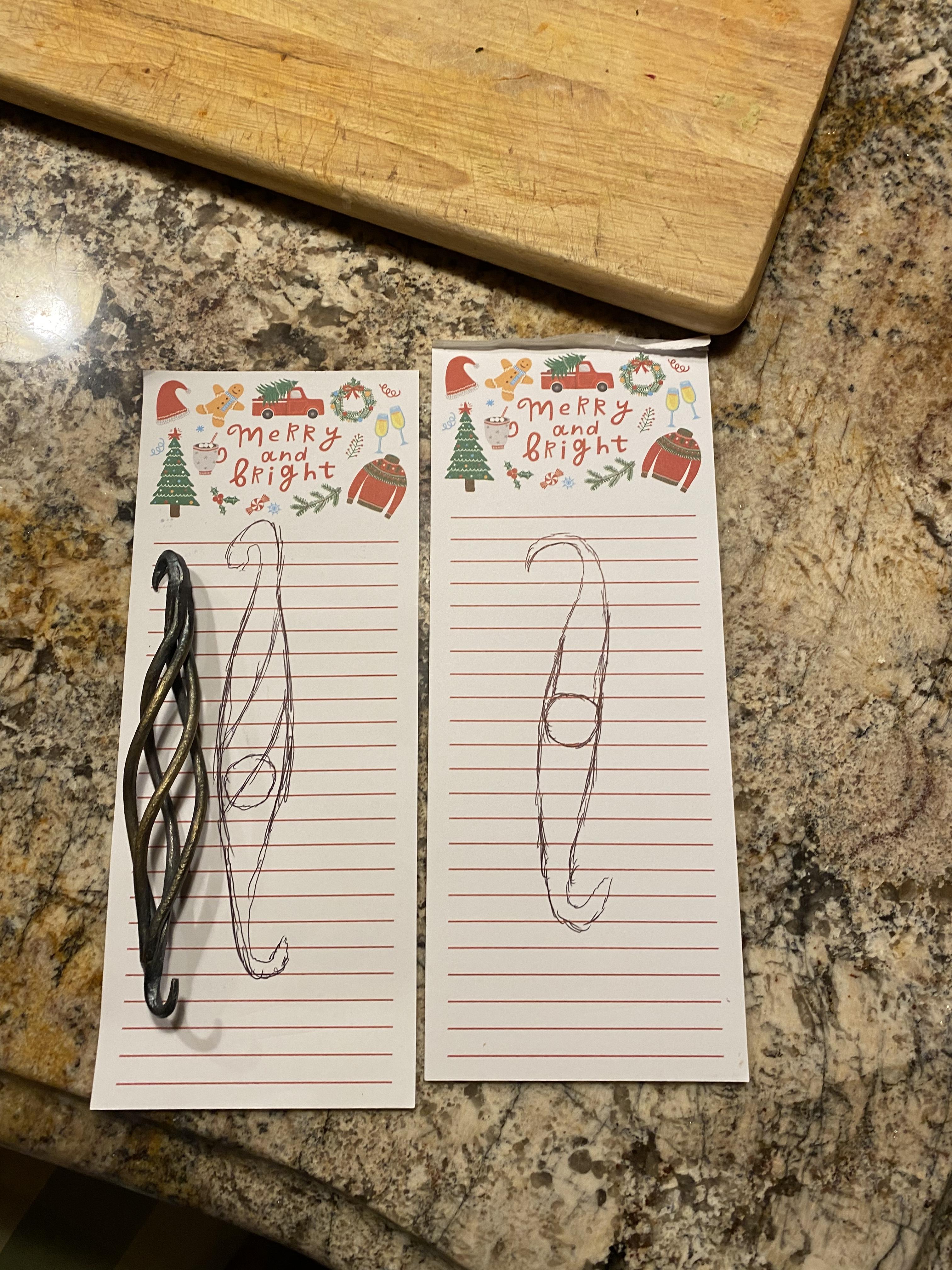

Pat Masterson Posted October 7, 2021 Share Posted October 7, 2021 On 10/4/2021 at 3:08 PM, ThomasPowers said: I've seen other people stick a marble in the basket to fancy it up a bit. I saw John Switzer from Black Bear Forge do this. Definitely a cool idea but I don’t like how the marble obviously sits at the bottom of the twist. I shouldn’t say I don’t like it - I do. But knowing how I am i wouldn’t be happy with it knowing how much cooler i think it would be if the marble stayed in the center like it was suspended. After looking at this twist I did I guess I could pull that off if I size it right and then heat just two of the bars the minimum amount to squeeze the marble in and then pull them back so they trap the marble. Actually this reminds me - while making that globe I did I was trying to peen over the ends of the center rod that it was spinning on where it went through the holes in the half meridian thing - the flared ends are all that’s holding it together. But I tried using a little benzomatic torch to heat them so I could be a little more gentle when hammering them but it would not heat a 1/4 inch long section of 3/16” bar to even a dull red. I couldn’t believe it - I think it was because of the angle I had to hold it at though which maybe made it so the hottest part of flame wasn’t on the spot I needed because I had used it to get the 1/4” spokes to a black heat pretty easily. But for this part I had to keep it away from a piece that was held on with JB Weld so I could only hold it a certain way. Anyway the point of this whole novel I’m writing - I didn’t know there was such a thing as an “air acetylene torch” which is cheaper and from what I understand less dangerous than an oxy acetylene set up. Does anyone know if these get hot enough for the kind of stuff I’d need it for - small localized heats on small stock usually 1/2” being the largest? Anyone ever used one? Kind of funny - forge welding has been this hugely daunting idea to me ever since I started smithing. I watch a lot of Black Bear Forge and he always says it’s such an essential skill to have. But now that I actually did it I find myself doing a lot of staring at this basket twist where it’s welded. This simple little thing is becoming one of my favorite pieces just because I pulled off the welds lol. Quote Link to comment Share on other sites More sharing options...
ThomasPowers Posted October 7, 2021 Share Posted October 7, 2021 Could always do "peas in a pod" and put several marbles in. Differing colours might be nice. Stuff one in it for the bottom, one in for the top and then one in the middle depending on sizing. Of course the heavier it is; the larger the limb on a Christmas tree it hangs from---or the closer to the trunk. I like welding baskets as they tend to be a nice easy weld to do even with a fairly small fire. Quote Link to comment Share on other sites More sharing options...

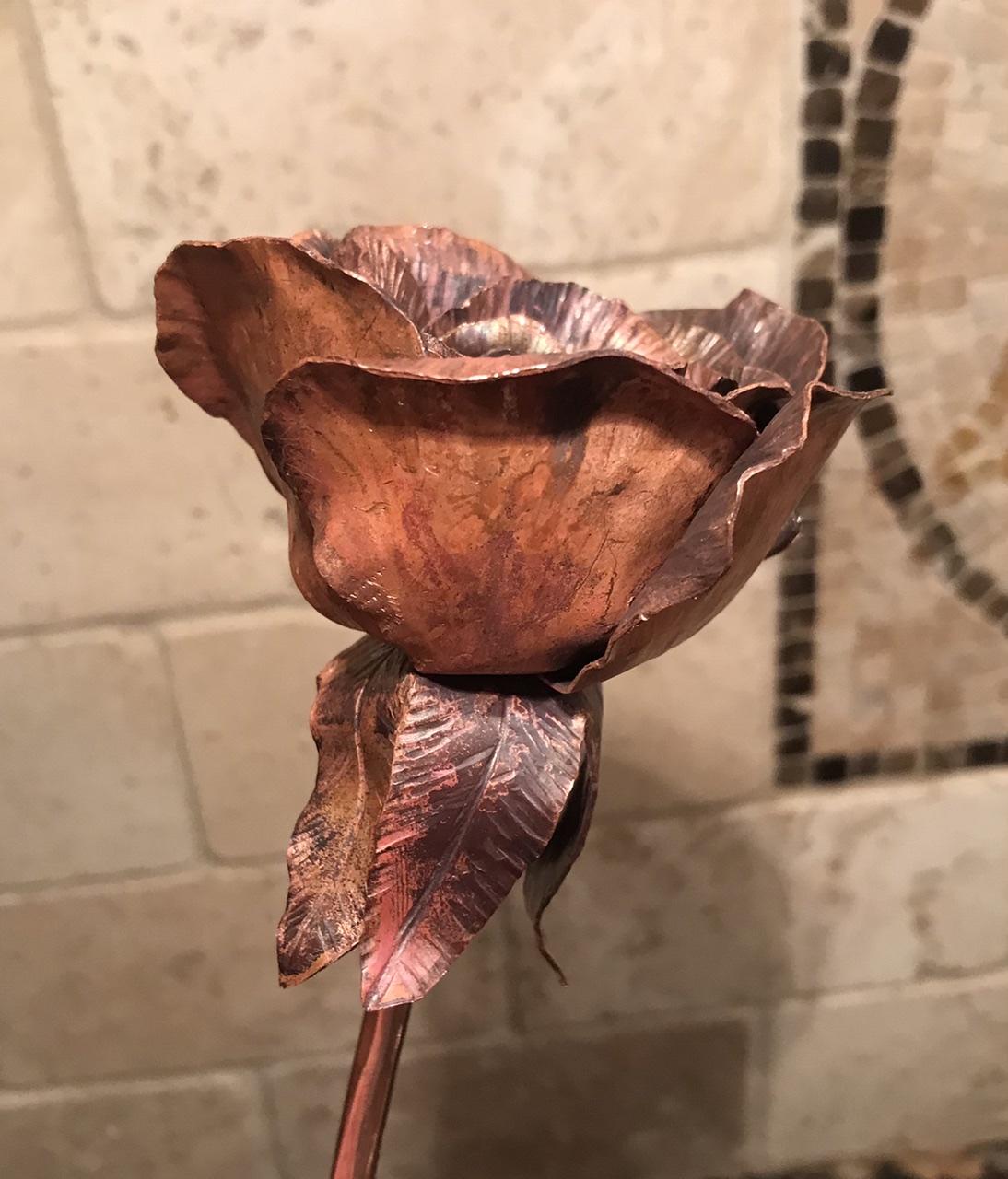

Rojo Pedro Posted October 8, 2021 Share Posted October 8, 2021 I finished a copper rose. A gift for the wifes bestie. I like the shape but think I got little too heavy with the peen. Overall very happy thanks for looking Quote Link to comment Share on other sites More sharing options...
Irondragon Forge ClayWorks Posted October 8, 2021 Share Posted October 8, 2021 It looks outstanding to me. I'm sure she will love it and the peening looks good too. Quote Link to comment Share on other sites More sharing options...
