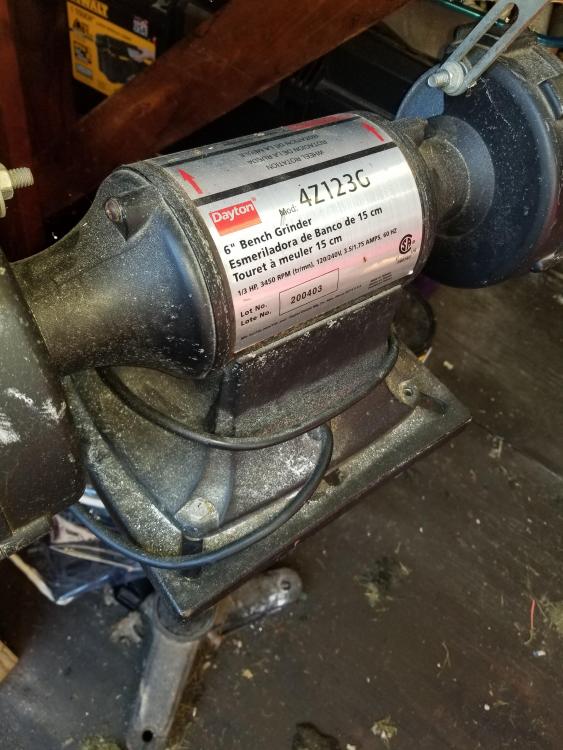

Gandalfgreen Posted September 27, 2021 Share Posted September 27, 2021 my buddy came way down on what cards he wanted realized the difference in value and well was able to work it out so I now own that welder 2 masks a giant brand new c clamp. and few odds and ends and this grinder below Quote Link to comment Share on other sites More sharing options...
TWISTEDWILLOW Posted September 27, 2021 Share Posted September 27, 2021 Congratulations Gandalfgreen! I m glad you were able to work out a better deal! Quote Link to comment Share on other sites More sharing options...

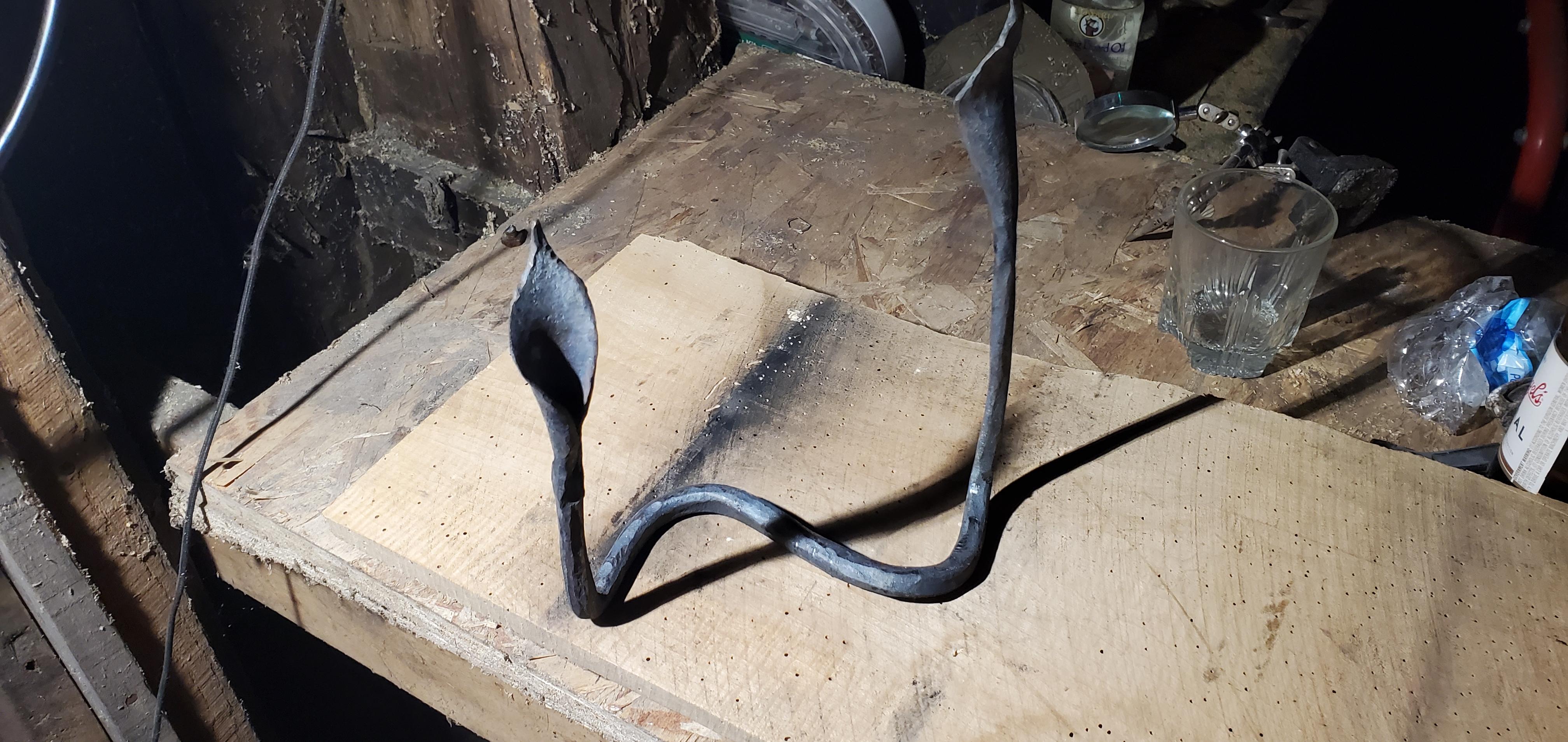

Chad J. Posted September 28, 2021 Share Posted September 28, 2021 Working on a candle holder, need to put some leaves. I'd never tried to do that before and I must say, it's time to find or make some more tools. I'm going to tighten up the base a bit but it'll have to be over the coal forge but I'm very happy with it so far. Quote Link to comment Share on other sites More sharing options...
JHCC Posted September 28, 2021 Share Posted September 28, 2021 9 hours ago, Chad J. said: it's time to find or make some more tools. It’s always that time! Quote Link to comment Share on other sites More sharing options...
Rojo Pedro Posted September 28, 2021 Share Posted September 28, 2021 Looks good Chad Finished a hook and started a file knife. Need to practice ball ends Quote Link to comment Share on other sites More sharing options...

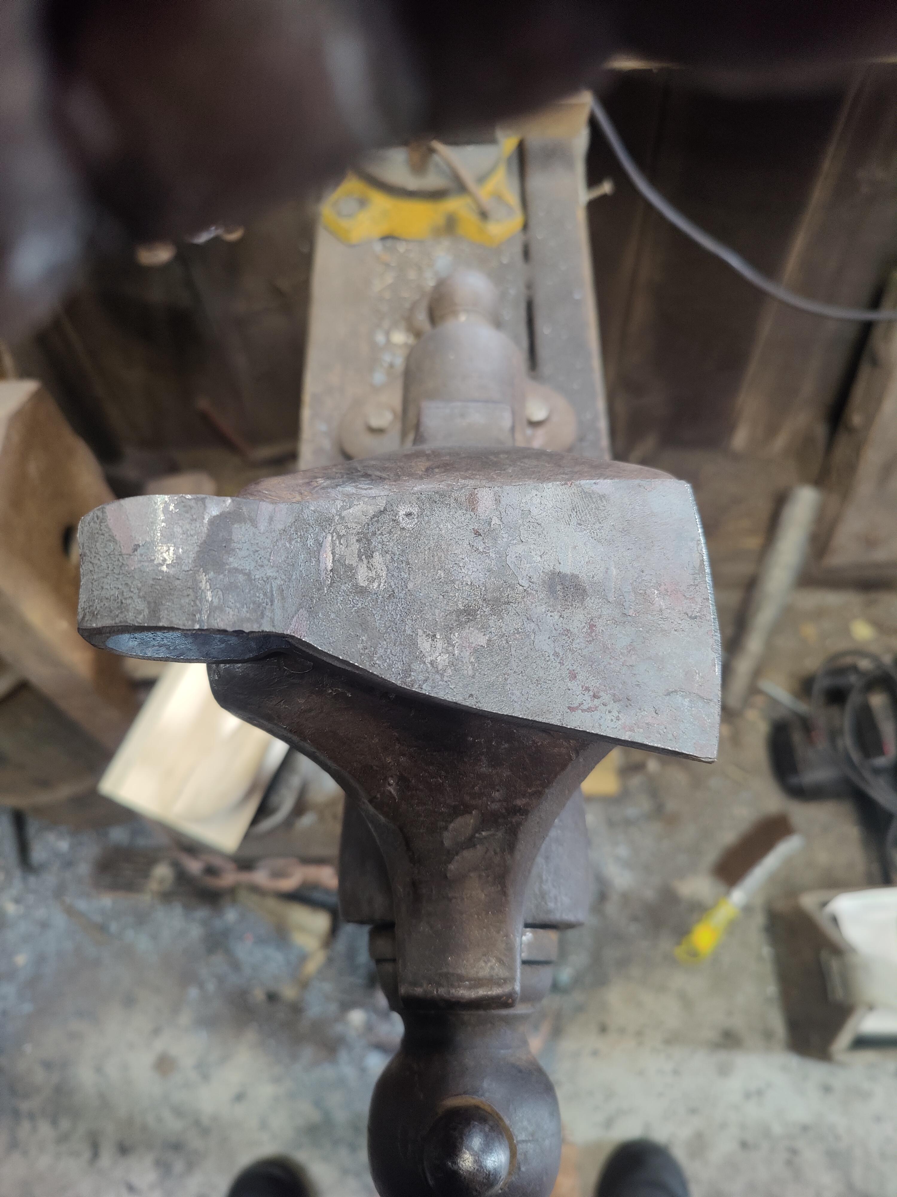

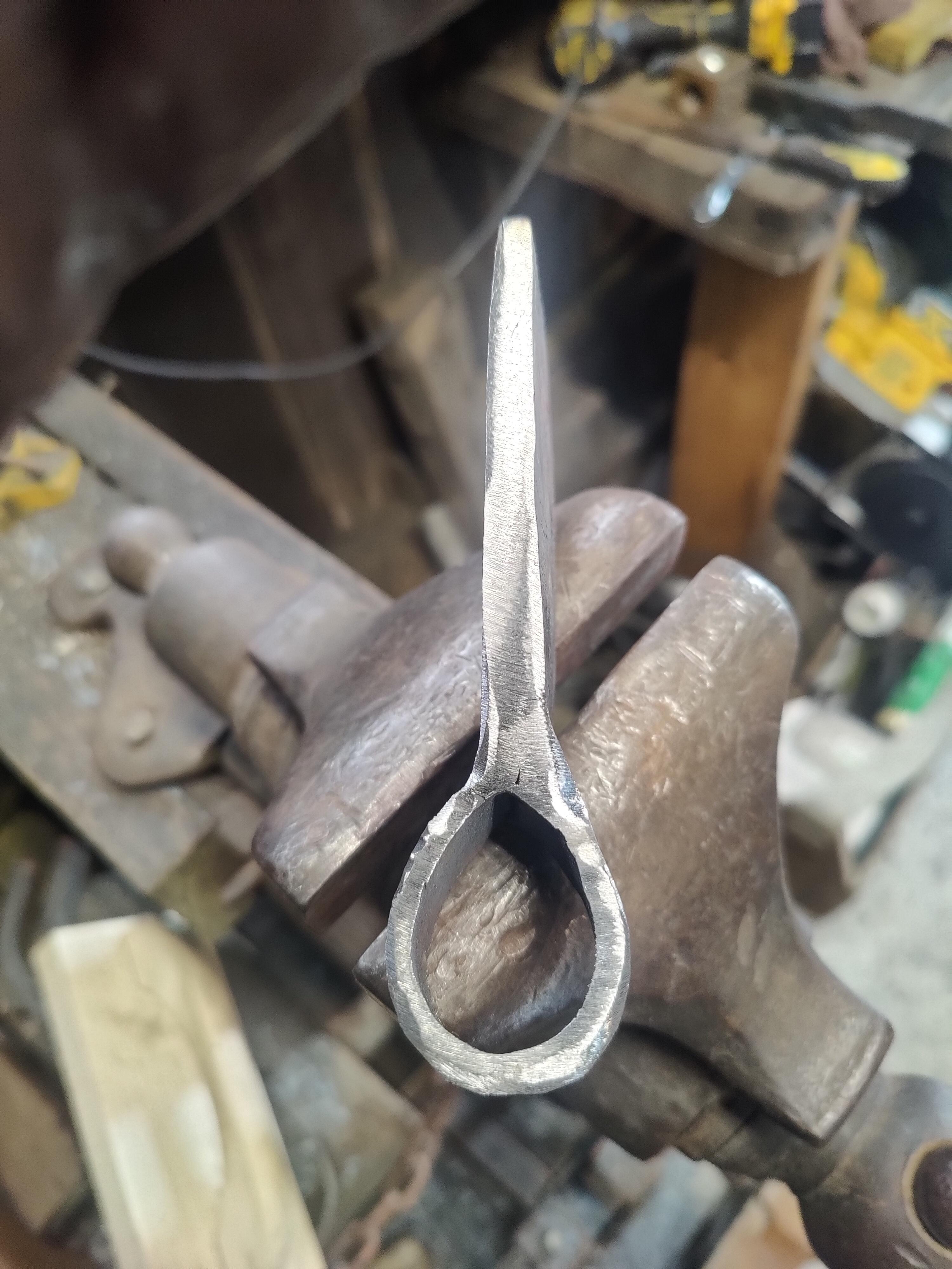

BillyBones Posted September 28, 2021 Share Posted September 28, 2021 Had to try out the new toys. Still a little work to do. Just a tad off center but still some drawing out to do so that should be fixed and one little spot where my cheeks did not quite meet that did not weld. Mild steel with an old rasp for the bit. Quote Link to comment Share on other sites More sharing options...

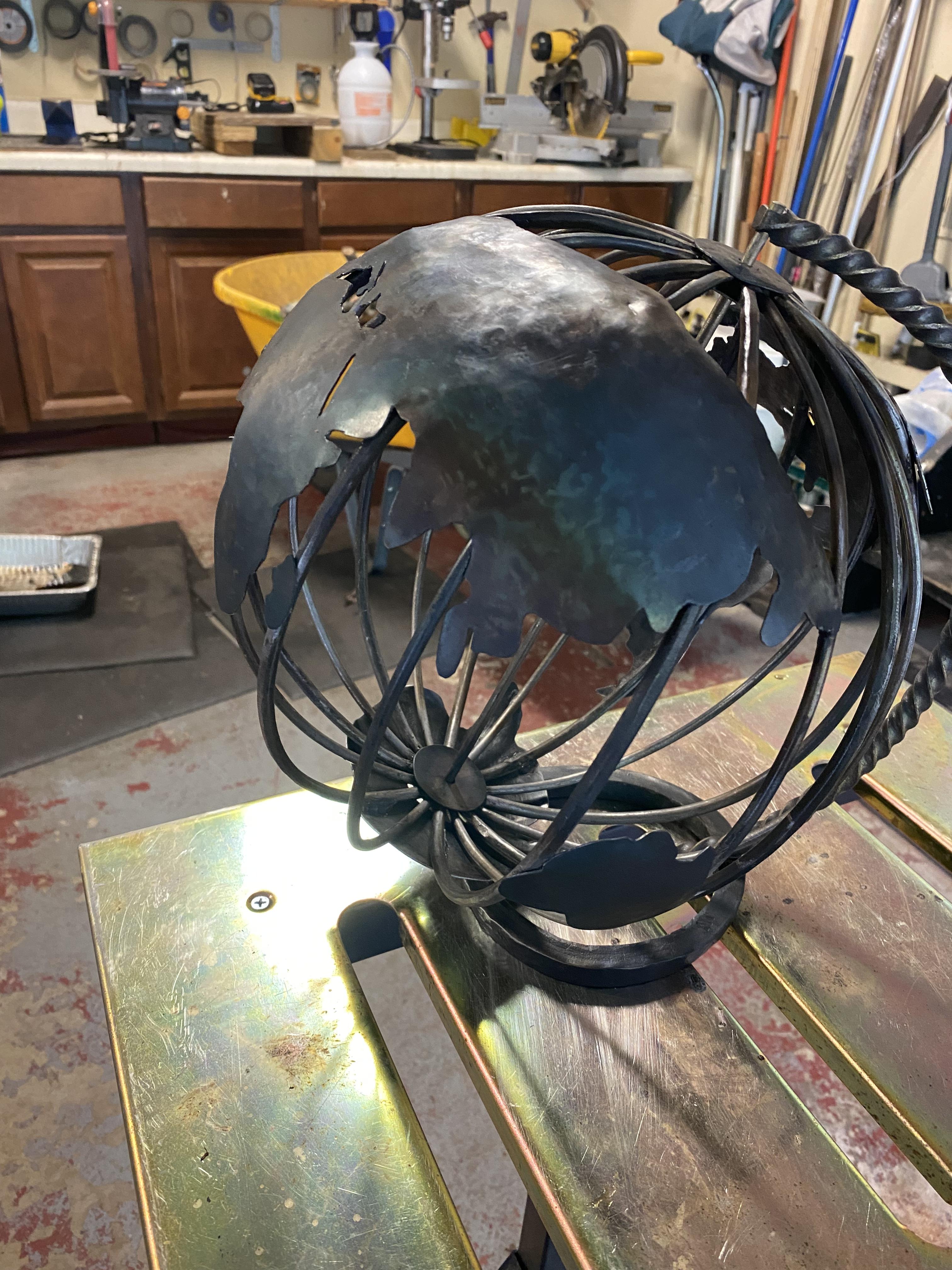

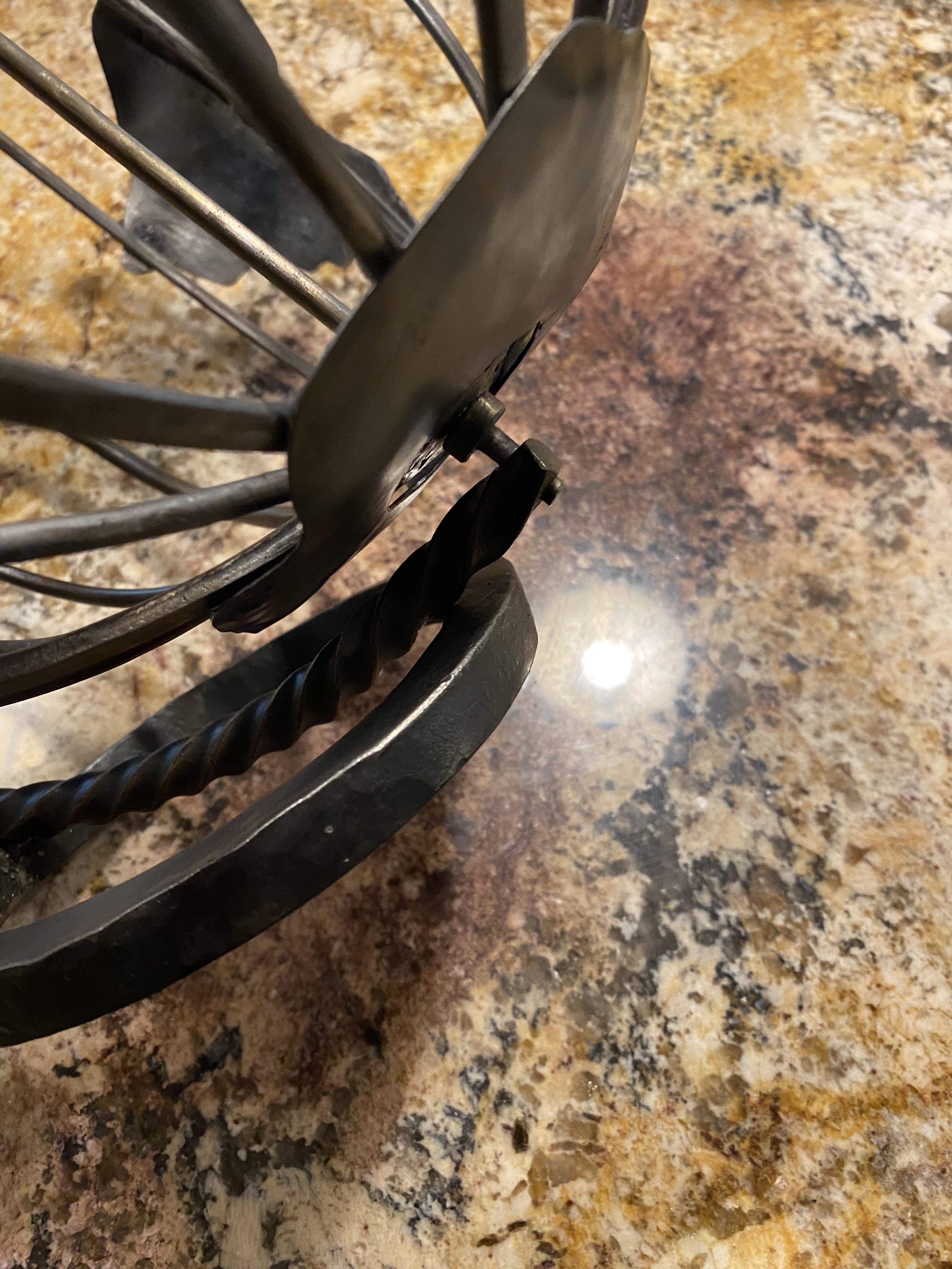

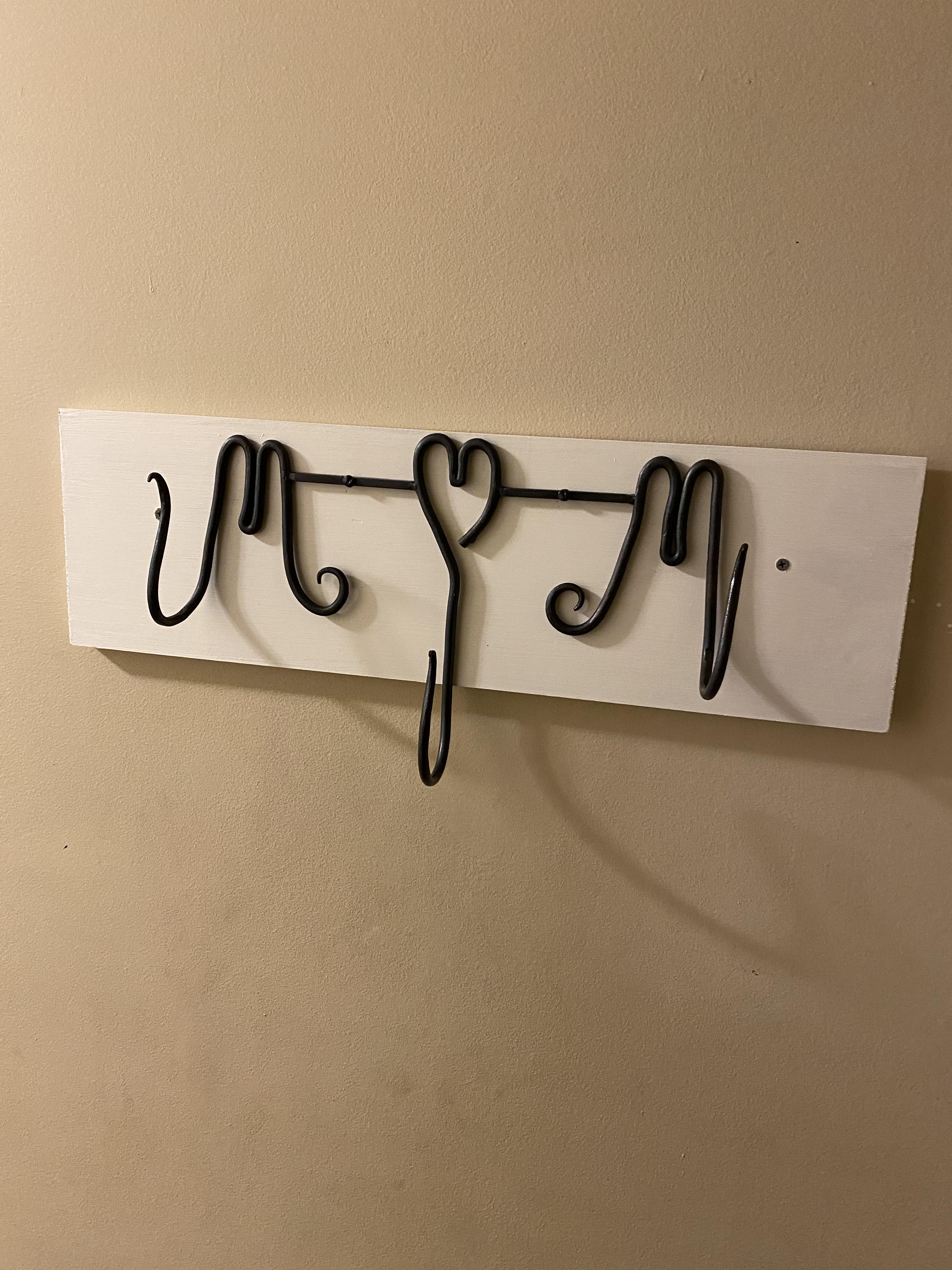

Pat Masterson Posted September 28, 2021 Share Posted September 28, 2021 Haven’t gotten on here or really been able to work on any projects for about two weeks…but the bright side is I get 20 or so pages of new “what did you do in the shop today” posts to go through. I got out of work a bit early today and finally, finally finished this globe. I don’t even know how many months work of weekends this took but I’m pretty happy with it - would do a lot of things different on the next one but still pretty cool. Strange thing - the sheet metal I used for the continents took the paste wax finish differently than bar stock…I definitely went past temper colors to a black heat then hit it with the wax when it got down to the right temperature but they still came out with all of these crazy colors - still temper colors I guess but they look quite - “earthy” so I’m actually loving that part. And it spins surprisingly well. I just made a little washer for the center post that went under the globe and that keeps it at the right height. So much trial and error with this thing I’m glad it’s over lol. And going with my normal theme I came to realize that this coat hook for Mother’s Day wasn’t very well though out either. The mourning holes weren’t spaced far enough apart to each hit a stud so I mounted it to this piece of wood and mounted to the board to the wall so it will actually hold some heavy coats. Hope everyone is staying safe, healthy and happy. IMG_1217.MOV Quote Link to comment Share on other sites More sharing options...
Chad J. Posted September 28, 2021 Share Posted September 28, 2021 How did you cut out the continent's again, that looks great. How did you amount for the curvature or did you kinda wing it? Quote Link to comment Share on other sites More sharing options...
ThomasPowers Posted September 28, 2021 Share Posted September 28, 2021 You know that if you just stuck to the Super Continents like Pangea and Rodinia and others; then it would be easier to cut and mount them on globes!---Of course the globes would also be more lopsided in weight... Nice and cool today would be great to sneak into the smithy, save for the dark and wet! Quote Link to comment Share on other sites More sharing options...
Rojo Pedro Posted September 28, 2021 Share Posted September 28, 2021 Hope you used the latest ellipsoid although I’d bet your magnetic interference is through the roof! Quote Link to comment Share on other sites More sharing options...

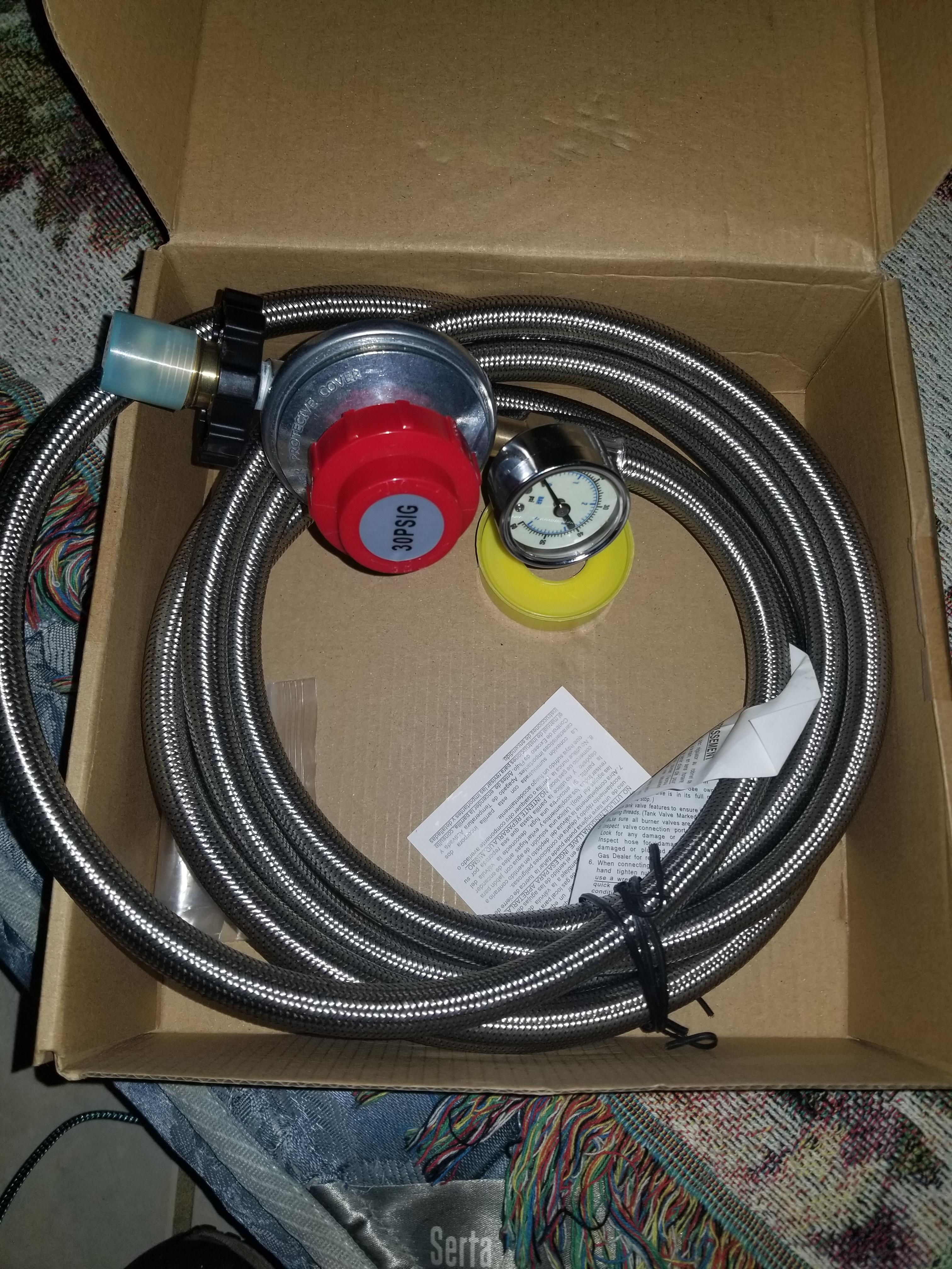

Gandalfgreen Posted September 28, 2021 Share Posted September 28, 2021 showed up one day early heck yes. 12 ft s.s. braided line 0to 30psi regulator and a pressure gauge. tomorrow night could be firing up the forge though just to dry silica. so close and so ready. Quote Link to comment Share on other sites More sharing options...

Pat Masterson Posted September 29, 2021 Share Posted September 29, 2021 23 hours ago, Chad J. said: How did you cut out the continent's again, that looks great. How did you amount for the curvature or did you kinda wing it? Thanks. For cutting them out I started with a Dremel but that quickly became aggravating so I went with the angle grinder which cut through the 22 gauge sheet like butter obviously. Just did rough cuts and then I was able to get the finer shapes on my little belt grinder and some filing and then a lot of shaping with a ball peen and stump with a bowl impression I hammered into it. And yes - if the term “winging it” was in the dictionary it would have a picture of me holding this globe. Definitely want to make another one. Next one I’ll use a uniform size for all of the spokes instead of two different sizes which I just did because it was what I had on hand. As far as the continents go I’d probably do it basically the same way except without trying to get so much little detail - once the whole thing is together I think the little parts that were very difficult don’t really make it much better looking. Attaching the continents was my biggest problem. Tried welding first and blew right through cuz I’m terrible at it. Tried JB weld then it melted when I wanted to blacken everything, then the wrong type of gorilla glue and then finally got it with the right gorilla glue. I forget who but someone on here suggested attaching them with brass rivets and I think that would look really awesome so that would be my next try. Thanks again for that suggestion whoever you are! Quote Link to comment Share on other sites More sharing options...

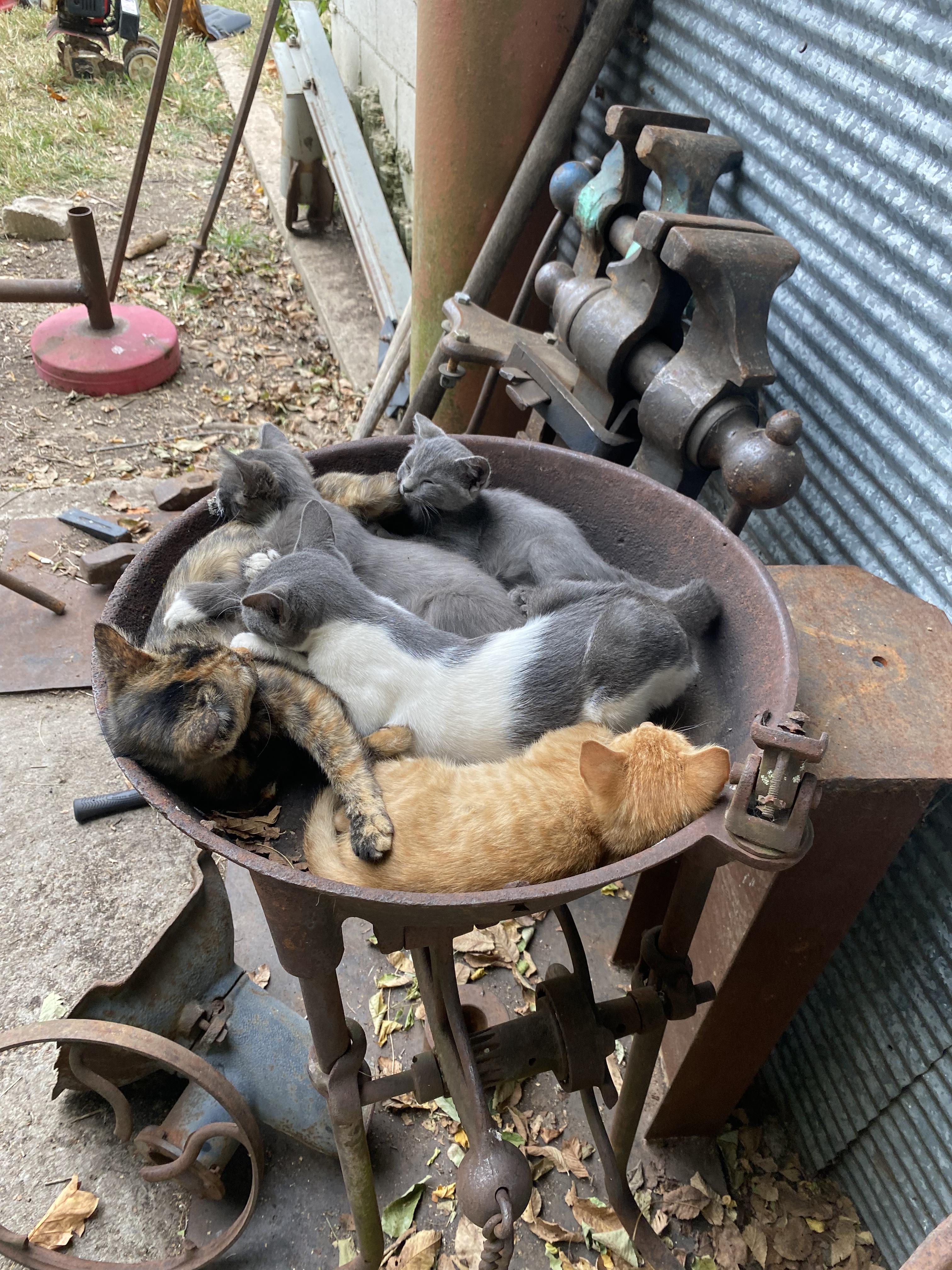

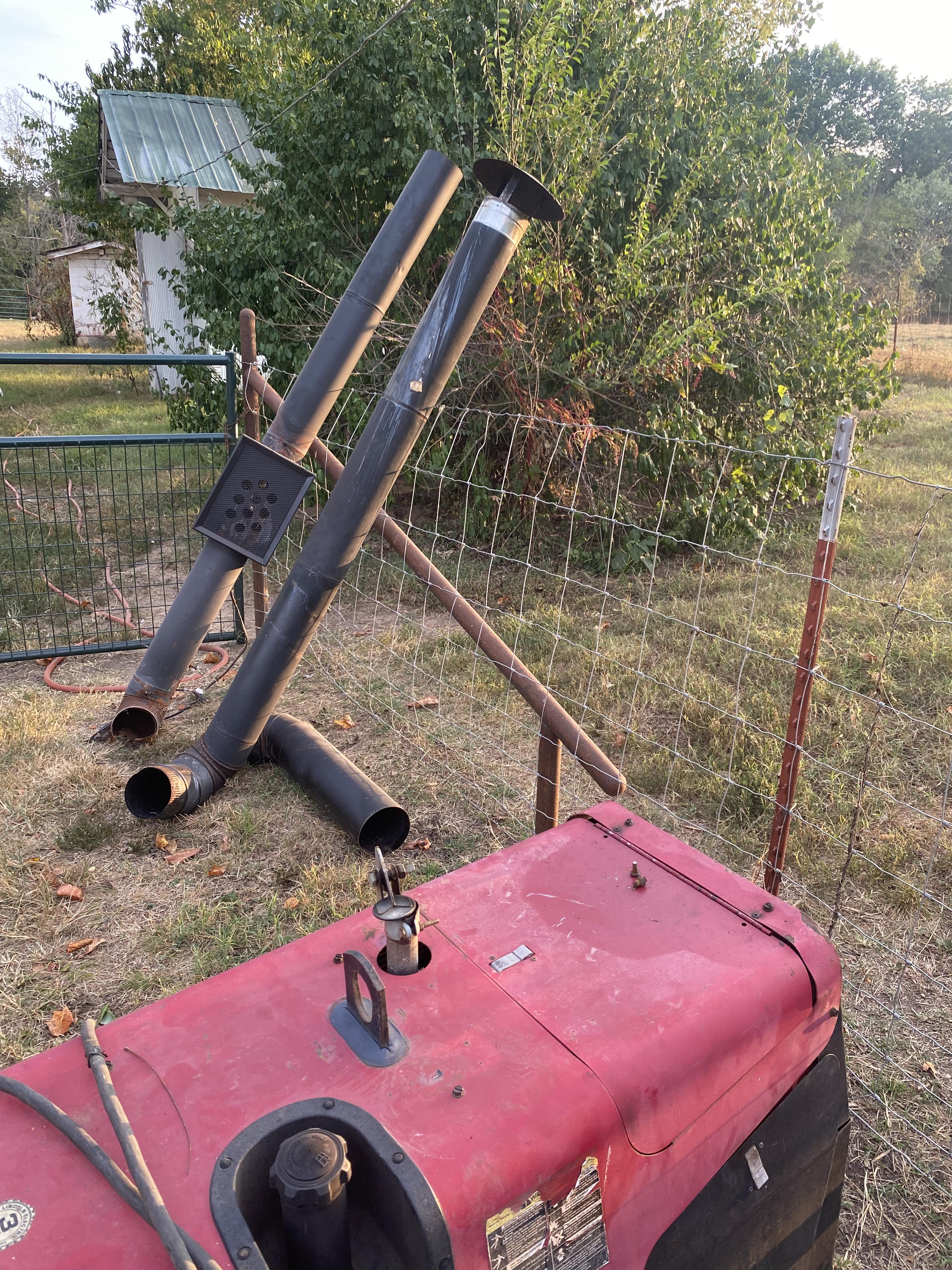

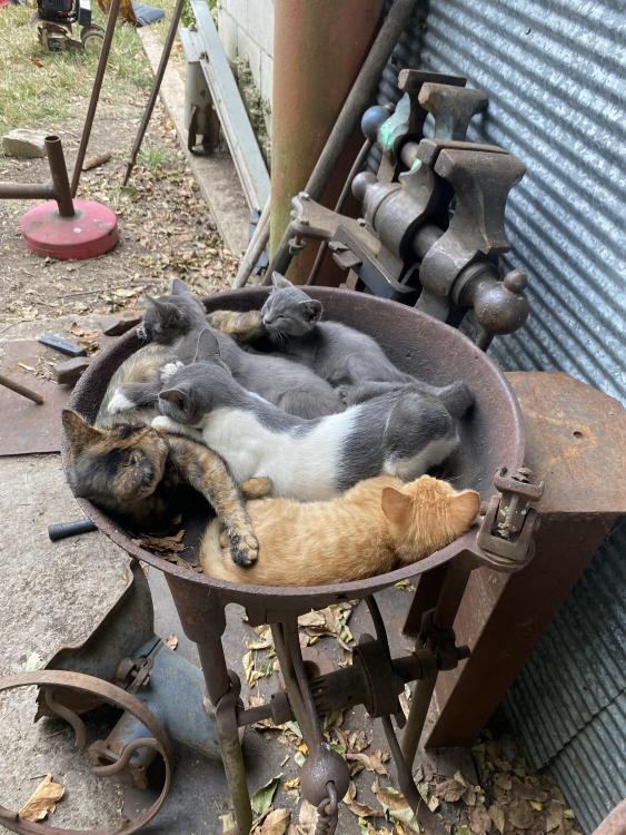

TWISTEDWILLOW Posted September 30, 2021 Share Posted September 30, 2021 Today Been working on tearing down last year’s stove pipe and installing new for this year out in the shop it’s still warm outside here but it won’t be long before it cools down an I hate climbing up on the roof in cold wind, I’ll finish up in the morning, also the shop cats weren’t much help today… Quote Link to comment Share on other sites More sharing options...
