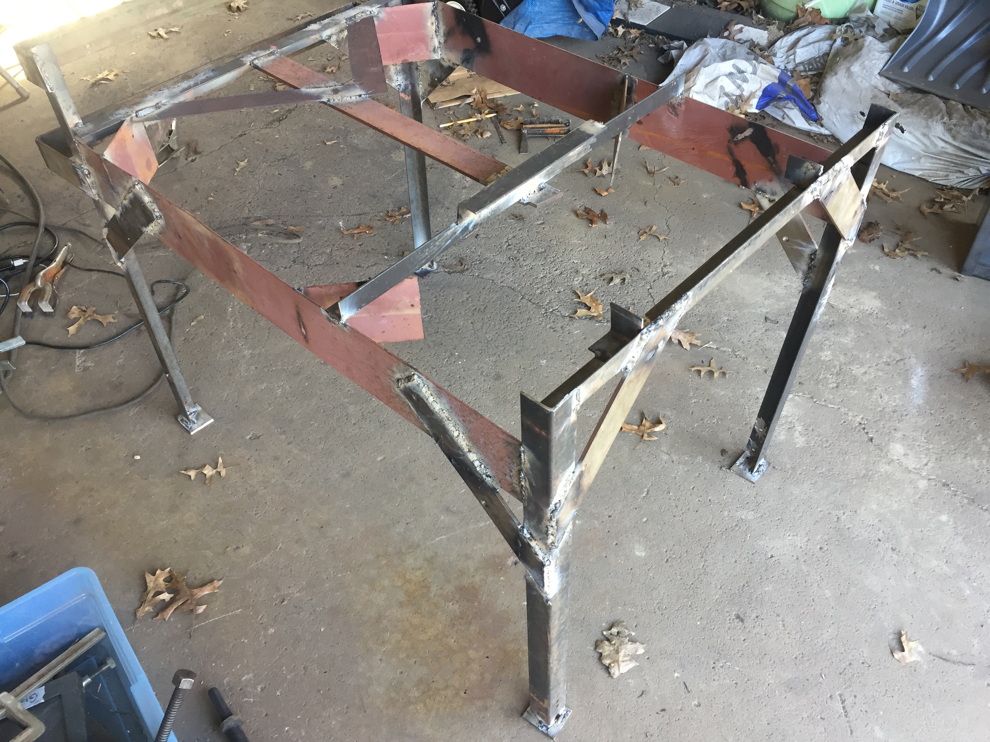

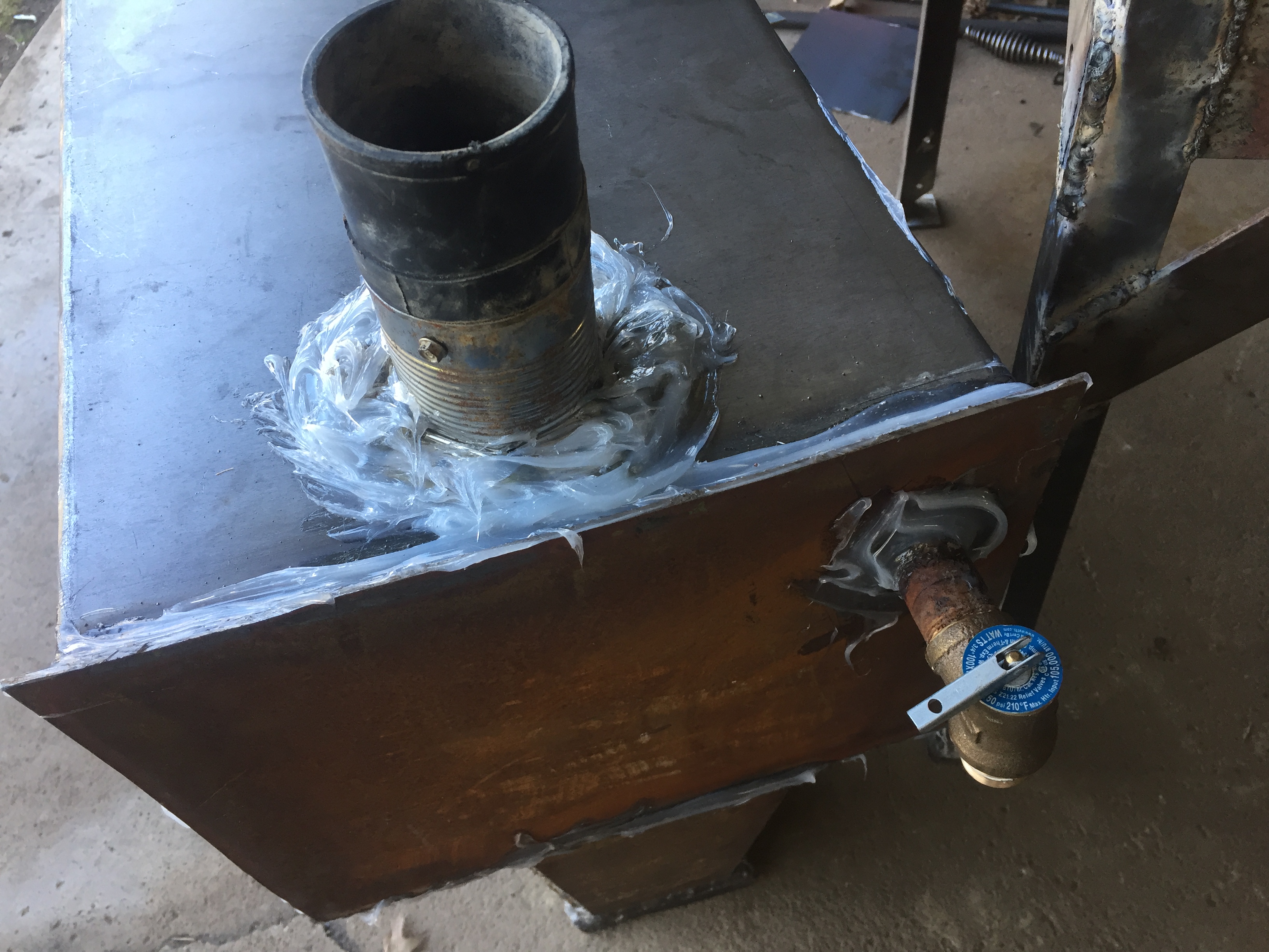

JHCC Posted April 22, 2018 Share Posted April 22, 2018 Welded on diagonal braces (two each in all four corners) and a central support down the middle of the firebox: It is MUCH more solid (i.e., without wiggle-wiggle) now. I’ll probably add a shelf at some point per Frosty, but I think we’re good for now. Also siliconed the seams of the bosh. I decided to use the old air intake off the JABOD, both because it works well and also as a memento of that particular forge. (Note the drain valve for the bosh, salvaged off a friend’s dead hot water heater.) Quote Link to comment Share on other sites More sharing options...

tonyw Posted April 22, 2018 Share Posted April 22, 2018 Just a tip, If you dip your finger in a mixture of dish soap and water, you can tool a bead of silicone without it sticking to your finger... Quote Link to comment Share on other sites More sharing options...
JHCC Posted April 22, 2018 Share Posted April 22, 2018 Another thing that would have been good to know a few hours ago! Quote Link to comment Share on other sites More sharing options...

BIGGUNDOCTOR Posted April 23, 2018 Share Posted April 23, 2018 6 hours ago, tonyw said: Just a tip, If you dip your finger in a mixture of dish soap and water, you can tool a bead of silicone without it sticking to your finger... An ice cube is even better, and can be shaped. Quote Link to comment Share on other sites More sharing options...
Glenn Posted April 23, 2018 Share Posted April 23, 2018 Use a plastic spoon or the end of a plastic knife. Quote Link to comment Share on other sites More sharing options...
SLAG Posted April 23, 2018 Share Posted April 23, 2018 If you must use your fingers, try spraying a little amount of WD40 on said fingers. SLAG. Quote Link to comment Share on other sites More sharing options...
JustAnotherViking Posted April 23, 2018 Share Posted April 23, 2018 9 hours ago, tonyw said: Just a tip, If you dip your finger in a mixture of dish soap and water, you can tool a bead of silicone without it sticking to your finger... I shall have to give this a go. I tried to silicone seal a big galvanised bin to hold water, but ended up with more over my gloves than on the bin... either way, it didn't stick or seal at all. I tried a high temp silicone after the first failure... it did stick to the bin, but dissolved in water... go figure. Third times the charm? right??? Quote Link to comment Share on other sites More sharing options...
