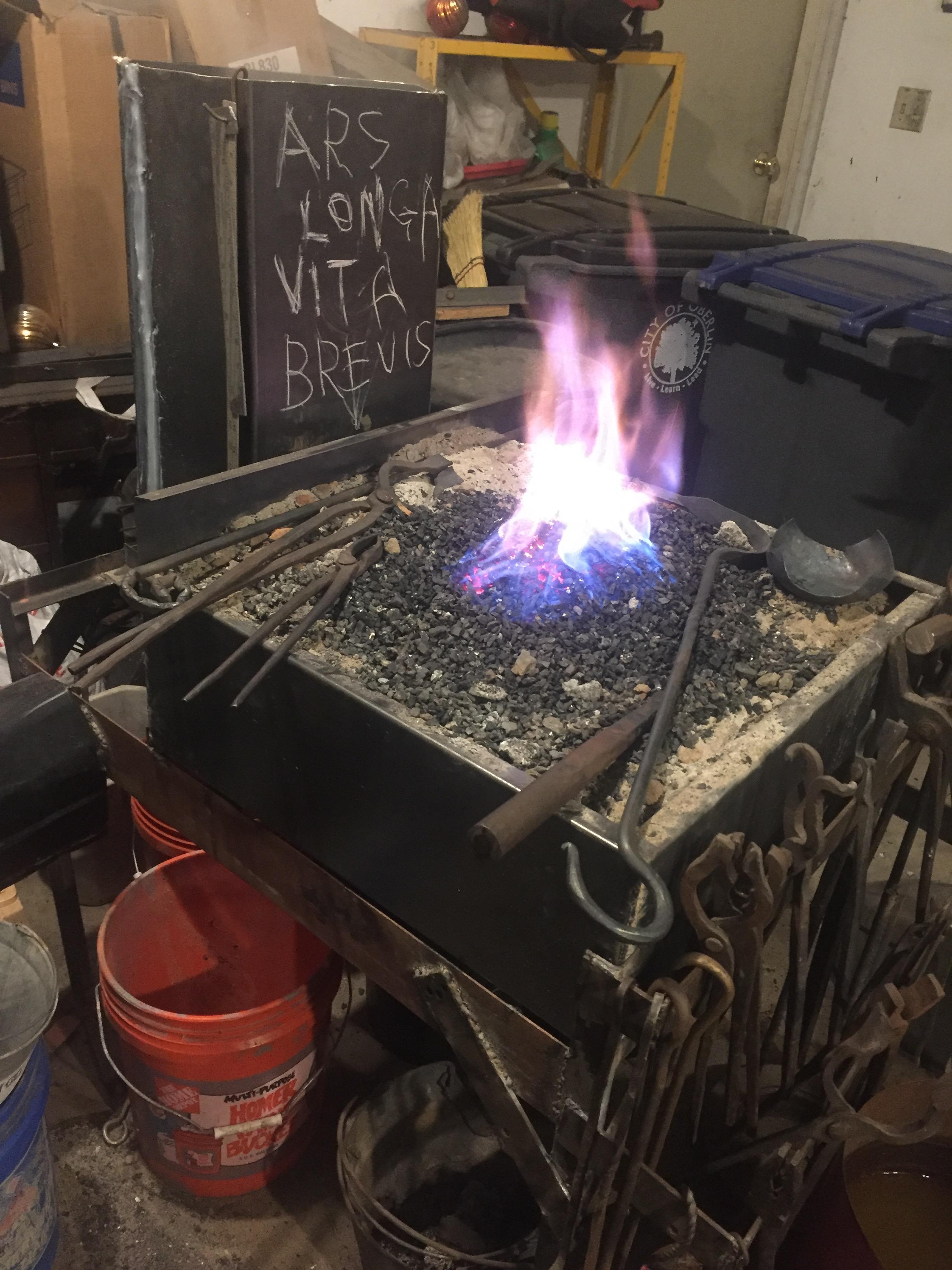

Judson Yaggy Posted May 1, 2018 Share Posted May 1, 2018 20 hours ago, JHCC said: Steam! "art long, life short"? Trying to learn more Latin. Quote Link to comment Share on other sites More sharing options...
JHCC Posted May 1, 2018 Share Posted May 1, 2018 Yes. In Latin, if there’s no other verb, you can assume the verb “to be”. Thus, “Art is long; life is short.” The original was in Greek, from Hippocrates. Geoffrey Chaucer similarly observed, "The life so short, the craft so long to learn.” Quote Link to comment Share on other sites More sharing options...

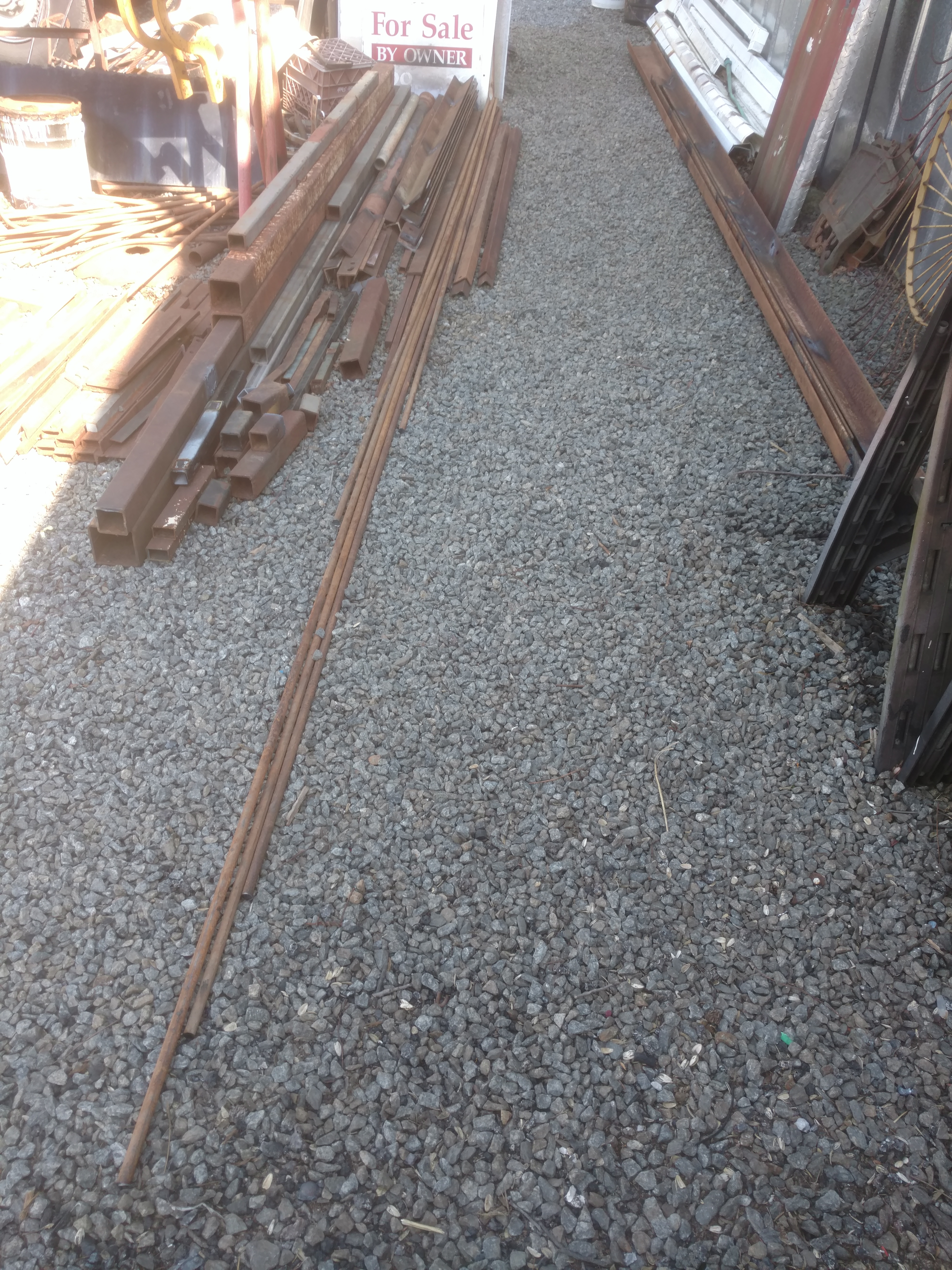

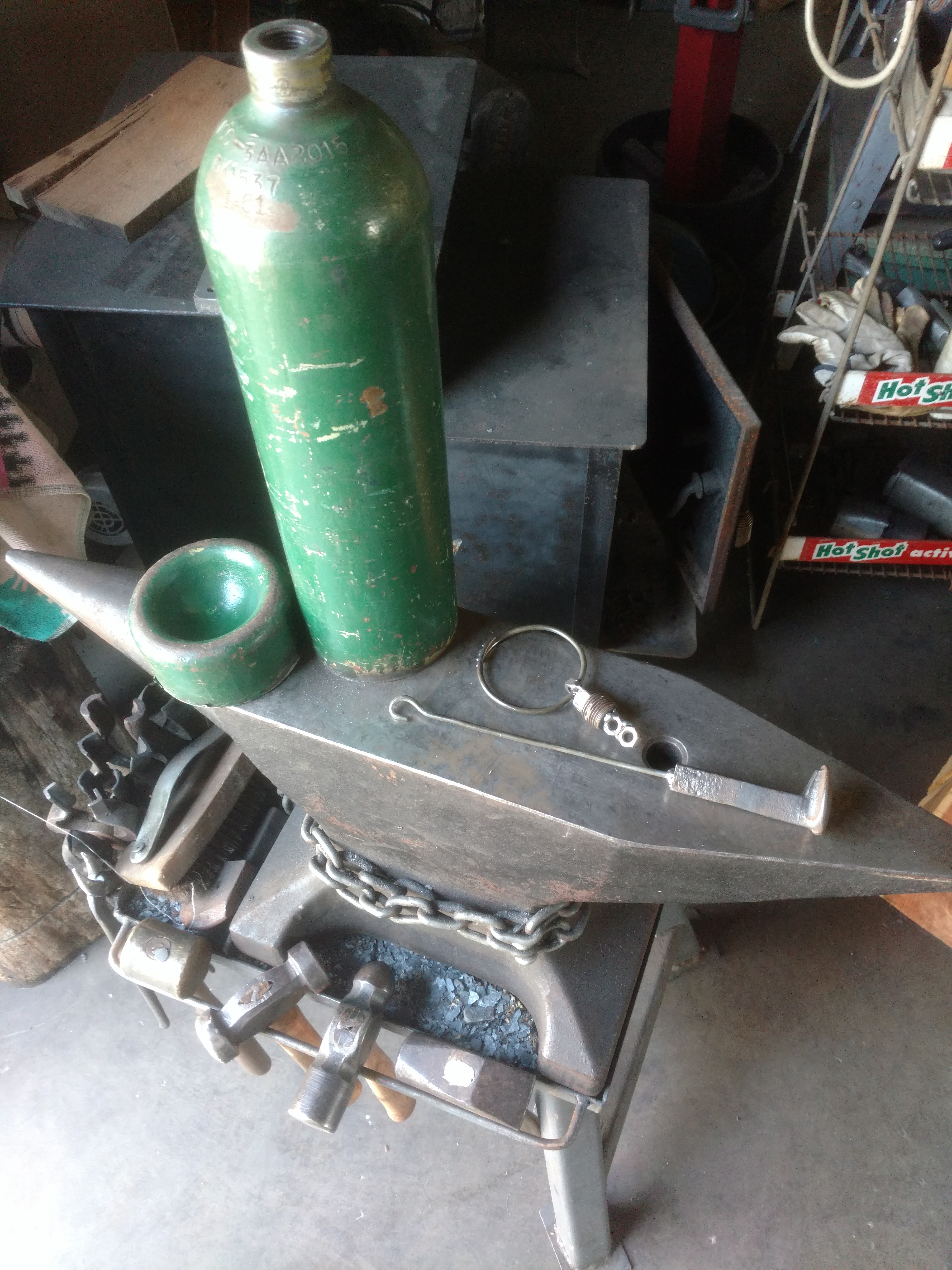

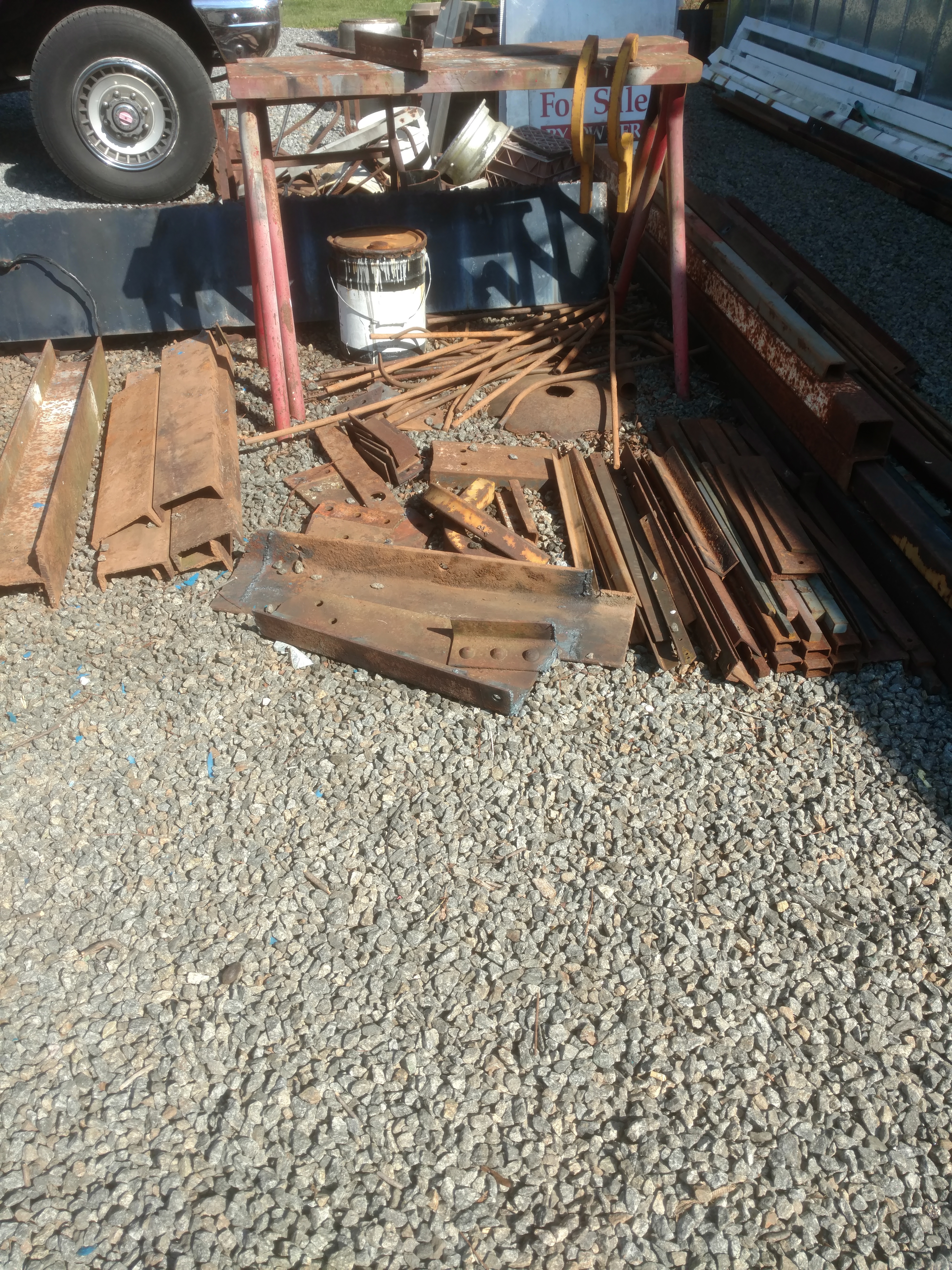

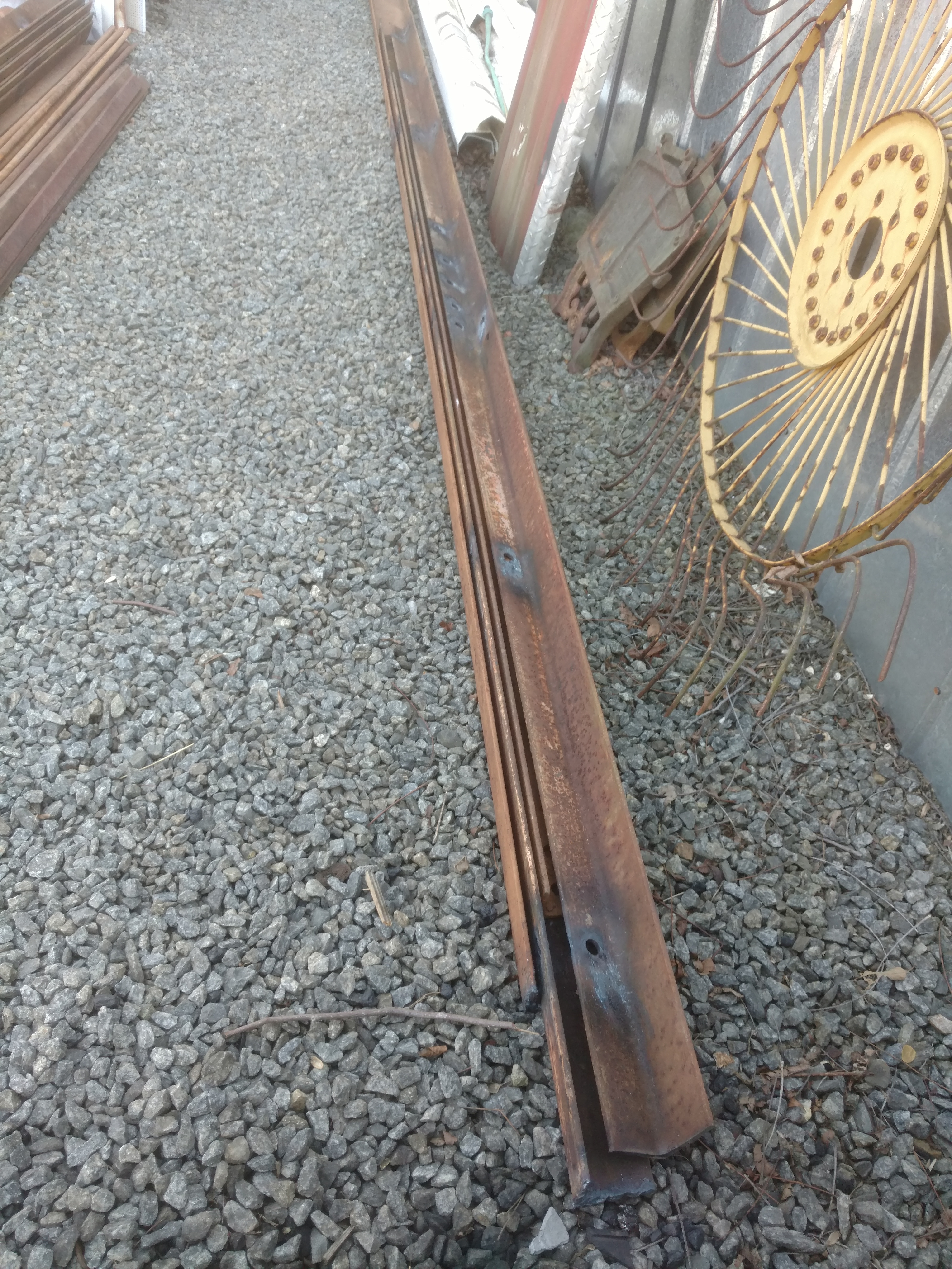

Reeltree Posted May 1, 2018 Share Posted May 1, 2018 Have been cleaning up a couple scrap metal piles, dismantled a steel truss for angle iron. Found a lost oxygen pony bottle,. Cut off the bottom for a dishing tool , rigged up a part of a r x r spike for the bell clapper . Extracted the high density foam out of the old hot tub cover. Quote Link to comment Share on other sites More sharing options...

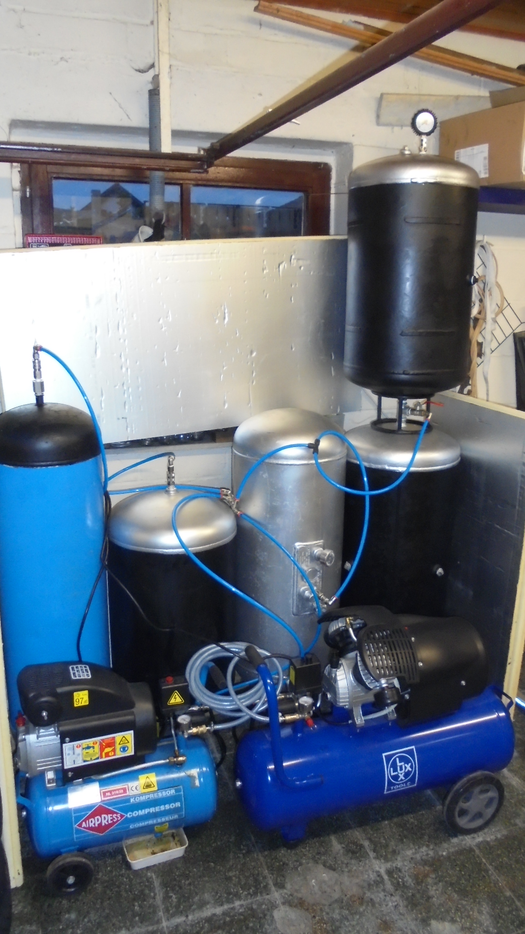

Hans Richter Posted May 2, 2018 Share Posted May 2, 2018 After getting some real huge air tanks I rebuild the aspiration area of the power hammer. 130gal’s on 145psi. Happy the breathless time is over. Create a nice sky line of ‘Tumulus’ Air Power Towers. Give them a nice paint job and pressure integrity test after all. Quote Link to comment Share on other sites More sharing options...
ThomasPowers Posted May 2, 2018 Share Posted May 2, 2018 And blast shielding? Quote Link to comment Share on other sites More sharing options...
Hans Richter Posted May 2, 2018 Share Posted May 2, 2018 Release valves on both the compressors and the tanks as well (155psi), -thanks to mention it. Quote Link to comment Share on other sites More sharing options...
ThomasPowers Posted May 2, 2018 Share Posted May 2, 2018 I have seen the results where folks did not take safety into account. Compressed air stores a lot of energy---why we can use it for what we do use it for. Quote Link to comment Share on other sites More sharing options...
jlpservicesinc Posted May 2, 2018 Share Posted May 2, 2018 Hans, how do you show and air bank, but not show the air hammer??? Quote Link to comment Share on other sites More sharing options...

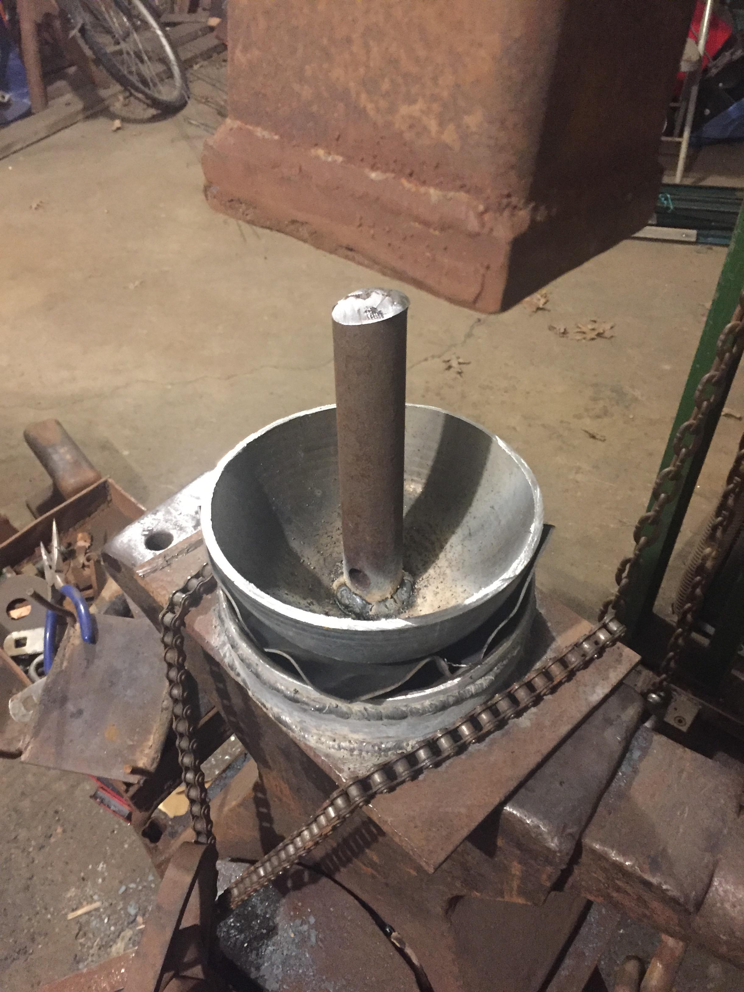

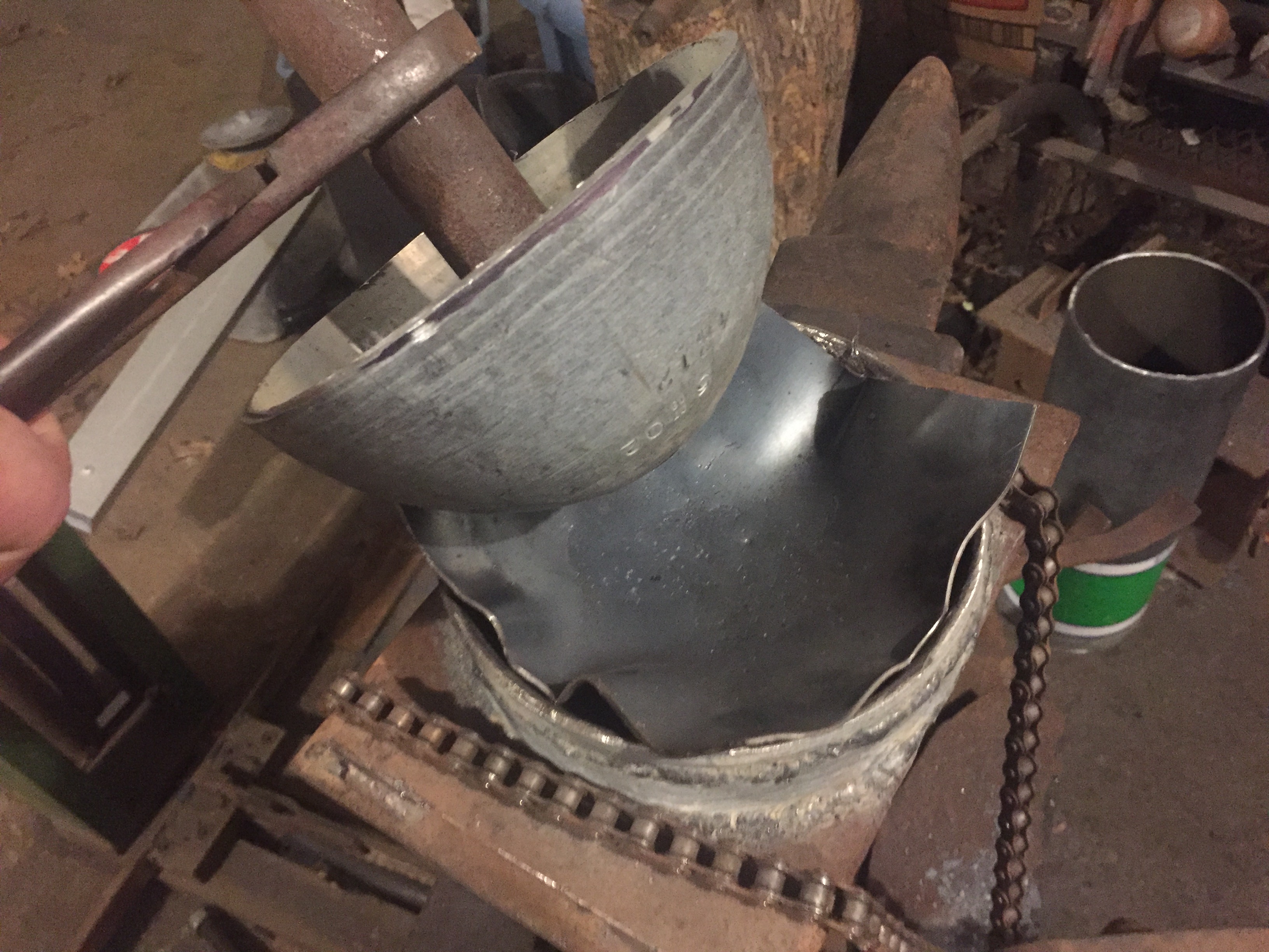

JHCC Posted May 3, 2018 Share Posted May 3, 2018 Welded a rim onto the new forge. Also cut the top off the scuba tank and welded a thick stem to the inside. Together with the dishing form I made a few days ago and some judicious whacks from the treadle hammer, it should handle the initial forming of some bowls I’ll be making. Quote Link to comment Share on other sites More sharing options...
JHCC Posted May 3, 2018 Share Posted May 3, 2018 Addendum: the scuba tank is one that was retired after it failed hydrostatic testing. The walls are about 1/4” thick, as you can see in the center section of the cylinder standing on end in the background of the above photo. With the valve removed, there’s no excess air pressure to worry about, and because the tank never held anything besides air, there’s nothing nasty that’s needs to be purged (other than a layer of paint on the inside that should be removed before doing any welding). The steel is soft enough to cut with a portaband. Quote Link to comment Share on other sites More sharing options...

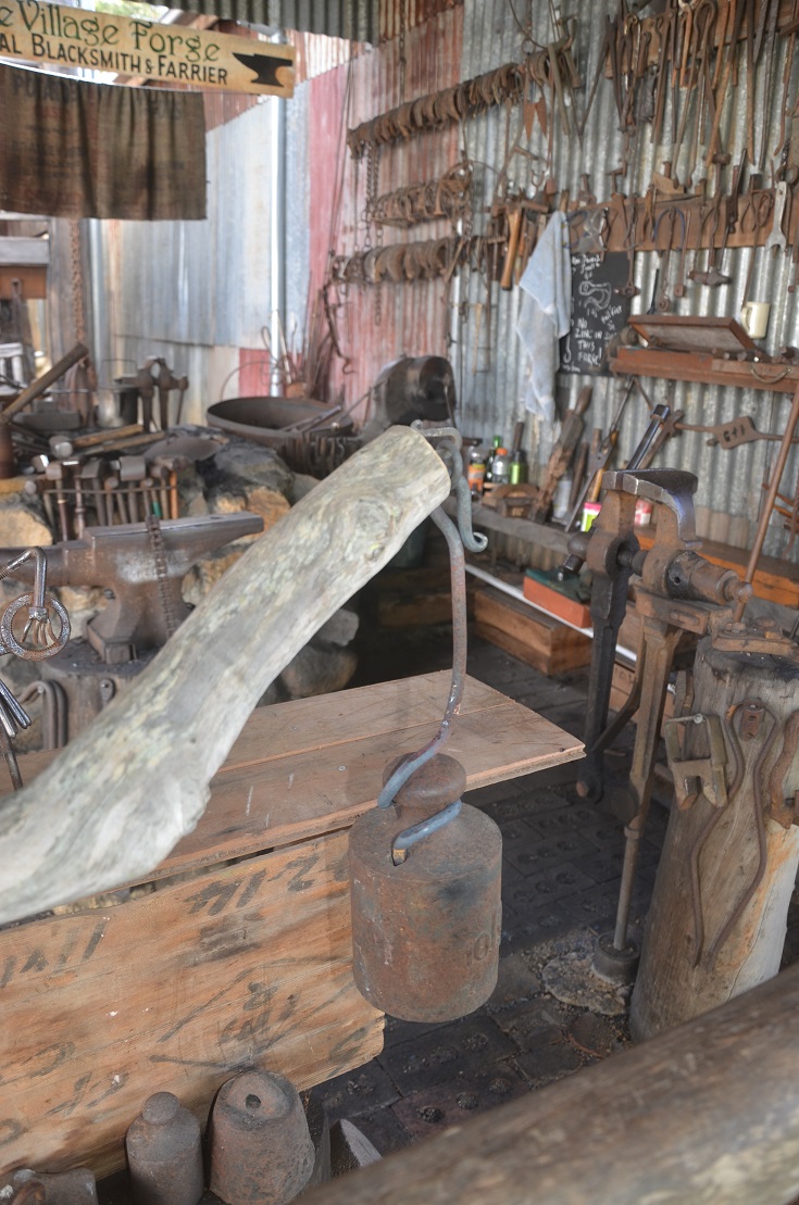

ausfire Posted May 3, 2018 Share Posted May 3, 2018 John, that is one serious dishing set up. Great use of recycled stuff. I spent some time today rearranging the gate to my forge area. We have bar gate that operates on a swivel to allow horses to pass beneath when we have a farrier doing shoeing demos. The counterweight lever on the bar was too long and it blocks the visitors' view. I cut it shorter and tripled the weight on the lever. The 10kg weight had a handy hole in it so it was easy to forge a piece of 10mm steel around into a hook. Another small hook into the wood and bingo - it works well. The three pics show the weight set up, the hook in the timber bar, and the general view of the gate. A bit of maintenance work in between demos: Quote Link to comment Share on other sites More sharing options...

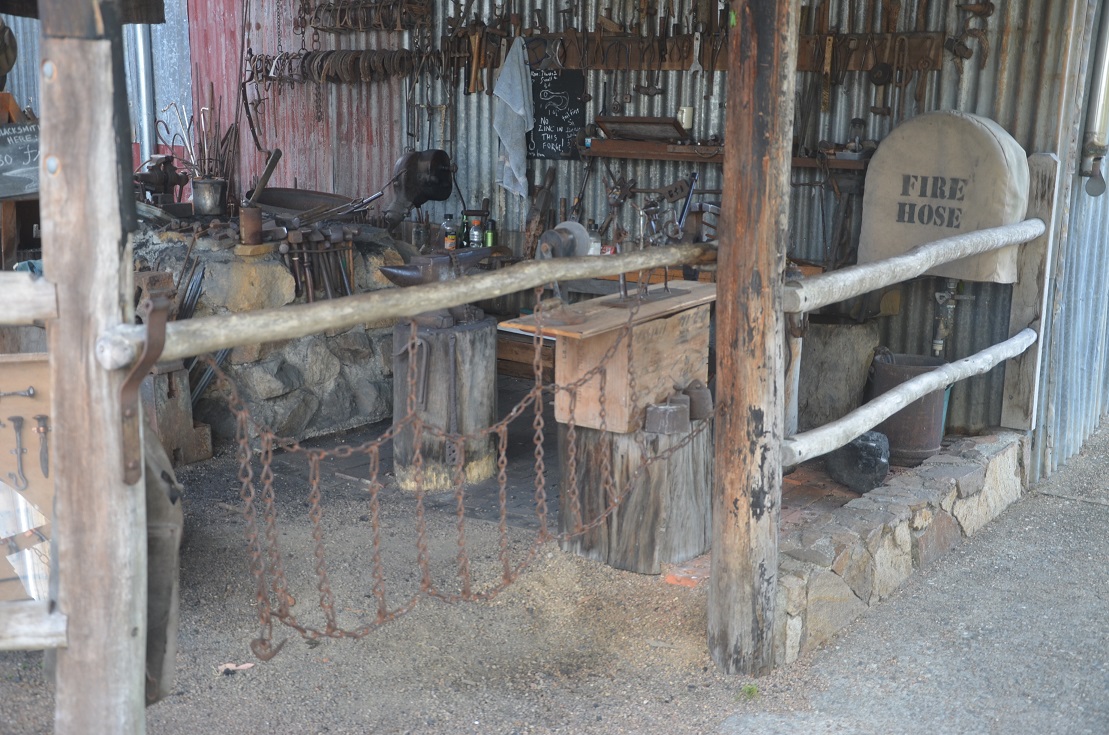

ausfire Posted May 6, 2018 Share Posted May 6, 2018 Just spent two long days in the forge doing demos for our annual Pioneer Days. Made a lot of the usual stuff - bottle openers, bull's heads, crosses, toasting forks, snakes and a troll cross or two. Just over 1100 visitors through the gate this weekend. Sunday night now and feeling a little weary! I parked the Holden beside the forge and put a display of some scrap art on it. Both the car and the sculptures attracted quite a few photos: Quote Link to comment Share on other sites More sharing options...
tkunkel Posted May 6, 2018 Share Posted May 6, 2018 Ausfire, Nice collection of scrap art and also love the vehicles in the back! The Holden looks awesome, also! Quote Link to comment Share on other sites More sharing options...
Hans Richter Posted May 6, 2018 Share Posted May 6, 2018 Aus, you are a blessed person to do/live your passion in this beautiful environment. If you ever think about pension or retirement please give me a sign. I gladly want to take over this great occupation ;-) Know the feeling from my ‘outlaw-time’ on the historically shipyard. When I had asked a dollar (American/Canadian/Australian don’t care) for every foto they take, I was a rich person now. Enjoy every day and stay healthy. Your sincerely, Hans Quote Link to comment Share on other sites More sharing options...
Daswulf Posted May 6, 2018 Share Posted May 6, 2018 Great display Aus. I love when you post pictures with so much to look at in them. Quote Link to comment Share on other sites More sharing options...

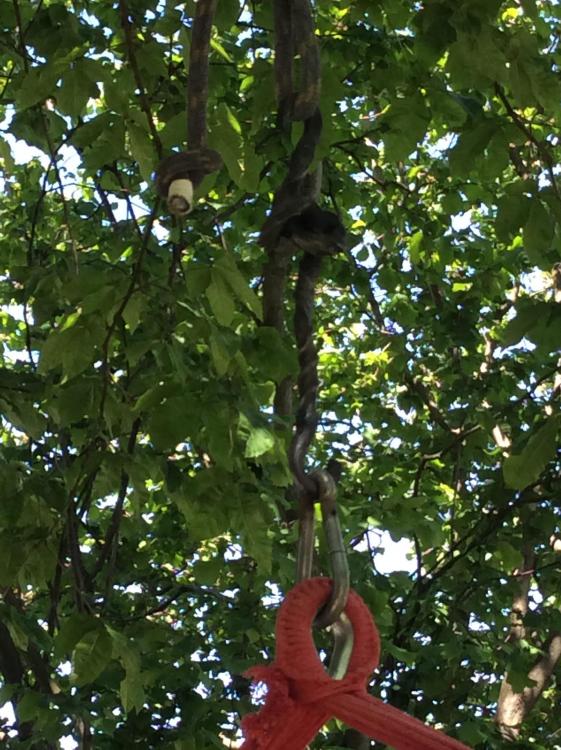

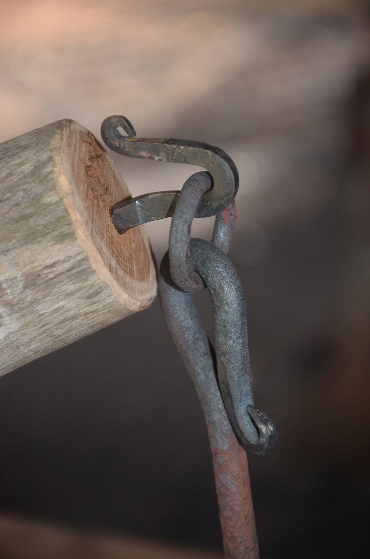

Koek Posted May 6, 2018 Share Posted May 6, 2018 started out with a simple twist with a hook on both sides to hang our hammock chair. seeing as it was a wee bit long however so I decided to tie a knot in it. Quote Link to comment Share on other sites More sharing options...

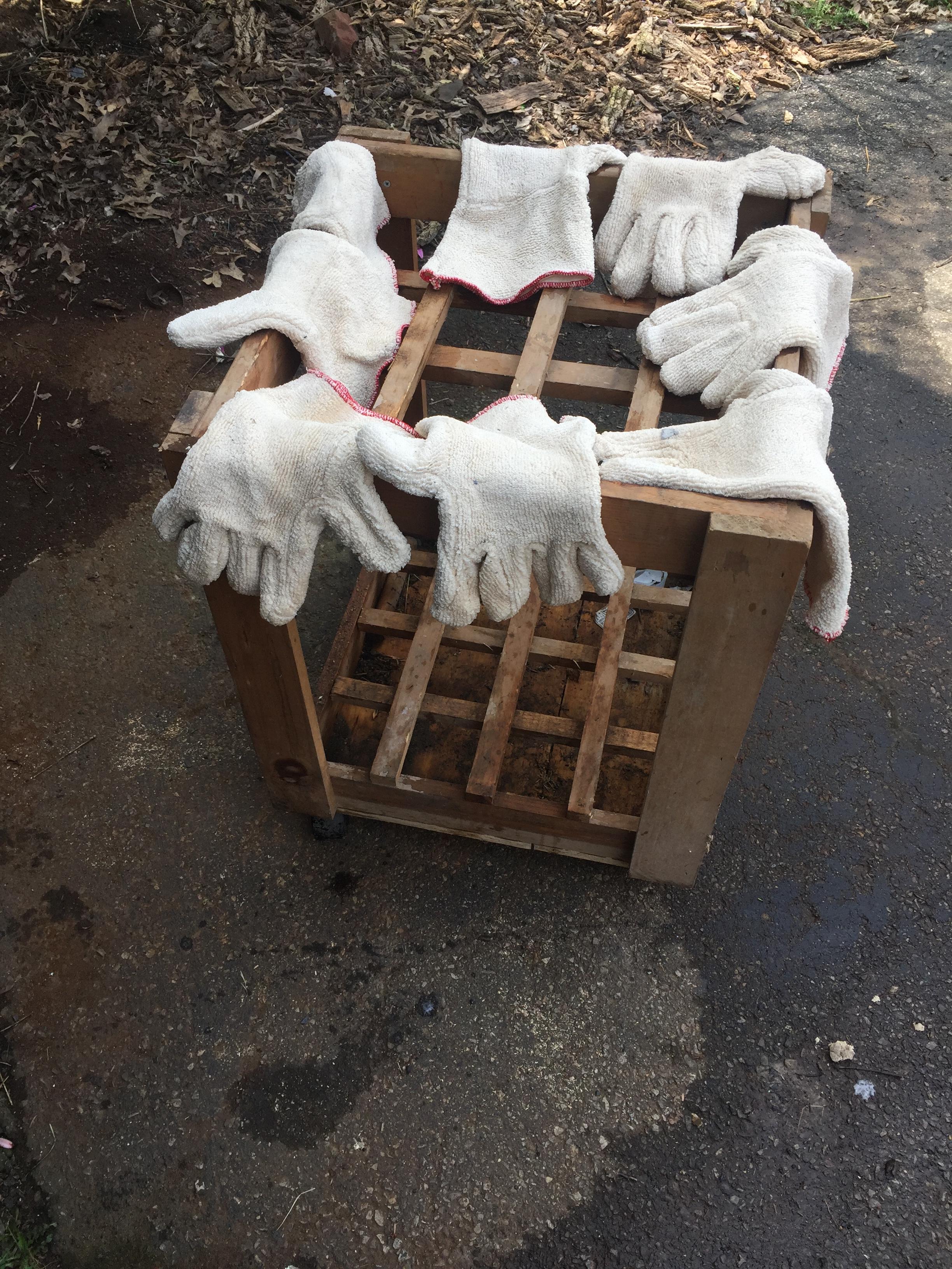

JHCC Posted May 6, 2018 Share Posted May 6, 2018 A while back IFI member Stitch gave me a bundle of big cotton terrycloth gloves that are great for heat resistance, but not so good for flying sparks. Remembering another use for borax and boric acid, I made up a bucket of flame retardant (1 part boric acid, 7 parts borax, 100 parts water), soaked the gloves, and put them out to dry. The first pair were great for use with tongs and tooling under the treadle hammer — until they caught a spark. I’m hoping these will be better. Quote Link to comment Share on other sites More sharing options...

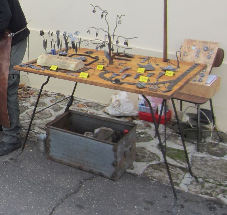

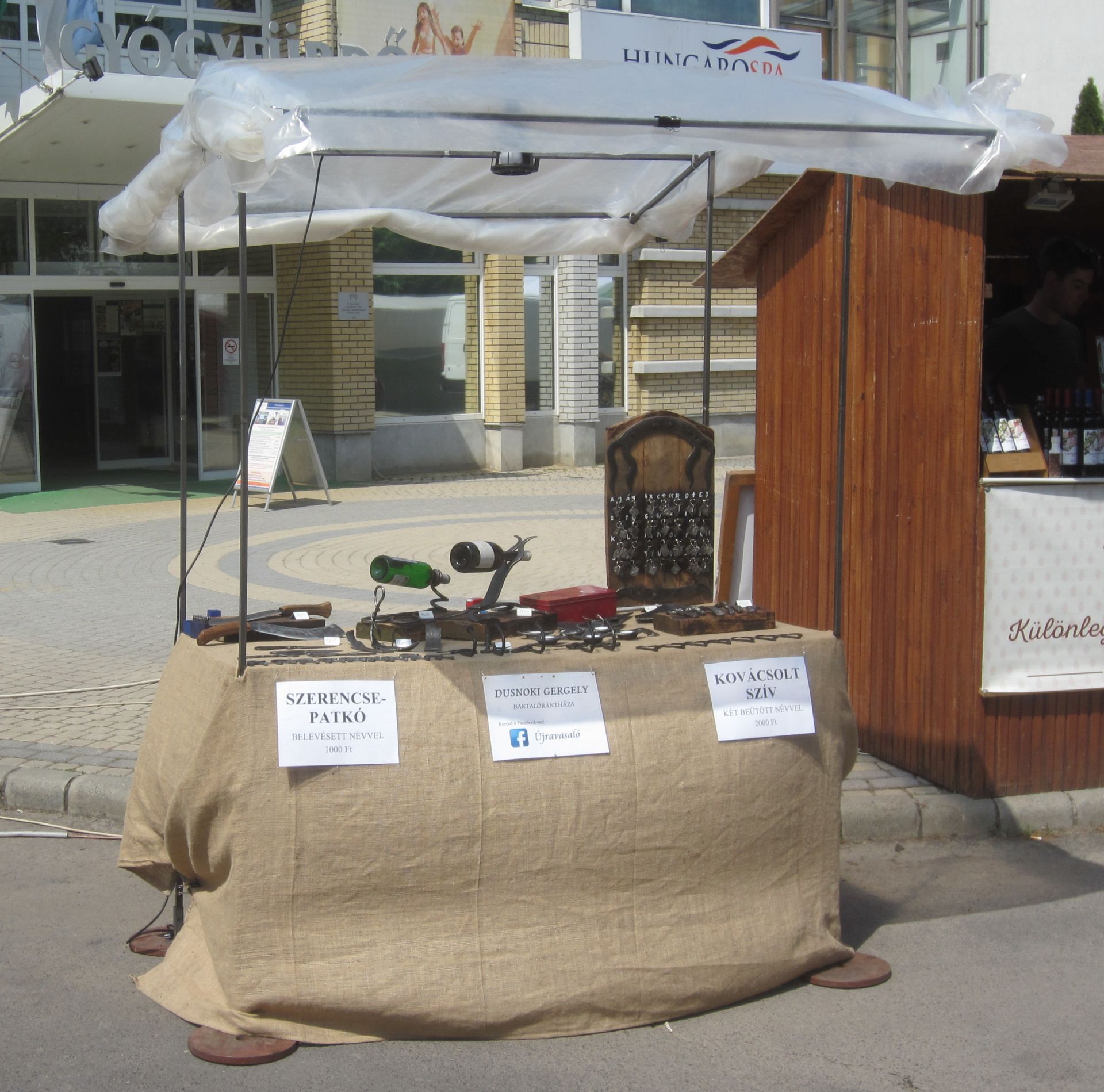

Gergely Posted May 6, 2018 Share Posted May 6, 2018 Aus, amazing stuff in your picture: both your work and the automobiles. I recently upgraded my show table gear. In Dec and then in March my stuff got so much damage by the rainy weather that I had to stop and think. The new version is totally rain safe, storm safe. It can be dismantle into <3' pieces in less than 10 min and weighs under 40 lbs. Except the four bottom paws that are 15 lbs each. The table surface measures 160 cm x 80 cm. It still lacks a good painting, and I want to change the plastic to some waterproof canvas for better looks and good shade. For comparison I attach a picture of the old table. I liked it, but it weighs the same as the new and has half the surface. (And I can't hide my things from the customers under it.) Bests: Gergely Quote Link to comment Share on other sites More sharing options...

Hans Richter Posted May 6, 2018 Share Posted May 6, 2018 Gergely, a nice booth -looks very authentic with the filigree legs of the exposure table and the scrim cover. Well done. Specially like the wine holder and I'm curious if there is some Tokay still in the bottles. Let me know Quote Link to comment Share on other sites More sharing options...

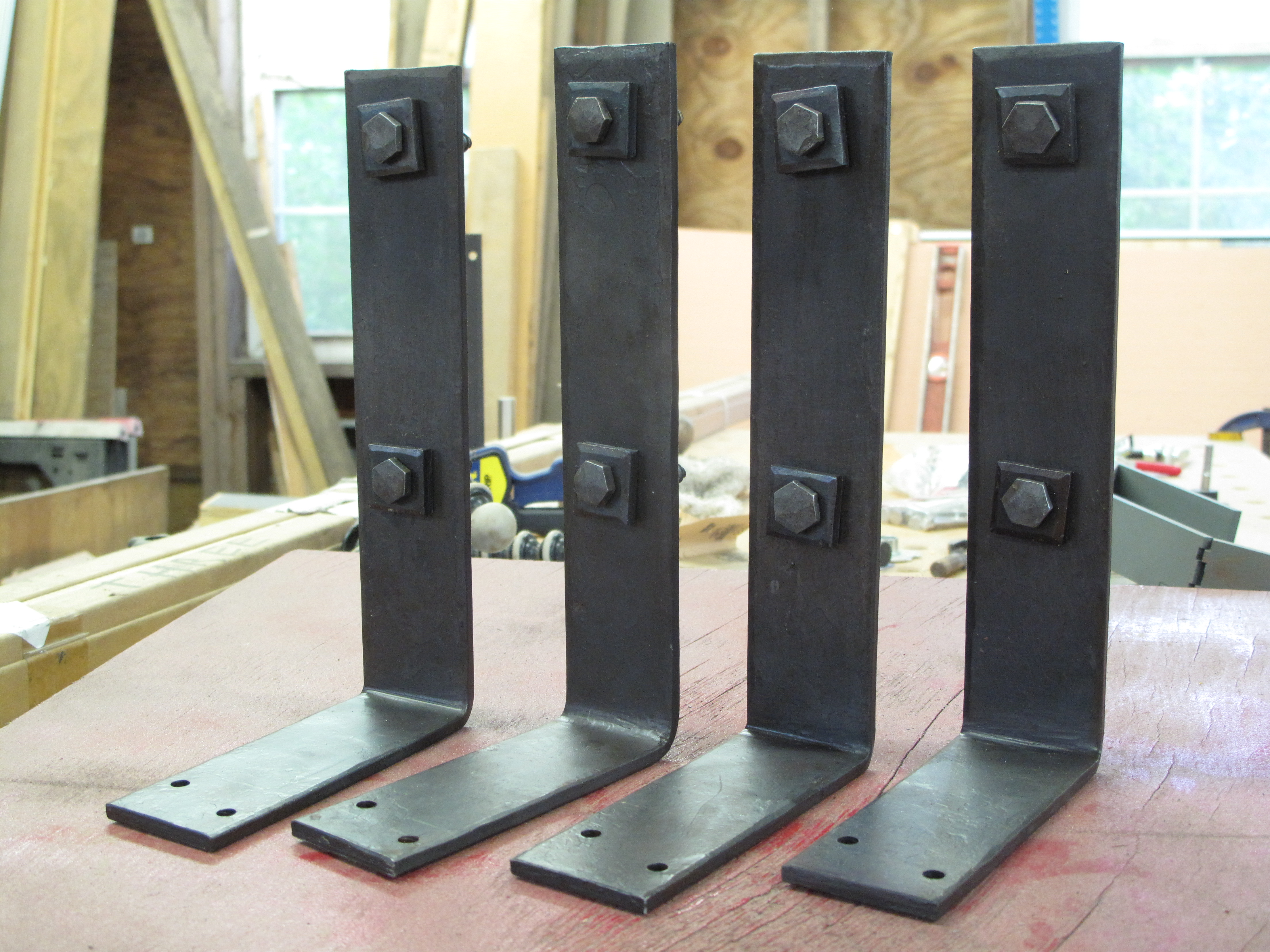

VaughnT Posted May 6, 2018 Share Posted May 6, 2018 Got all four brackets made and delivered to the customer. She met me halfway, which was awesome, but I kinda wish I'd driven all the way and done the install myself just so I could be sure everything went together like I envision. Now I have to come up with a way of bending these brackets more efficiently. Right now, I just clamp them in the vise and knock the leg over. The downside is adjusting for different lengths of legs because I have to put a block under the vertical leg in the vise. I'm thinking about buying a section of rack that will allow for 1/4" adjustments while still supporting the lower leg. Not sure about that, though..... Quote Link to comment Share on other sites More sharing options...
ThomasPowers Posted May 7, 2018 Share Posted May 7, 2018 How about a fixture for the vise that has a stop for the bottom of the leg and a right angle bend to engage the vise top sort of like an L with the top bent over to the left.... Noticed that a new "wine tasting and craft beer" place has opened in our little town---now we have *2* businesses! I must make a couple of bottle openers and corkscrews as a "welcome gift".... and leave them a stack of my cards... Quote Link to comment Share on other sites More sharing options...

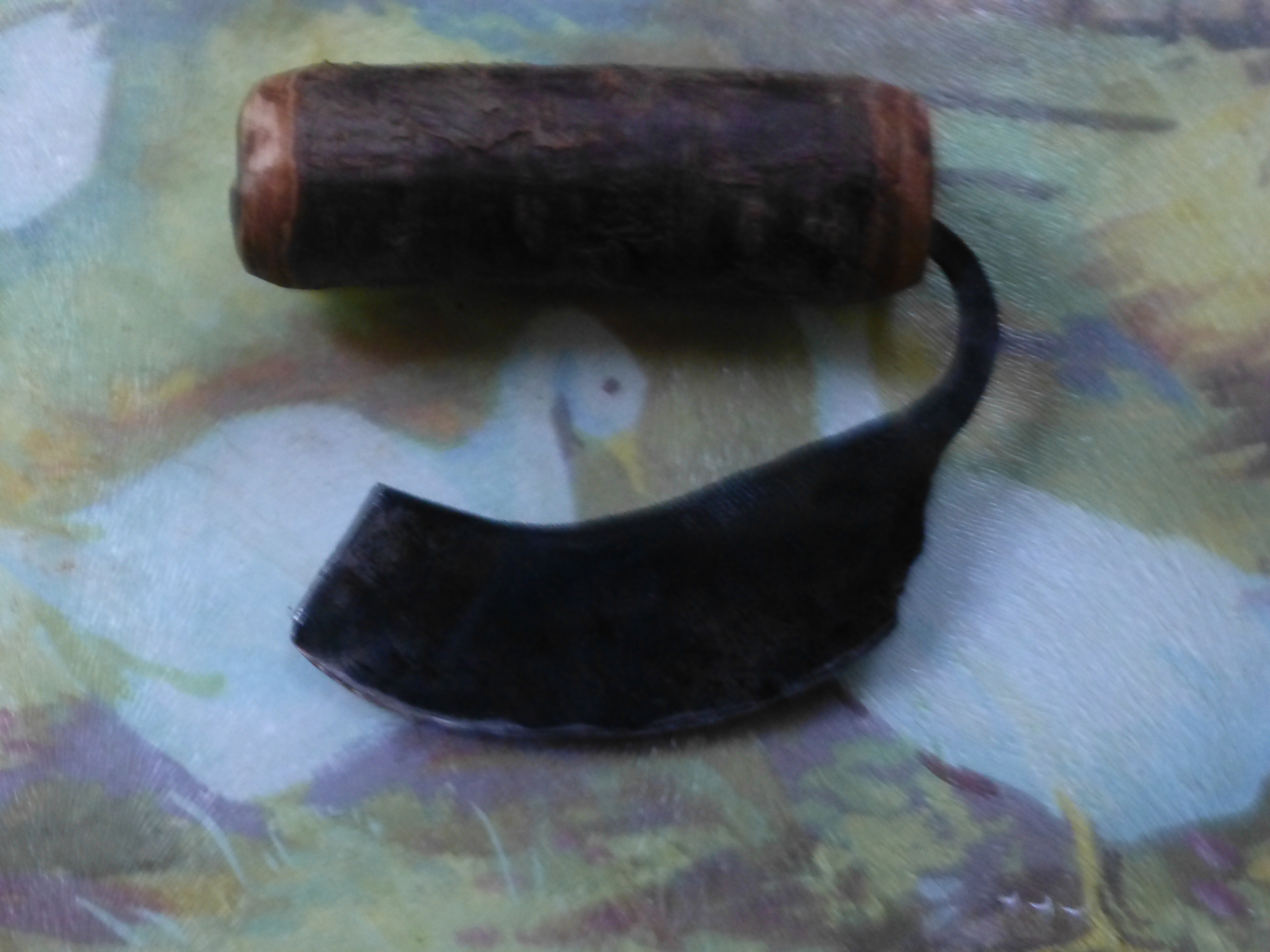

Heelerau Posted May 7, 2018 Share Posted May 7, 2018 I finished this little herb knife for the War Office a few days ago. I forged it out of an old file and used a piece of fruit wood as a handle. The War Office kindly turned my great whetstone to allow me to make an initial working edge, which I then finished off on an oilstone. I have left the blade fairly hard. It is pretty roughly finished, but a functional tool. She is ver pleased with it which is the main thing. Quote Link to comment Share on other sites More sharing options...
