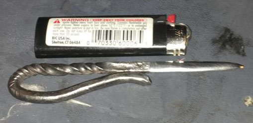

snake hands jimmy Posted April 23, 2018 Share Posted April 23, 2018 Just finished this little letter opener. 1/4 mild. This is my first blacksmithing project Quote Link to comment Share on other sites More sharing options...

Daswulf Posted April 23, 2018 Share Posted April 23, 2018 Nice first item Jimmy. Practice your tapering so you can put a nice scroll finial on the handle end. Hans, any way to smuggle some of those brats through the mail to me? Quote Link to comment Share on other sites More sharing options...

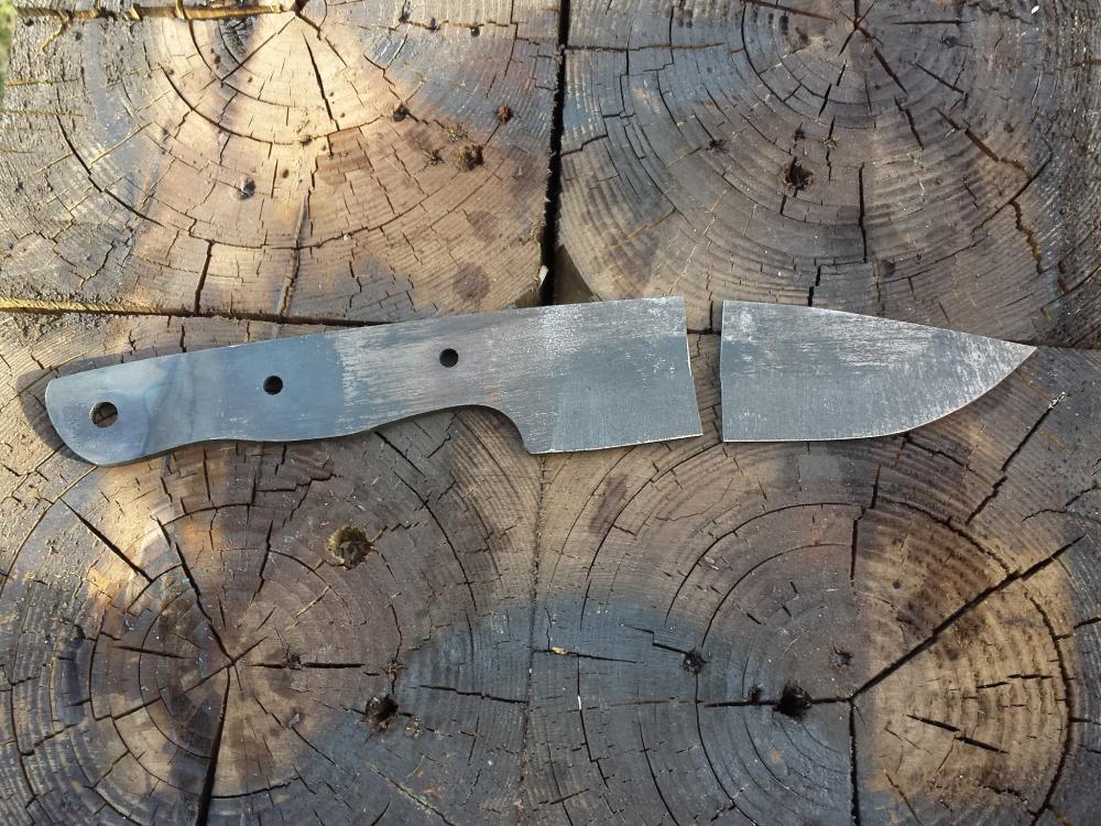

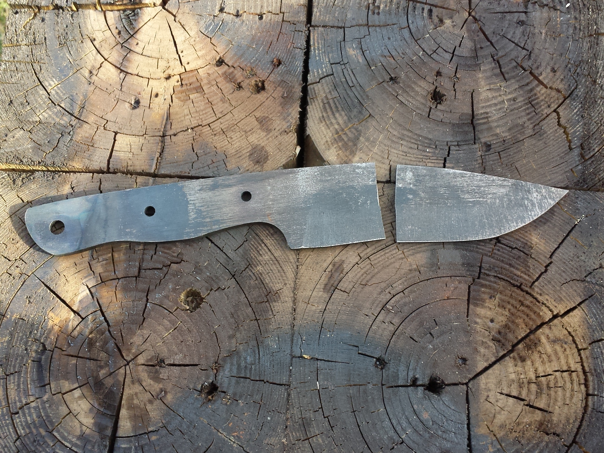

sfeile Posted April 23, 2018 Share Posted April 23, 2018 I learned a valuable lesson in the shop today............. Don't let a knife cool too much and then try too hard to straighten it right after quenching...... Quote Link to comment Share on other sites More sharing options...
Daswulf Posted April 23, 2018 Share Posted April 23, 2018 Awe man... Looks like it was going to be a nice one. Sorry. I've been there, learned that, and could even possibly do it again. Quote Link to comment Share on other sites More sharing options...

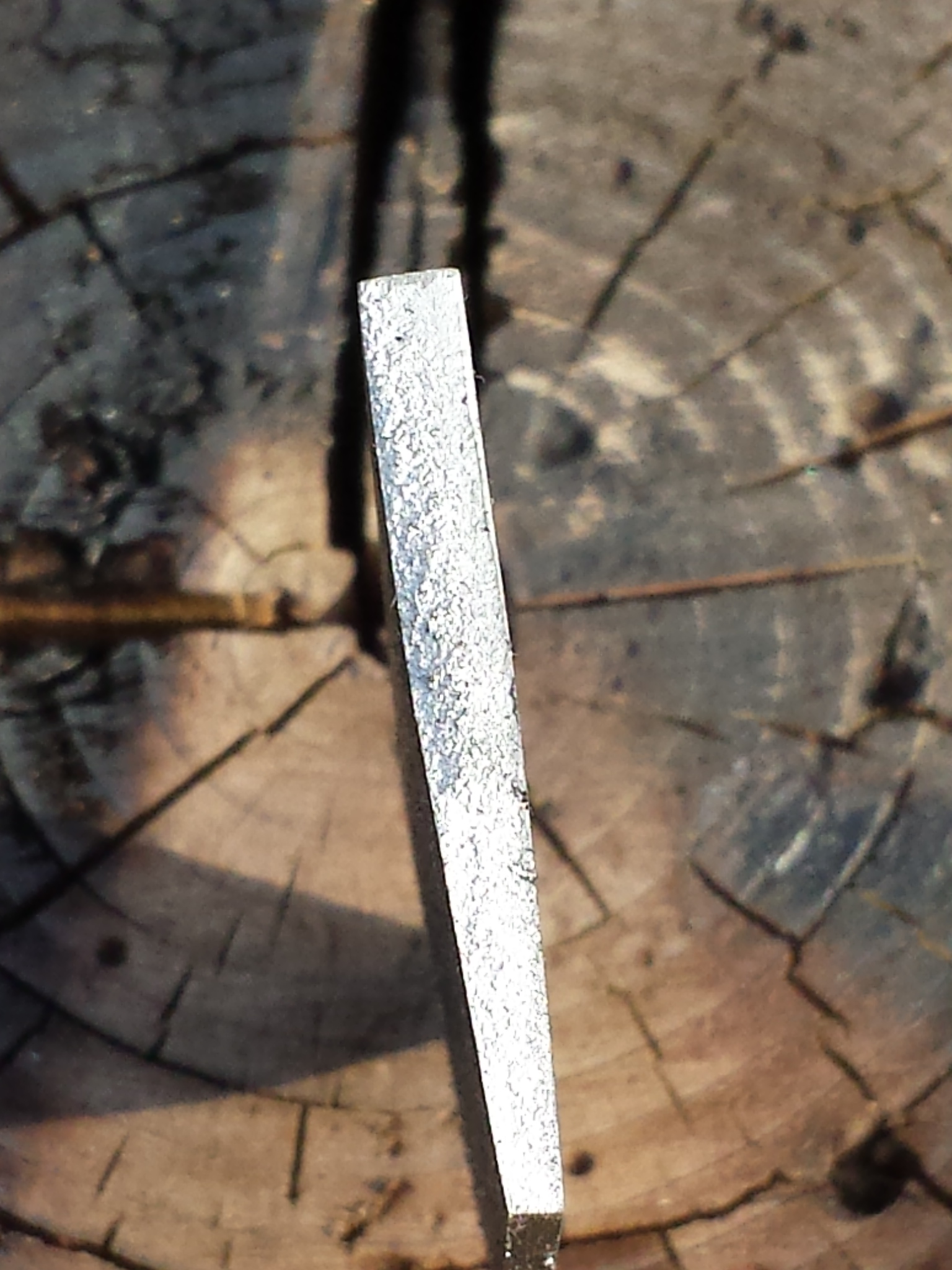

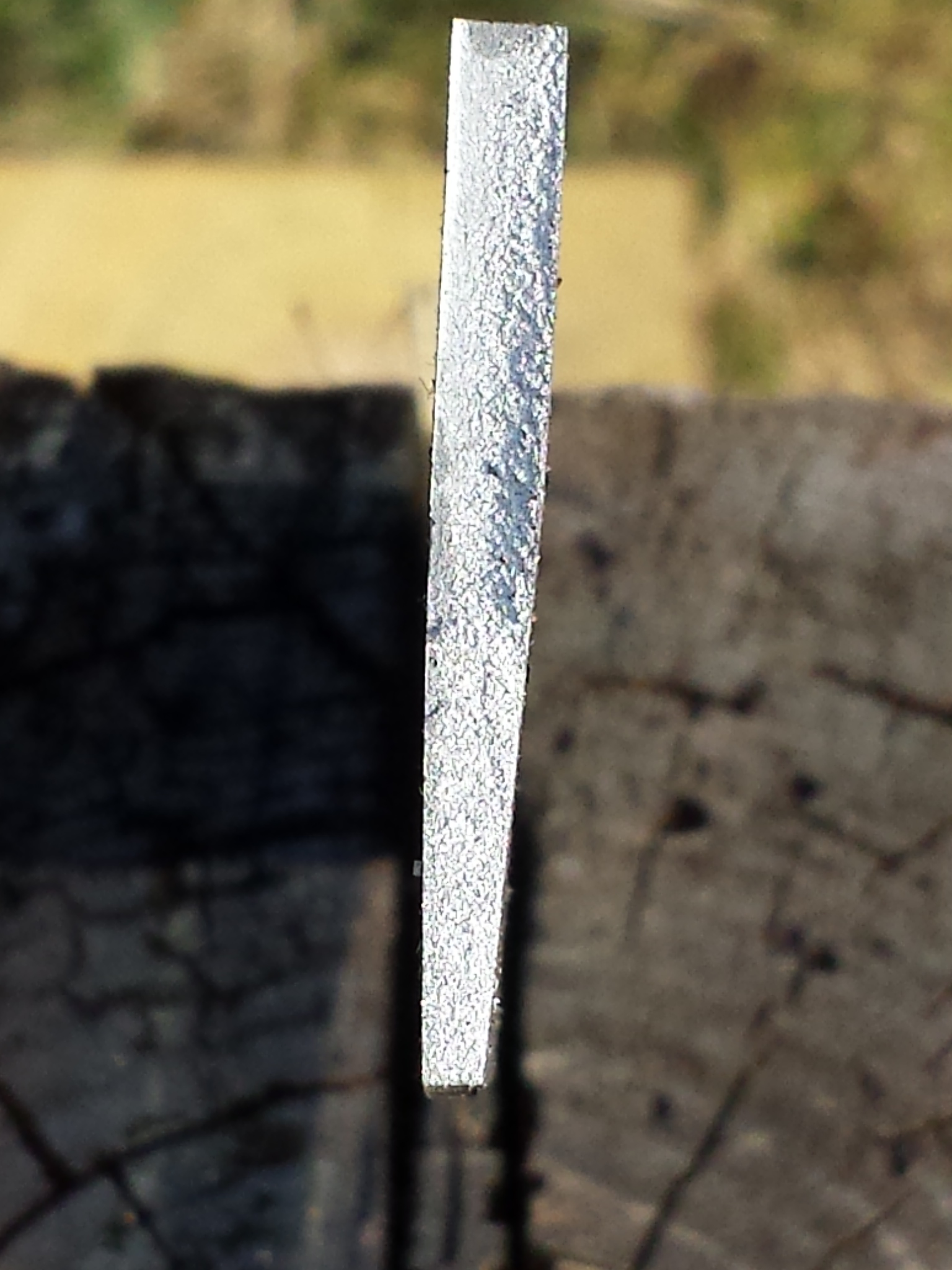

jlpservicesinc Posted April 23, 2018 Share Posted April 23, 2018 The grain looks pretty big like it was heated to long or quenched at to high a temperature or to hot in your final forging sequences. Better off it broke.. im saying this from over 30 + years of experience as it would have happened sooner or later if used hard.. The grain when hardened should look smooth like a pearl.. Quote Link to comment Share on other sites More sharing options...
sfeile Posted April 23, 2018 Share Posted April 23, 2018 On 4/23/2018 at 6:16 PM, Daswulf said: Awe man... Looks like it was going to be a nice one. Sorry. I've been there, learned that, and could even possibly do it again. I've had a couple small warps before and managed to straighten them. But, I saw them right out of the oil and was able to just lean on them a little and we were good. This one I didn't notice anything out of the oil, but I think I set it down before it cooled enough and it just took off. Then like an idiot I tried to straighten it cold.... On 4/23/2018 at 6:19 PM, jlpservicesinc said: The grain looks pretty big like it was heated to long or quenched at to high a temperature or to hot in your final forging sequences. Better off it broke.. im saying this from over 30 + years of experience as it would have happened sooner or later if used hard.. The grain when hardened should look smooth like a pearl.. Probably quenched to hot in all honesty. Thanks for that. Pretty much why I posted the grain pictures to learn if I was doing something wrong. Quote Link to comment Share on other sites More sharing options...
Frosty Posted April 24, 2018 Share Posted April 24, 2018 On 4/23/2018 at 2:06 PM, snake hands jimmy said: Just finished this little letter opener. 1/4 mild. This is my first blacksmithing project Not bad Jimmy, how's it work? Practice up on tapers like Das suggests a nice finial scroll really dresses things up. Proportions are important too. Next time try a little heavier stock, I like starting folks out with 3/8" sq or 1/2" rnd. They are almost exactly the same volume per inch. It'll stay hot longer and give you more time to work it without being very heavy work. All in all pretty good first go. Keep it up, you'll be giving lessons before you know it. Frosty The Lucky. Quote Link to comment Share on other sites More sharing options...

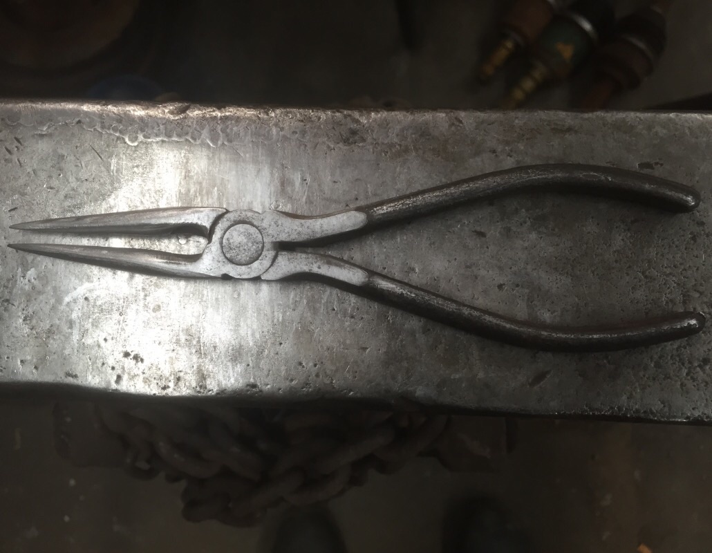

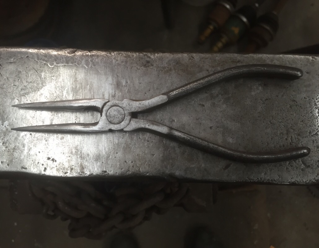

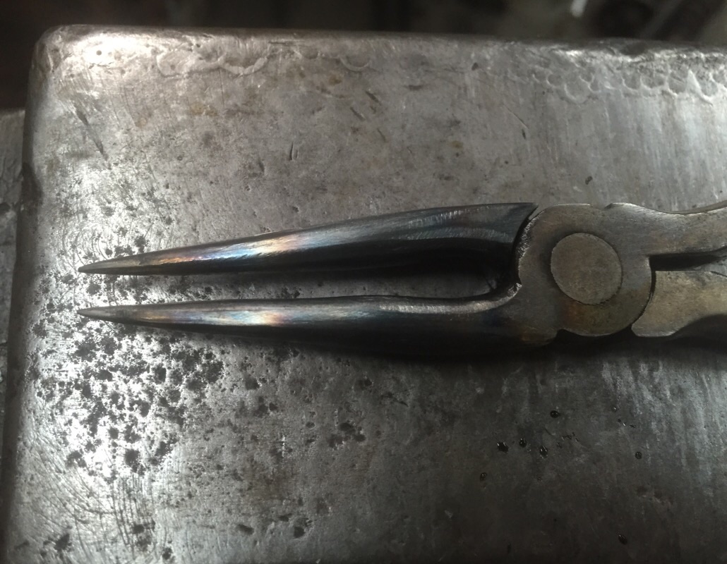

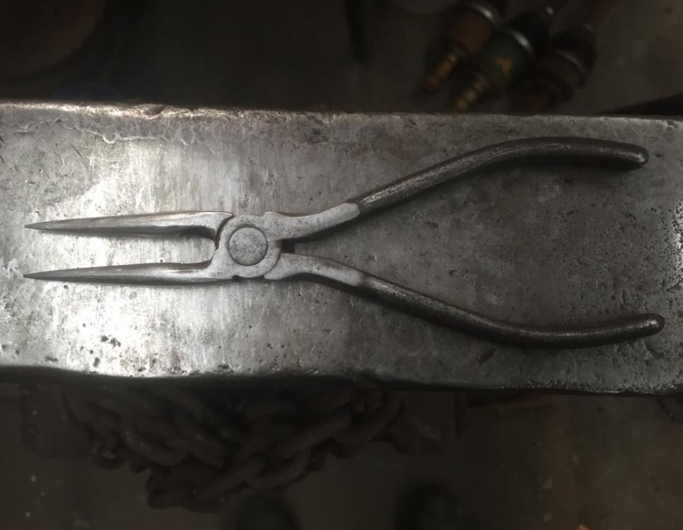

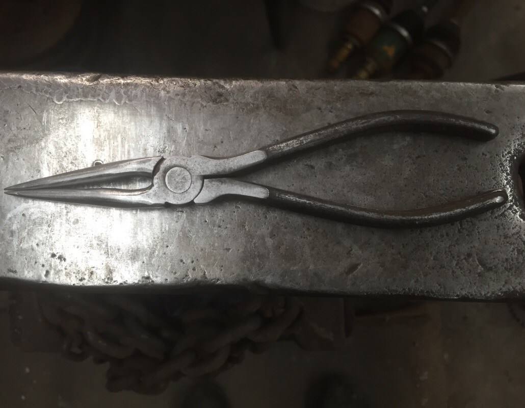

Daswulf Posted April 24, 2018 Share Posted April 24, 2018 After a frustrating time with a small pendant at my first time forging again in over a week I decided to revamp my scrolling pliers made from old needle nose pliers. They worked, now they will work better getting into tighter spots and being more rounded. Quote Link to comment Share on other sites More sharing options...
ausfire Posted April 24, 2018 Share Posted April 24, 2018 Nice job on the needle nose pliers, Das. I need to do that with some of mine. Adding that tight little end on the scrolls is tricky and I always seem to cross up the ends of the pliers. Maybe they are el cheapo ones and a lot smaller than the pair you have modified. I'll try what you have done - the tempering looks like you have the tips pretty hard. Not too brittle? Quote Link to comment Share on other sites More sharing options...

HammerMonkey Posted April 24, 2018 Share Posted April 24, 2018 10 hours ago, Daswulf said: ...I decided to revamp my scrolling pliers made from old needle nose pliers. Das, did you forge the tips on the needle nose pliers or just grind them to shape? I have an old set of pliers that I want to modify like this... Quote Link to comment Share on other sites More sharing options...

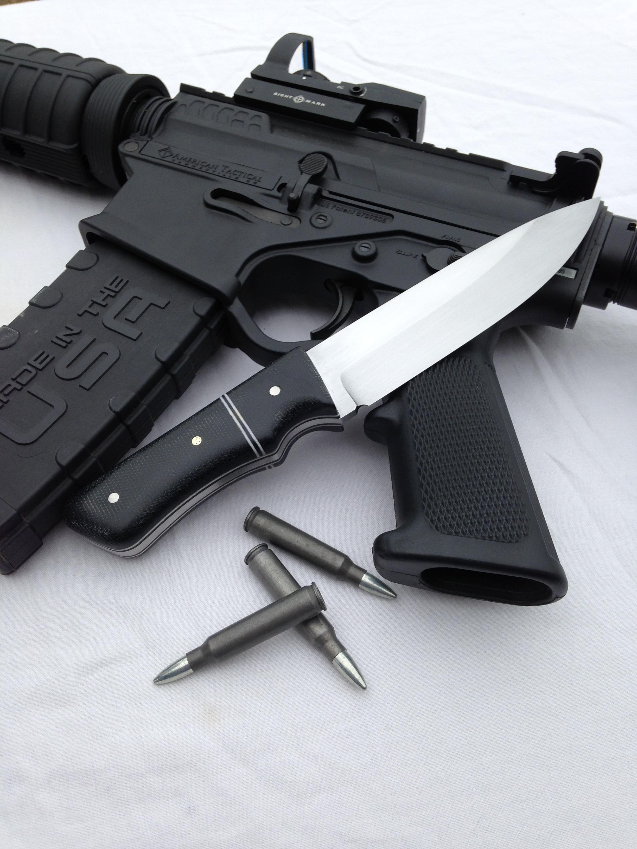

Tubalcain2 Posted April 24, 2018 Share Posted April 24, 2018 Finished up on my new EDC. I am pretty content with it. 1080 and micarta. Quote Link to comment Share on other sites More sharing options...
Daswulf Posted April 24, 2018 Share Posted April 24, 2018 5 hours ago, ausfire said: Not too brittle? Time will tell. A lot of times tips of needle nose will bend on me so I'm trying a little harder. I heated them to a medium red then quenched then was still a little worried they might break so I drew it back a bit. I did risk putting a thinner piece of metal just back from the tip and squeezed and they didn't break. Might have been pointless but I figured I'd give it a shot since I can find cheap needle nose pliers at the fleamarket for .25-.50 cents all the time. These are smaller needle nose. 1 hour ago, HammerMonkey said: did you forge the tips on the needle nose pliers or just grind them to shape? Just ground them down to shape. I have a pneumatic angle grinder that takes 3" roloc discs that I use a lot and makes easy work of the small stuff. You could use a 4 1/2" grinder with flap wheels too, just be careful. TC2, that's a Very nice knife. Well done! Quote Link to comment Share on other sites More sharing options...
