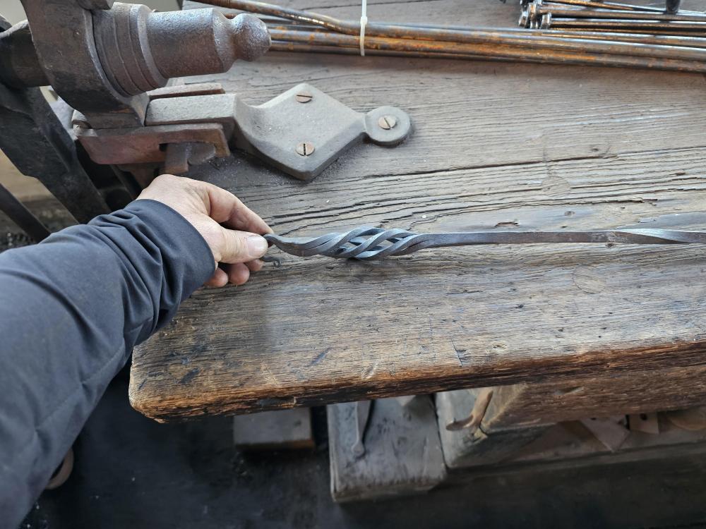

Arthur210 Posted February 24 Share Posted February 24 On 2/20/2024 at 9:31 PM, Goods said: Arthur, I like those broaches. I’m going to have to make some at some point and you’re setting a good bar. Thanks. Fibulas of this type are fairly easy to make, and good practice for a variety of twists and textures. On 2/20/2024 at 9:50 PM, Daswulf said: Arthur, ive made a whole one pennanular in my time. It was a real experience dealing with the inexperienced buyer on how to use it that Ive passed on making more. Tho, is it good to have the pins bent to lock on the ring better? It can be, but it's not always practical. In this case, since they are not perfectly circular (because of the omega shape), a tighter bend would limit the wearer to a single angle for the pin. On 2/20/2024 at 10:50 PM, George N. M. said: You probably know this but I'll throw in a bit of my spiel for anyone who doesn't know why they are called "penannulars." "A circle is an annulus. A ring or or doughnut is an annulus. "Pen-" means "almost". A peninsula is almost an island and penultimate is almost last. So, a penannular is almost a circle." Indeed. There are basically 3 types of fibulas: penannular, bow and plate. Of the penannular type, the Omega style is the most common. Bow fibula are shaped a bit like an oversized safety pin. Plate fibula are basically made like modern brooches, with a spring needle under a decorative plate shaped like an animal or an abstract design/shape, and often embelished with precious metals or stones. Fibulas date back to the bronze age. Even during the iron ages, they were often made (partially or completely) from bronze. Quote Link to comment Share on other sites More sharing options...

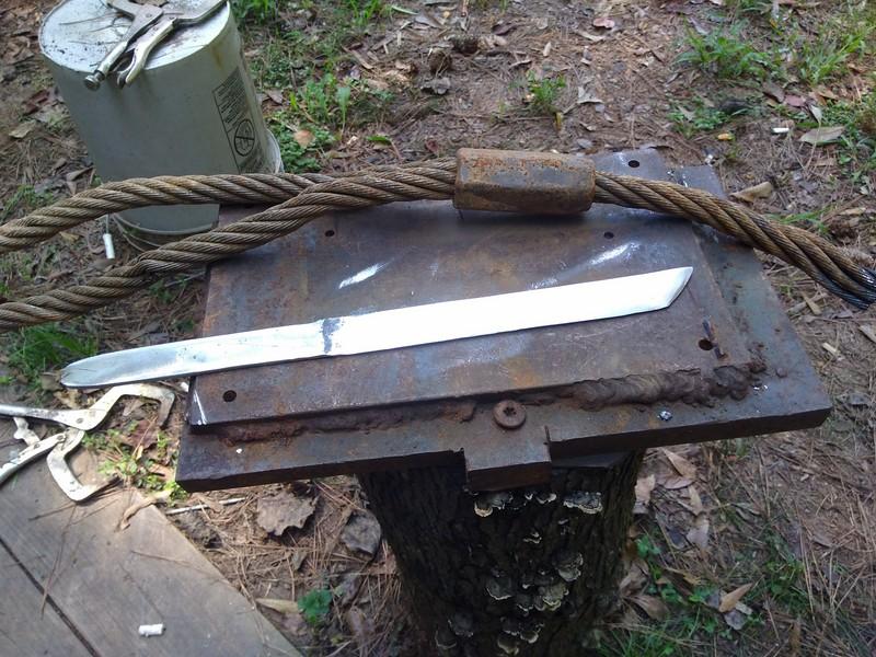

bluerooster Posted February 25 Share Posted February 25 Time to harden the blade. Built a quick JABOD with a trench long enough to evenly heat the blade in one go without having to move it around in the fire too much. Got it hot, and into the quench. It didn't curve as much as anticipated, and came out with a slight bow. I had the vise already set up with some angle iron (just in case). So I clamped it to finish cooling. I then set about cleaning the residual clay to check for cracks, and the end fell off. Well poo! Time to start all over again. Oh, I also found that the cable blade failure, actually works great for cutting charcoal to size. so the day is not a total loss. Quote Link to comment Share on other sites More sharing options...
jlpservicesinc Posted February 25 Share Posted February 25 Sorry to hear it's kaput.. Way back in the day when I was forging these blades for use 1 out of 10 would shatter in hardening. I felt very good about the average.. Ninja-to were between 18 and 24" blade length. with a longer handle and sq tsuba.. I've never broken one in use.. Quote Link to comment Share on other sites More sharing options...
bluerooster Posted February 25 Share Posted February 25 1 in 10 is not bad. So far I'm going 2 for 2. But I'll get on another in the very near future. I'll be using what I learned from the past two, and mabe the next one will come out better. Quote Link to comment Share on other sites More sharing options...

jlpservicesinc Posted February 26 Share Posted February 26 1 hour ago, bluerooster said: 1 in 10 is not bad. So far I'm going 2 for 2. But I'll get on another in the very near future. I'll be using what I learned from the past two, and mabe the next one will come out better. At one point I was forging 2 a day.. So that really made a difference dialing them in.. Always Sunobe. by the way I just looked up the meaning of sunobe to make sure we are on the same page.. A sunobe as I'm referencing is the sword billet before its edge geometry is forged in. This unit in its pure form has all the finished measurements and thicknesses built-in.. To finish all that is needed is to forge the ends spine, sides and edge are forged.. But the sunobe dictates thickness, overall shape from the very beginning. I found that going this way gives very consistent results especially once, one sees how this raw sword blank transforms seamlessly into the final shape. Nothing worse than having a bleb that needs to be fixed because of an error and then having to forge this out raw. If I'm preaching to the choir just let me know and I'll stop.. Quote Link to comment Share on other sites More sharing options...
