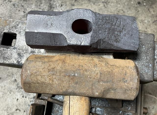

Goods Posted January 29 Share Posted January 29 JHCC, I’m not sure I could bring myself to get that organized. Here’s my work for the day: I started with 6.5” of 2.5” diameter 4140. Target was 8lbs, and pictured with an 8lb for scale. Not sure I’ll be at 8lbs when it’s all said and done.I knew this was going to take a lot of work, but even with the power hammer, I’m exhausted. Not looking forward to the final drift, but have to make an appropriate drift first… Keep it fun, David Quote Link to comment Share on other sites More sharing options...
Frosty Posted January 29 Share Posted January 29 Rough your drift out a git oversized and drive it HOT into a hammer head to swage it to dimension. A bit of grinding to clean it up and you're ready to drift off. The hammer head looks pretty darned good Dave, I'll bet it'll be the best double jack you have when finished. Frosty The Lucky. Quote Link to comment Share on other sites More sharing options...

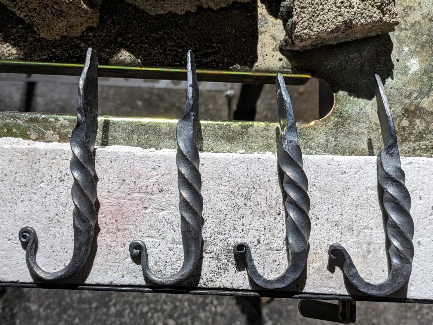

Shainarue Posted January 31 Share Posted January 31 Been there many times, gewoon. I admire the more experienced smiths here that walk away and rethink things. I'm with you, crying in the corner (or more likely, throwing a quiet temper tantrum), lol I might think on it as I'm tossing and turning later, but not intentionally. I actually made the same math mistake doing my hooks last night. Forgot to add in diameter of stock for the calculation of how much material I'd need for the hook. So the hooks are 3/4" instead of 1". No biggie. Quote Link to comment Share on other sites More sharing options...
jlpservicesinc Posted February 1 Share Posted February 1 gewoon IK, Hows about some photos.. I know your have been working on some projects.. Be great to see them and how your doing.. Shaina nice twists. Your pig tail scrolls are getting better too.. Quote Link to comment Share on other sites More sharing options...

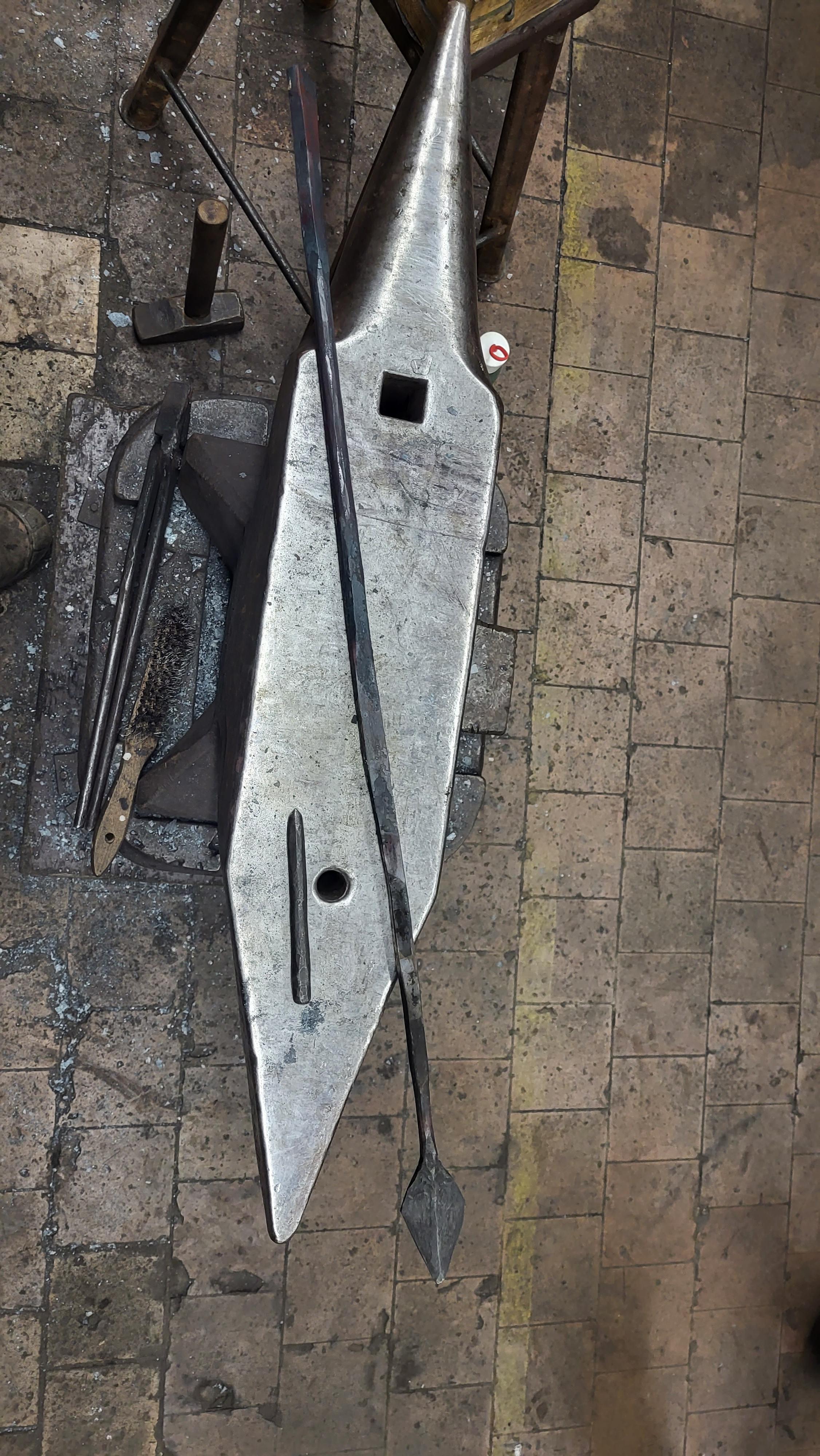

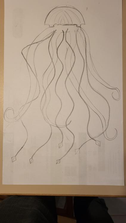

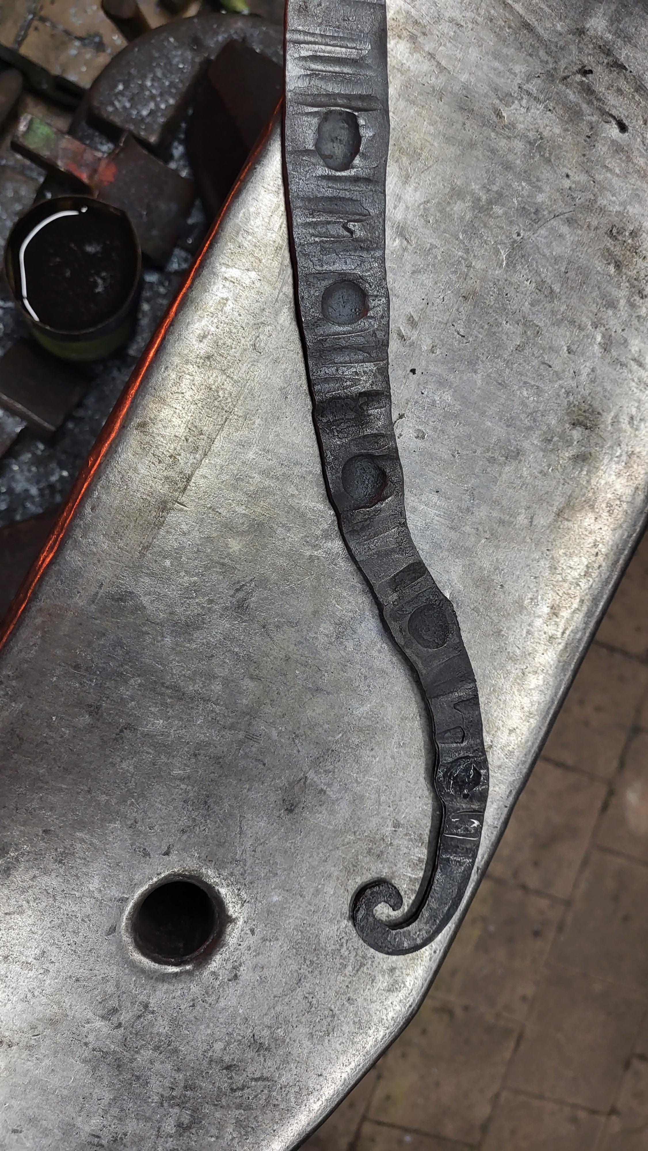

gewoon ik Posted February 1 Share Posted February 1 You do indeed. But it is not on that project I failed. The hinge that fight with me on thursday is scrap. Have another idea that will go quicker, less nice but it needs to get done. The big project you know, i can mention short. I don't have good picture of the parts so far, only my rough sketch and some samplepieces (althou the long round tentacles the idea is gopd, i start making them) Project for school, need to make a hinge. Need to have some complex techniques in it some ornamental stuff, some forgewelding, ... So i designed my own. Don't like the "traditional" forgings, not my style. So I ended up with a jellyfish (blame the kids, they wanted me to draw some and the idea came from there). The small tentacles are going to be round of 12mm above the ornamental piece at the bottom. And will taper to 18mm to the body. Lenght of 500mm. They will have dimples in it, quite large to give it structure. The ornamental piece will be bigger than in the drawing. Around 50mm in width. Will have 3 crisp points and a centerridge. in this picture i need to round it up more and starting structuring it. the flat tentacles will be tapered from 30 to max 40 to a point over a length of 350 to 400mm. They small end will be scrolled up to give it a tentacle look. It all will be structured with 2 fullers and the same rounding tool (to "hide" the mounting holes). These go quick with a guillotine-tool and heavy hamer. I have only an example of it the flat tentacles will be forgewelded to the hinge body. That will be made out of 4mm plate, with the start of the flat tentacles. The round tentacles will be installed with a tenon but the tenon will be 90° to the back. The upper part, those lines on the drawing, will become ridges. So an big project. I can use a power hamer to make all the parts so the drawing of the tapers should go quick. The first long tentacle was my first power hamer use and i did less than 3 hours making it, including a mould for the taper and the ornamental piece (no powerhamer) and the explanation and testing of the power hamer (on another piece) I don't think it will be used as a hinge (to pass the test, it needs to be functional), i need to make 2 and a very big door. Will probably live its live as an ornamental piece on a nice piece of wood. Quote Link to comment Share on other sites More sharing options...
jlpservicesinc Posted February 1 Share Posted February 1 Coming along nicely. Last we spoke it was still conceptual so it's great seeing it come to life. Photos of the failed hinge you originally mentioned would be great too. I'm a visual creature. I think most Blacksmiths are so seeing things is soo much better than reading a description. Quote Link to comment Share on other sites More sharing options...
