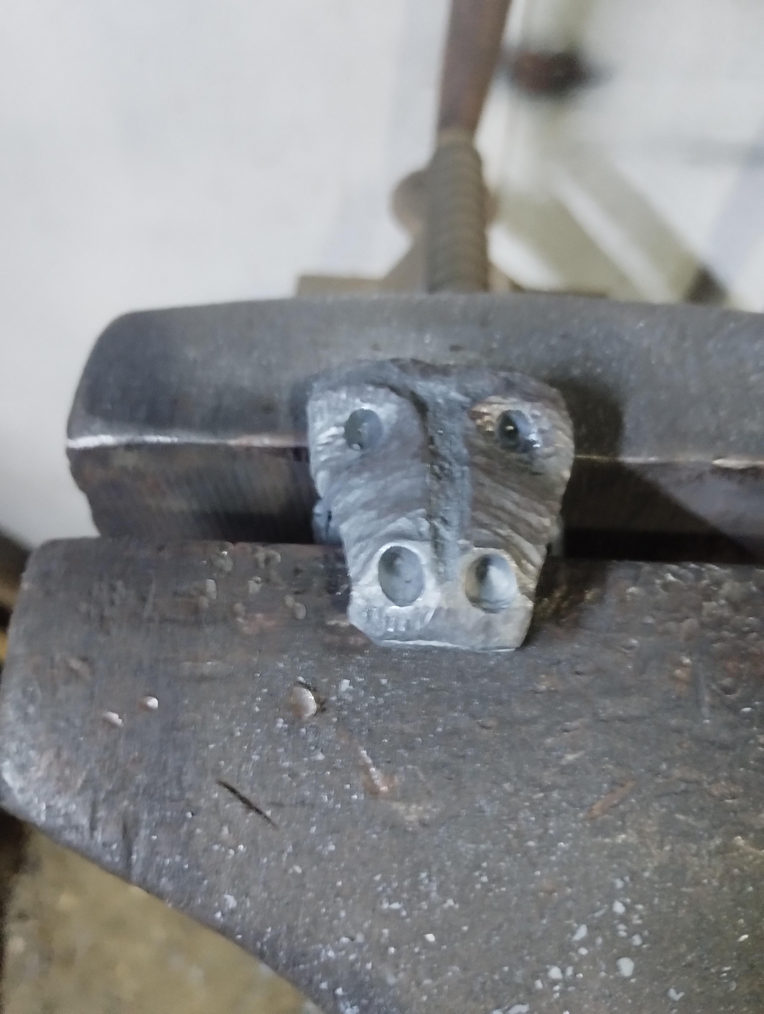

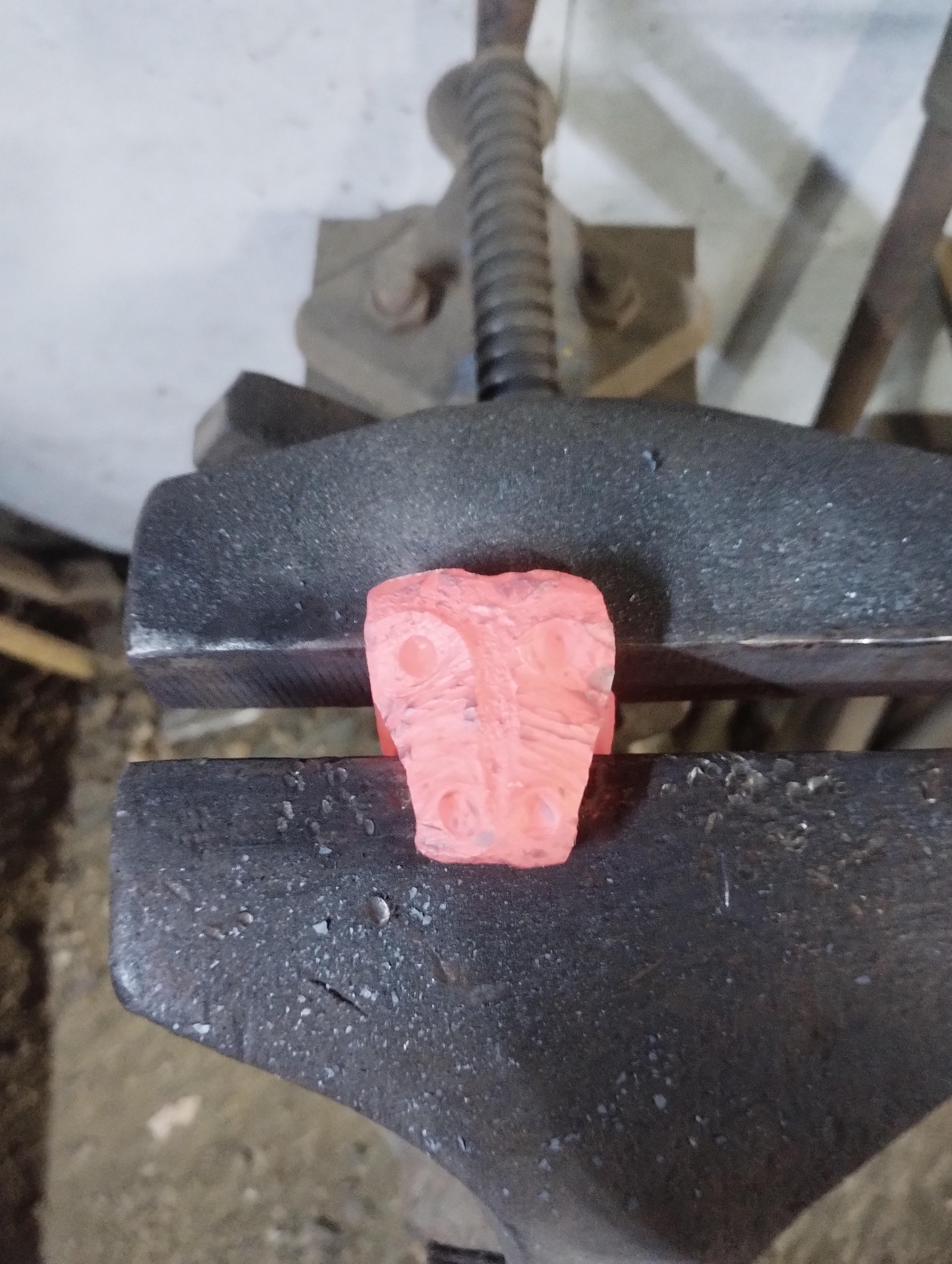

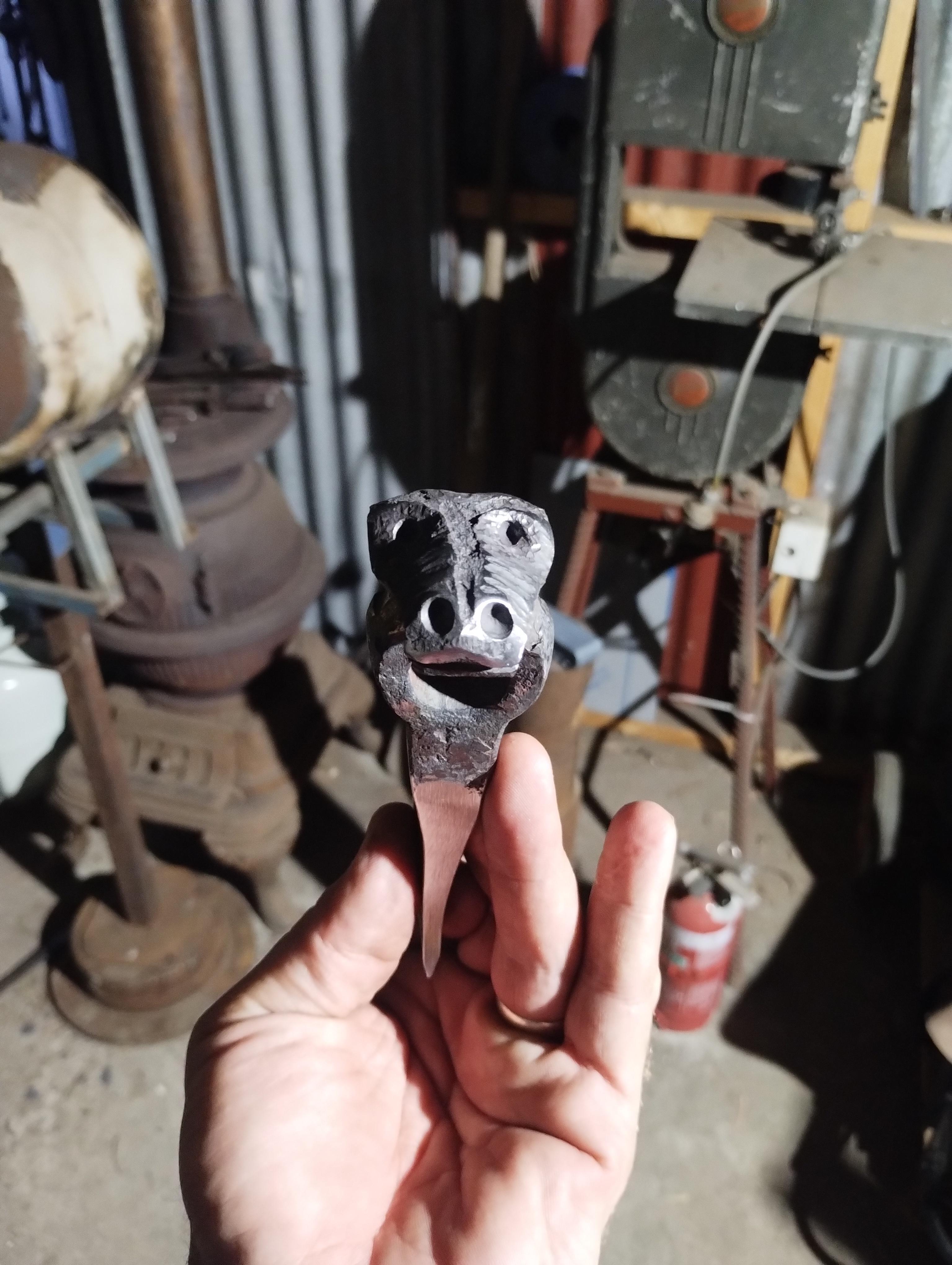

I spent an afternoon making a hatchet with a dragons head from a railway spike. This was my 2nd go at Blacksmithing so happy with the results.
I feel very privileged that an experienced blacksmith gave his time to teach a complete beginner a few skills & invited me into his Smith.
Here are a few pics
I enjoyed it so much especially knowing how much room there is for improvement, there will never be another one made just like it! Once I make up a handle it will be a gift for a friend to put on the mantle piece.
Whaaaaat?  Quit your day job because you are a natural at this. Keep at it, we will follow your development with great interest.
Thank you for the encouraging words Davor.
I am currently traveling around Australia in a caravan so don't have a day job to quit :)
It also means I cannot set up a shop. When we go back to a normal life at the end of the year I am looking forward to setting up a shed so I can tinker and develop my skills. I really do love Blacksmithing but will keep it as a hobby. Unfortunately my body wouldn't hold up to doing it full time. A car accident 23 years ago took its toll on me.
As I travel around the country I hope to find a few more people that will let me into their Smiths so I can keep learning. Having Phil teach me how to do the dragon Hatchet has really boosted my confidence.
