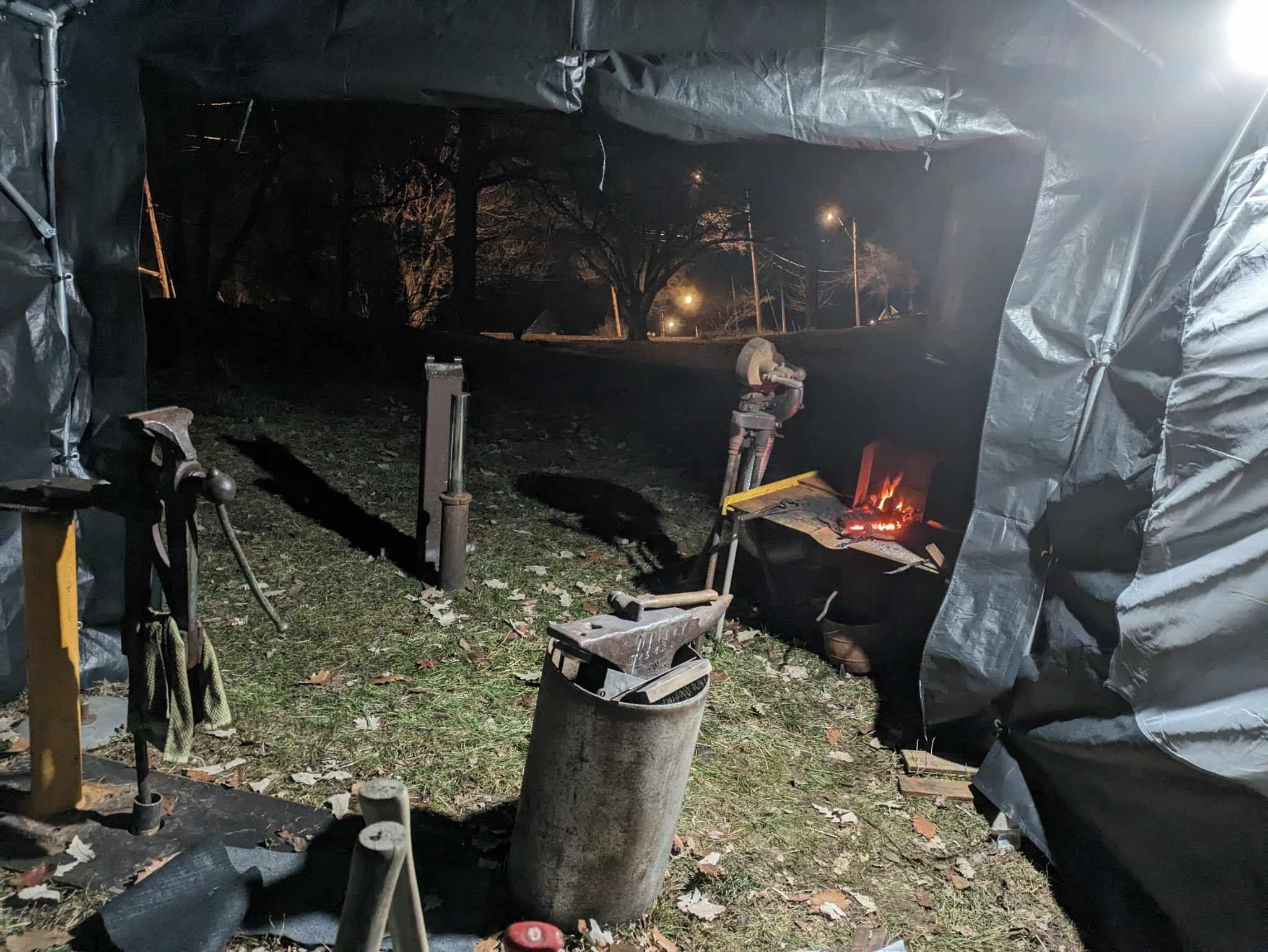

Shainarue Posted February 1 Share Posted February 1 I mounted the hooks to a plank of lumber last night at which point I noticed the two flat scrolled hooks are crooked! I tweaked and double checked tweaked more and double checked again before I painted them. I don't know how these managed to get past me. Embrace the imperfection I also decided last night to try and forge in the temporary shelter. I was hoping I'd get used to the slope. I didn't. If anything, it felt worse the longer I was out there. So I won't be forging the again until I've leveled the ground. Here's a pic from inside the shelter looking out. For reference, I tilted the camera until the light poles in the background were vertical. It looks like I took a crooked picture but it really is that sloped. Quote Link to comment Share on other sites More sharing options...

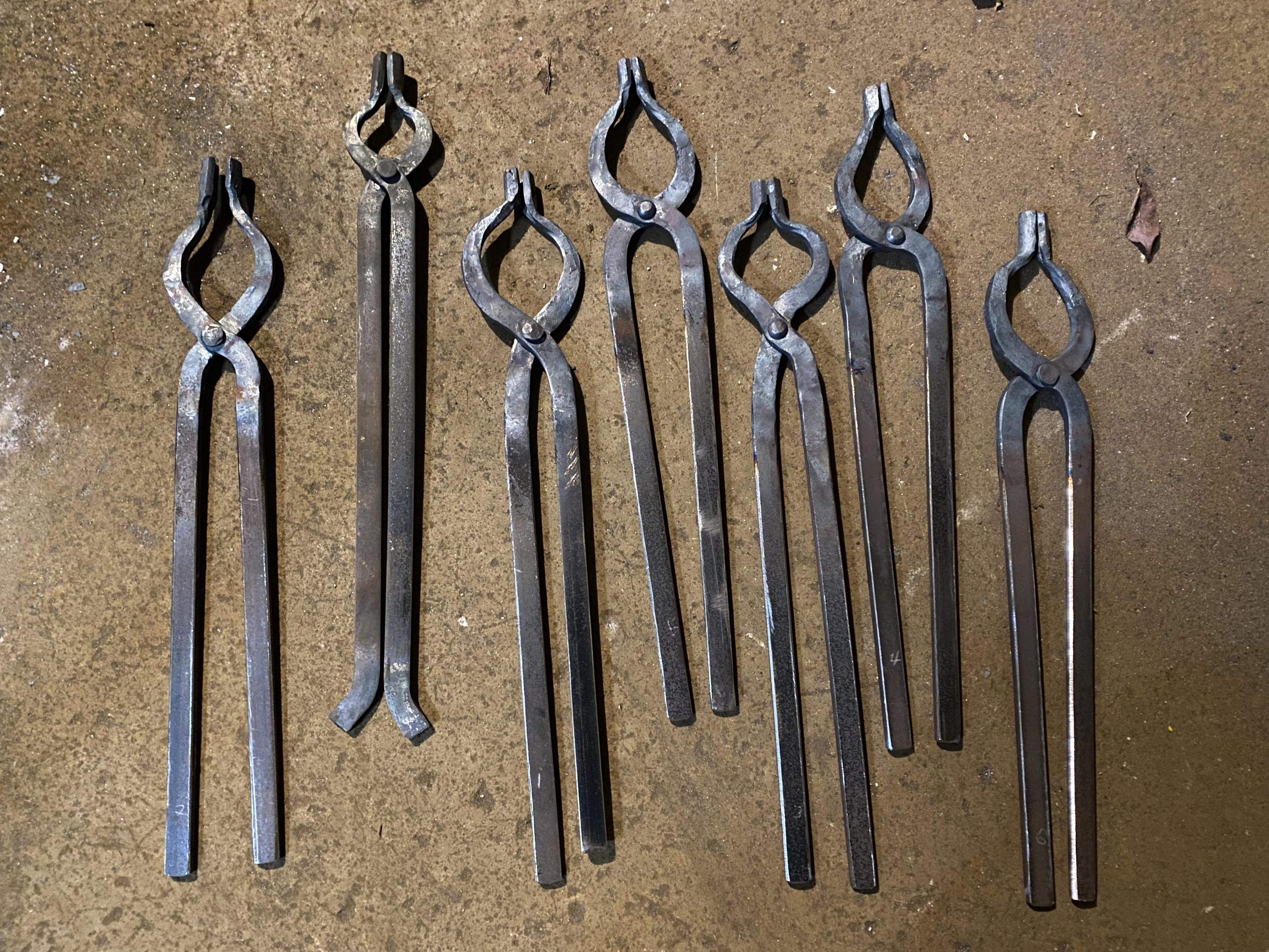

JHCC Posted February 3 Share Posted February 3 I am teaching a class on Sunday, so I need half a dozen pairs of 3/8” bolt tongs. Here’s the prototype; I’ll make the rest tomorrow. These are made from two 16” lengths of 1/4” x 1/2” flat bar, shouldered, tapered, twisted, bent, with the bits shaped on the fly press with the fuller & swage I made yesterday, and riveted. The first pair took about an hour, but I think I should be able to bring that down. Quote Link to comment Share on other sites More sharing options...

bluerooster Posted February 3 Share Posted February 3 quick, and simple tongs. I love it! Quote Link to comment Share on other sites More sharing options...
Will Brouwers Posted February 3 Share Posted February 3 I might steal both the leaf J hook and John’s quick and easy tongs! That stuff looks great! Quote Link to comment Share on other sites More sharing options...

Frosty Posted February 3 Share Posted February 3 That's a beautiful leaf coat hook Billy, I really like it. Am I the only one here who puts 2 screw holes in a coat hook? Nice tongs John they look to be about the same basic tong I like to make from 3/8" x 3/4" stock. I have more ham handed friends I believe. Better luck next time(s) Blue, practice will get you there. Frosty The Lucky. Quote Link to comment Share on other sites More sharing options...

JHCC Posted February 4 Share Posted February 4 Finished the tongs. Not 100% happy with them, but it’s too late in the evening to do any more fiddling. 7 hours ago, bluerooster said: What is the class? I’ve got half a dozen total beginners coming over tomorrow. They will each make a bottle opener from 3/8” square bar. I also made a pointer to use during class, based on the one I saw Carl West using last week. Quote Link to comment Share on other sites More sharing options...

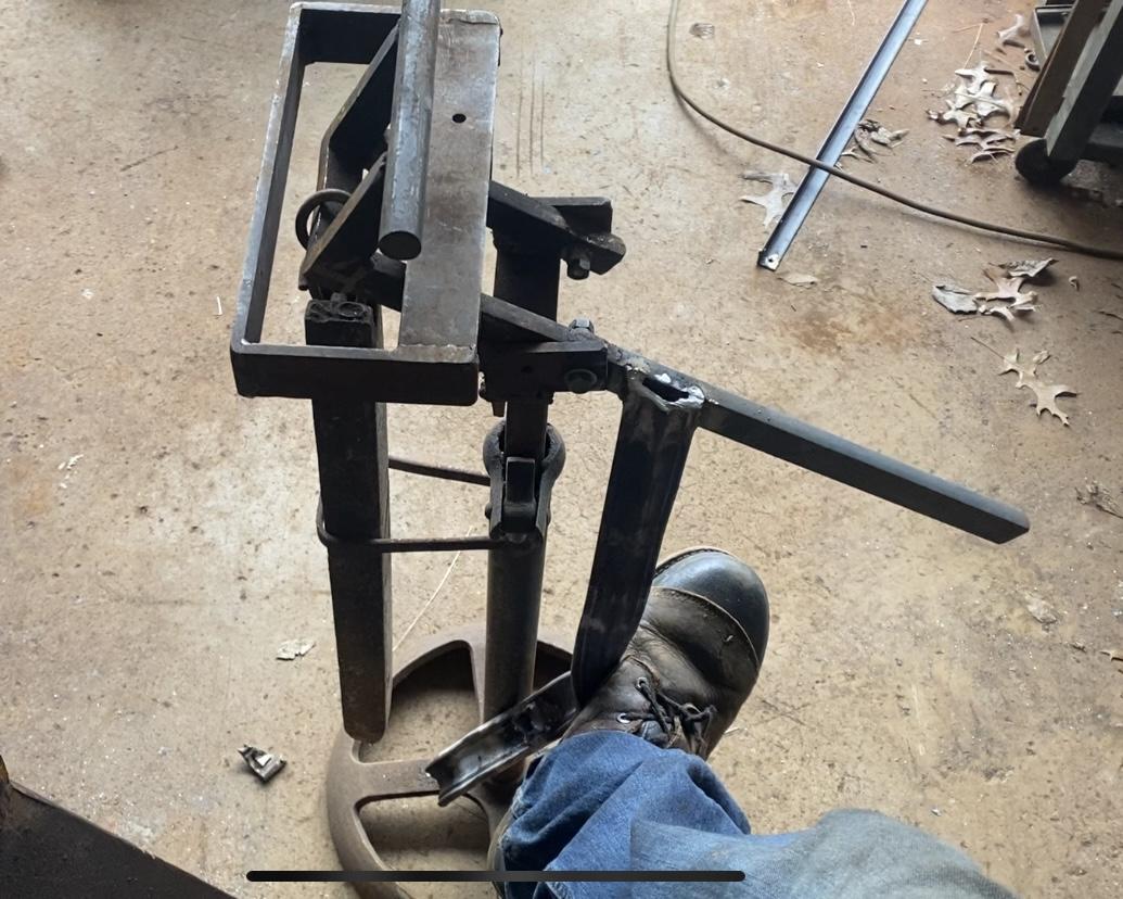

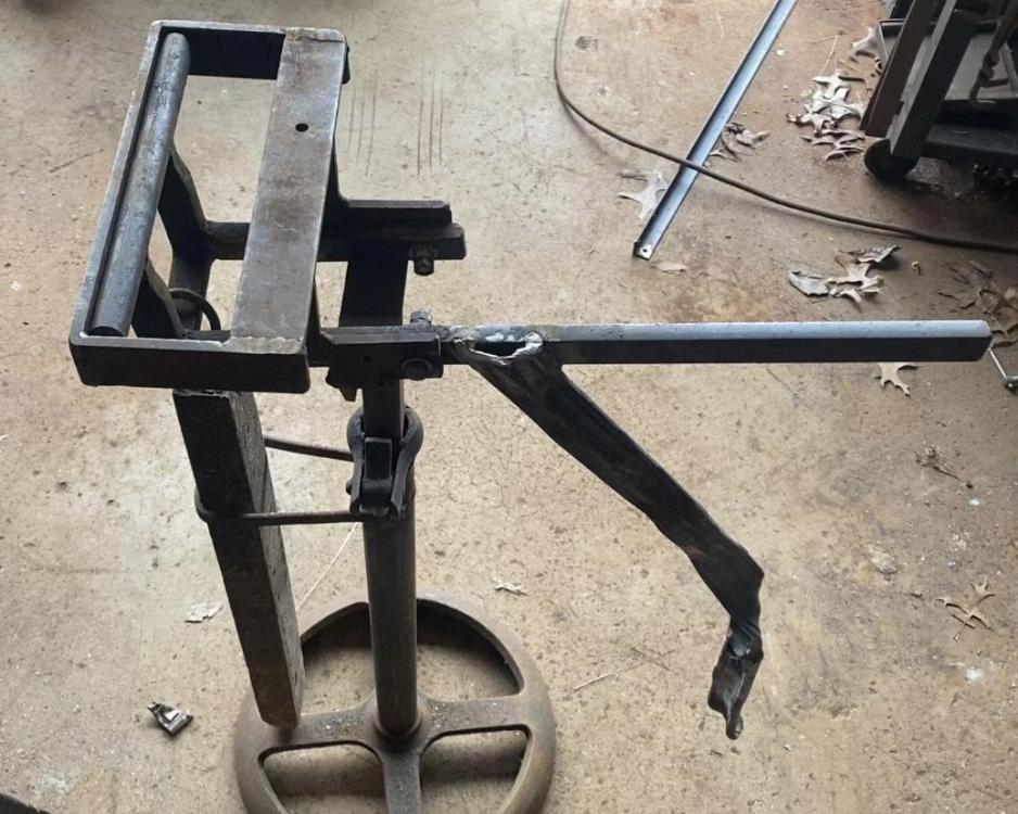

JHCC Posted February 4 Share Posted February 4 Also added a foot lever to my stock support/hold down, for hands-free operation. (This was made from a piece of molded cap rail that I’d salvaged from a handrail that got hit by a car, spoiling it for its original use.) Quote Link to comment Share on other sites More sharing options...
Davor Posted February 4 Share Posted February 4 That is a nice hook Billy. JHCC that is a genius design, I was looking at it thinking how that lever looks funny how are you gonna hold it shaped like that. Then I realised that it is not for pressing down, that it holds it self. Excellent. Quote Link to comment Share on other sites More sharing options...
JHCC Posted February 4 Share Posted February 4 I stole the basic idea from Kim Thomas, who has such a hold-down incorporated in his “chisel stand”. My innovations were to eliminate the work surface, make the height adjustable, change the shape of the hold-down from an upside-down “U” to a double “T” (thus allowing the stock to be moved in and out of the sides rather than being threaded in from the end), and (now) adding the foot lever. I also added a guide to keep the counterweight from swinging around. Quote Link to comment Share on other sites More sharing options...
bluerooster Posted February 4 Share Posted February 4 I like that hold down/stock support. Is that a base from a gum machine? Quote Link to comment Share on other sites More sharing options...
JHCC Posted February 4 Share Posted February 4 No, it’s from one of a pair of stands given to me by a friend. Not sure what the original use was, but they had 12” square steel plates on top. I still use the other one as a moveable stand for tools, moving it next to whatever I’m working on at the moment. Quote Link to comment Share on other sites More sharing options...
Frosty Posted February 4 Share Posted February 4 Pretty slick, thanks for the link John. Frosty The Lucky. Quote Link to comment Share on other sites More sharing options...
