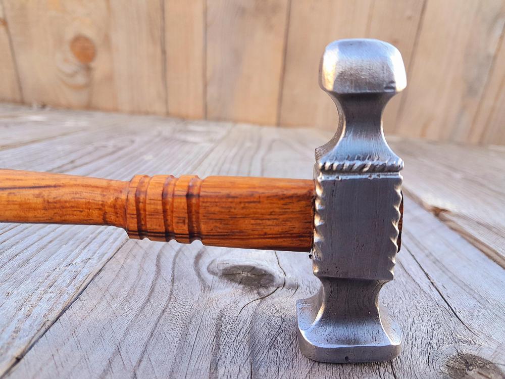

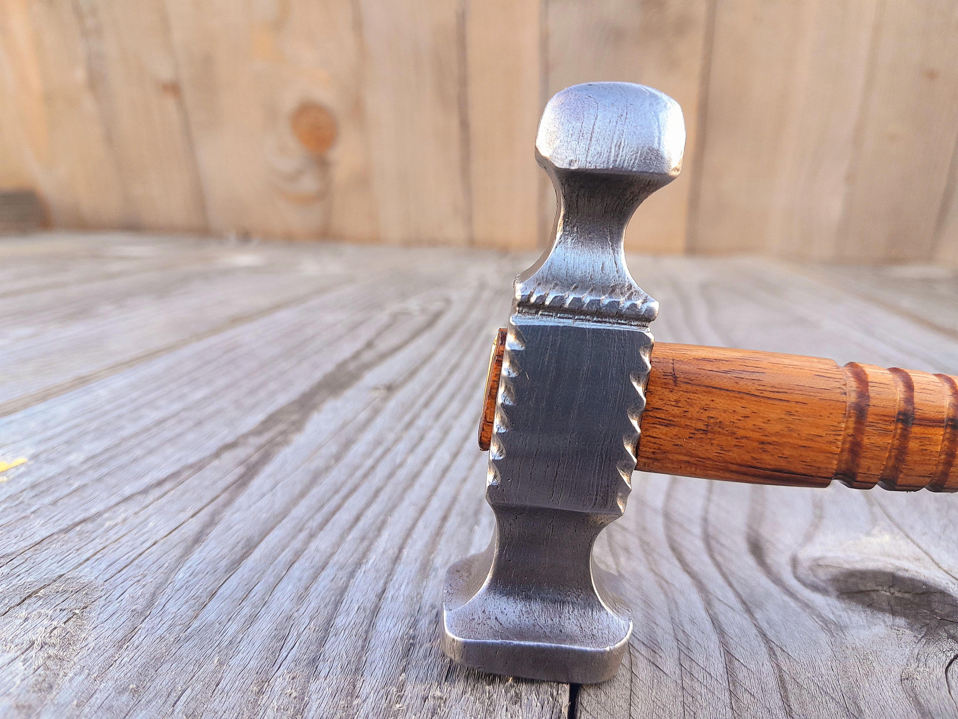

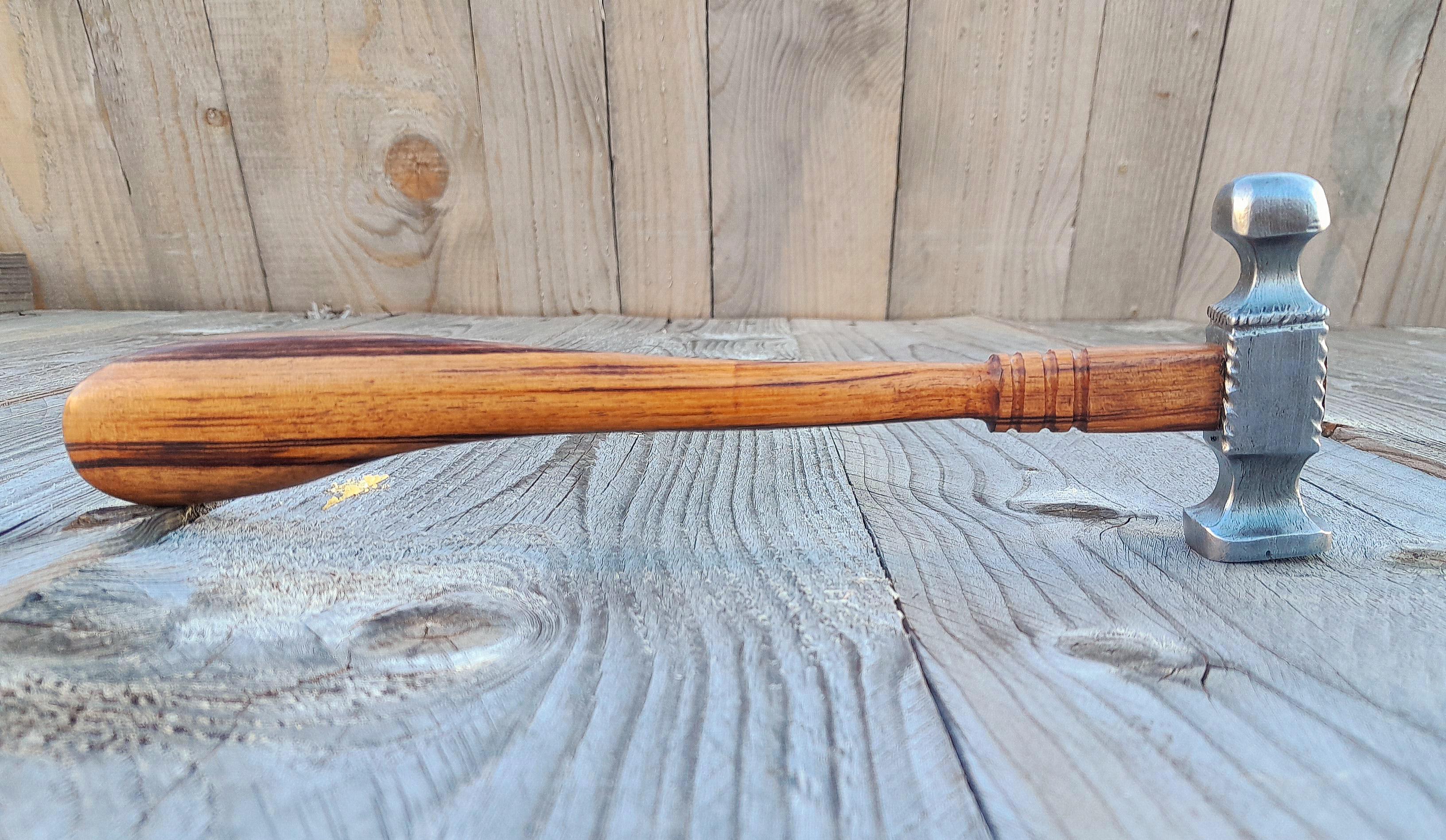

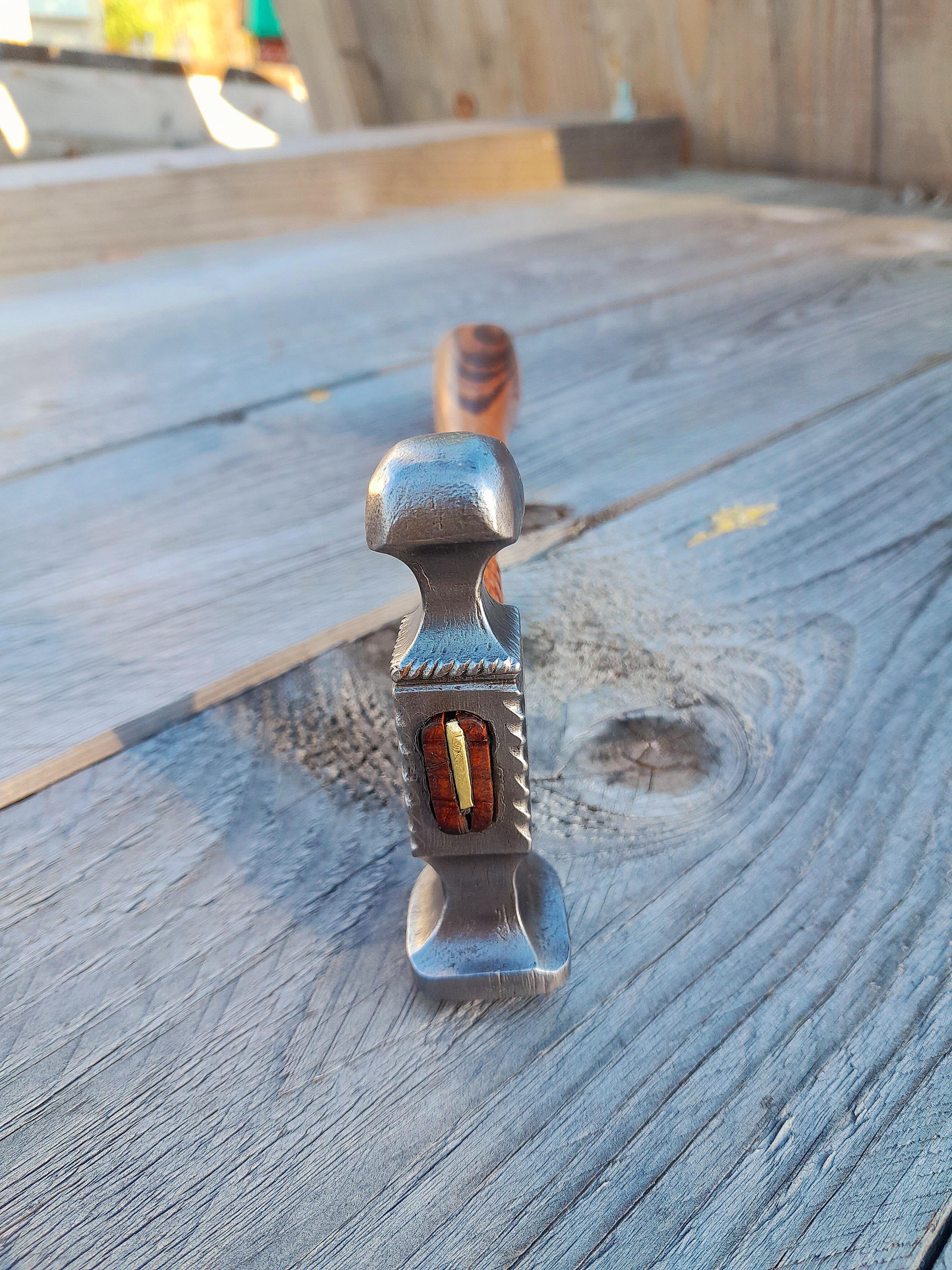

I just finished up a chasing/engraving hammer. I made the head a couple months ago. I drilled and filed the eye instead of punching it. I found that out the hard way( 4 previous tries). I forged it to shape and then cleaned it up with files and a grinder.
The handle is Goncalo Alves that I shaped and filed to shape. I actually used my lathe to mill the filework around the neck of the handle. Took a little bit of patience and clean uo but I got  'er done. I might use it to decorate my next project which is a pipe tomahawk.  I'm very glad to have completed this. This has been a project I have had in mind for the last two years. I am thinking of making more and selling them at demos but I have a bit much on my plate lol.
