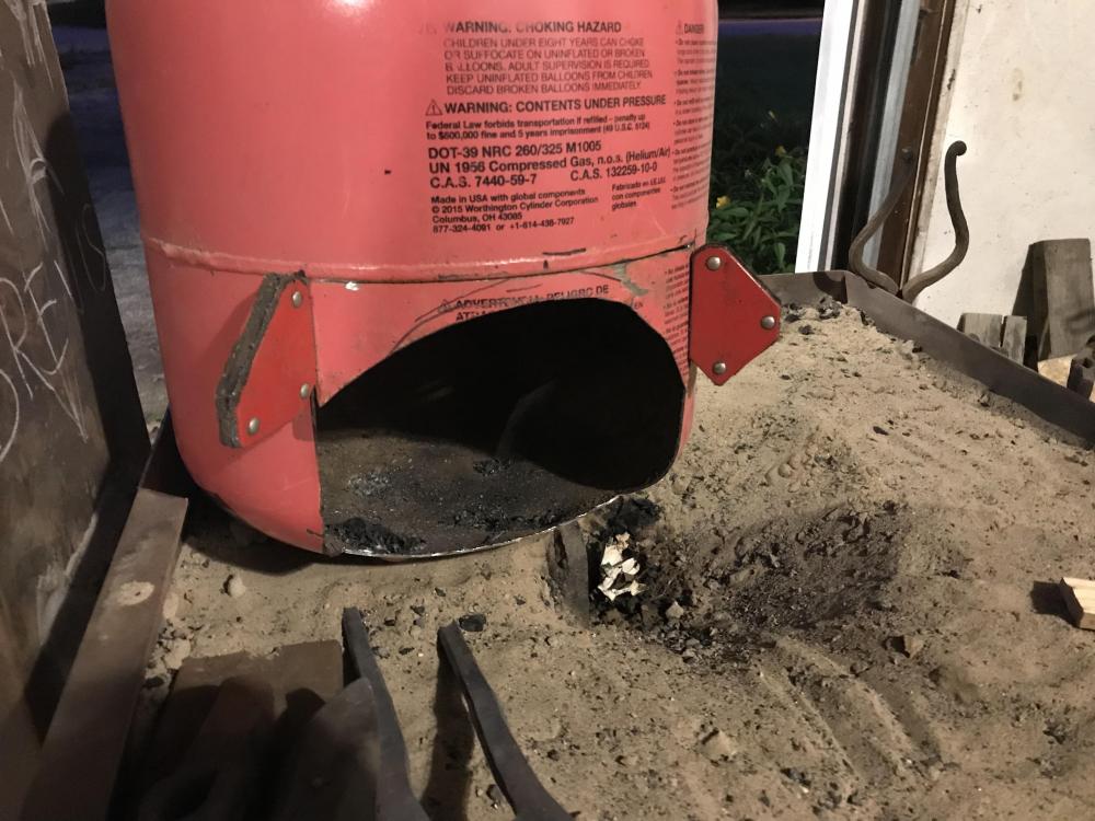

Here's the tank sitting in the forge. You can see where the top had already been cut off and one of the marks for cutting the front opening.

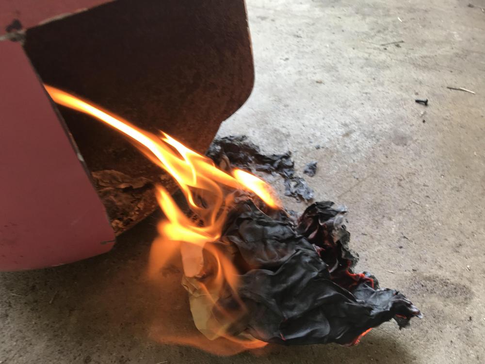

Here's a test burn with some brown paper. Decent draft.

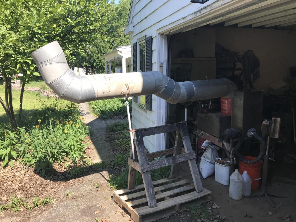

Here's the horizontal flue seen from outside the garage. It ain't elegant, but it appears to work.
I took a video of another test burn once it was in place, but I couldn't get it to upload to YouTube. I'll try again later.Initial observations: decent draft. I suspect it will be better with a full-size fire pulling hot gasses up the flue. Also, the fit of the flue in the hood is pretty sloppy, and I think it's leaking smoke out and draft in. I have an idea for fixing that, though, and will be trying it soon. More to come!
Suggest you round the corners of the opening to the tank. This creates less opening area and increases the suction a bit. Once clear of the garage door, a more vertical chimney will also increase the draft.
Good thoughts -- thank you. I still have the cutout from the opening and can easily make a couple of arched corners from that and tack-weld them in place. As for the vertical pipe, we'll see what the salvage gods send my way.
I think if I make the sawhorse support somewhat taller, that will increase the upward slope of the flue and improve the draft a bit as well.

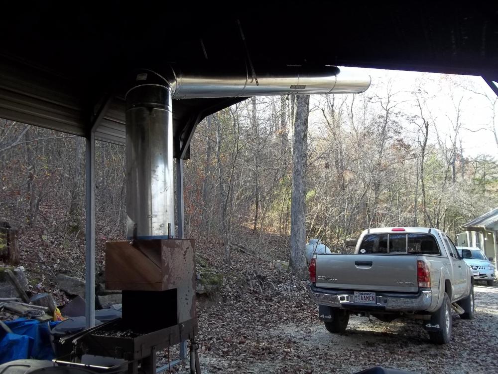

JHCC. my original flue was smoking up my shed horribly, so I ran a slanted 12" flue out the end.  Works like a charm.  Your outside double elbow might be restricting the flow a little (maybe none at all) so you might try a straight slanted flue without the double elbow.  If it's a problem with the upright supports, maybe you can modify them.
The double angle in the middle is jammed, so that’s about the best I can manage. I’ll try tweaking the bends at the ends, though.

Update: welded in the arch (messily, because my welder setup is a bit overpowered for this thin steel, even at its lowest setting), switched out the flue supports for something taller, and made a gasket to tighten up the connection between the hood and the flue. Performance is definitely improved.
