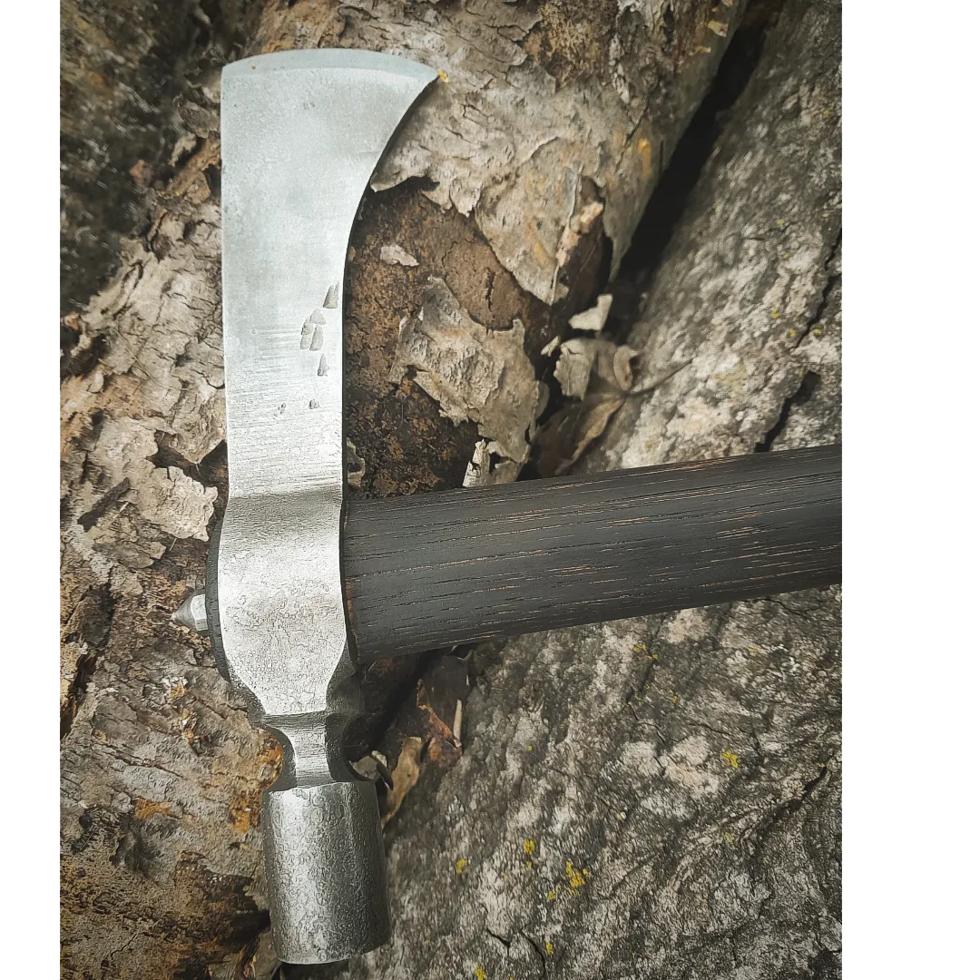

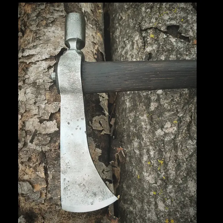

I just finished up a pipe tomahawk today. I forged it out of a peice of 1inch Dom pipe with ¼inch walls, slit it down the middle and forge welded a 1080 bit. The handle is charred hickory with a damascus smoke plug. I put a sliver of leather between the bowl and the handle to create a better seal.
Looks pretty good John, you're getting good at this.

White fox-  that's a nice tomahawk,I like the Damascus plug I don't see that a lot .. one of these days I should probably try my hand at an axe, hatchet, or tomahawk.
