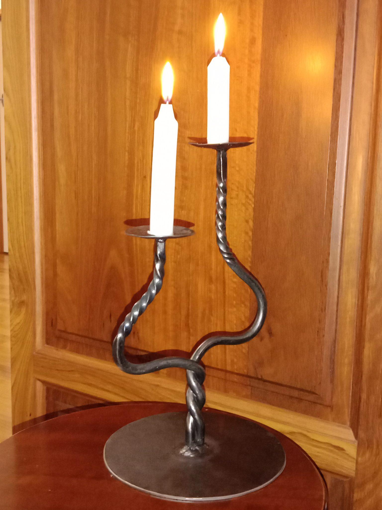

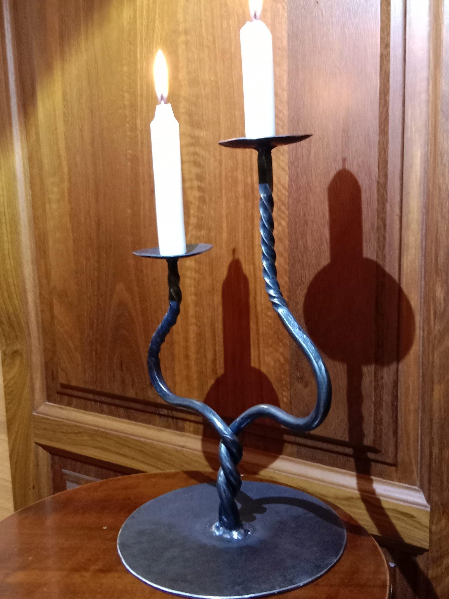

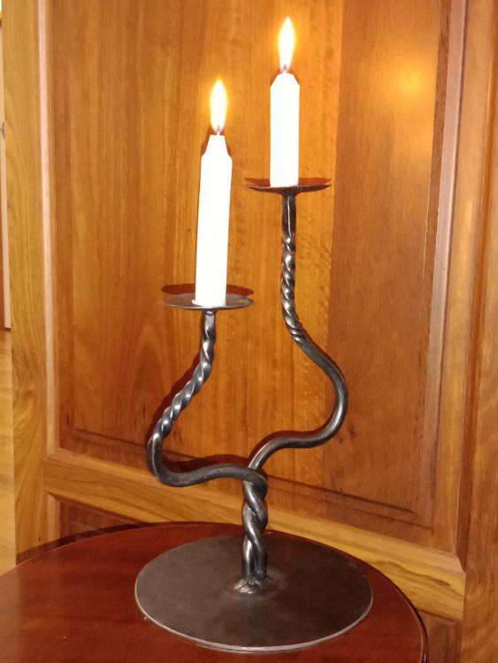

Jim, how are the candles held in place. I do not see a cup so i am assuming it is a spike. Are the drip pans welded in place and the spike made from a tenon?
Nice idea, i like it. I love making candle holders. There are so many variations you can do, From wall mount, table top, or even floor stand. My wife will not let me make her any anymore.

Thanks Jono, yeah i thought i would add the twists for something a little more exciting, just had to make the last bends right in one heat cause it wouldnt fit back in the forge lol.
Billy, it was my first candle holder so just winged it as i went, was going to use a spike for the candles but then thought it would look good with those small tea light candles too, so no spike, figured the melted wax would hold them, ( mabye not though..may have to mod a small spike on thinking about it..)
Yeah they are welded on. Will be trying a few more for sure!

Jim that is a great candle holder.   Do you have a coal forge, gas forge or both?  In the past I've stated superhuman in one that I have to finish in the other.  Working a piece straight until I had to make a large bend that wouldn't let me work in the propane forge type of stuff.
Rojo, for sure, give it a go and  post a pic, id like to see it, i dont mind a bit of ( candle ) stick welding;)
Thanks Frosty, appreciate it alot mate.
Chad, I have a charcoal and 2 burner gas forge, i use the gas now mostly as its quicker but it is a bit limited with certain shapes, ( couldn't fit a bit of coil spring in it to straighten last time!) then to get the bends just right( only had to straighten them a few millimetres) for the holder after it was done i use a mapp gas torch.
