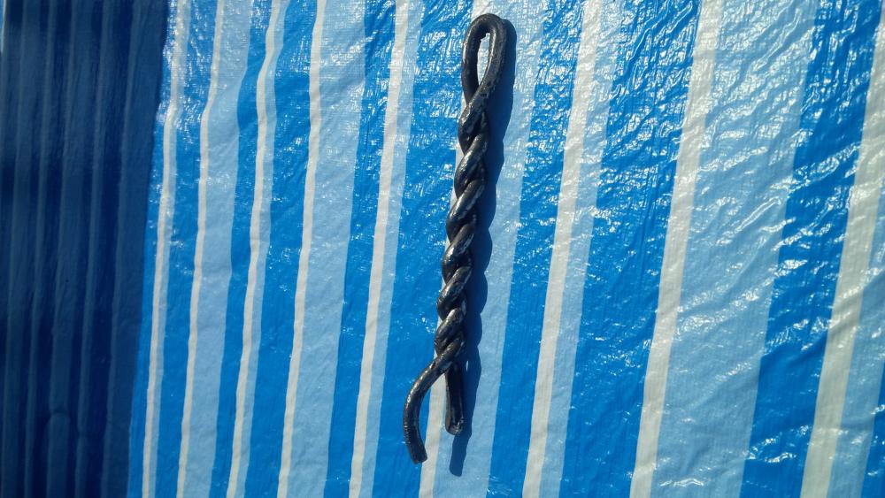

John B Posted July 27, 2016 Share Posted July 27, 2016 8 hours ago, mcb said: Thanks swedefiddle. I will have to think about a twist-top design that I can forge. Would be an interesting challenge. These work well for twist tops, they were originally made for a live forging competition, 45 minutes to make something to crack nuts with, and were made from an old car spring, But my wife used them when she damaged her wrist and couldn't get to grips with the twist tops on bottles. Quote Link to comment Share on other sites More sharing options...
Pancho07 Posted July 27, 2016 Share Posted July 27, 2016 Very cool John, I think I have a new project to try Quote Link to comment Share on other sites More sharing options...
