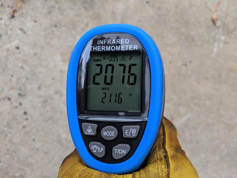

  8. Thanks BartW,. I have been playing with the blacksmith hobby off and on for the past 4+ years and this is the first time I feel more like a hobby blacksmith and less like a goof pounding on hot scrap metal. I still have lots to learn but it felt really good to succeed at this one skill. It expands the realistic projects I can attempt by a nice notch and that feels good too.
  9. Made another attempt this morning. First thing I did was switch out my burner nozzles. At first I tried .055 and that just turned my forger into a orange ball of fire burping monster. Shut it down and put in .047 diameter nozzle and that seems to be pretty close to a sweet spot for my forge. Using the same IR thermometer I was able to hold 2200F with a peak of 2265F. This time I folded a piece of mild steel over and in the fold put a piece of high carbon steel from a file. I had ground off the teeth and cut off about 1.5 inches of the the file and ground the mild steel clean too. The piece of file got tucked into the folded over end of mild steel. No pictures of it but the folded mild steel covered only about half of the top of the piece of file. Heated it until just starting to turn red and then applied a nice coating of Borax flux. Back into the fire and watched for the Borax to bubble. It did not bubble as vigorously as I though it would so I almost missed it but it did bubble and out it came for firm controlled blows with the hammer. Before it lost too much color it when back in for a second heat and then slightly firmer blows. A final third head and heavy blows and I had a pretty good weld it seemed. I cut the side off the weld with my grinder to expose the weld seams and it seemed to take pretty good. I decided I would attempt to make a small wood chisel from it so I ground the mild steel off of the top side leaving the high carbon steel exposed on one side. I then drew out the weld layer to nearly twice is original length. Figure if it didn't come apart doing that it was a decent weld. I ground off the scale on the edge of the weld and used a sharp file to clean it up and you can see the weld interface and the small separation at both ends of the weld. I will grind those out when I finish rouging in the file. I ran out of propane. Thanks for the all advise and suggesting guys. That weld might not be pretty but it would not have been possible at all without your feedback. Thanks for all the help!

  11. Thanks, the mud is getting at little more watery at least. I did not flux inside the joint I was trying to make only fluxed after I had put the two surfaces together, so that no doubt did not help my attempts.
  12. Thanks guys that was very helpful. I will see what I can do to get some known good tool steel or high carbon steel without nickle or chrome. I will also see if I can get my forge a touch hotter too. The hard to read colors working outside and my eyes is why I bough that IR temperature sensor. I am guessing I need to be seeing 2200-2300 degrees in the forge to have the steel hot enough to weld by the time it gets to my anvil. I think I might need slightly larger diameter fuel nozzles as I still think I am injecting the fuel too high of a velocity drawing in too much air in with it in my burners. It's hard to get a reducing flame even with the airflow choked way down. It goes from neutral to extinguished with very little reducing flame in between. Fatter nozzles might let me get more fuel into the forge without overdoing the air too much. When I first built the forge I was using .025 MIG tips as nozzles going to .035 made a noticeable improvement to the temperature. I have a bunch of extra tips so I might drill some out to .047 and see if that helps get my temperature up a bit more. I also need to get my propane tank into a large bucket of water, about half way through the session I froze it pretty hard and that was hurting my fuel output too.
