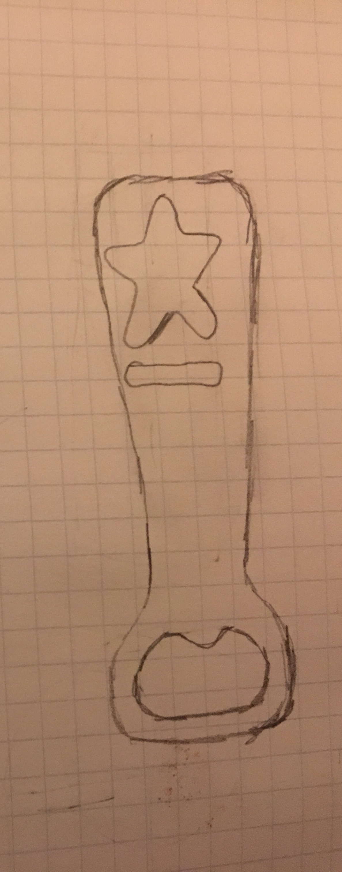

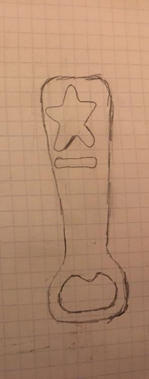

After sleeping on it some more I think I'll probably go with something like this.image.jpeg
ill probably try the other as well just to see if I can but I would imagine this would be more comfortable at the least.
I like that Pancho, a neat solution,
If you do define the star edge it would be  as you have already realised beuncomfortable to use, and if put in a pocket or bag it could damage lining.
I like this thread, proof of considered input, understanding of requirements, and a practical feasable solution Well done all concerned,
Now you just have to make it and post pictures.

Will do John, if all goes well with the process I have in mind should be done later today.
All was going great until I quit paying attention and burned the loop off, guess it goes into the reminder box
Happens to us all, it's called "gaining experience" Darn frustrating though all the same.
Not quite back to square one, call it a practice run.
Good luck with the next one,

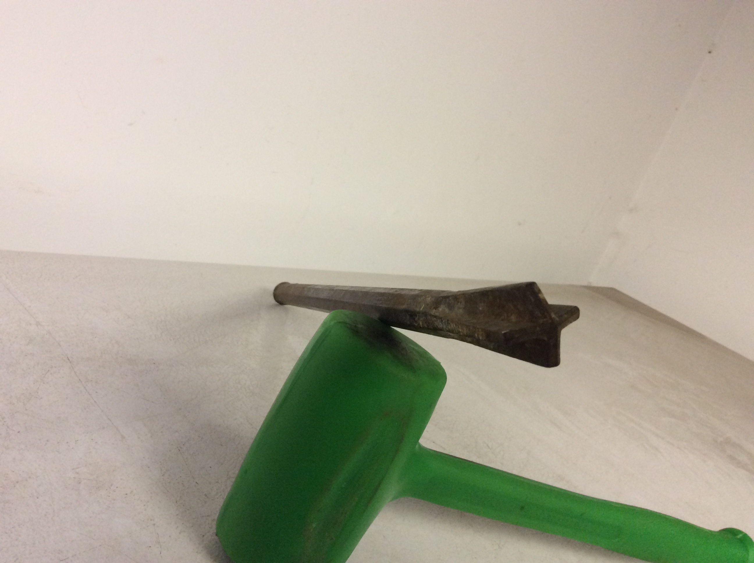

Found this old decorative star punch I made years ago.  Filed shape out. 5/8" point to point.
It probably could work but it's not quite the shape I'm lookin for
30 minutes ago, BD1 said:
I'm new to this so just wondering if a '' STAR '' chisel would work to punch through ?
https://encrypted-tbn1.gstatic.com/images?q=tbn:ANd9GcSylBMGB4ZeC-T8YWniDVDU1ub8rkWGWESAwz_XQagXrqiFWkjHimages?q=tbn:ANd9GcSylBMGB4ZeC-T8YWniDVD
Bob those would mark the steel well, but once you started to push them thru you'd loose the pattern because of how "shallow" the shape is. If they were ground back farther they might work. The smaller one would make neat patterns on the surface though for a lot of things.
The 5 point star drill could be modified to work though making your own with a file and piece of coil spring wouldn't be much more work.
I like your current design. Remember, the thinner the steel the faster it will heat so save the thin sections for the last steps. forge it to general shape, punch the hole for the opener loop and leave it that way till you're finished with the star, then go back and finish the opener.
Forging from thick to thin saves me a bunch of burned off thin sections. ;)
Yes Doug, that was the online pic I found . This one may work but not the design he wants.

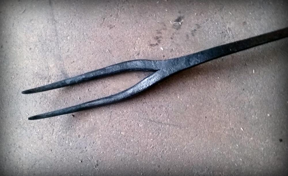

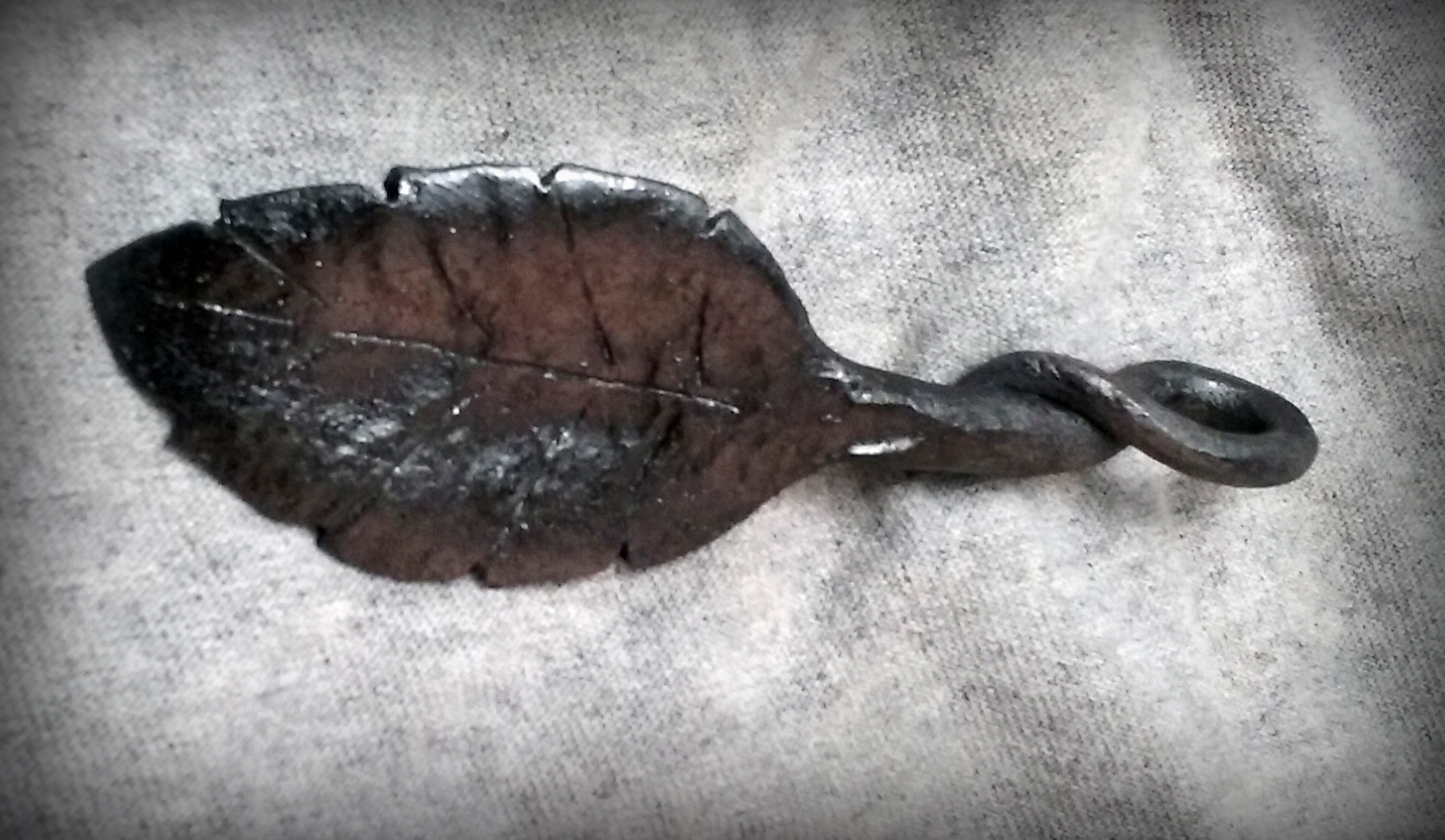

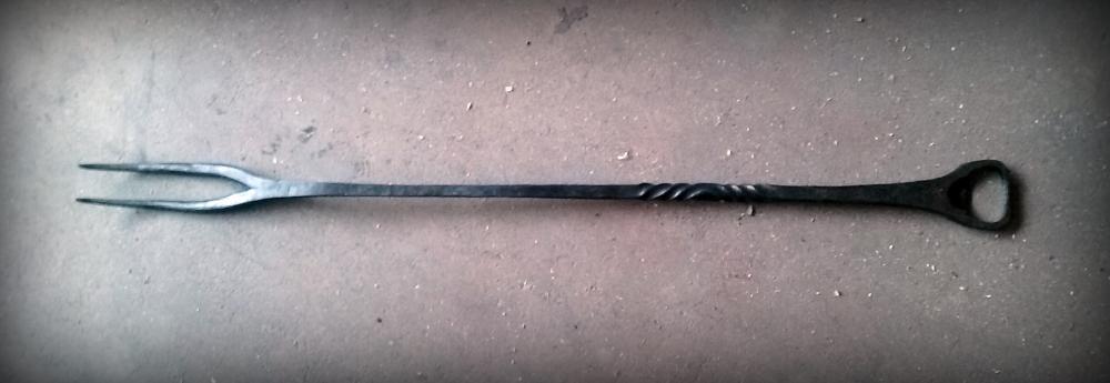

Had a couple of vacation days I had to use or lose, so took them to get some extra time to get stuff done for my upcoming show.  Spent the morning on a couple of file knives.  Then took the rest of the day and went a little opener heavy.  Made a toasting fork/bottle opener.  Then made one out of the end of a lug wrench.  Then took the lug bolts out of a truck axle I scored at the scrap yard and made openers out of those.  Took a few minutes to make one of those coiled rod candle holders. Then just because I've never gotten one that I like, I spent the last part of the afternoon trying a leaf key chain.  This one actually looks like a leaf, so I'll take that as a win.  Still long way to go, but my inventory is finally getting up there.

Ayup, looks like the crazy bottle is open alright. You're capturing the transition from a known object to a different known object nicely. Seeing the plastic nature of steel is a good selling point.
Looks good to me! I maintain its crazy to NOT turn junk into something useful...
Heap, that's a good lineup of more stuff for the table. Having a good variety shows the Different things you Can make.
Nice work.

A suggestion on the fork, put a radius at the bottom. As is it is a weak design that can promote a crack.

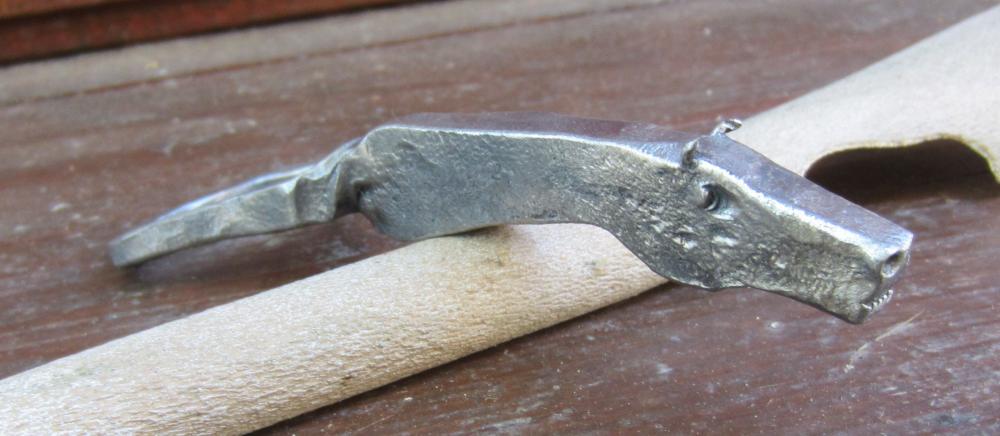

I had my troubles lately with twisted openers, too. Here is the horsehead prototype I made. I still can't understand how but I mistwisted the stem. (Looked at it, marked the direction, viced it, twisted it, opened the vice, and bamm: wrong!) So you can see the correction in the twist's lines.
