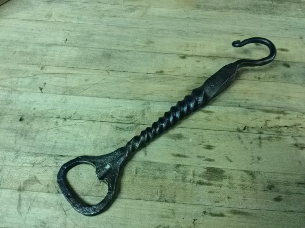

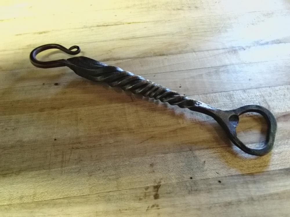

BryanL Posted March 21, 2016 Share Posted March 21, 2016 My first two bottle openers. If you look closely, one was going to be a pineapple twist but I stopped at just twisting one direction so it has a funky extra twist look. The other is all about more practice. Quote Link to comment Share on other sites More sharing options...

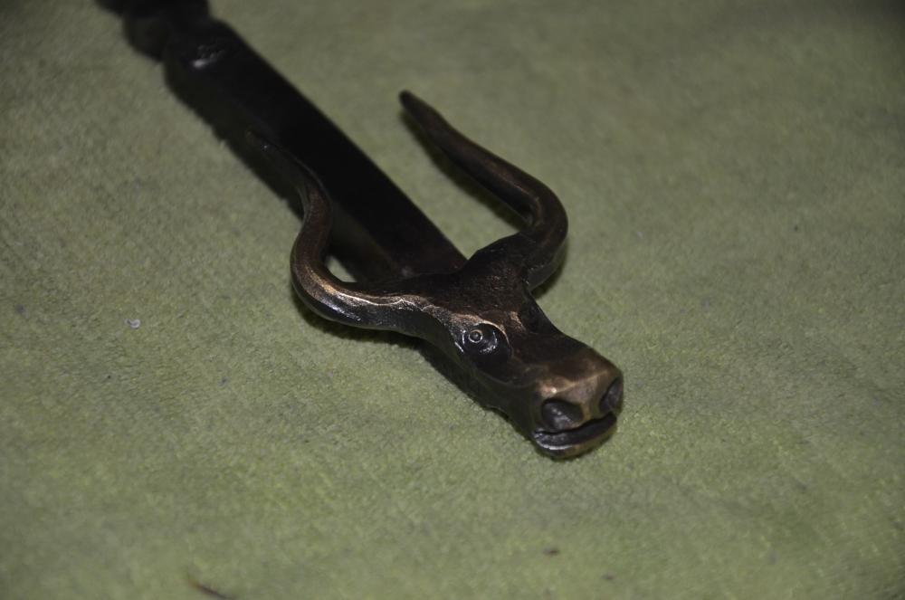

ausfire Posted March 31, 2016 Share Posted March 31, 2016 I was just splitting the horns to start another bull's head bottle opener when one of the visitors, a little girl said, 'Can you make a dragon like Smaug?' I think she had been watching a Hobbit movie. I have never made a dragon so I split the horns a bit further and gave it a try. It looks a bit 'bullish' but I was happy with it for a first go. I need to make it look a bit craggier and fiercer ... and has anyone forged a dragon with a tongue sticking out?? That would be a challenge. Quote Link to comment Share on other sites More sharing options...
tdaleh Posted March 31, 2016 Share Posted March 31, 2016 Ausfire google Dan Boone blacksmith dragon lots of dragons. Quote Link to comment Share on other sites More sharing options...
beammeupscotty Posted March 31, 2016 Share Posted March 31, 2016 (edited) 11 hours ago, ausfire said: I have done tongues on dragons. I forge them as a separate piece, then drill an appropriate sized hole in the mouth and sweat solder the tongue in with silver solder. Edited March 31, 2016 by beammeupscotty Quote Link to comment Share on other sites More sharing options...
John McPherson Posted March 31, 2016 Share Posted March 31, 2016 FABA how-to pages has a few examples. http://www.blacksmithing.org/CB-Archive/2006/2006-01-cb.pdf Quote Link to comment Share on other sites More sharing options...
