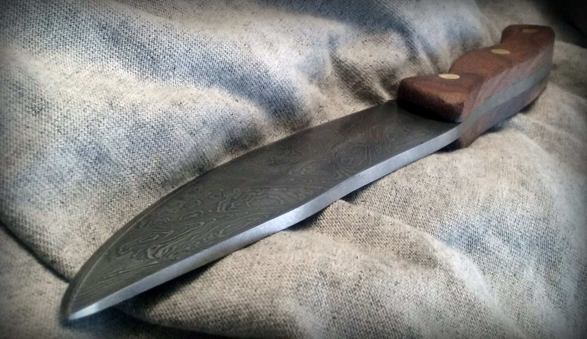

I've always been intimidated by feather patterns, but decided to give it a try. I love how it came it, and will absolutely be trying some other variations in the coming months. Blade Length: 6" Handle: 4.5" 1080 and 15n20, bone bolsters, walnut scales, black leather spacers This took me about 2 and a half weeks from start to finish, which is the most time I've spent on a single knife in quite a while... I wish I had made the handle just a bit bigger... my wife says it fits her hand perfectly, so I guess that's not terrible, but even for a kitchen knife, I'd like it to be just a bit bigger for my hand. The bone also came out looking kind of gray and dirty. Other bone I've used has come out white and clean looking, but I guess I got a bad cow or something with this batch.

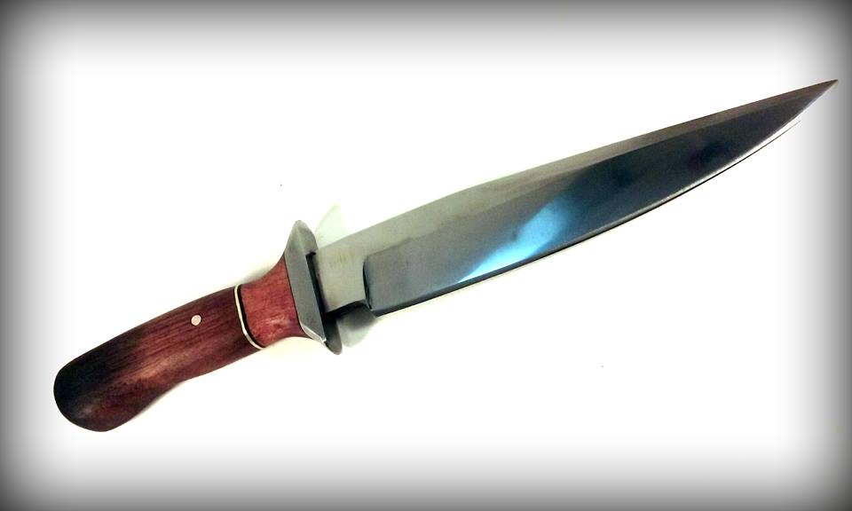

Hey everyone, Been a while since I've posted much. Been swamped at work, but have had enough time to complete a few recent projects. First is a Wakizashi inspired blade. 16.5" blade. 22" overall. Made from 5160 with Walnut Handle scales. Next is a small 5" twisted Damascus hunter. 1080 and 15n20 with quarter sawn oak handle scales. And last is an 8.5" Bowie with a Walnut and Mahogany handle with leather and brass spacers. Made from 5160 with a mild steel guard.

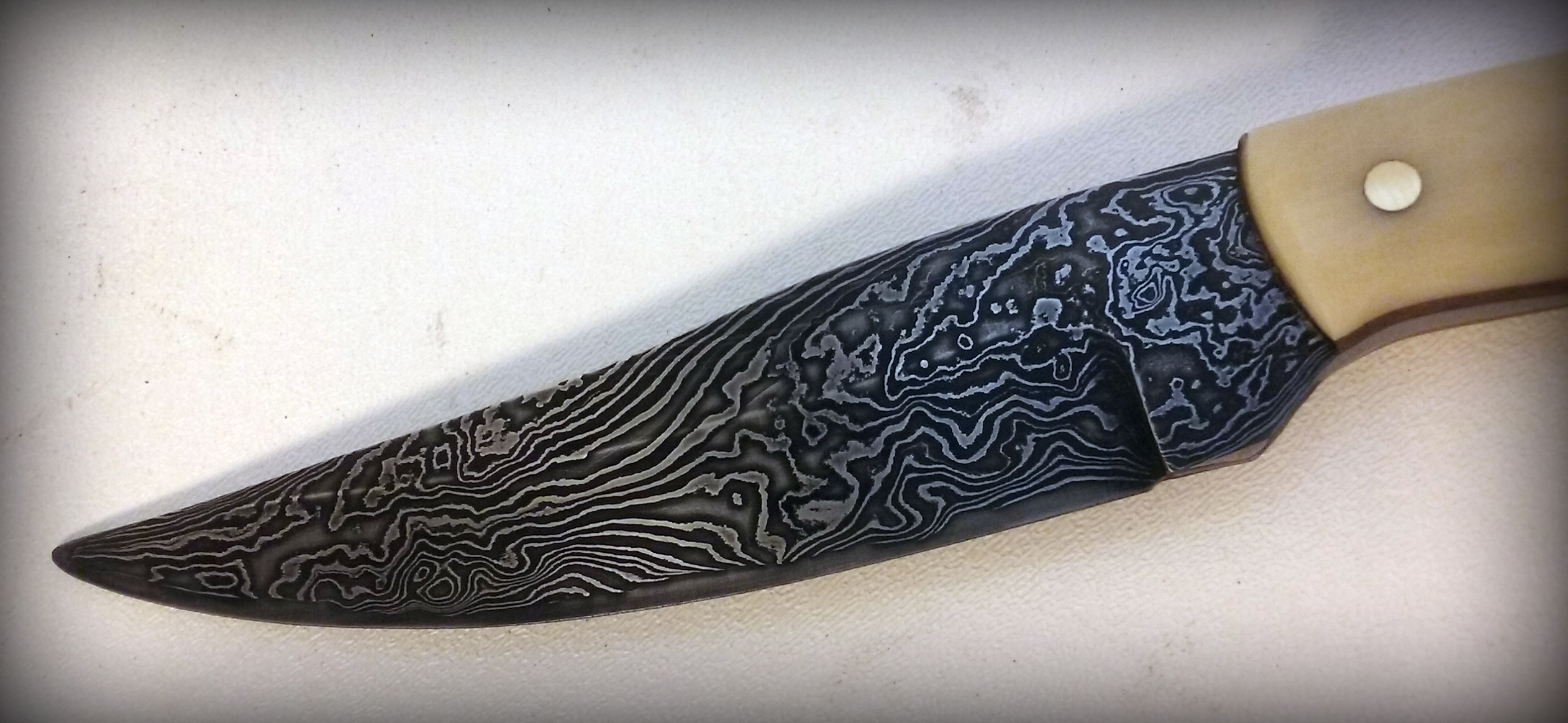

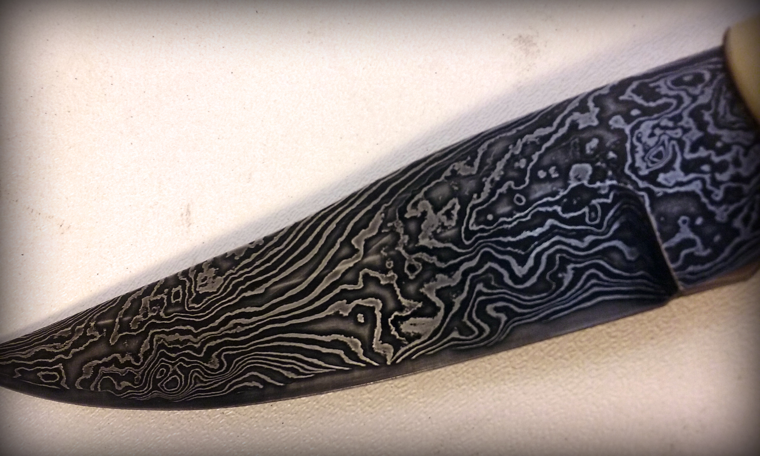

Damascus with bone handle (First time using bone)(picture heavy)
HEAP of JEEP replied to HEAP of JEEP's topic in Knife Making
Thanks, Theo. I've watched a lot of your builds and have been in awe, so that really means a lot to me. Thanks, Das. I've heard that working it with hand tools with help prevent the nasty smell, so there might be more bone handles in my future. -

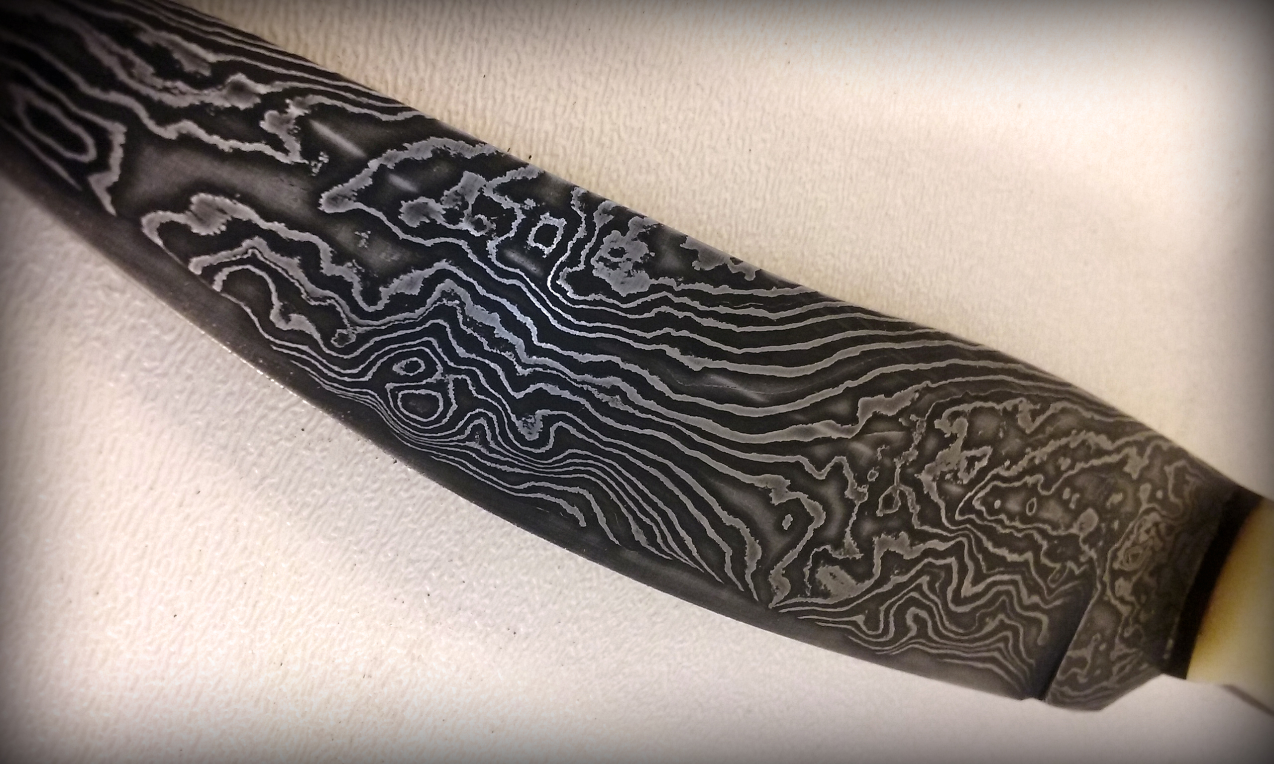

Been a few months since I've really had time to forge up anything new, so when the time appeared, I of course had to go back to my favorite things to make. 1080 and 15n20, 60 layers, twisted, then stretched out and san mai'd it around a 1080 core. So final layer count would be 121. I used some old cow bone from my dogs chew toys, and some walnut as spacers. Its my first time ever using bone and it was so nasty, messy, and smelly, I don't know if I'll ever do it again. My garage still stinks to high heaven.

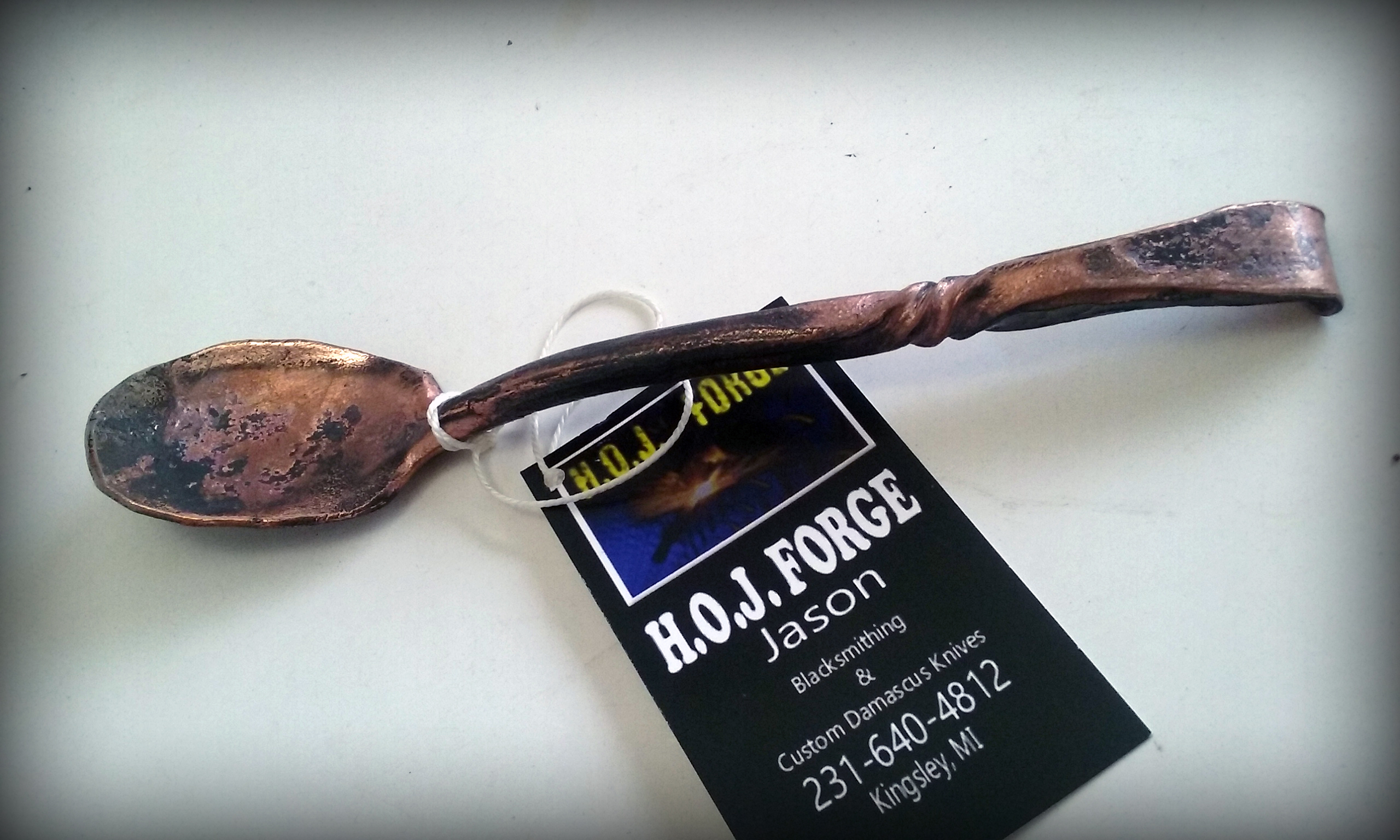

Trying to whip out a few small things for a Christmas craft show I have this weekend. When I was at the scrap yard a few days ago, I grabbed, what I thought was, a 5/8 copper rod, thinking I'd find some uses for it. I thought a copper spoon might be kind of cool, so figured I try one. I was worried about getting the copper to hot, so I kept a very close eye on it, but no matter what I did, it just wasn't moving very easily. I eventually got the spoon shaped, but wasn't happy with a coupe of spots around the bowl, so decided Id just touch them with the angle grinder and level them out real quick, and to my surprise, I got sparks.... a quick test with the magnet, and it turns out it was a steel rod with copper plating. Oh well. I was basically done with the spoon so decided to just polish it up to see what I got, and I was surprised at how much copper remained. Figured I'd label it "decorative only" since I can't be certain what alloys might be involved, but I think it will stand out nicely on the table.
