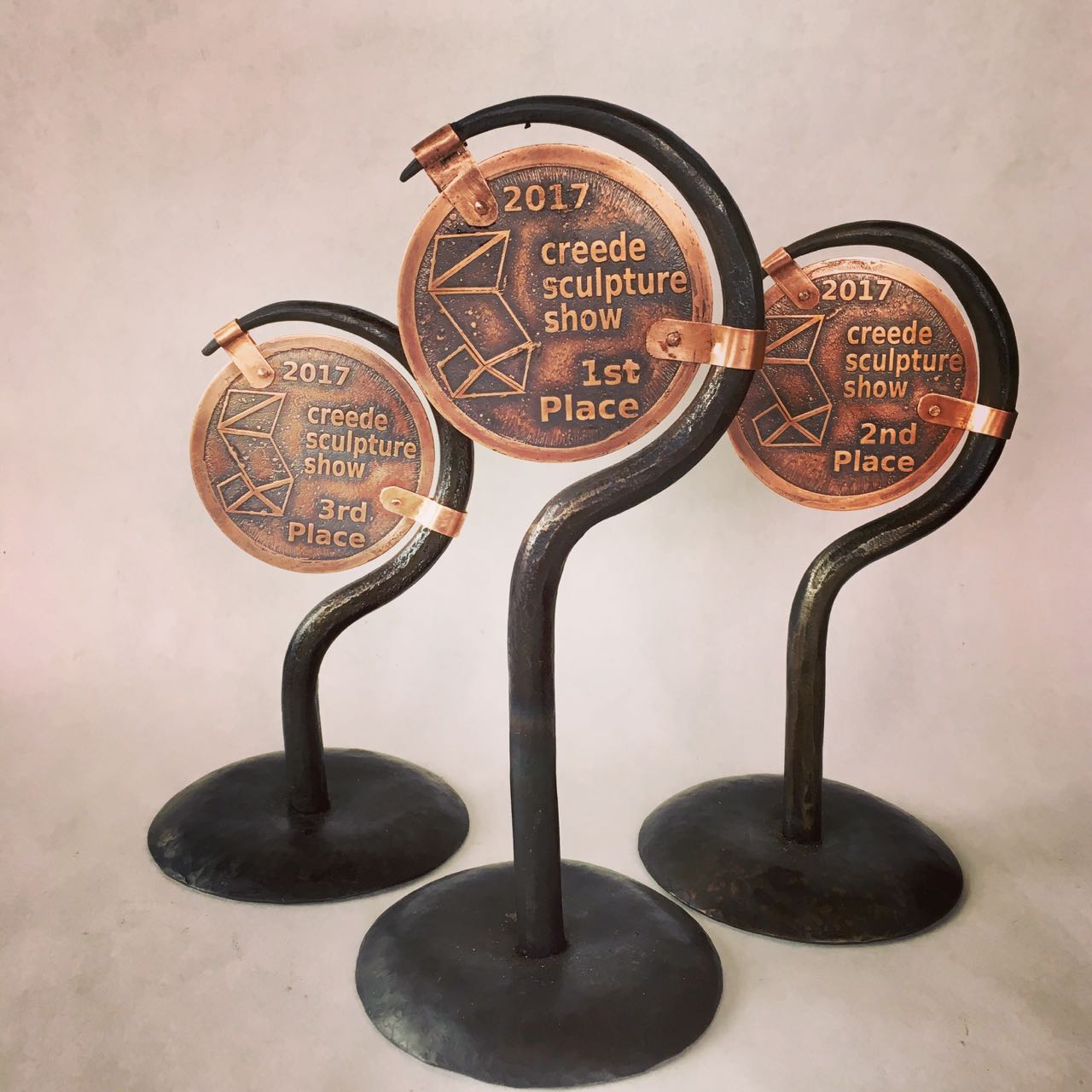

Thought there might be some interest in the final result. Ran into a time crunch due to a series of health scares, so i had to compromise on the design a little bit. Still reasonably happy with the results. FWIW - These are the awards for the Creede Sculpture Show this weekend.

Really enjoy working with a mixture of copper/steel on a project. Offered to forge and donate the awards for the Creede, CO Sculpture Show this weekend (2017/8/18). A little intimidating making awards for a juried sculpture show. A few mistakes here and there, but still pretty happy with the way they came out.

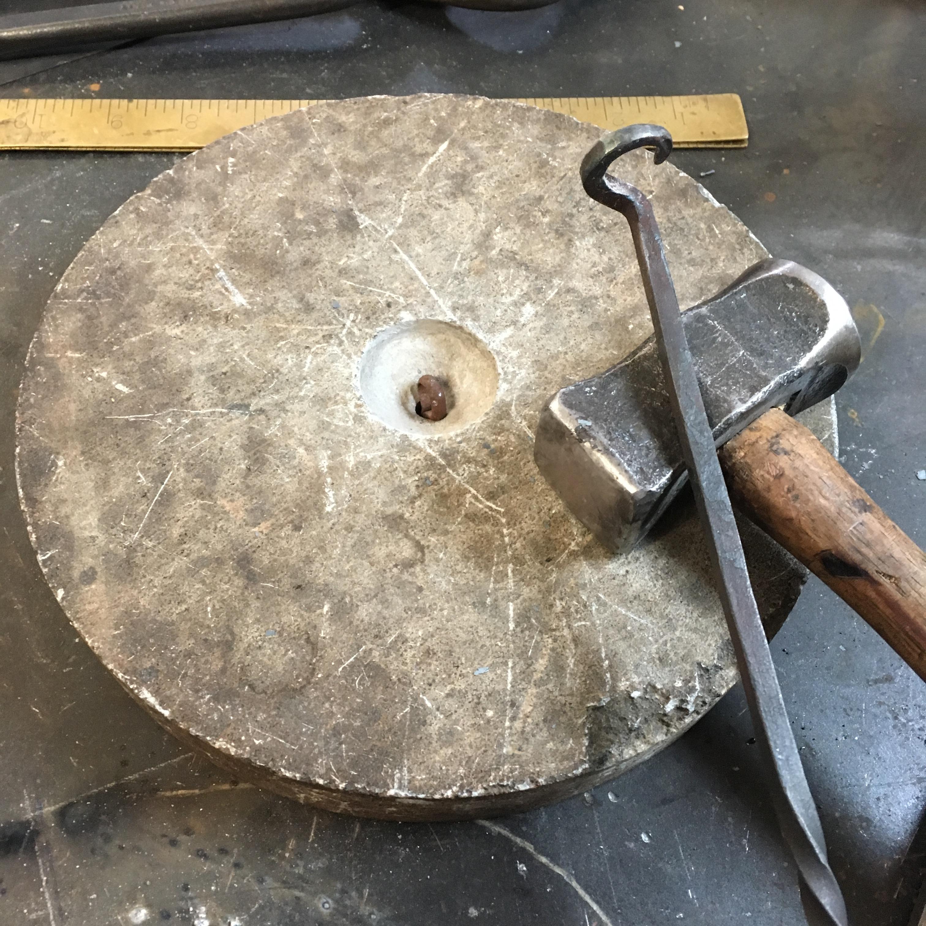

Here was my take on the hook with only the customer description. Despite what the video seems to present, the hook can be used from a vertical position. There is a slight screw pitch to the hook. I was under the impression that it had to also be able to pick up the radiator from a fire. Which you would want to do from the side. IMG_7321.MOV

The customer has all the radiators, but I have a lot of scraps left over from our home soapstone stove (3k lbs of mass). I've been saving them for some sundials. Perhaps I'll do some experimenting. Ive gone all Polyphemus (lost vision in one eye) so it will have to wait for a bit until I get things figured out.

Lactating camels aside (I feel like I started a thread of the Telephone Game), I believe I found depictions of the hooks used for the stone radiators: Figure 11 in this 1911 document. Or the picture on Page 15 of this document. What I forged was a bit excessive in the hook and the handle was different. Mine functioned a bit better than the plain hook but would have been prohibitive for mass production. thanks for making a rather mundane post into something [whatever the opposite of mundane is]. Dave

So, just a bit more info from the customer: the stoves were touted as quite the labor saving device for wives in the early 1900's. Not just for cowboys! The stoves were called 'The Caloric Fireless Cook Stove'. Haven't had a chance to do much more investigation, certainly no pics of the stone handling tool.
