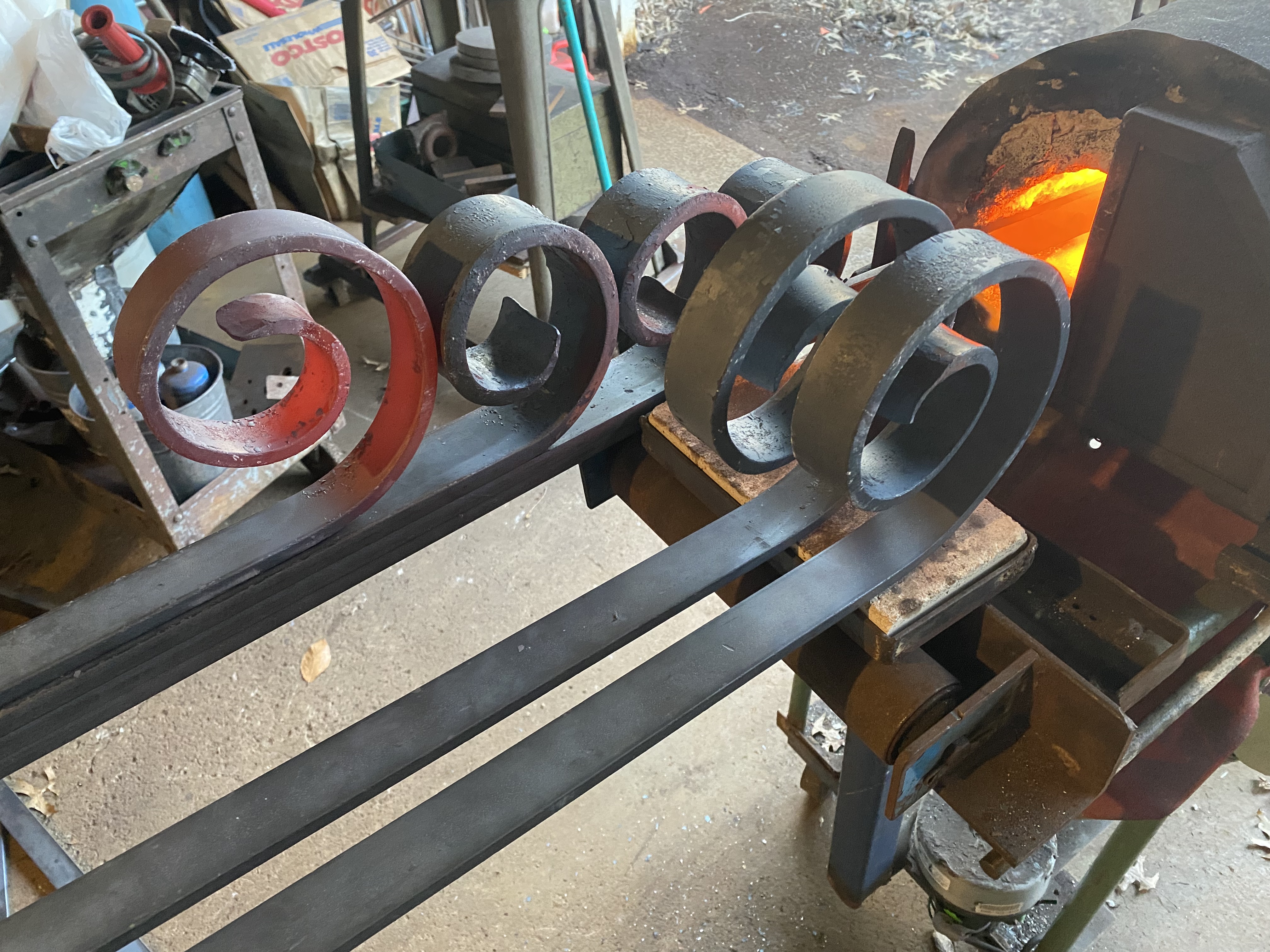

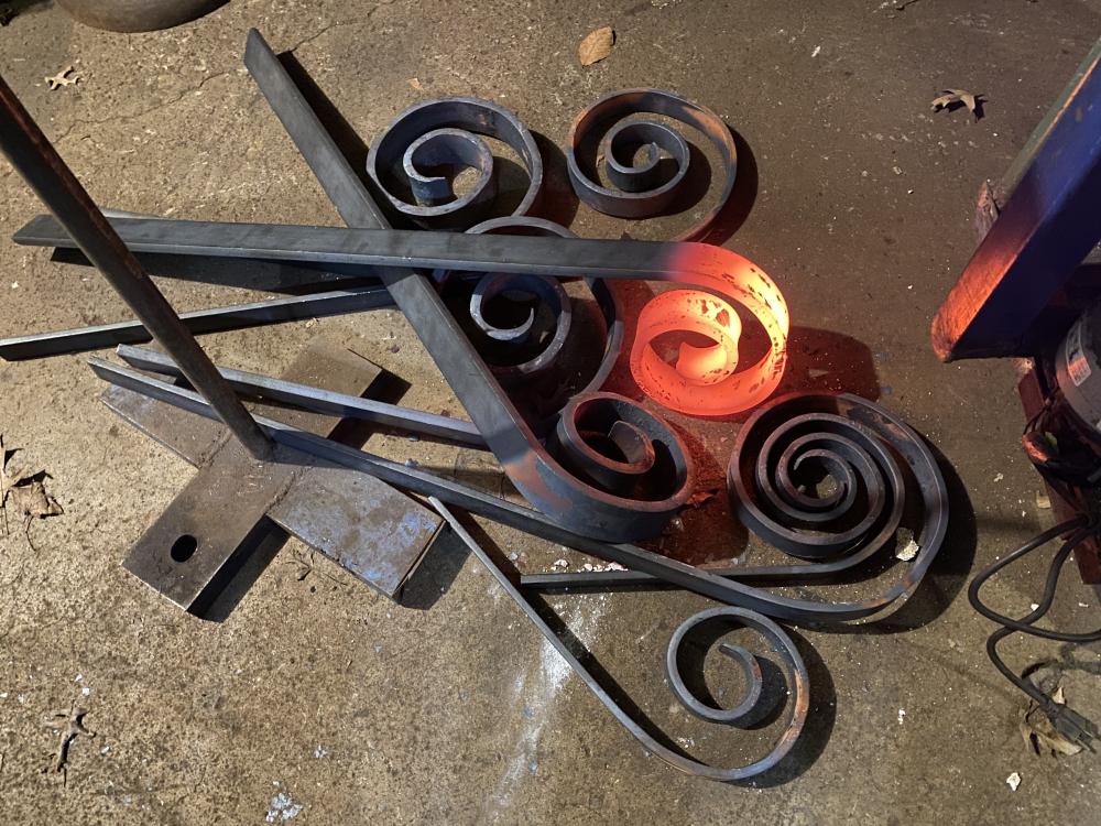

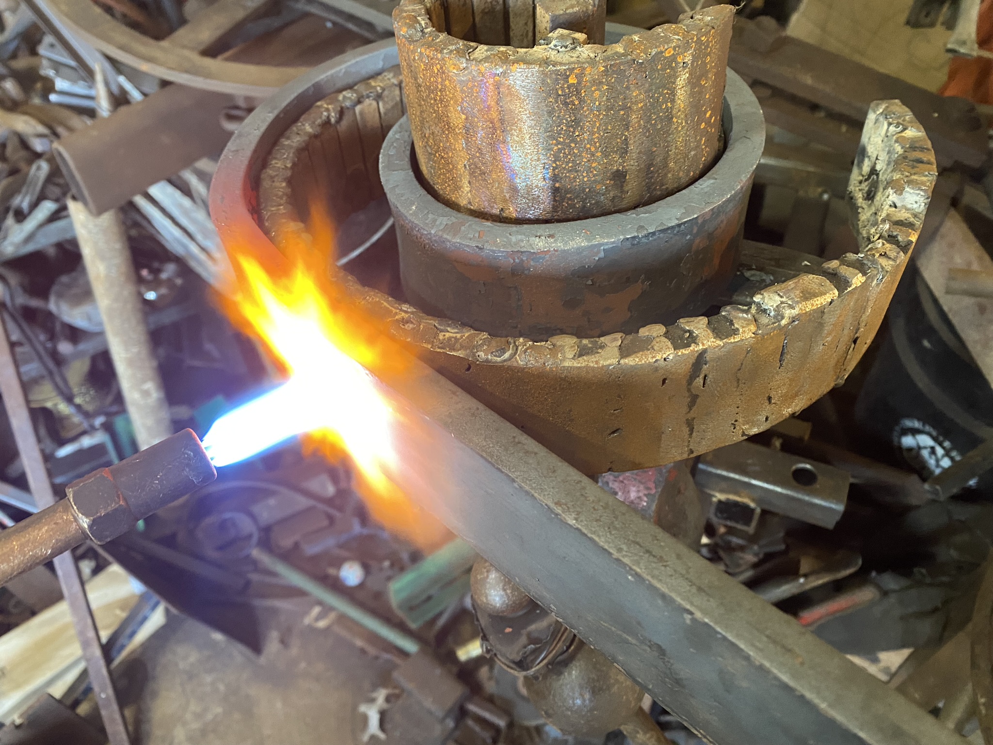

Lots of scrolling.
When the scrolls are too big for the forge, spot-heating with the oxypropane torch is an acceptable alternative.
The combination stock support/hold-down was very helpful when tapering the ends under the treadle hammer.

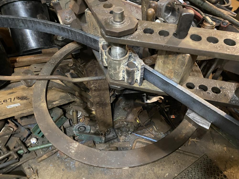

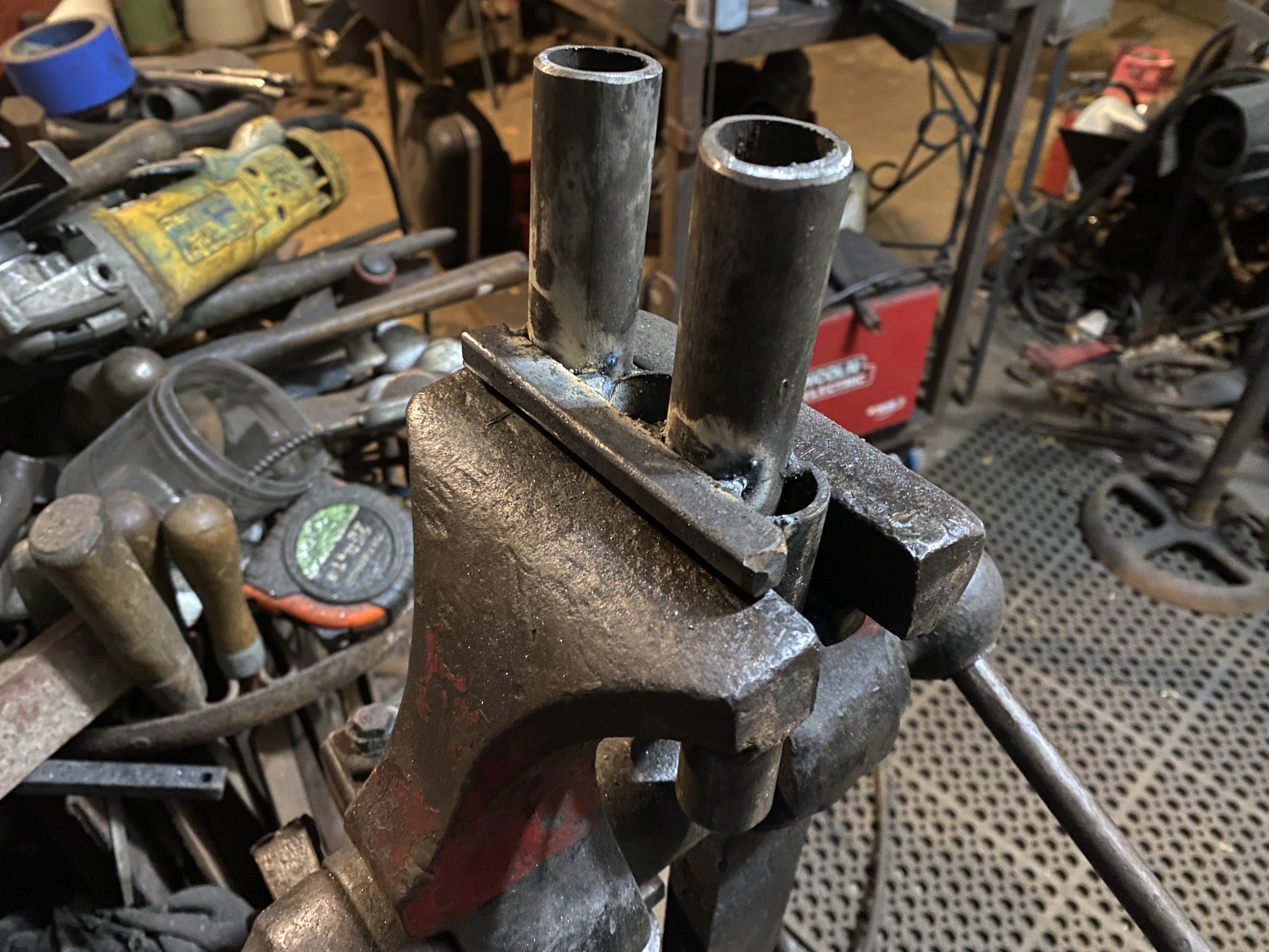

Also made a couple more bits of tooling for the Hossfeld bender; details HERE.

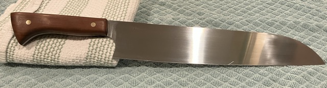

Well the chef’s knife I was asked to make is/was finished:
(Yes, the blade slid across the edge of my fine sharpening stone and the corner of the stone left a pretty good mark.) I did some test cutting with paper and was quite surprised how well it cut, and continued having fun cutting all of the paper I had nearby.
Then I used it to prep dinner tonight. I performed very well. Unfortunately, I didn’t clean it right away. We ate first… well, now I have to re-sand the blade. One of the food items etched the blade and left a couple bark spots. Live and learn…  (I’m feeling better about making knives now, but I don’t think I’ll ever make a chef’s knife this large again (12”). It was what was requested, but I found it really awkward in use.)

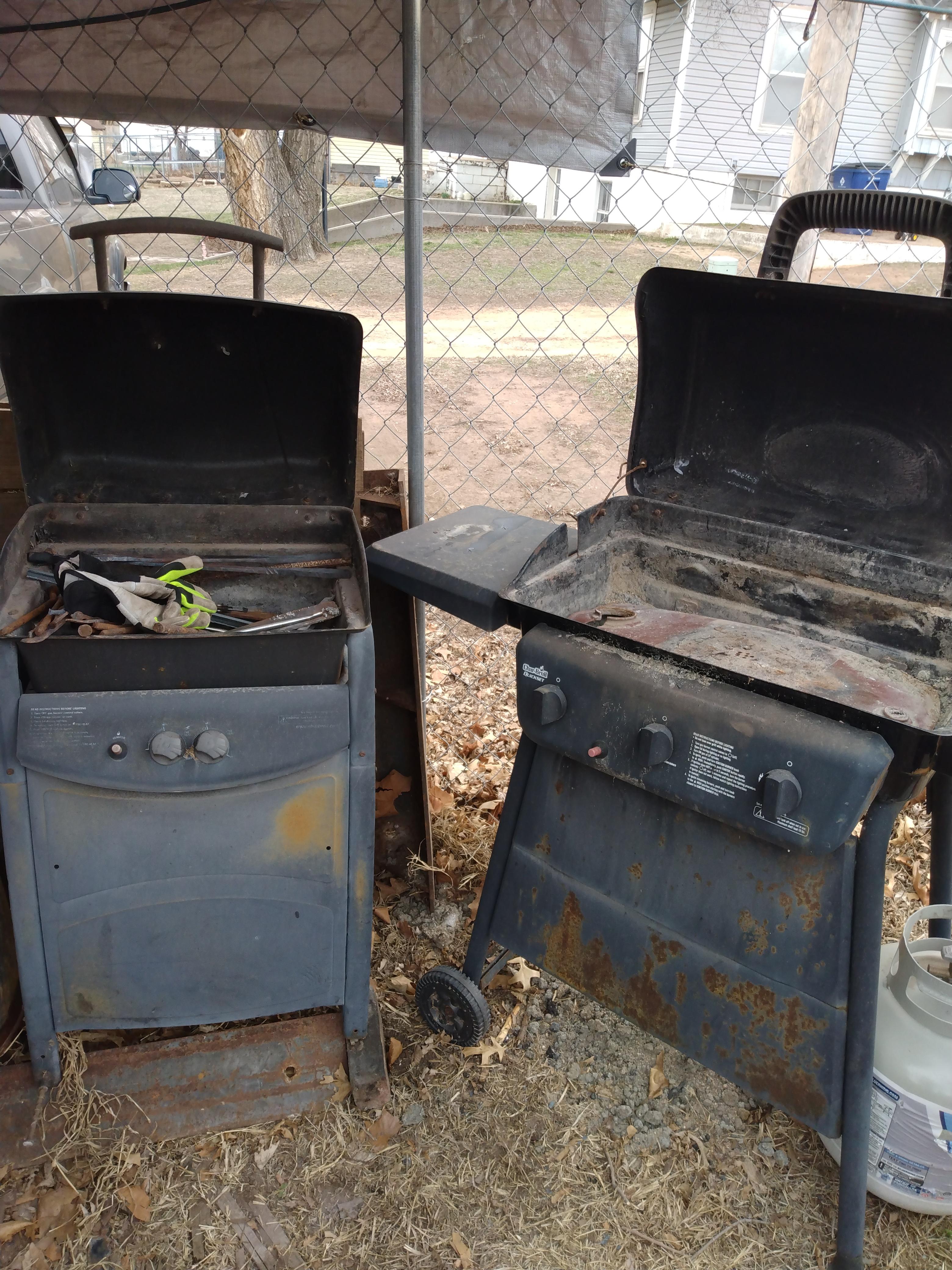

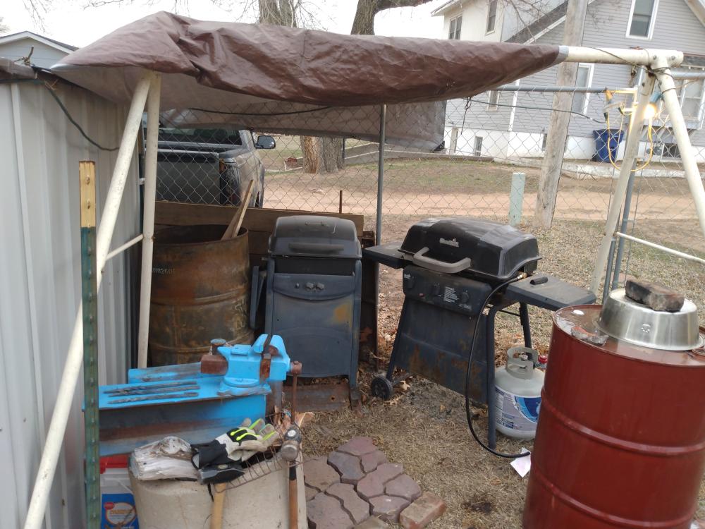

I had a busy day.  Reorganized the shop area, added some pavers, strung a tarp over the top, and re levelled the anvil at the correct height. Then I started to try some tent stakes out of some cheap rebar.  I need them to re set some landscaping border since the old stakes pulled out over the winter and let the border plastic flop about this past winter.  Also re seeded the lawn and planted some watermelon and pumpkins.   Anyway the first tent stakes looks like I wanted.  The other two I got started but I got too tired to complete.  Turns out I'm more than a little out of shape.  Also, the new propane forge heats fast enough that my shoulder didn't rest enough between bouts of hammering.  Also finished cleaning out the two empty grills to use as a place to keep tools dry, the forge dry, and work in process dry.IMG_20230305_173928661.thumb.jpg.17691896919b94ed9cc3f76940424757.jpg
