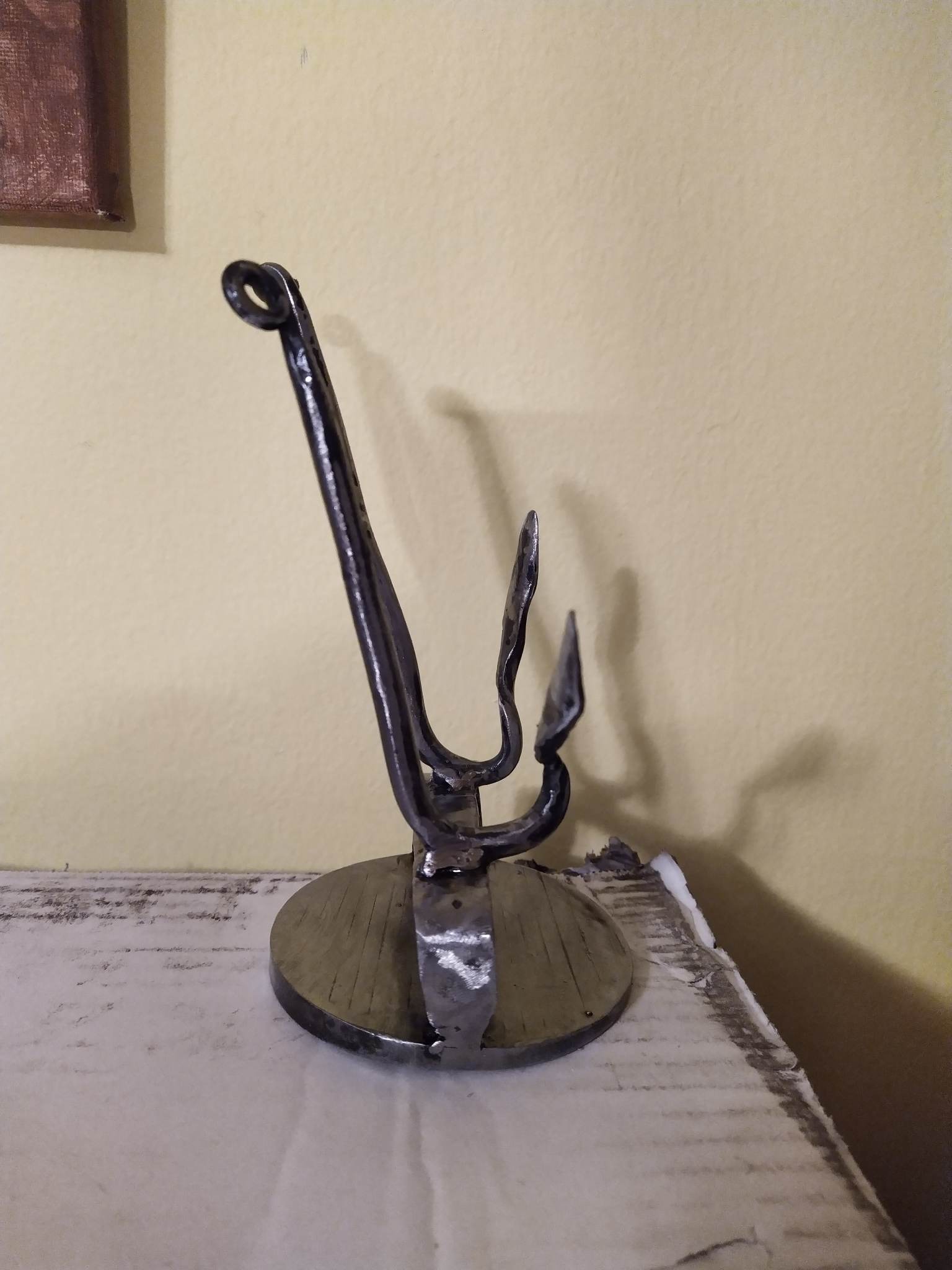

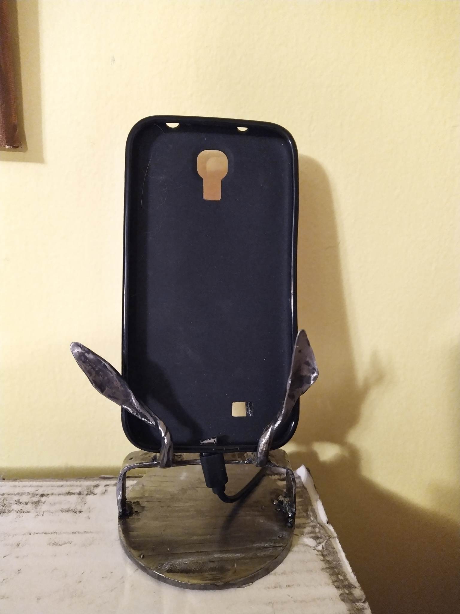

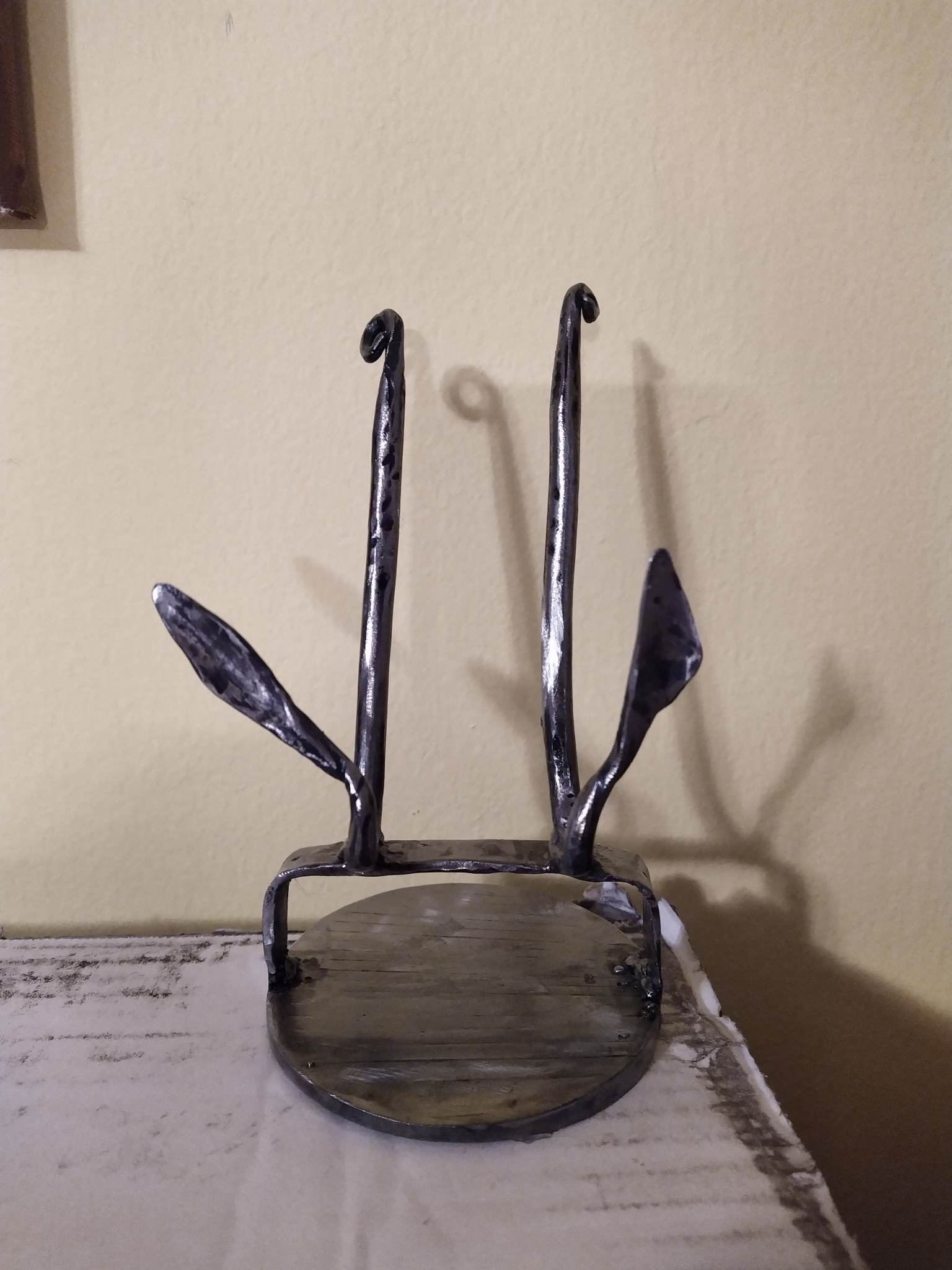

I finished the phone stand for my wife last night. I had sent her 3 or 4 ideas and this is the one she liked - "J-style". The original J-style design was made all out of one piece and had lots of bends back onto itself. She wanted "less bulk" and asked if I could just do the two sides separately and then weld it to a base. I sent her an in-progress shot and she reminded me she wanted room for a charging cable to be connected while in the base - so I found another piece of scrap bar, pounded it flat and bent it to make a 'table' of sorts to raise the pieces up.
I'd do a lot of things differently if I made another of this style. But she's happy to have this one and that makes me happy too.
