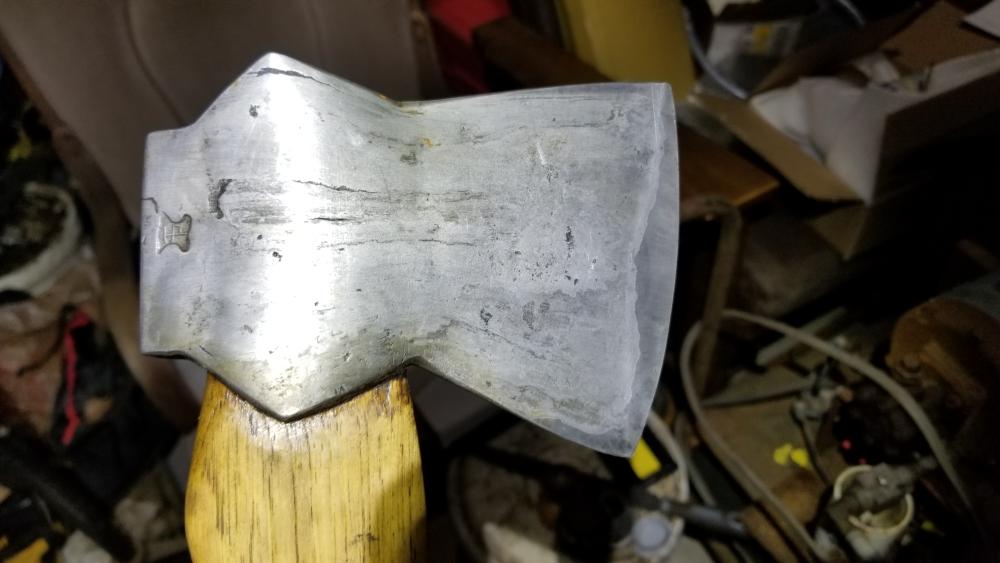

All of my own personal tools (felling, limbing,) were designed with a pre shape.. (pre shape=about 30 sharpening)
The pre shape accounts for wear or about 30 miss strikes on the ground.. The top edge on most axes is missing and this pre-shape accounts for this higher wear area.  Also helps with leading edge cut in and fine work.
First photo it's hard to see this leading "wear edge" 2nd photo is easy to see. also makes it easier to use when making kindling.

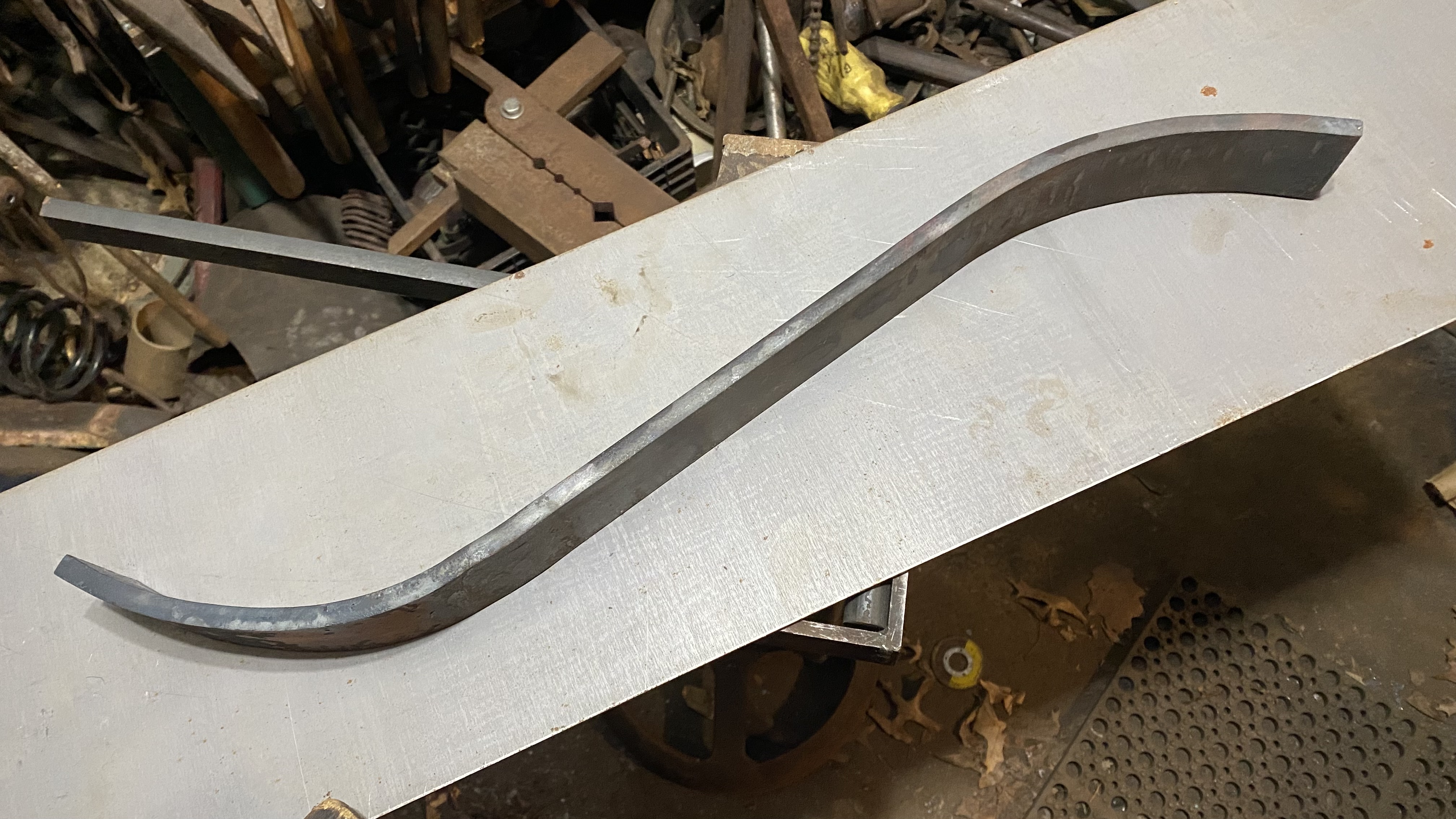

A few bits and pieces. The curved ends of this bar will be the two sides of a radius block for the Hossfeld bender.

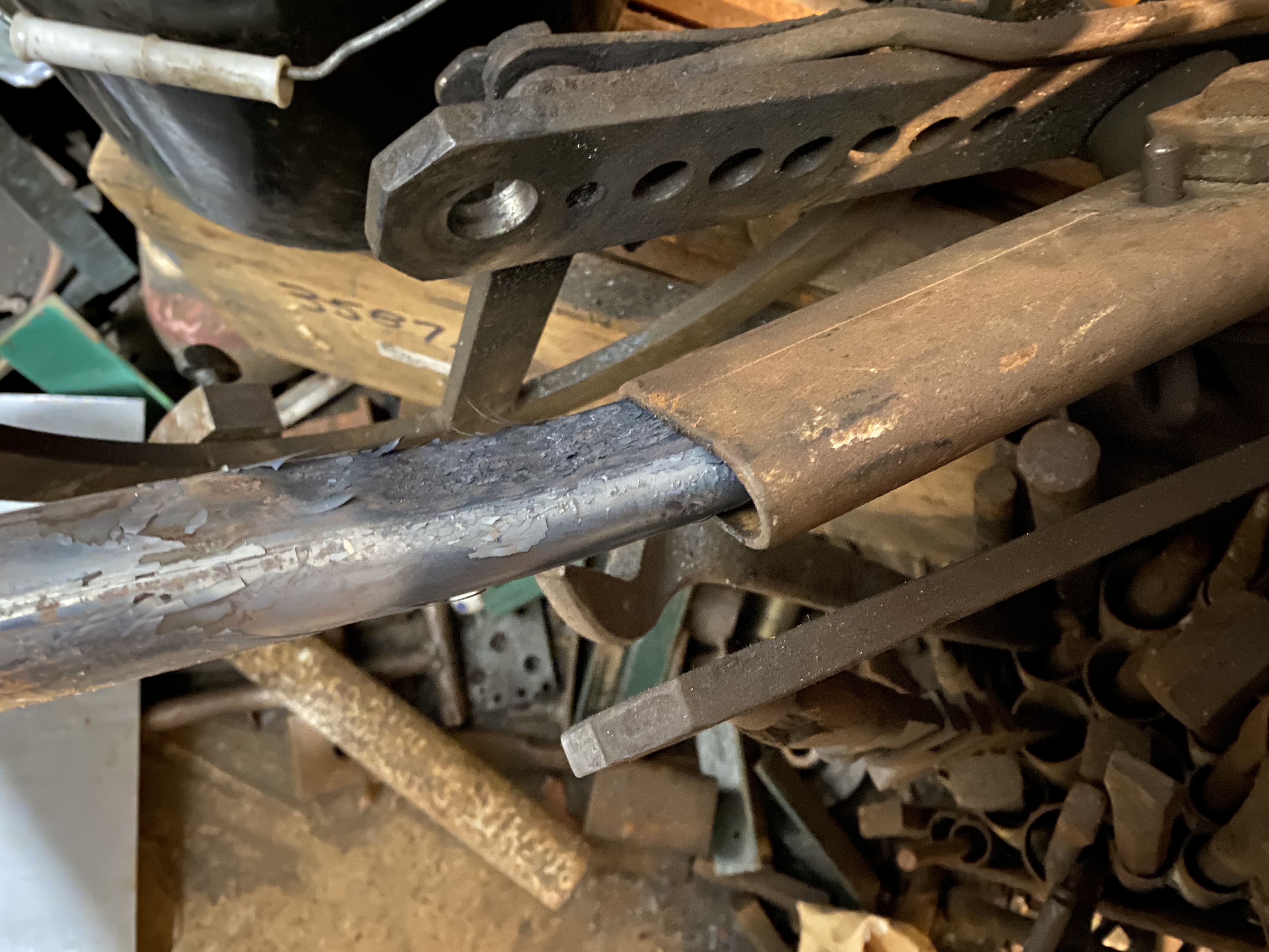

Started flattening a piece of pipe for the Hossfeld’s handle extension.
The fly press works very well for this.

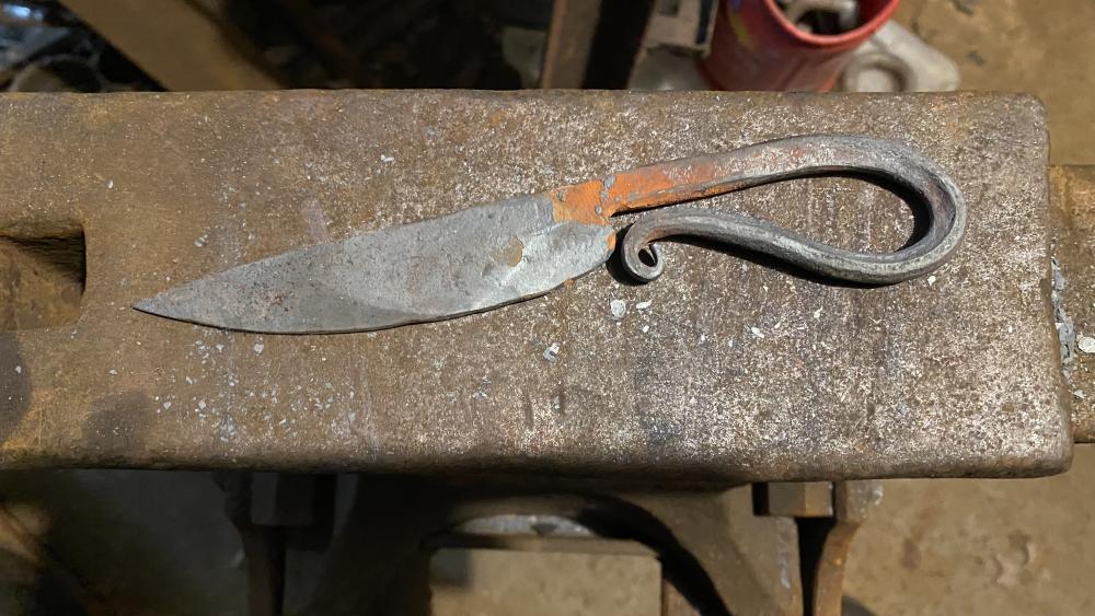

One of my students left this knife behind when she graduated, and I’ve decided to finish it and send it to her. The blade was forged and the handle drawn out; I just did the bending and rough grinding. Next step: heat treatment and finishing.

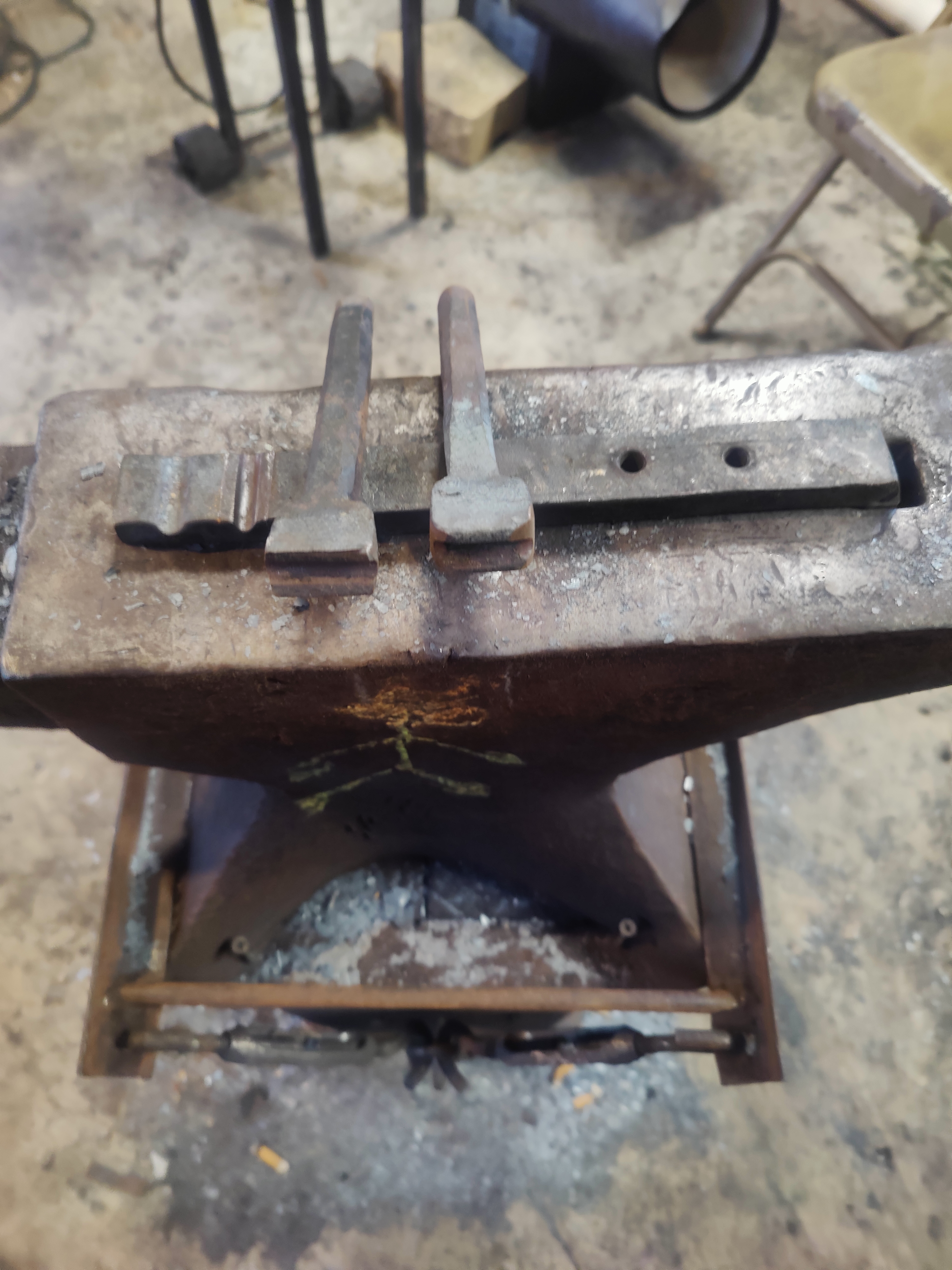

Shaniaru, i tried one of them gate latches not long ago. Since i was not doing for a grade i did not make a staple for the hook but a second plate for it. The shaping and bending was not to difficult but staying with the print and making it to specs was the hard part.
I made these tools to help in making it as well. And help they did. A piece of 1" x 1/2" bar, bent the one end over to fit my hardy. Then put 2 bottom swages in it 1 is 3/8" the other 1/4" they come in nice to get any lumpy bumpy spots our and to get the tenons sized and nice and square. 2 top tools, again 1 is 3/8" the other 1/4", the 3/8" is useful for doing the top of the squared staple, the 1/4" i used for sizing and adjusting the tenons. Then drilled 2 holes , 1/4", to hold the staple in place while i worked it. I made the bottom part a bit bigger than i needed so that if at some point later i wish to do more of these out of different sized stock i can add swages and holes of different sizes. If you have watched Mark Asprey's videos you should know how these are supposed to work.
I found the project to be fun and challenging. It is really an exercise in figuring out how much material you need is what i have found. Have fun with it and good luck.
