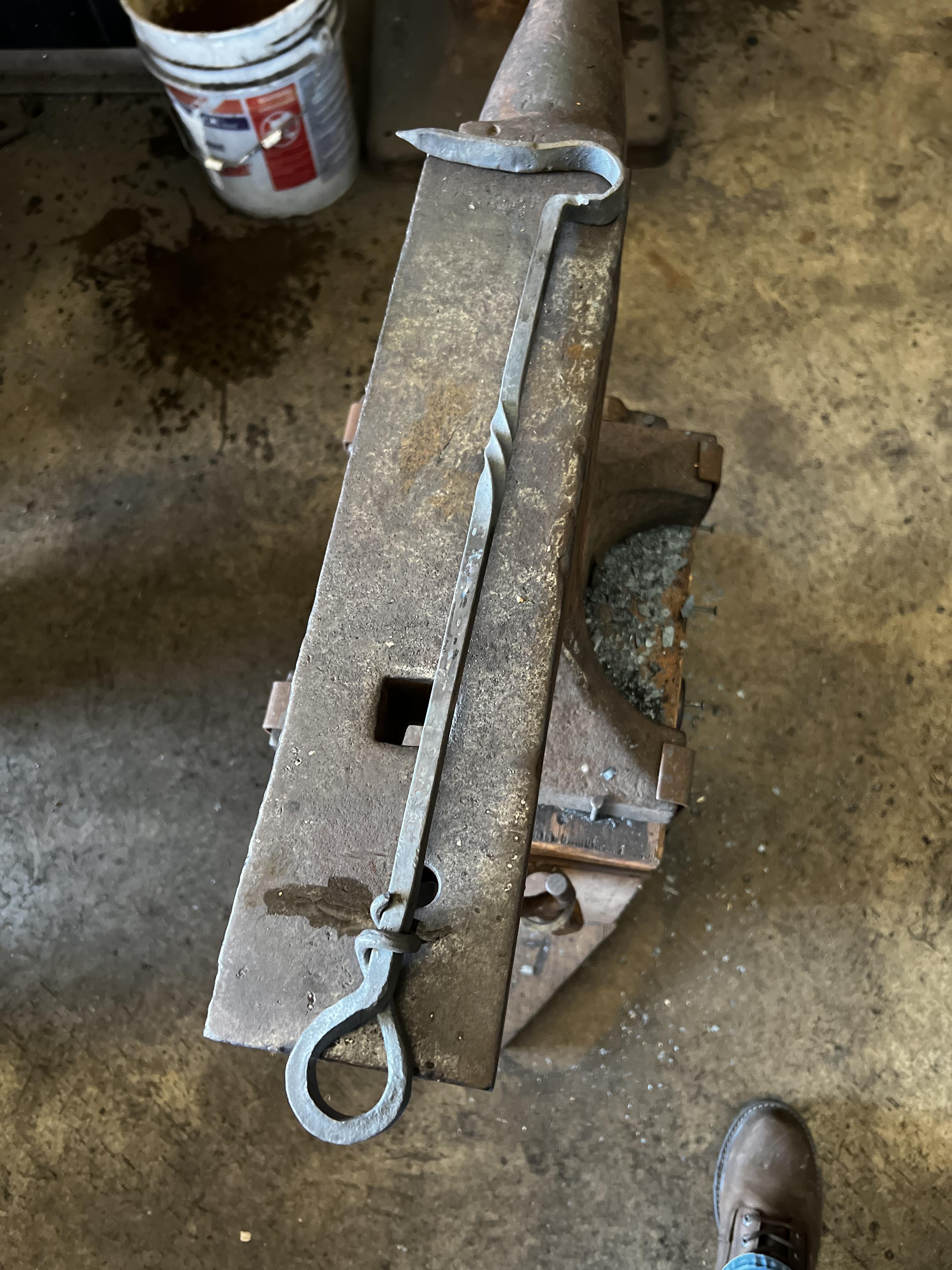

I had a chance to fire up the forge today and started out making a couple of tools from some e clips I was given. First time working with them and found out that it’s some tough material, then made a flower and J hook for my wife.

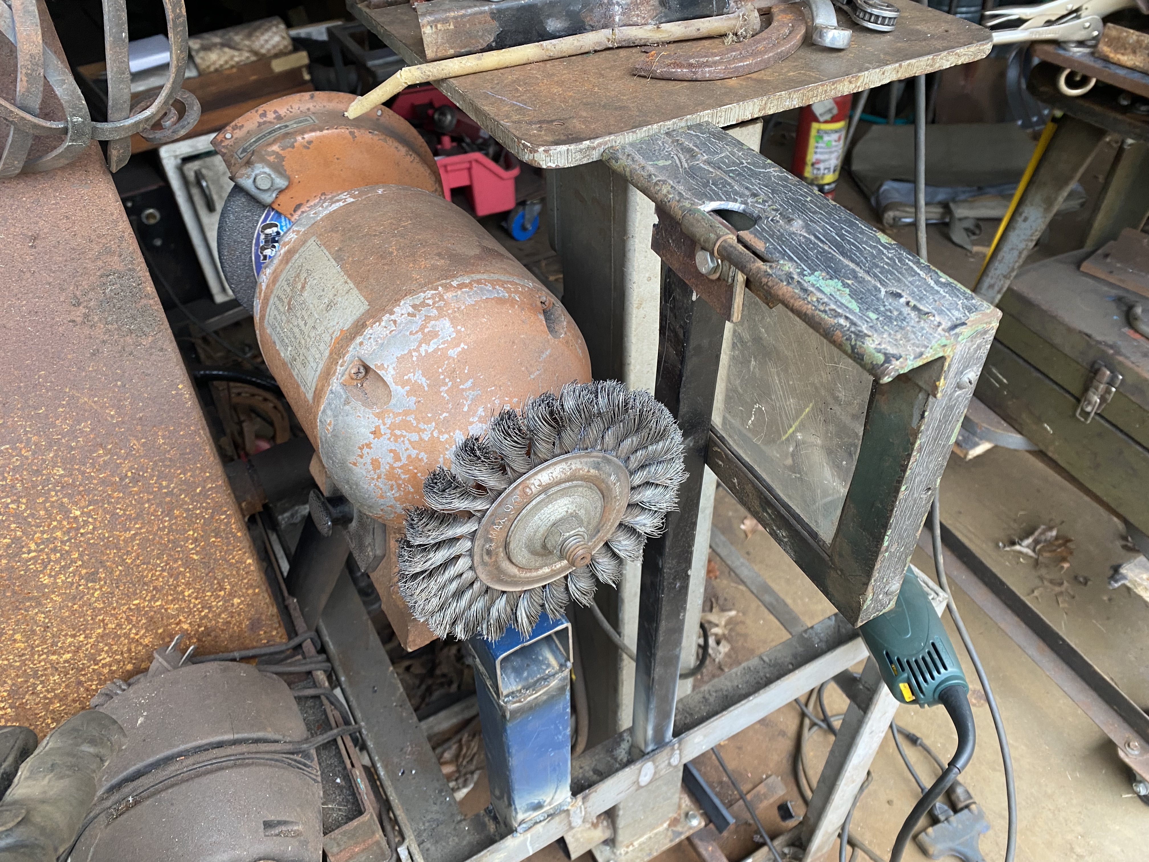

Spent a lot of time cleaning and reorganizing the shop, with limited success. However, I did make some time to add a guard to the wire brush.
This is supported at the back by a hinge bolted to a vertical post (itself welded onto the main frame ) and on the side by resting on the grinder motor.
The hinge swings out of the way for ease of changing the wheel. By the most amazing coincidence, the guard is below the level of the belt grinder’s table, so they don’t get in each other’s way.
The guard was in a box of random stuff I picked up at the industrial surplus place a few years ago and wisely did not get rid of!

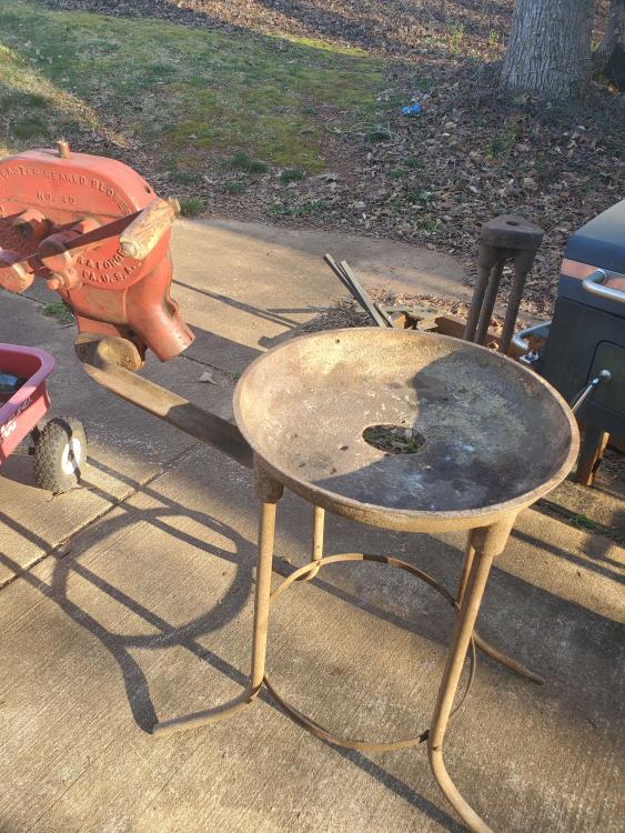

Picked up this rivet forge on the cheap. Started getting parts forged out for it (and tools to get those parts made) recently to try and get this up and running for my travel / "history adjacent" demonstration forge. The blower was a little tough to get going physically but tightening down all the set screws took the play out of it and chainsaw oil lubed it up just fine. Looking forward to finishing this one. The butcher tool was forged out of an old garage door spring. Despite all the warnings, i went ahead and hardened it in water then tempered it back to purple. I used it to cut out the webbing left behind by rough drilling the shape of the grate / tuyere plate.
Looks good.  The blower sounds a little rough, probably lash in the gears, but it windmills fine which, to me, incicates a good, usable blower.
Once you get it all connected up make sure you have provision for an ash dump.  This can often be made from a plumbing T, mounted sideways with the air coming in the bottom of the T and out one side of the top with the ash dump being the other side of the top with a sdrwed on cap to be removed when dumping.
Im looking forward to finishing it. I've built lots of solid fuel forges which makes me familiar with the design. I will be posting more pictures when i get closer to finishing it. The gears look good. I suspect the rattling is due to me only finger tightening the blower to the arm. its just vibration.

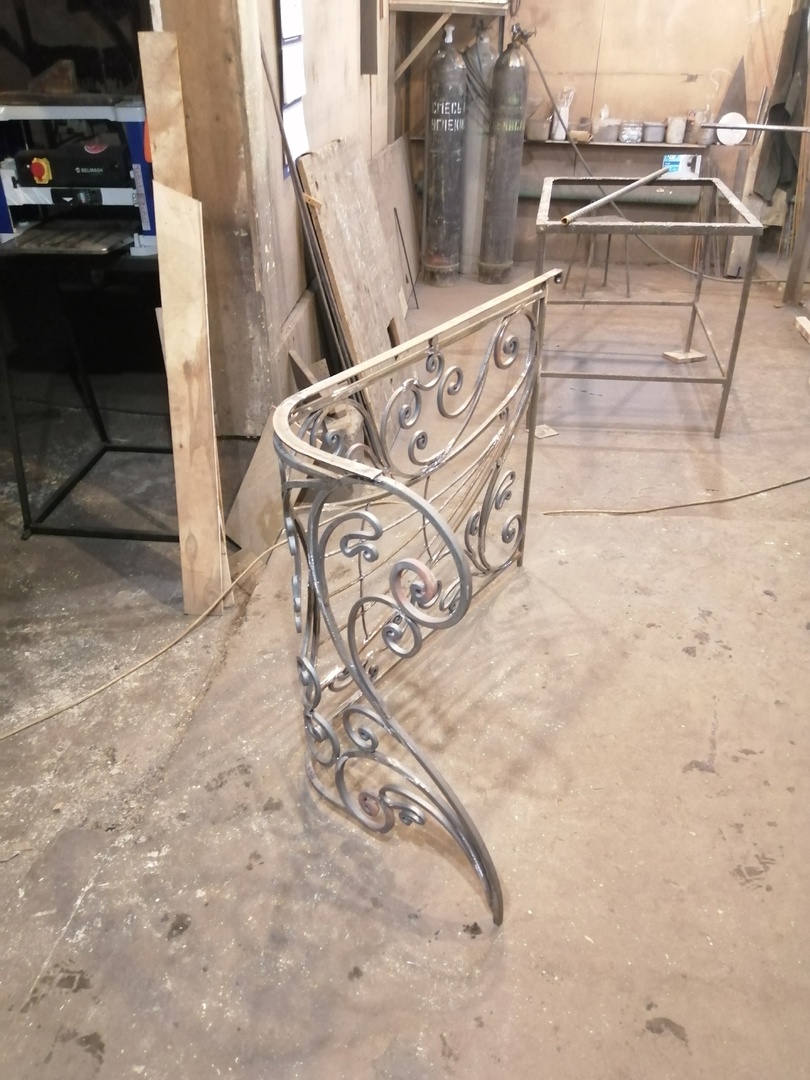

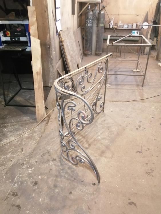

Local friend hurt their back so I went and helped out Saturday. Shaping 3/4 by 1 1/2 bar into railing on the power hammer (Anyang equivalent).Bottom die to flatten widen and round one side of the bar. Just rough shaping to help out. Also straightened some work on the hydraulic press, easier with two sets of arms and eyes.
A couple of youths were in the shared space for art class, my friend saw "the spark" in the older one's eyes and (with parental permission) proceeded to show basic pointing and twisting skills to the two. Nice little encouragement in the craft and fun to watch them teach while doing grunt work in the background.
I learn so much helping out pros!

I like that rivet forge, Duckwalk.  I’m envious.  After using a coal forge this weekend, I want to get one to add to my gas forge.

I haven’t done anything of significance out at the forge lately. Certainly nothing as good as that stair railing.
