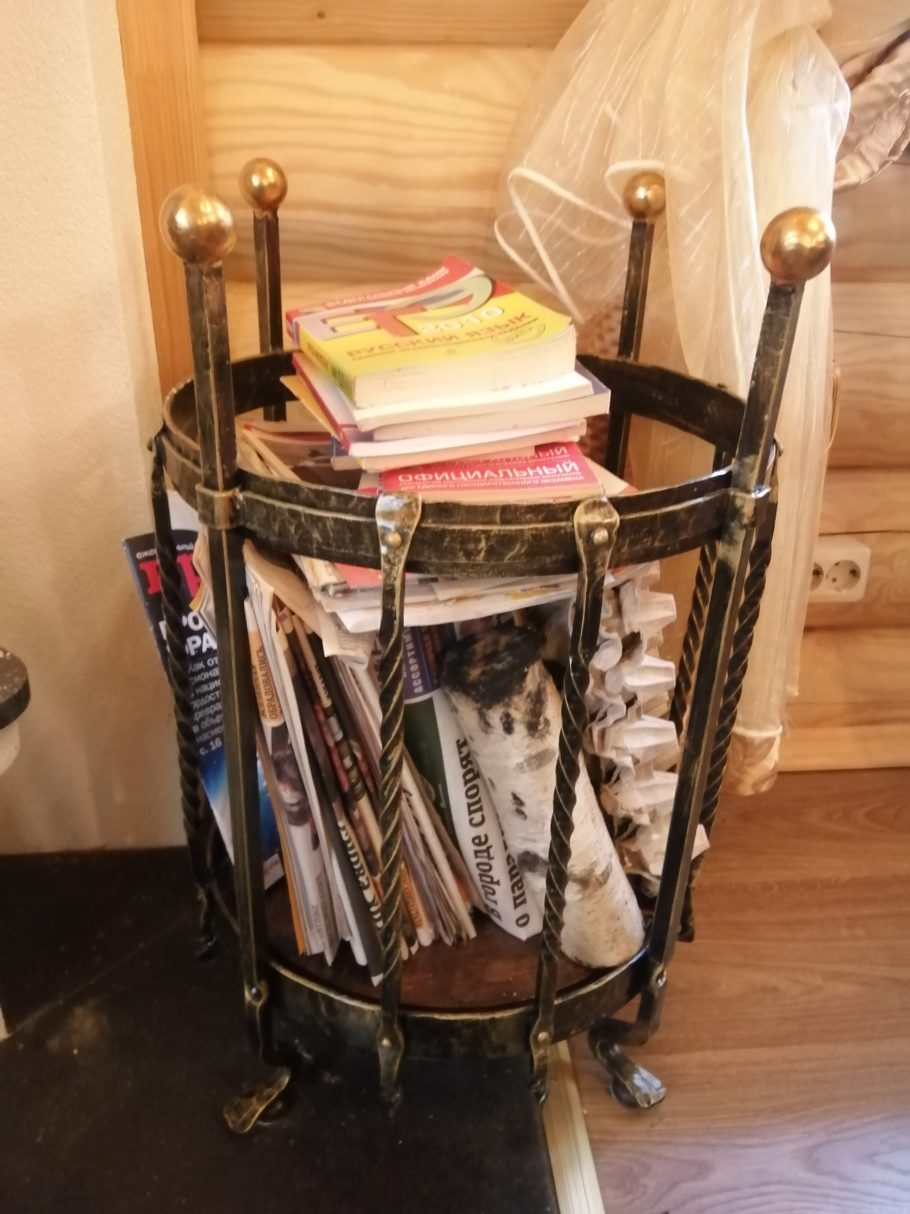

15 minutes ago, George N. M. said:

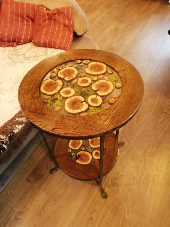

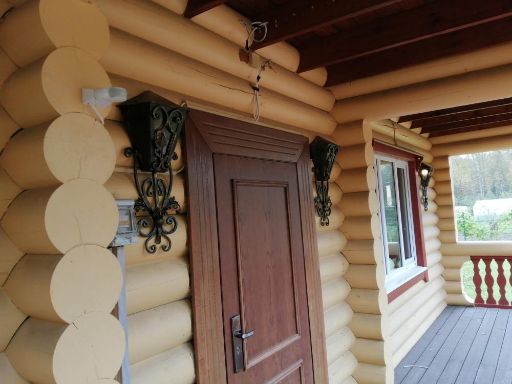

Does Russia have the custom of taking off shoes before you enter the main part of the home like they do in Scandinavia?

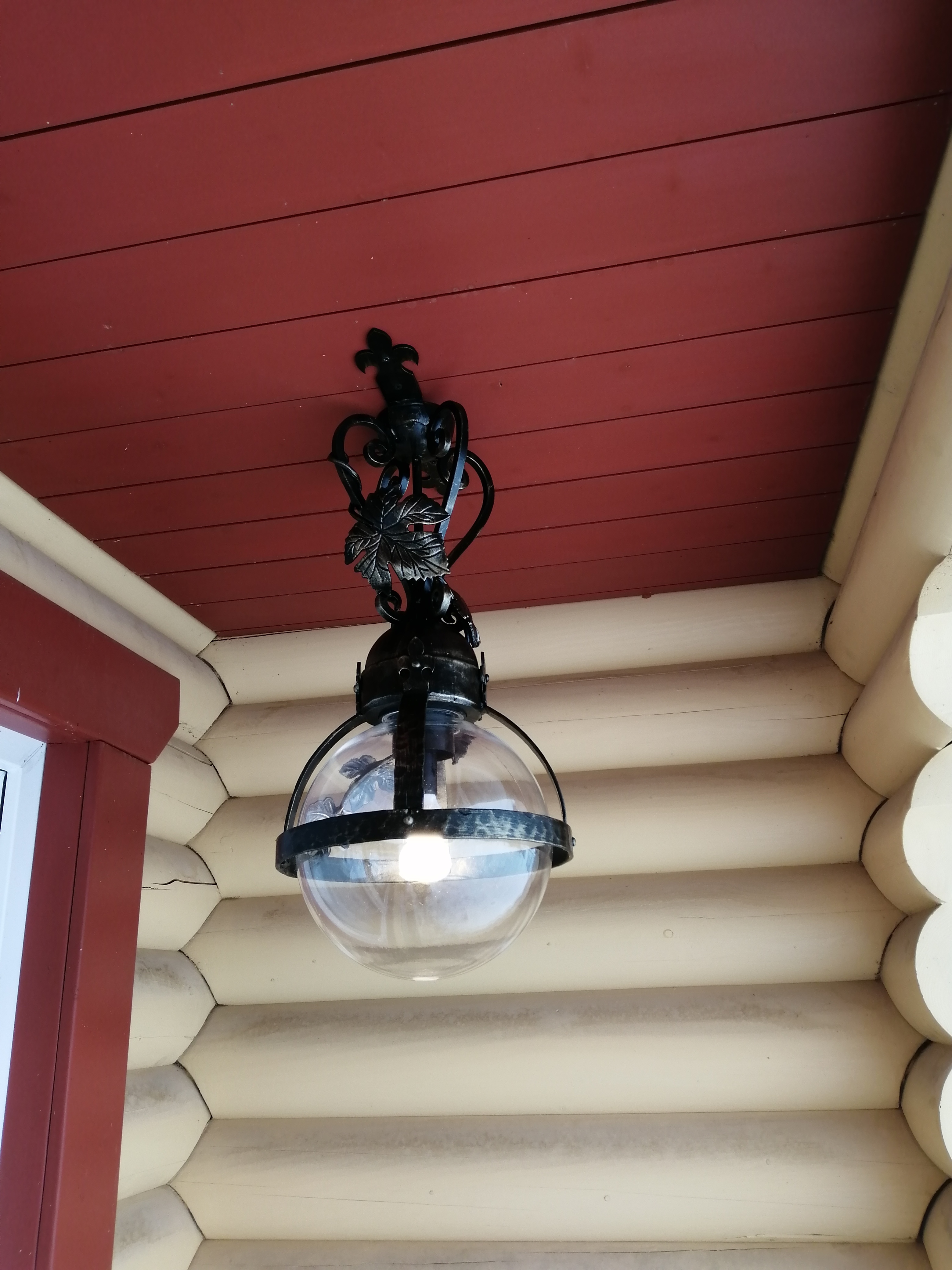

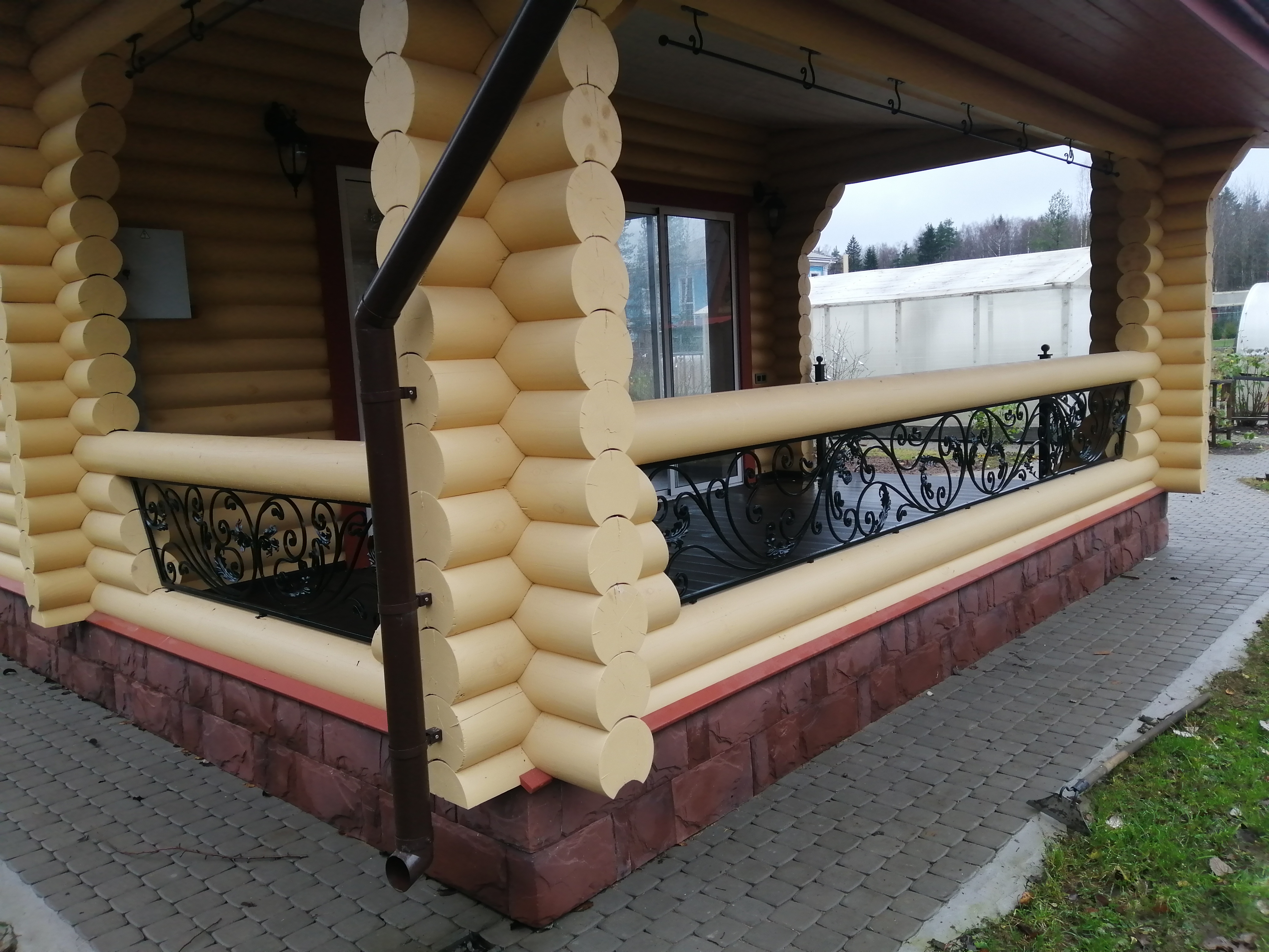

Thank George !
This is the customer's house. Big estate. I have been working there for several years. It is customary for us to leave shoes right at the door, indoors.

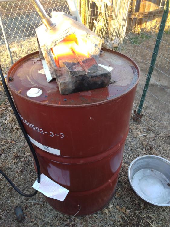

I'm almost out of round stock and my steel yard is currently closed on Saturdays,  which I just found out today...

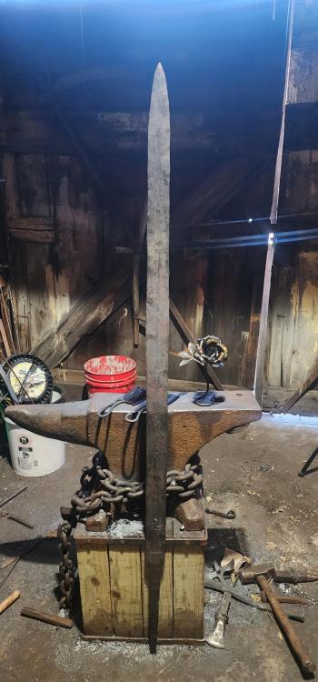

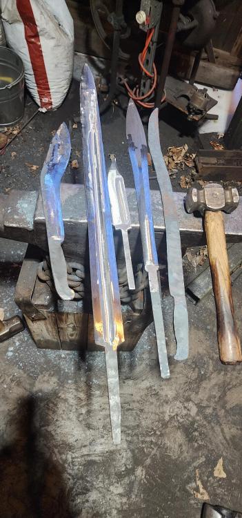

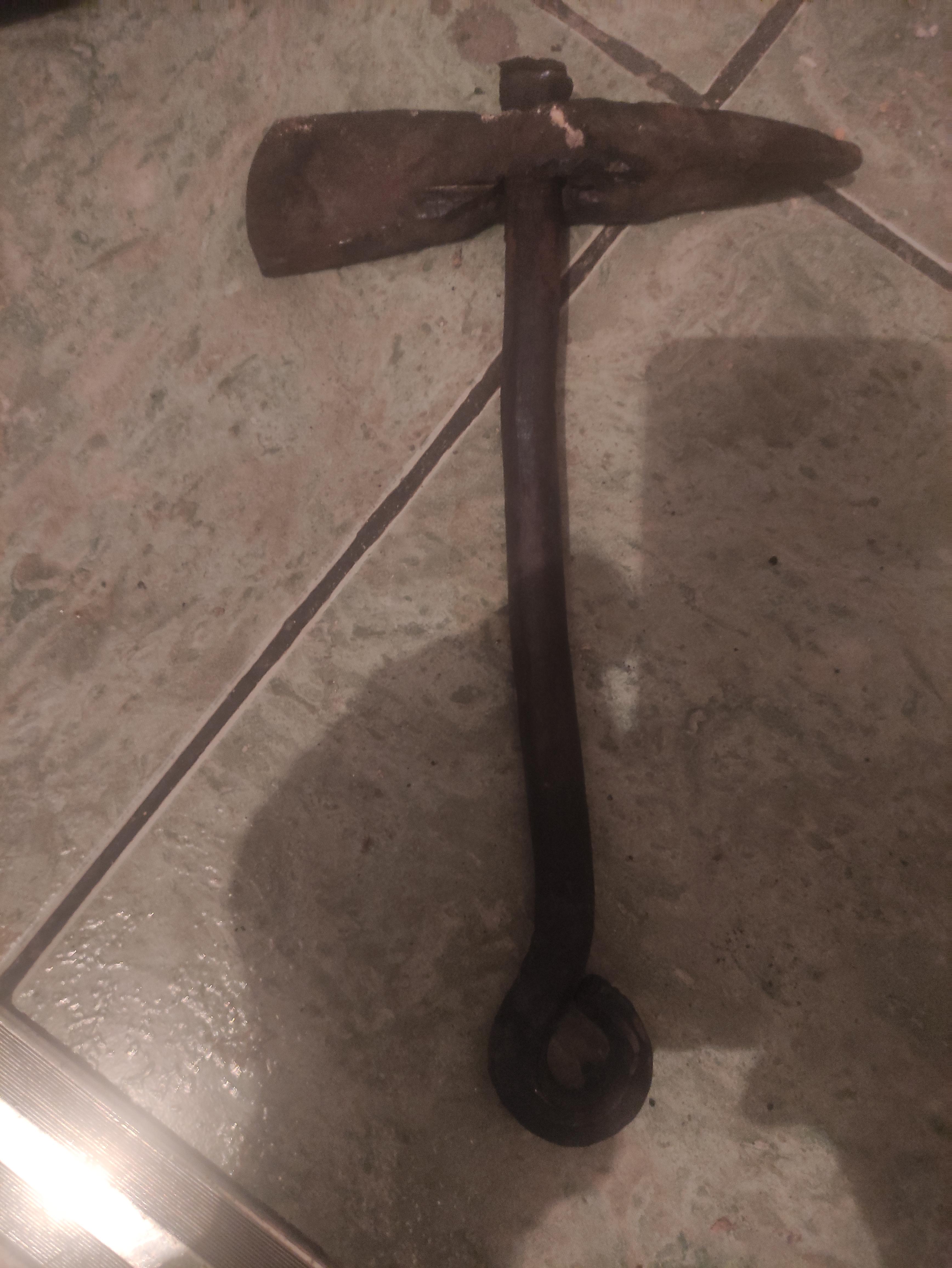

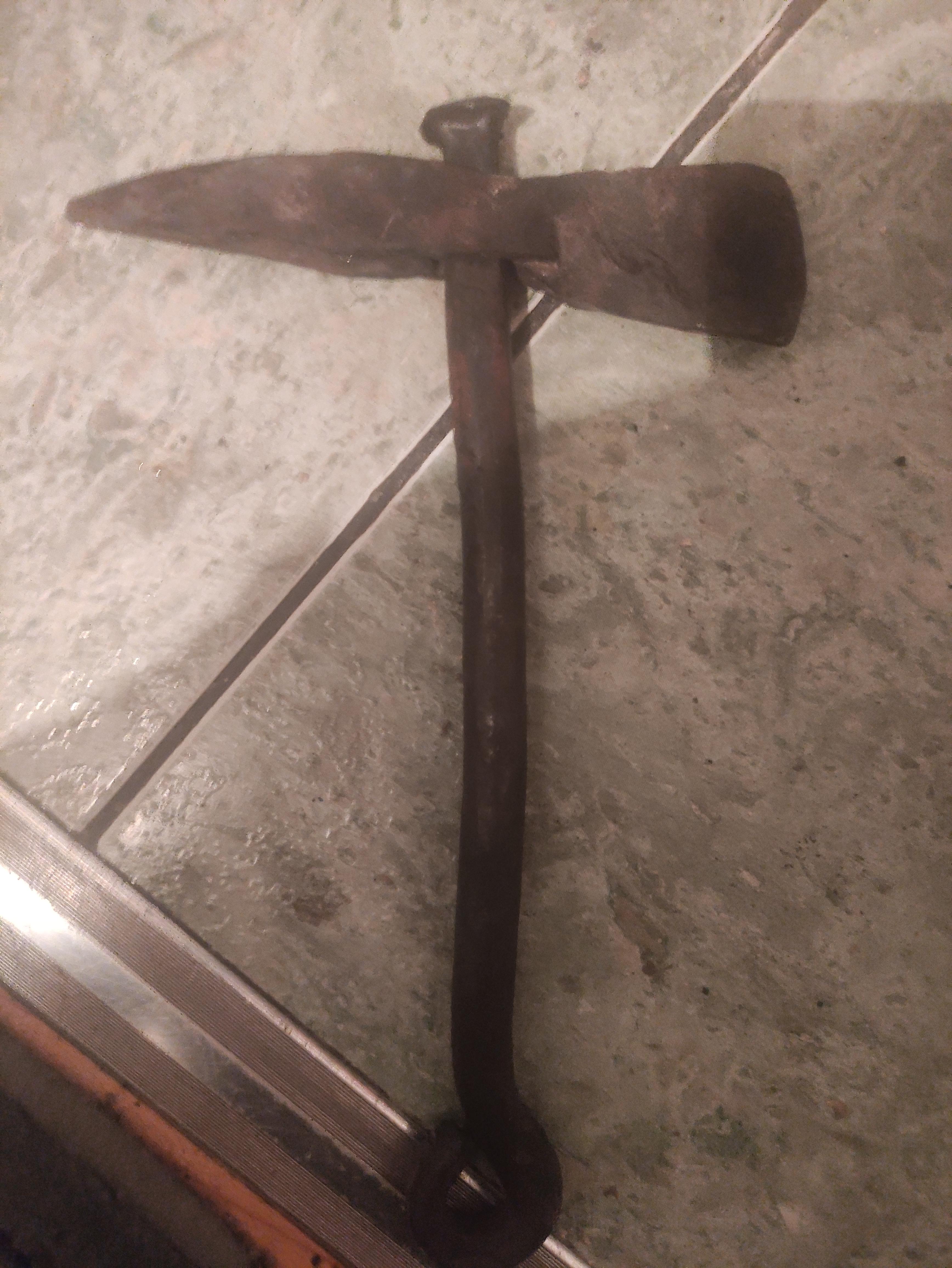

Anyway it's been a blade day.  I have several that have been leaning against the wall along with a new arming sword I just started.  I think I may start normalizing for a heat treat today.  Well, at least the ones that can fit in my oven.
The kukri actually started as another xyphos that I messed up the handle.

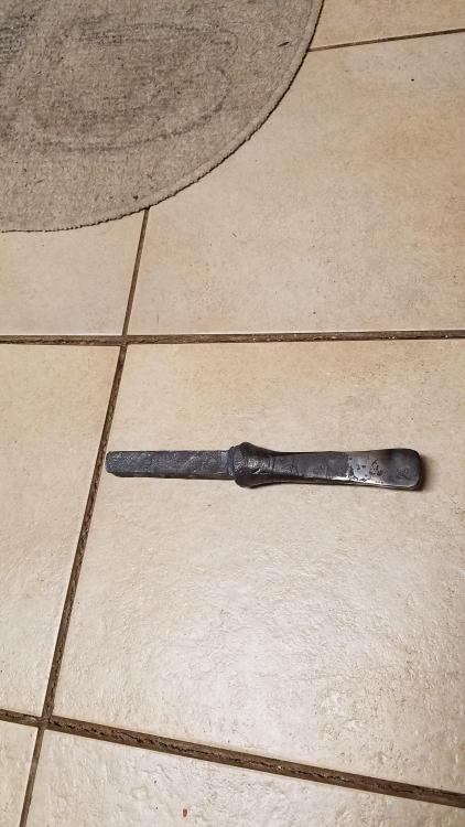

On 2/14/2023 at 8:38 PM, Irondragon ForgeClay Works said:

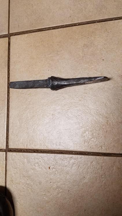

I started an anvil hardy fuller that Debi wanted for making the Russian wrapped roses.
Finished the fuller. The stem was a little crooked and needed hardening and tempering. Made from 4130 sucker rod end. Hardened just fine in peanut oil and tempered back to blue.

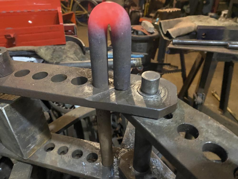

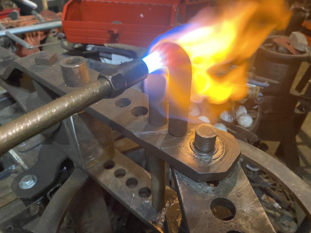

Got a bunch of stuff done. For starters, one of the missing pins for the Hossfeld bender (for which the oxypropane torch came in handy):

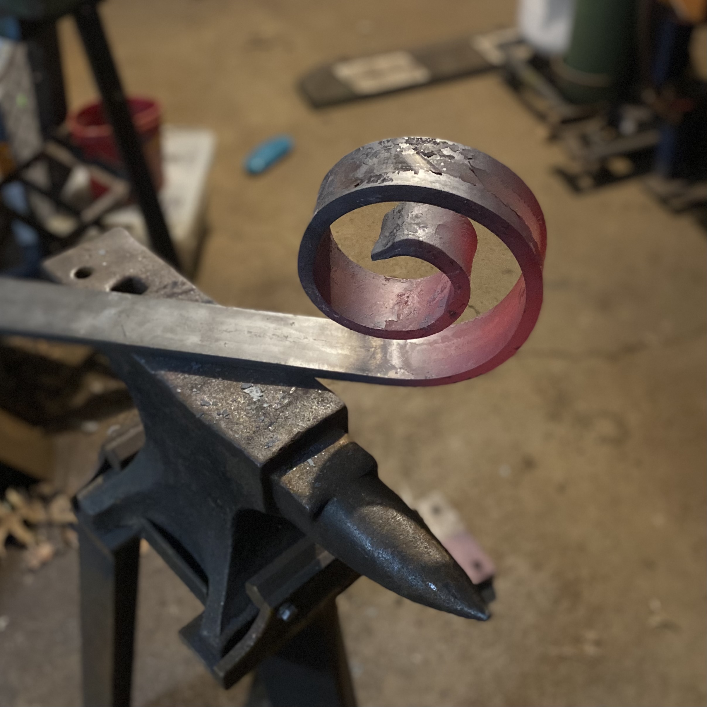

And finished with a honking big scroll in 1/2” x 2-1/4” flat bar:
(For scale, that’s a 145 lb. Peter Weight.)

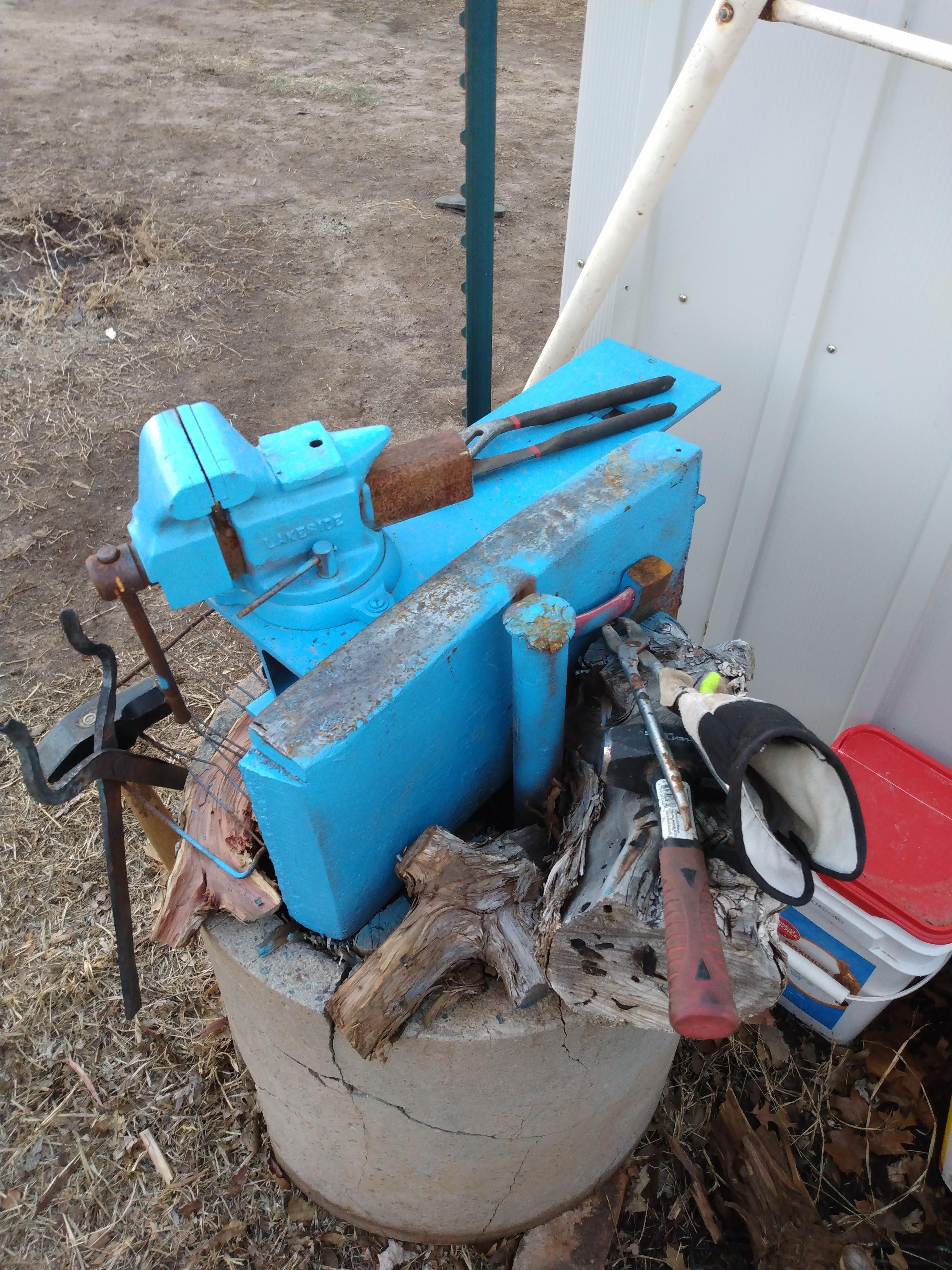

Addendum: the combo hold-down/stand came in very handy for holding the plant hooks for punching.
6 hours ago, Irondragon ForgeClay Works said:
great looking twisting wrench
Funny you should mention that. I was using it today to tighten bolts on the post vice, it slipped and smacked me in the face HARD. Wrong tool for the job, totally my fault, but dang! Why do my life lessons have to hurt so danged much?!
The right tool for the job definitely has its advantages.
With tightening bolts, compare an open end wrench, a box end wrench, a 6 point box end wrench, a 12 point socket, and a 6 point socket.  Look at the length of the handle for each.  You decide which is the right tool for your job.

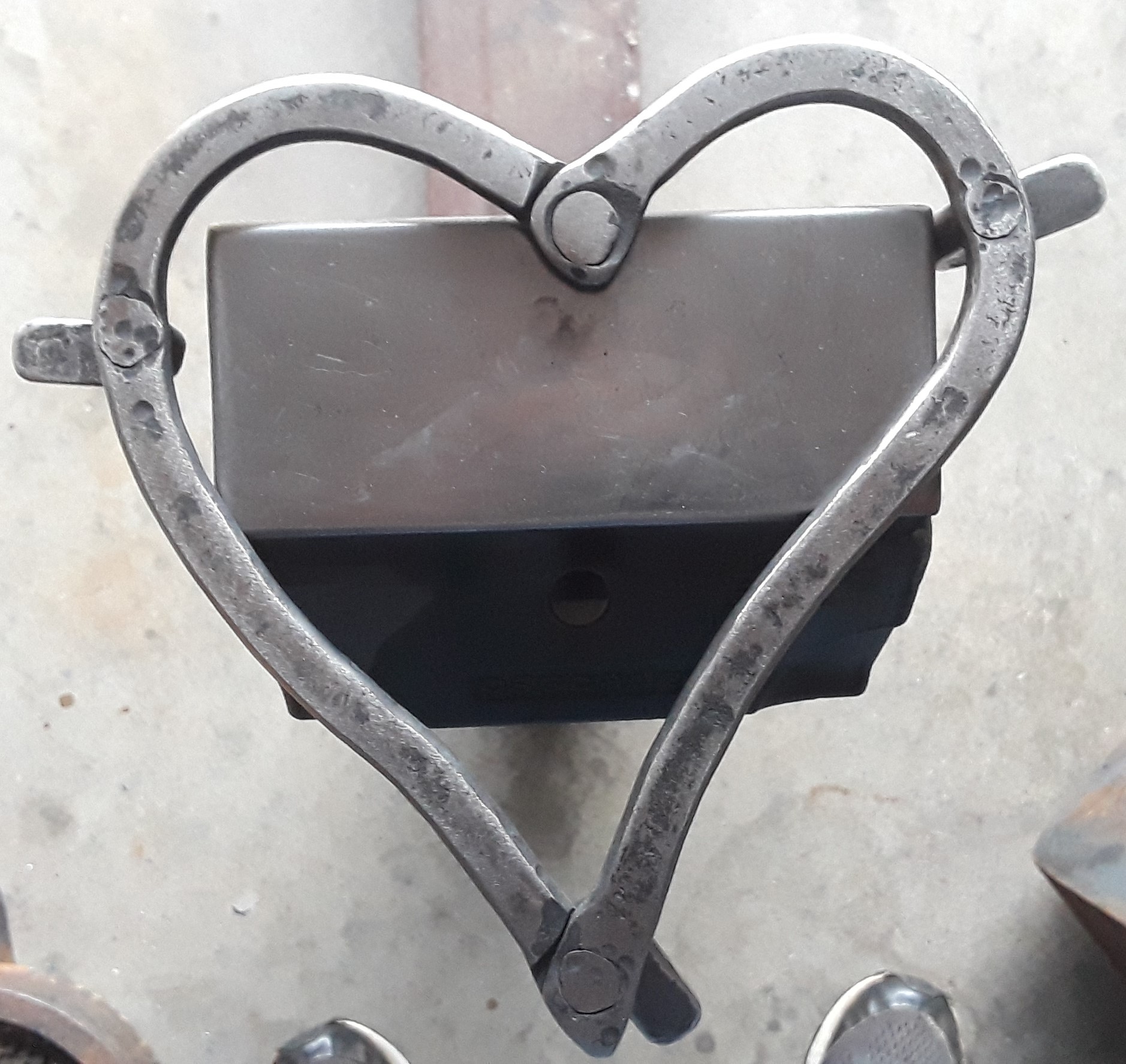

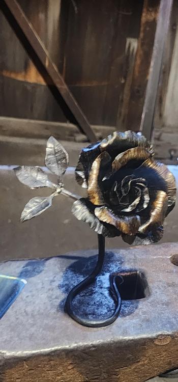

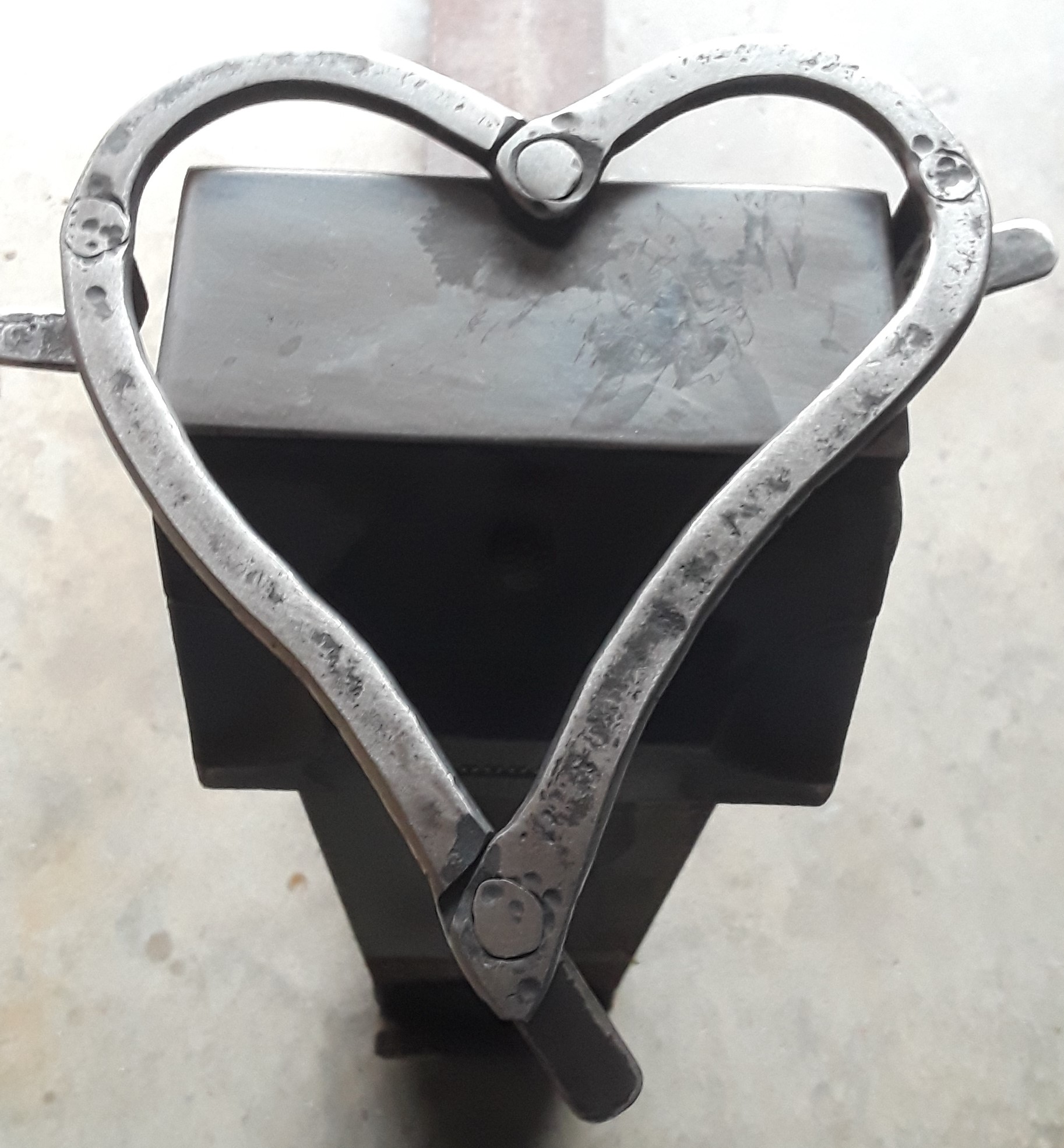

Finished banging this out for Lori's Valentine's day gift.  Only two weeks late, which is good for my typical timeline.  Made from stainless steel, unknown type, half inch round stock to start.  Still some tweeking and cleaning to go.
image.thumb.jpeg.5126c2b297b50741758b246ff55aedb6.jpegimage.thumb.jpeg.ba5a580e490344ed0885344fc1c93aca.jpeg
For perspective of size, the forklift tine upon which it rests is 6 inches wide.

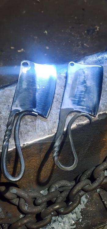

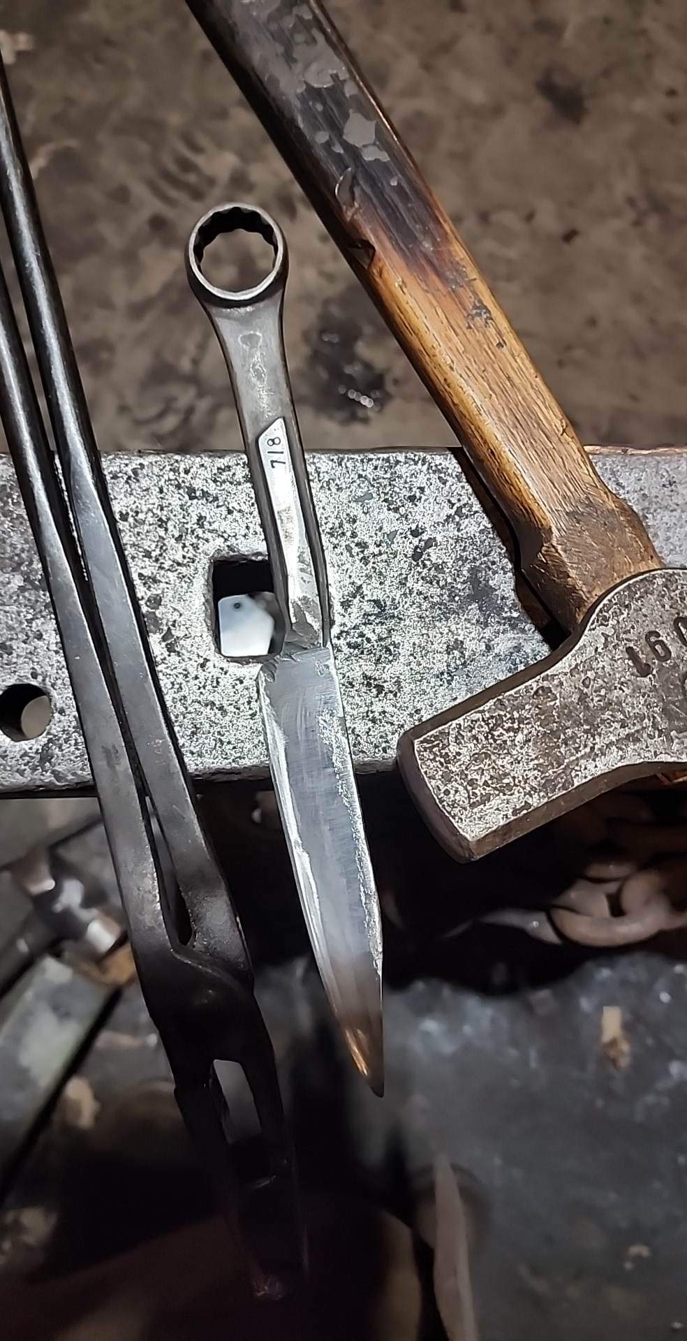

Chad, those look great! Hope HT goes well! Also, wrench karambit a are a lot of fun, and a good challenge to get the urge right. Goods, that’s a comfy looking handle.

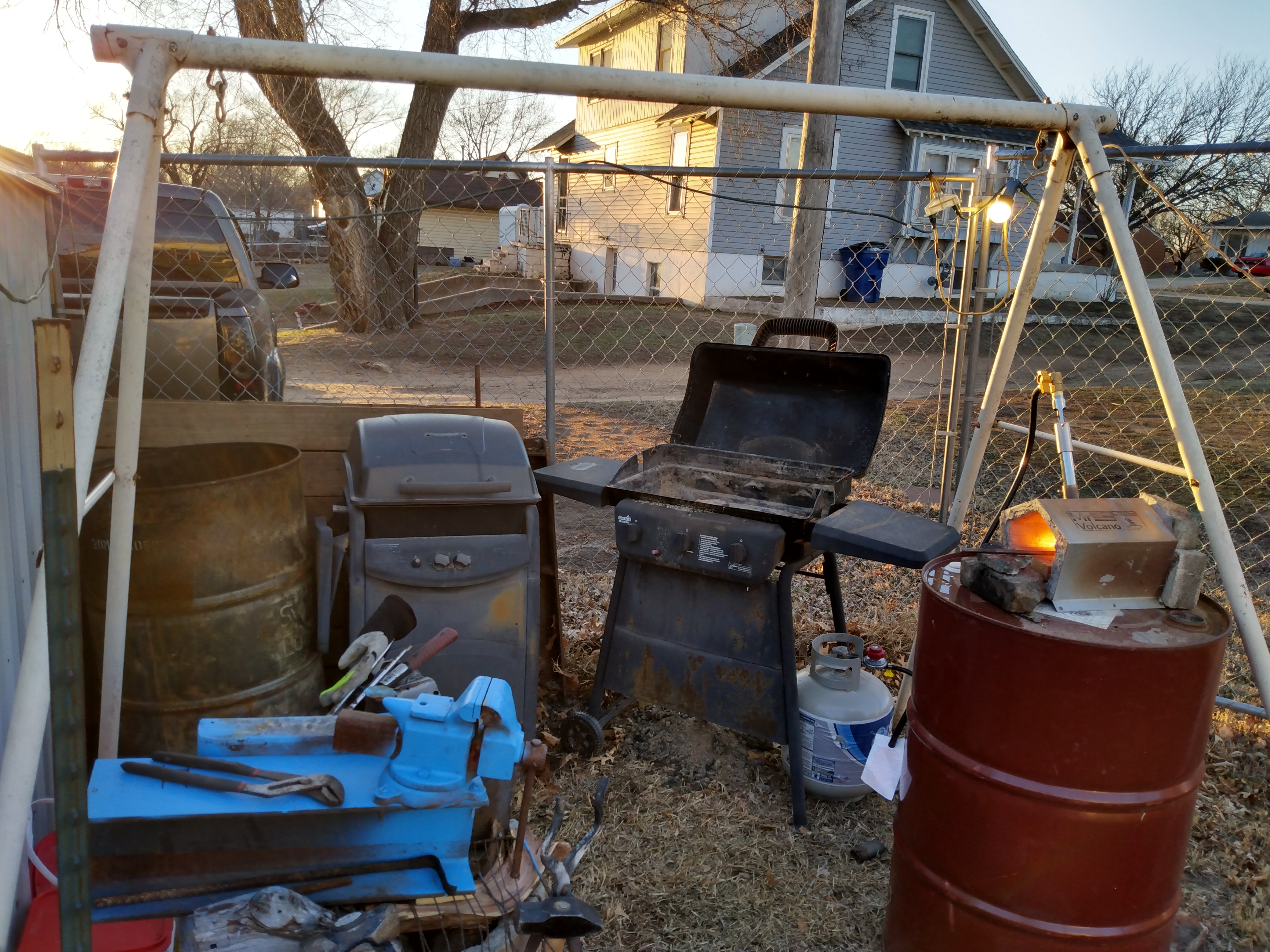

So I completely reorganized the shop area today.  I have a good wind block on two sides.  And spots to spread a tarp over the top in case of rain.  I then lit the forge and and was trying to get back to making leaf key chains.  What sucks is I broke two of them at the stem before I quit for the night
