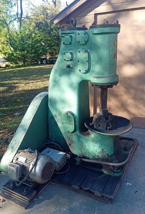

First, much apologies for this verbose post. Sincerely! anyways... Had our first "Forge Friday" with the new functioning hammer. It was a success that I'm very pleased with, but not 100%. There are three problems that I'm aware of so far. Fortunately I am a machinist and can address them. If a guy had a different profession, these problems would be much more disappointing. Not that I'm not disappointed, but much less than if my options were fewer. 1) the lower anvil (called the "anvil cushion" in the manual) is acting... strange. Not with the hammering, but rather with die alignment. It was missing the retaining pin (centered underneath inside the slot in the die), so I machined one. Once inserted, the lower die was misaligned (offset) lengthwise from the upper die by about 3/8". At least now I know why the alignment pin was lost in the first place. Measuring things, I verified that the spacing of features appeared to be centered on themselves as they should be, i.e. both on the dies and the anvil. Yesterday after using the hammer for a while, the offset had reduced to more like 1/8" which is just odd and I haven't yet looked into it enough to know how this has shifted. It seems obvious that somehow the anvil must be moving, but I don't know enough to know how that is even possible. I'm halfway hoping that the bore the anvil (cushion) is fitted to has a fair amount of gap which I can address. Also, I'm assuming (hoping) that in the original manufacture of the hammer, the ram and anvil bores were kind of "line bored" to be located on the same line axis. I did verify that the casting is not cracked or anything (fortunately). 2) Stacked upon this, the dovetail for the dies is dorked up significantly. The bottom face seems decent, but the fixed side is pretty beat and also doesn't match the side of the dies well at all (7° spec in the drawings). This of course leads to the die working itself loose fairly quickly in operation as the fit of the dovetail/key is just not good. Way less than even 50% contact bearing. Seems my solution to this will be removing the anvil, building up material and machining it back to where it fits well again. Not a trivial job, but it's in my wheelhouse so I can do it. 3) related to this but somewhat separate, the dies themselves vary in spec. or in fit I guess. The flat die is almost 1mm (.040") narrower than the other 4 sets of dies that came with the machine, which is enough that the key doesn't even begin to fit the gap of the other dies. The crate of 4 other dies all seem to match each other fairly well, so it's the flat die that's out of spec. The flat die is also bungled up on both the dovetail sides and bottom and top faces, so it could use a complete tidying up. The other dies have seen little to no use and all seem to be in good shape as well as matching in dimensions. So my plan of attack is: 1) inspect further and take careful measurements 2) remove the lower anvil and inspect deeper both the die slot and the fit into the casting bore, possibly machine soft spacer ring to help alignment 3) close inspection and measurement of all dies 4) document all measured dimensions for analysis 5) repair what's necessary for as close as possible to 100% contact bearing of dies to dovetail fit 6) maybe manufacture new taper key to allow for use of other dies if necessary So it's a fair amount of work, eh? This tells me another thing, i.e. the rumors I've heard of this hammer having 100hrs of use are boldface wrong. This kind of damage/wear is almost impossible with 100hrs of operation. Not a huge deal in some ways, but at least another data point for my own records. Sooo, the good news - Upper die fit is pretty dang good. No problems there at all in both appearance and function of fit. The 7.5Kw VFD seems to drive the machine just fine. Big "Yaaay" in my opinion which saved my close to $3K compared to the remaining other solution. The hammer does indeed have (to me) amazing power to smash. Also it's painted green, so I may get out some paint and name-tag "Hulk" on it somewhere. Control is very good - basically exactly what you would want & expect out of a self-contained like this. So all told, I remain pleased to have acquired the hammer. Let me know what you think.

Hoping for someone with one of these hammers to be around here. Could be even a different vintage of same machine could be different, or maybe it doesn't matter either way? I just picked up and got running a 75KG (165lb.) Striker C41-75 hammer the other day. Pretty sure it's 2000 vintage (11/2000). Pretty happy with it. There are a couple details that I'm disappointed about, but easy workaround and shouldn't affect proper operation. First up though, the belt guard sheet metal on the back just happens to be missing the little plate showing correct flywheel rotation direction. The old rivets are there and witness mark of where the plate used to be, but plate is long gone. The more I think about it, it seems like the rotation direction really shouldn't matter and even if it spun backward from what the plate used to say. I mean the crank just raises the air piston up&down in a linear fashion at whatever rpm the motor spins, so functionally it should operate identically either way. Am I mistaken here? The only reference to similar is is a page showing lots of info on a Striker STC-88 hammer (88lb. not 88Kg I presume). This hammer has a different model number and appears different vintage, so not sure if his plate is what mine was or backward, but photo below is what his had: His motor is mounted underneath and on the left (looking at it from the back) and mine is mounted low and on the right looking from same perspective. This motor mounting location alone might change motor direction maybe. I don't know. It's close, but not an exact match to my hammer for sure. Here's the quote from this website: And later mentions this Is it even true that excess wear of compressor cylinder may occur" I can't understand why that would be the case, but I could certainly be mistaken. Sorry so verbose, but details might be important for proper assessment. In short, if somebody has a 75KG Striker like this one, if you could tell me what your label says for direction, I'd appreciate a reply. Could be that Anyang and other similar makes & clones all rotate the same direction by design, so if you know this is the case that would be helpful as well. Maybe there's a general rule of thumb that simple analysis just makes the proper direction of rotation evident? For reference, here's a photo of my machine in case that matters: Thanks a lot for any advice.

Made a start-up video. Check near the end and hear that the machine is doing a "tap-miss-tap-miss" kind of thing. I've seen that this is a "thing" on some hammers and I hope you can tell me if a) this is just standard operation and run with it or b) this is a possibly annoying control issue that can be adjusted out. Just generally, I'm new to this thing, it is a fine line to make it occur (thus far) and I would think that I can just get used to it if that's what people do through this phenomenon. Anyway, hope this video is at least somewhat interesting to some of you guys. YouTube video link:

I got to thinking about the weirdness of the bogging down with the VFD and my stupidity was revealed yet again. I thought "maybe it could be due to slipping belts?" I checked them and they were indeed significantly loose. So I snugged them up and tried it again. I'll be danged, darned and a monkey's uncle. That actually worked!! Holy Carp. The hammer still starts up slow and easy, and now there's zero bogging when the ram is engaged, and a quick, hard step on the pedal bar and WHAM! I do believe this is more what was intended. I guess the motor shifted a little in transit or something and loosened the belts. I do need to so some shimming as the thing rocks pretty bad. My current floor is known to be very non-planar. I think once I get that done, and several fiddly odds & ends I've been working on, i.e. missing screws, die fit-up issues, etc. - Oh yeah, did I mention that the hammer came with four additional die sets? Anyway, I tried one and it's way different width in the dovetail, so I need to either shave them all to match or make some matching taper gibs or something. Anyways, just fiddly stuff now.
Made a deal for a big (to me) hammer today. 165lb.
I gave the hammer a go from a 10hp VFD. It almost works, but I think the VFD just doesn't have enough poop to do it quite right. I gave it a 10 second ramp up time and that seems to have worked. No signs of any kind of amperage spike problem, and it gets up to speed, while in idle of course. However, once I engage the ram, it slows the thing down significantly, which I really don't even understand as it seems like the VFD sending out 60Hz is what it's doing for sure, yet the hammer's motor gradually slows down between 10% and 40%. Maybe the motor is just getting out of sync and just doing the best that it can with the phases that are being sent to it. I will say that slathering a little oil to the ram while it was down and also letting it warm up for a while does lessen the bogging problem, but not completely. And the biggest problem is that when I fully engage the ram (pedal down quick and hard), it struggles and doesn't hit very well, i.e. not nearly as hard as it did on the seller's RPC. It's a little like having half the hammer it could be, so that just won't do. So I guess I am at the point where I probably could kind of use the thing somewhat, but it's probably not doing the motor any good if I did. Thus I'm probably looking at investing in a RPC. The folks at American Rotary recommended either an ADX25 or ADX30. There's a pretty large price jump between the two, and I saw the machine running on a basic 15HP rpc at the seller's shop which ran it just fine. So for the moment, I'm pretty sure I'll be ordering an ADX25 RPC from American Rotary this week. So add around $3K to the price of the hammer, but the RPC is an upgrade in both power and quality from my existing one. Honestly, my existing one is a bit of a hack job to begin with, so it might be nice to remove it from my list of substandard stuff anyway. Point is, the new RPC will be spread amongst 7 other machines besides this hammer, so can't quite focus all the blame on it. Having said all that, it was pretty cool spinning up the hammer and testing it out today in my own home shop regardless. All in all, it's a step forward. Anybody need a video? I'm a little beat for the day, but could throw something together if you really want to see it.

Well it has arrived. Hauled it home today and lifted it off the trailer with my telehandler, and was surprised the machine would lift such a heavy load. The base was different than I thought. It's a 1" plate with 1" rubber atop that then capped with 2" wood planks. I figure the hammer plus the base (that plate adds 1K or so) is around 7200 lbs. if the specs from the manual are correct. So new plan as well. I set it on a concrete pad in front of a shed, so next weekend I plan to build an extension around it. This solves a couple problems, but mainly keeps me from being so cramped. But it will be nice to have one area segregated for the blacksmithing. I have a move in my future in about a year (with a much larger shop), so the certain mission creep I'm in the middle of will have more space to fit into once that happens It's really great to know that my telehandler is powerful enough so moving the machinery won't be a big deal. This hammer is double the weight of my heaviest other machines. Anyways, today is one of the good ones.
